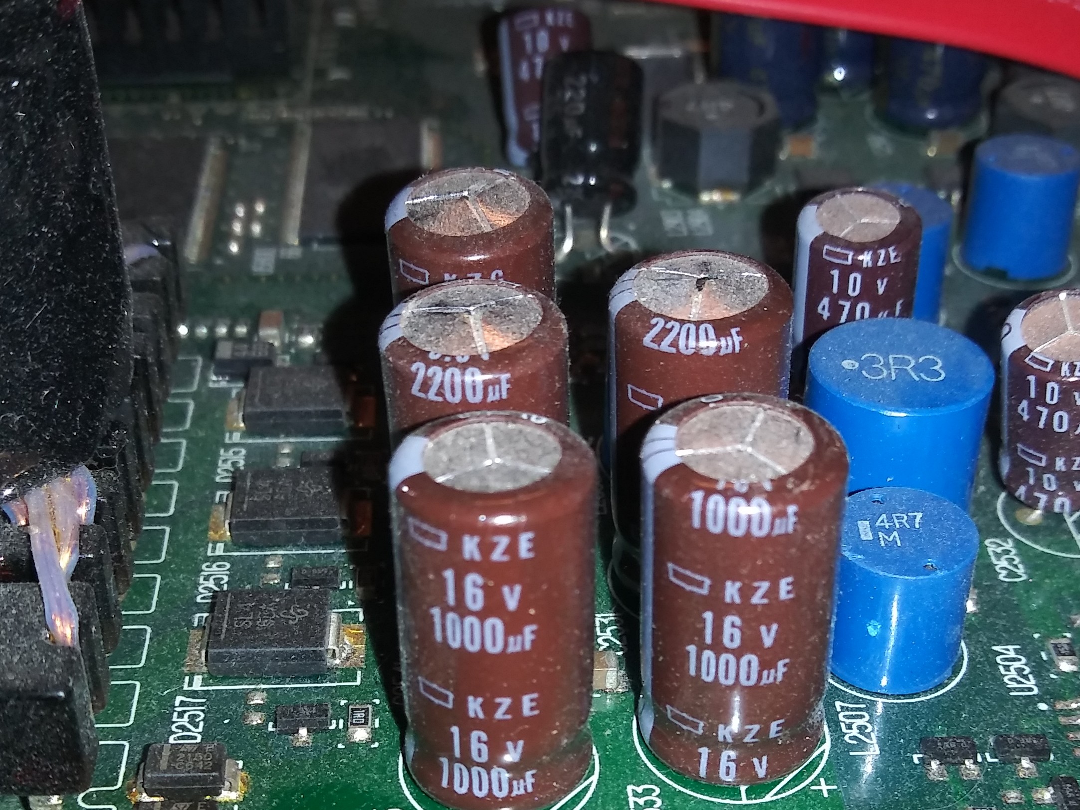

                    3x Nippon Chemi-Com KZG 2200uf 6.3v
                    These are part of a PSU in a (Scraped) DVR.

                      #890
                      Re: The Hall of Shame - Badcaps Photo Montage
                      And the KZEs are doing just fine, unsurprisingly.

                        #891
                        As usual.
                        And this is nothing. I have a Dell Dimension E5150 motherboard littered with KZG caps of a few different sizes. But not like that matters - they are all bad/bulged. What's even more funny is that some of these KZG caps are in low-stress spots (like next to PCI connectors) and there are 85C Chemicon SME (general purpose) caps sitting right next to them - all fine, of course.

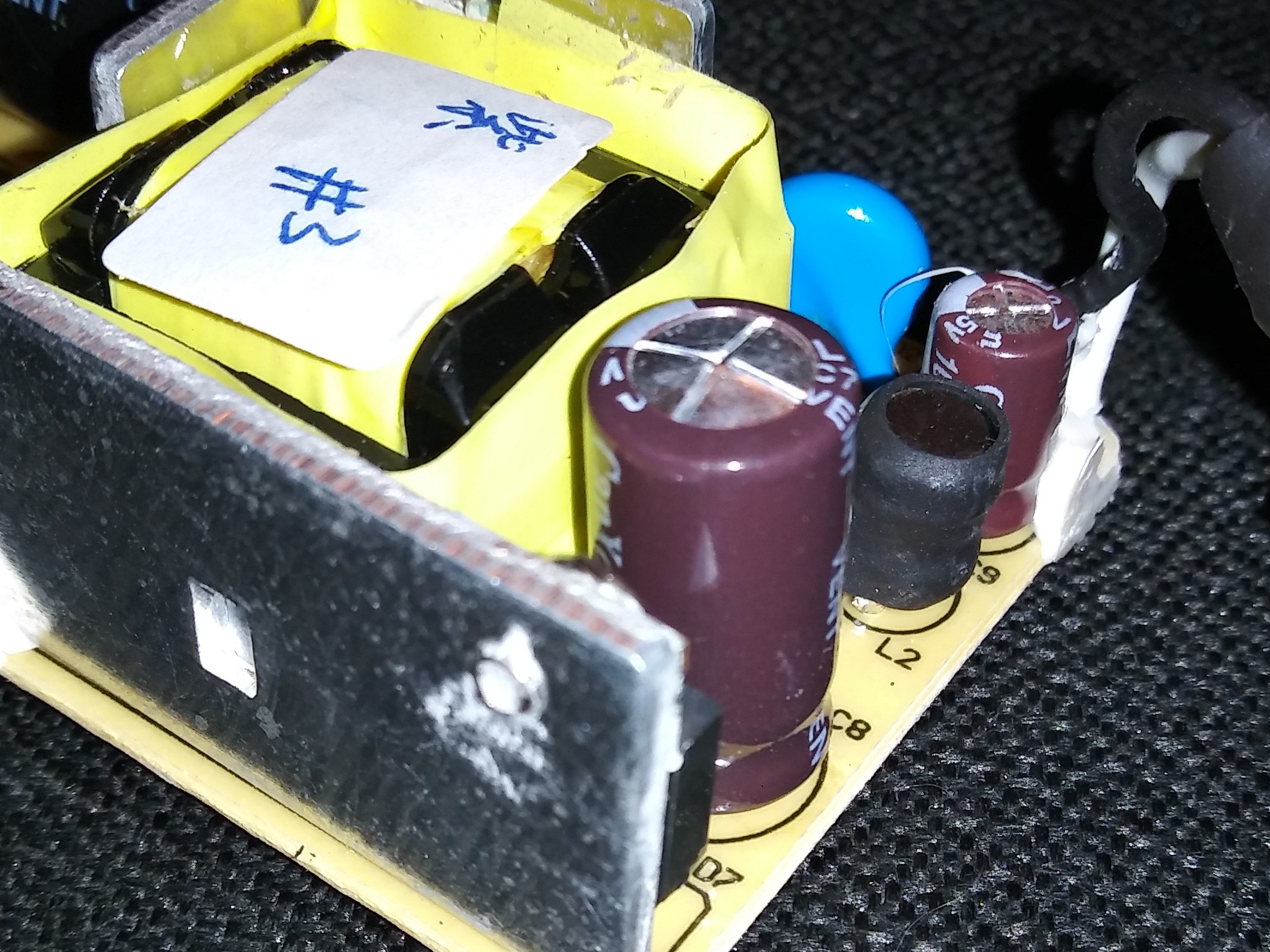

                              Capxon GL 1000uf 16v
                              This was inside a 12v power supply i got for a 1$. I'll most likely replace all three Capxon GL caps on the power supply with whatever i have on hand.

                                #895
                                Looks like a discontinuous flyback, definitely a stressful application. PW and LXZ look to be similar impedance.

                                    #897
                                    The thing is, this is the second time i've opened up one of these power supplies to find a failed Capxon GL cap.
                                    So far, the capacitors i have on hand that i think might be able to replace this capacitor is a 1000uf 25v Sam Young KME, a 1000uf 16v Junfu WG, and a 1000uf 16v Rubycon YXJ. (i'm not sure if i want to use the Rubycon since i'm not sure how often i need to use this power supply).

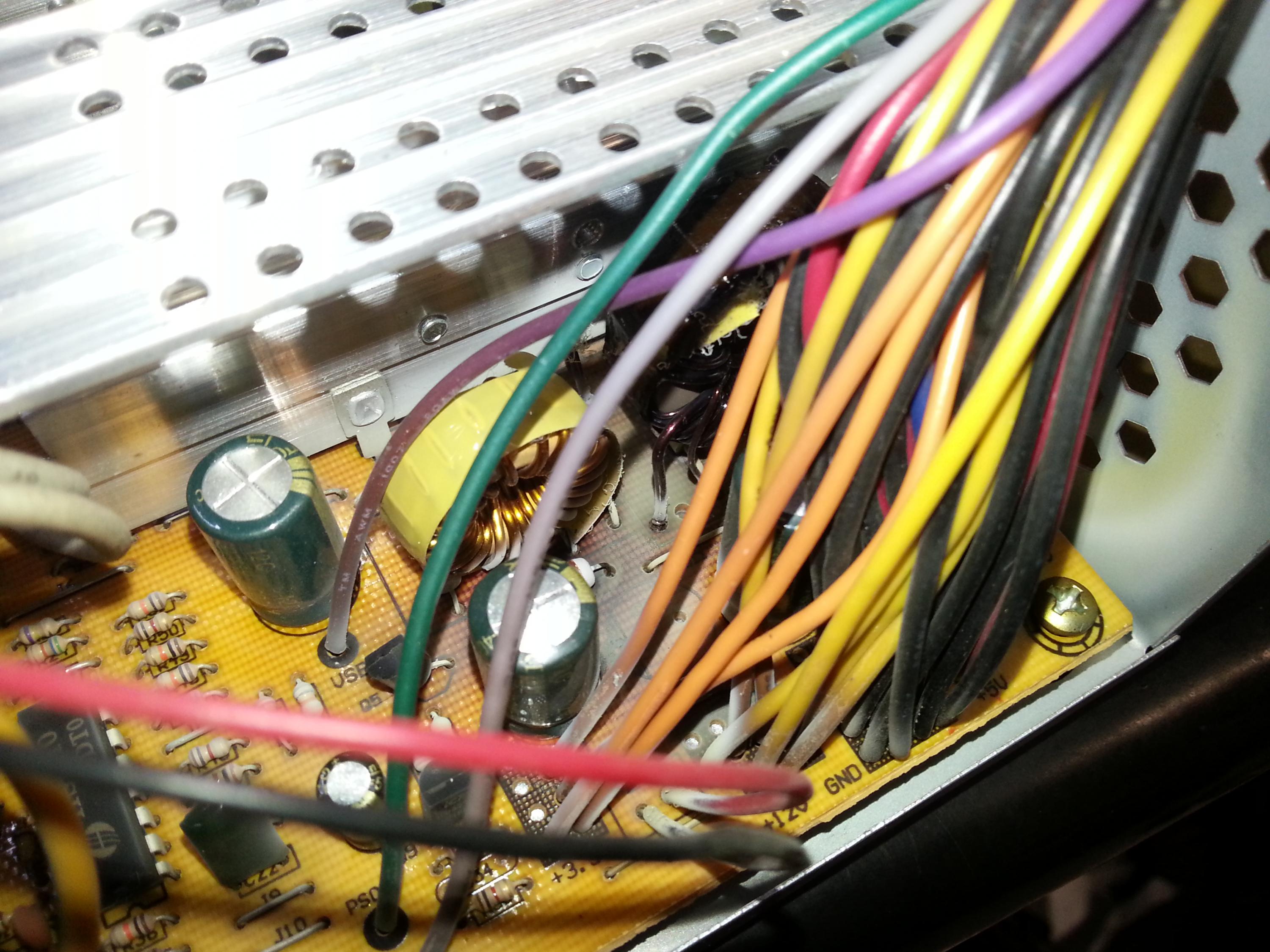

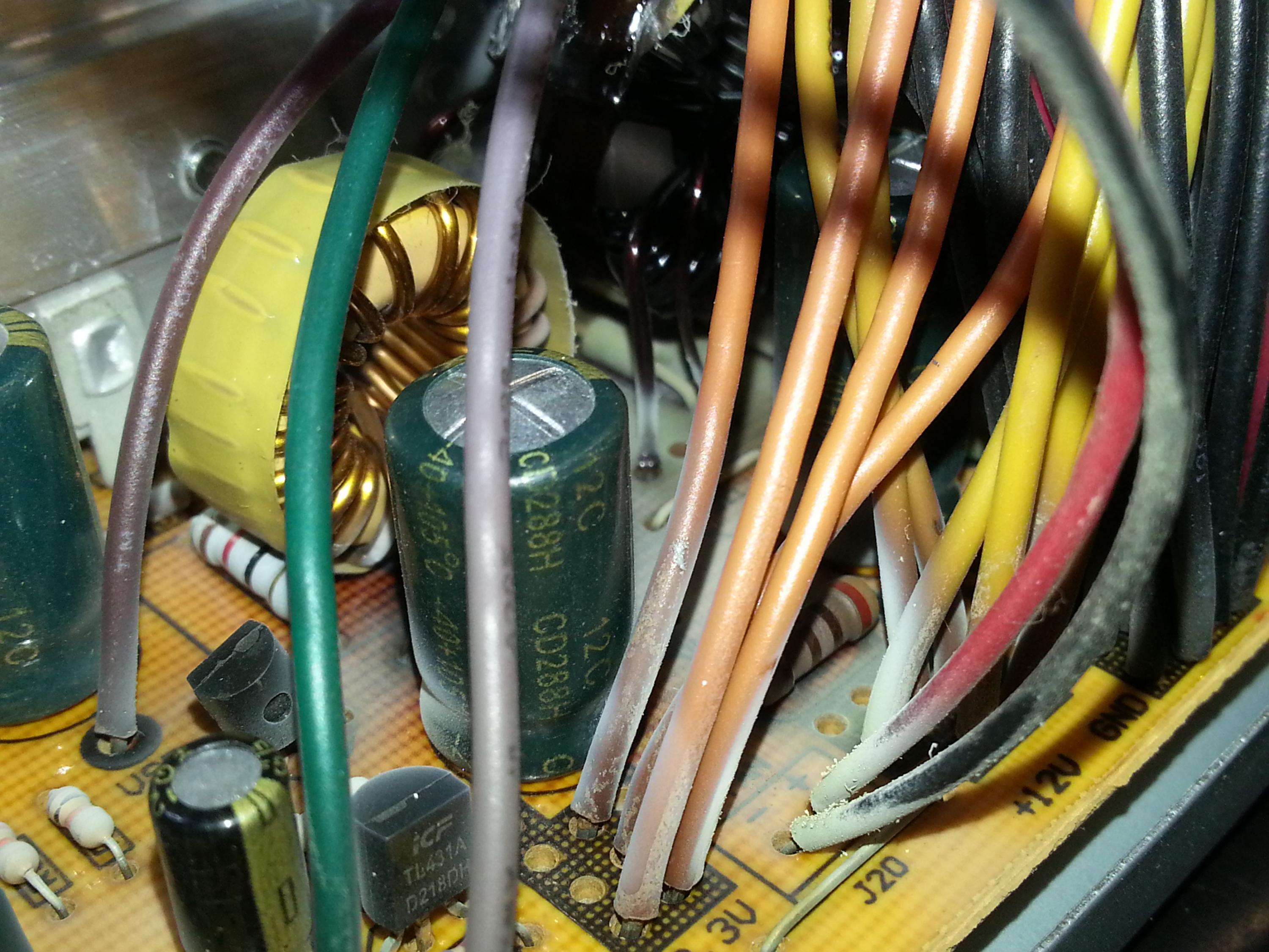

                                          #900
                                          Found this in an ATX supply and I thought it might be interesting: not sure if that white "fog" is directly related to the bulged cap, but I believe it is, since I haven't seen anything like that so far...what is that ? Has anybody seen this before ? :| Does electrolyte "vape" like that ?
