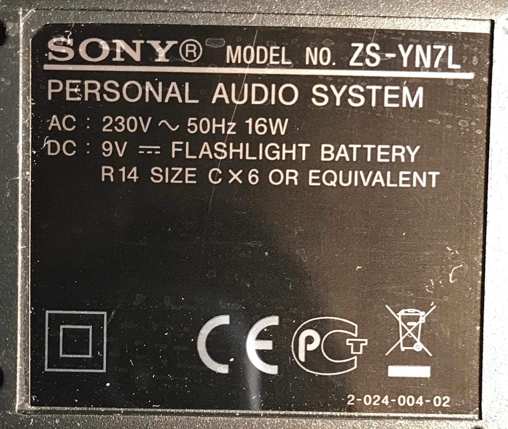

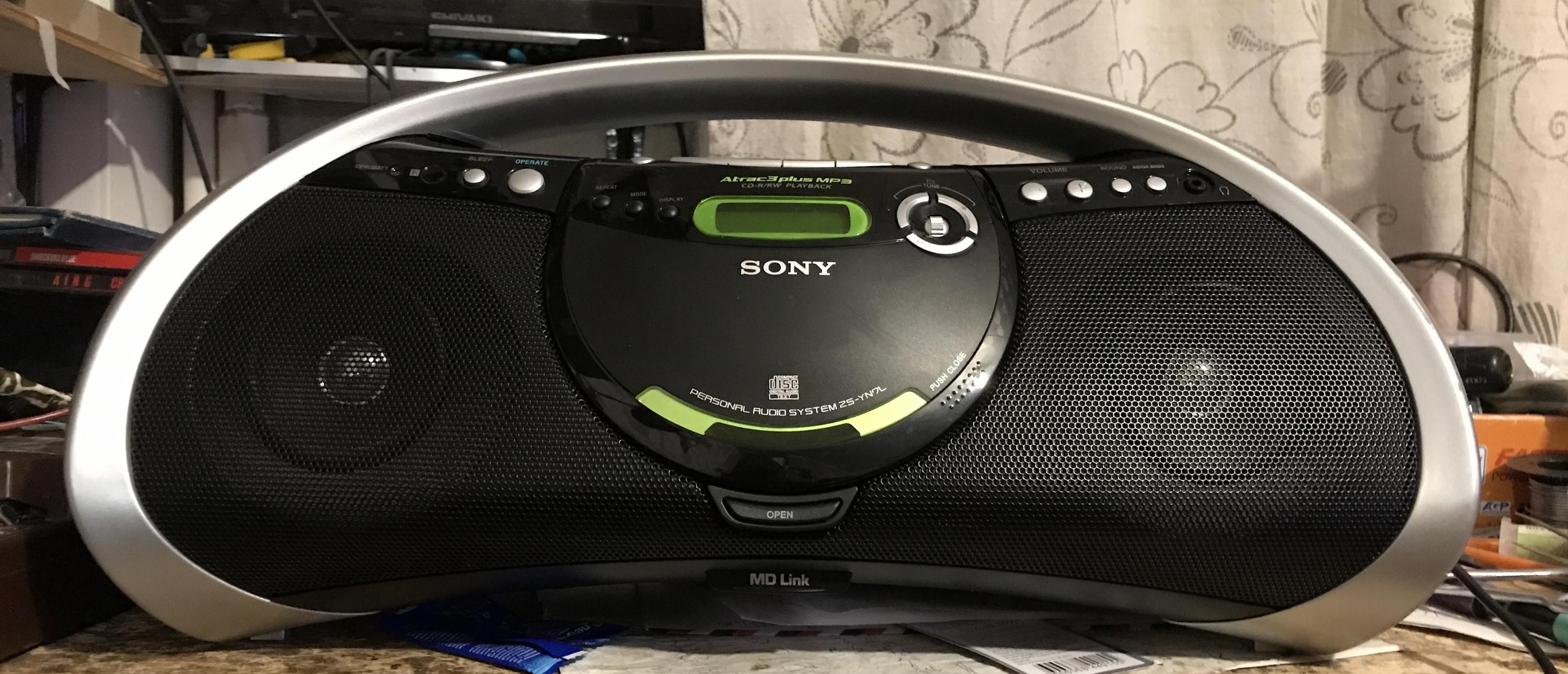

          I was repairing this Sony balalaika and found three faulty ones (short circuit!!!) capacitor , I do not know this manufacturer. Perhaps their breakdown was influenced by the fact that their operating voltage is 10 volts, and according to the service manual, capacitors with an operating voltage of 25 volts should have been used.

            Balalaika
            Wattevah...
            • kasfamily
              • Aug 2014
              • 774
              • Russia
              #1026
              Re: The Hall of Shame - Badcaps Photo Montage
              Yes, thats her -
              • Dannyx
                CertifiedAxhole
                • Aug 2016
                • 3912
                • Romania
                #1027
                Really though: is that slang for boomboxes/portable stereos ? I laughed like a retard for 10 minutes

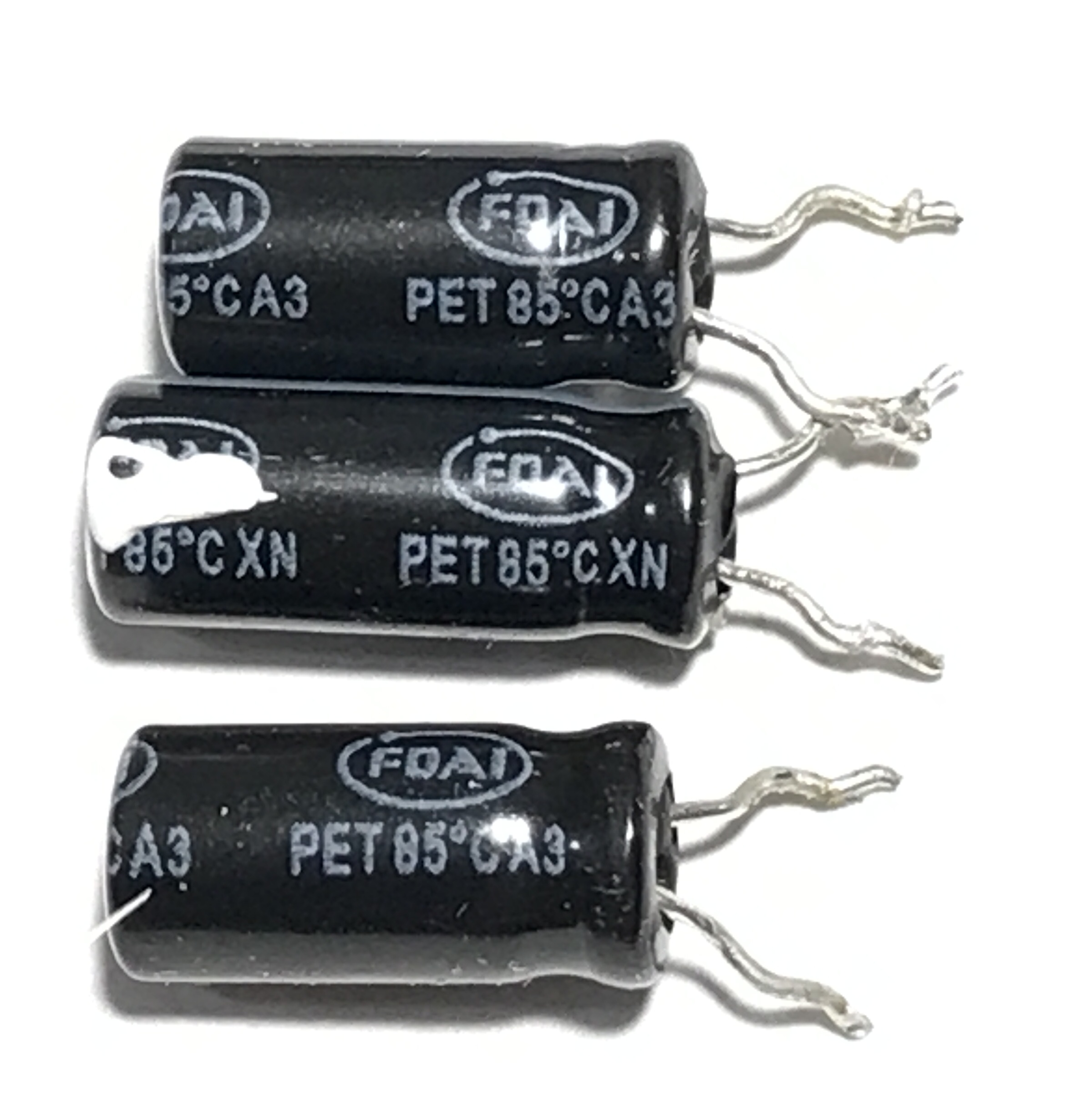

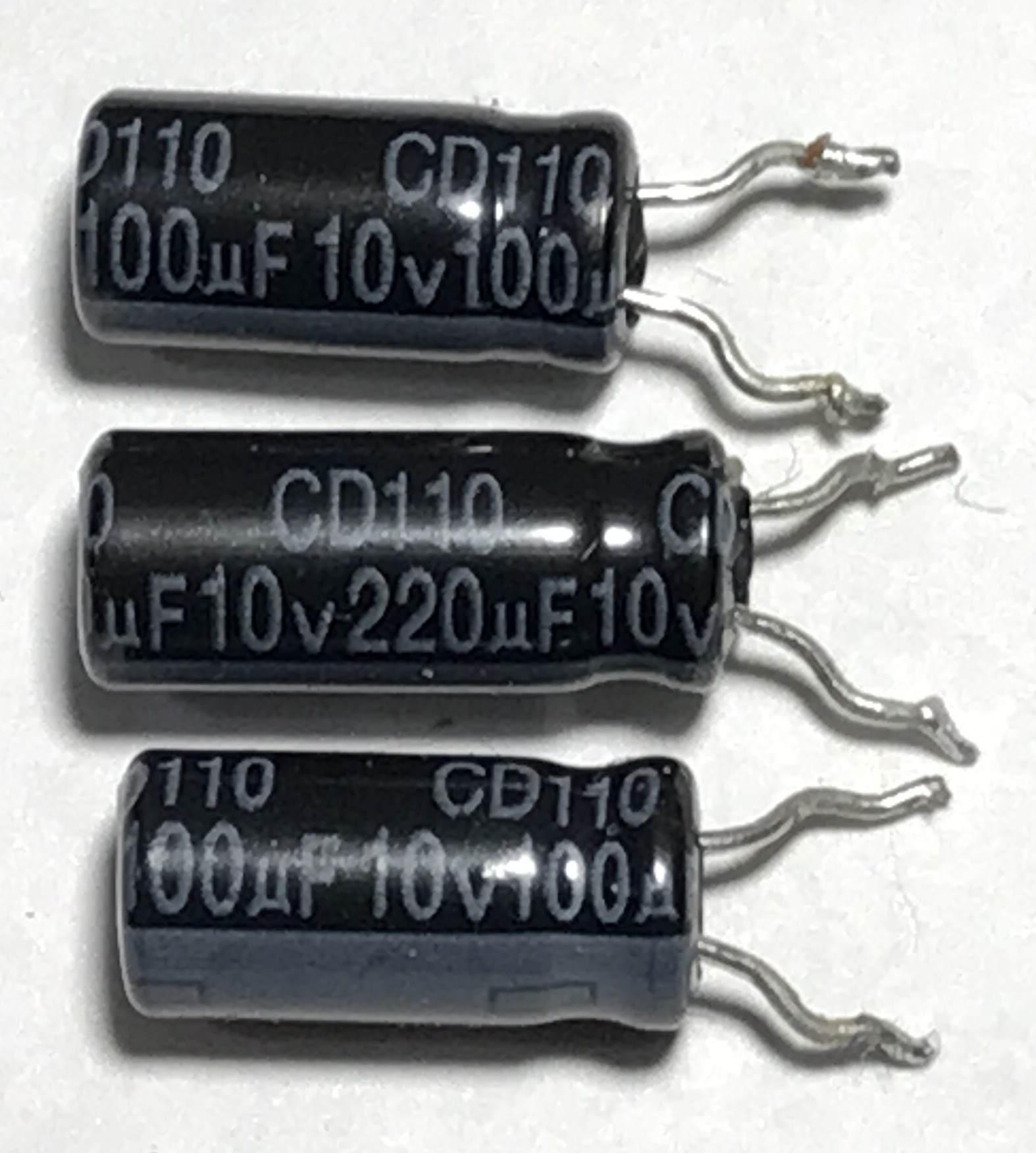

                    Old Elite PW 450v 120uf serving as a primary cap in my old Dell 2407. There is some leakage and corrosion on the positive terminal, seemingly a rather common failure on this model of monitor. As is well-documented on this forum, the terminal will eventually get eaten through and cause a bunch of components to blow up. Fortunately, my monitor was still functional when I found the bad cap. Otherwise, I would have had to replace a LOT more components!
                    All of the other caps (Elite ES, Elite EJ, TAICON HD, Lelon RGA, FOAI CD112A) seemed fine.

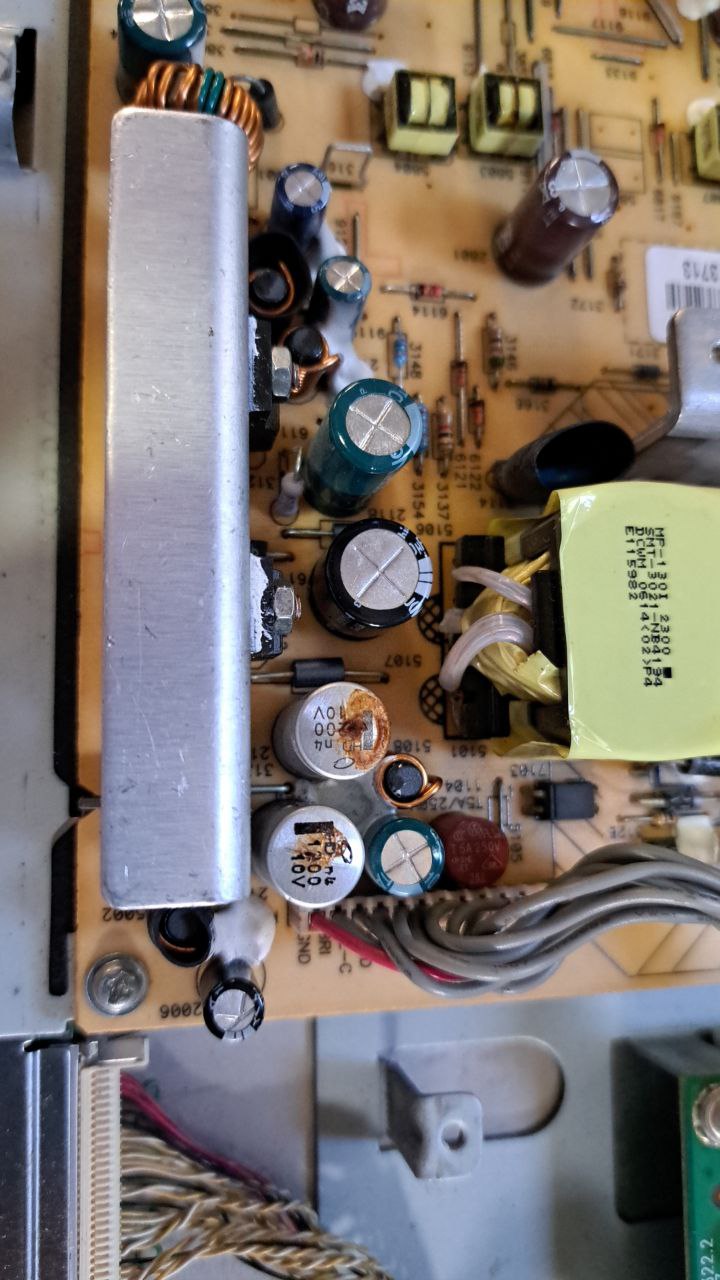

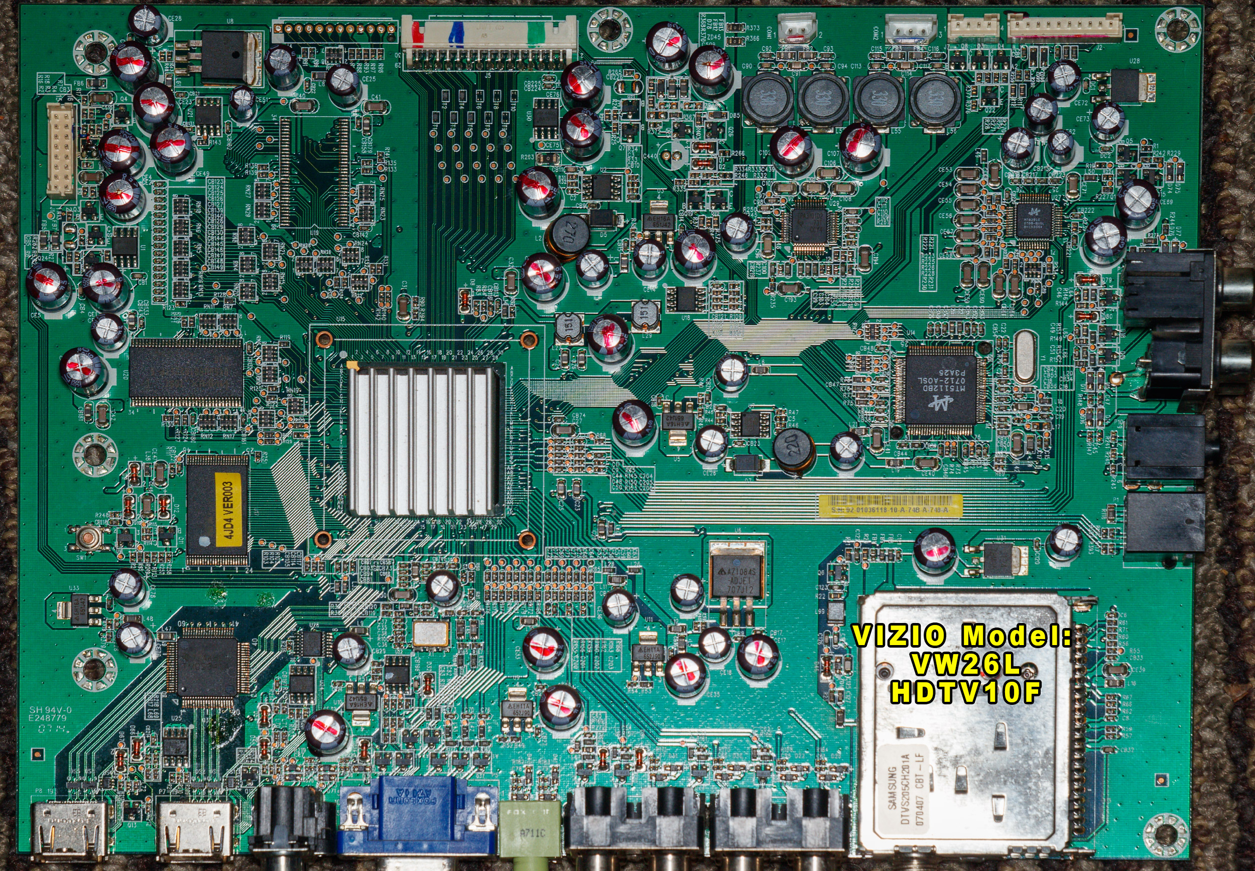

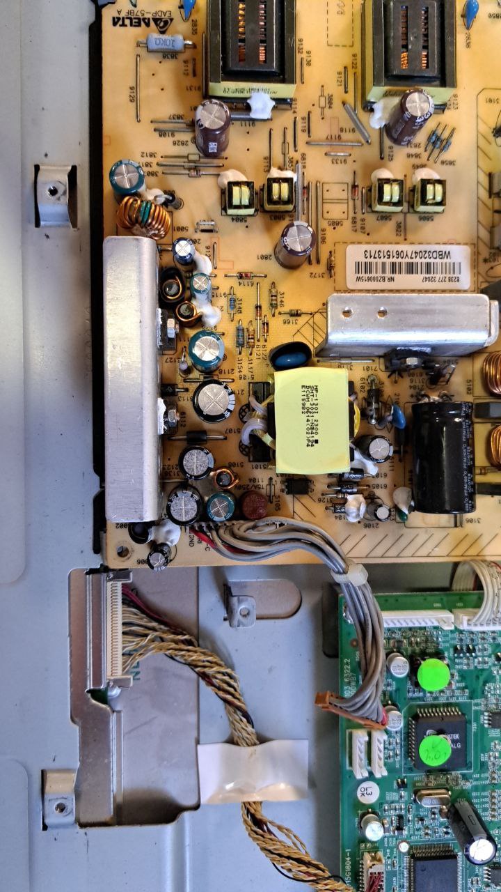

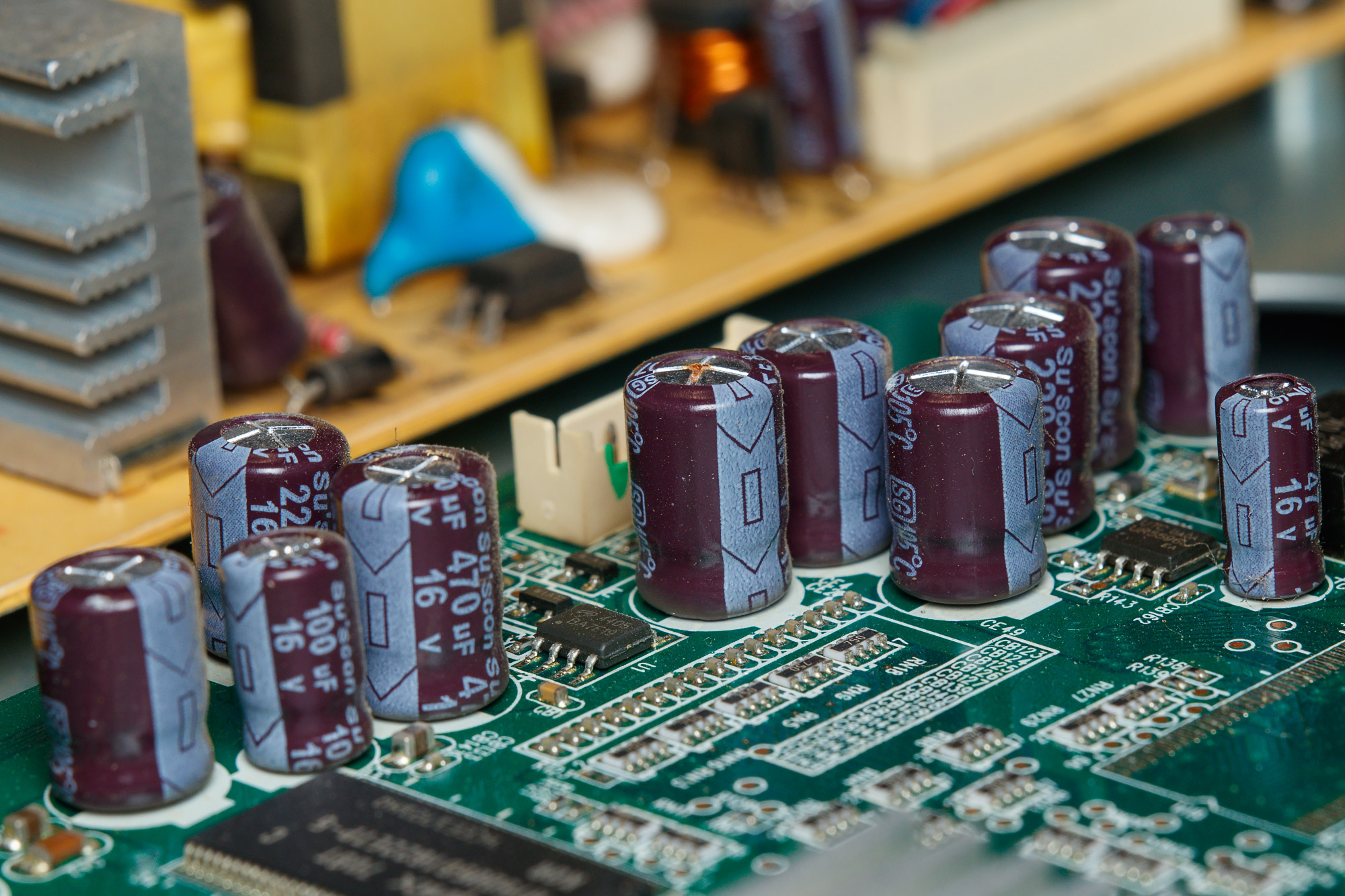

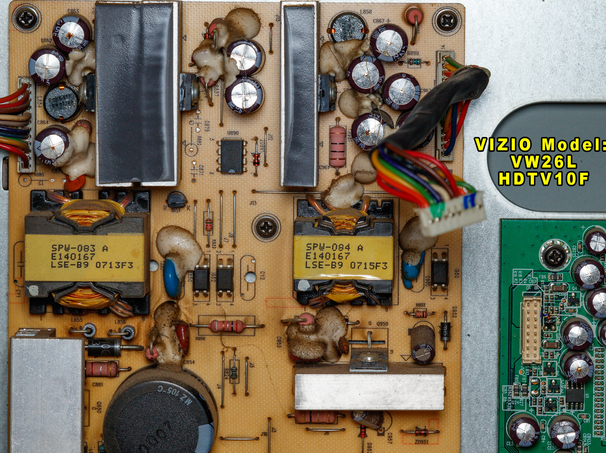

                            I think I found the reason my Vizio TV is cycling on and off and it has a buzzing in the speakers even when muted...
                            • RukyCon
                              A Fake Rubycon
                              • Jan 2017
                              • 816
                              #1034
                              NGL those su'scon caps be looking a bit sus.

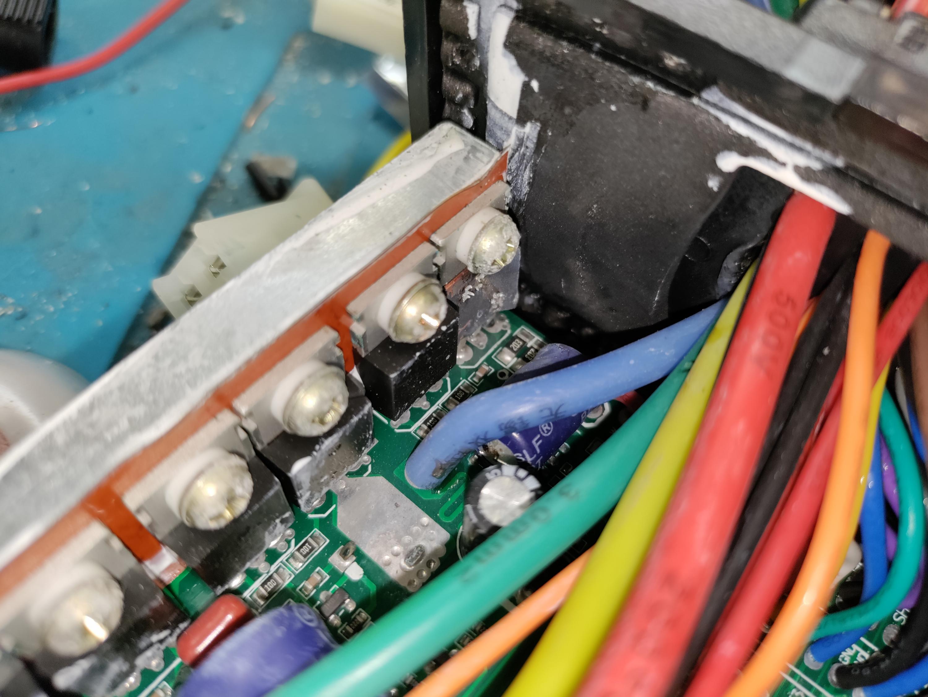

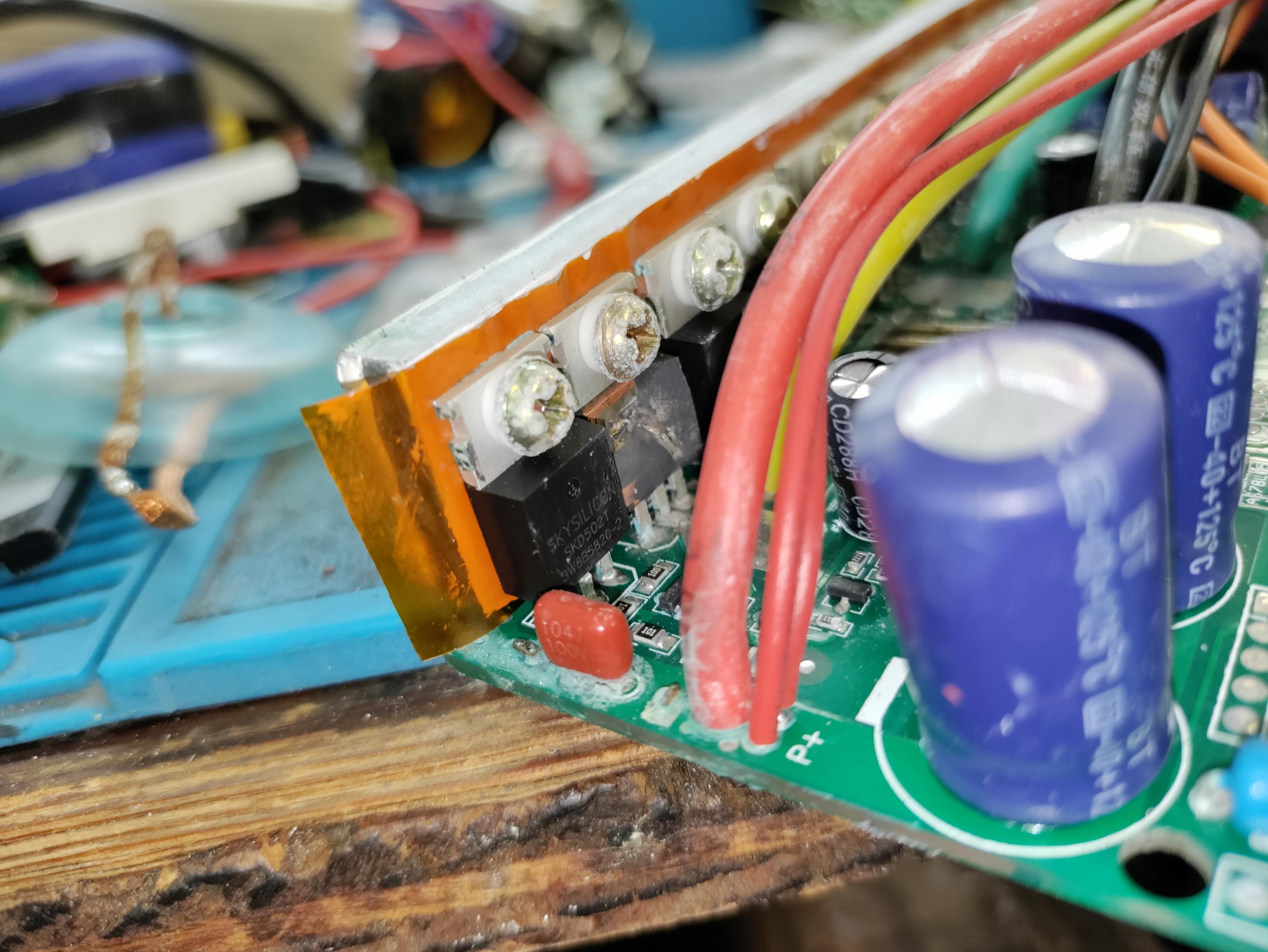

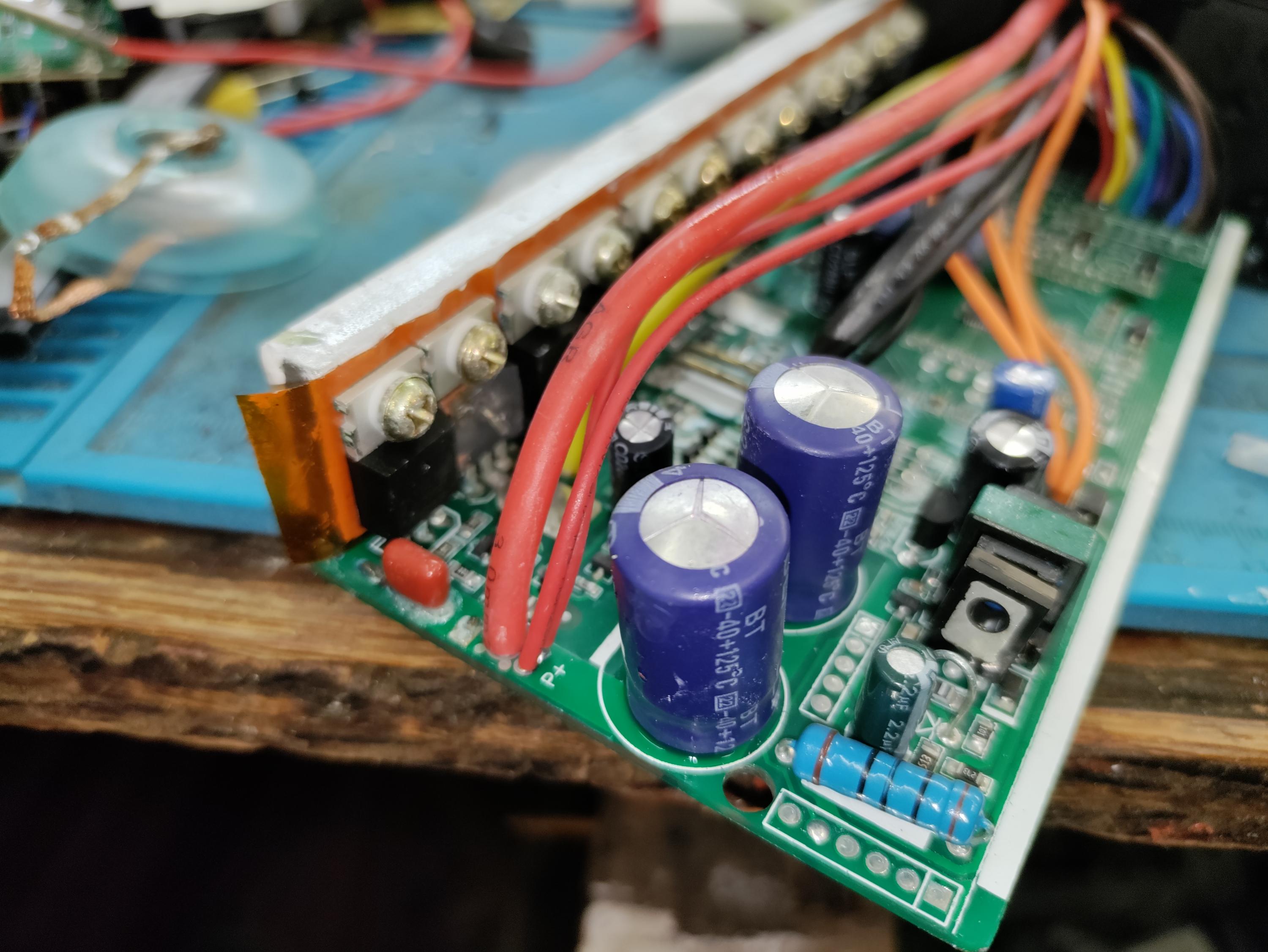

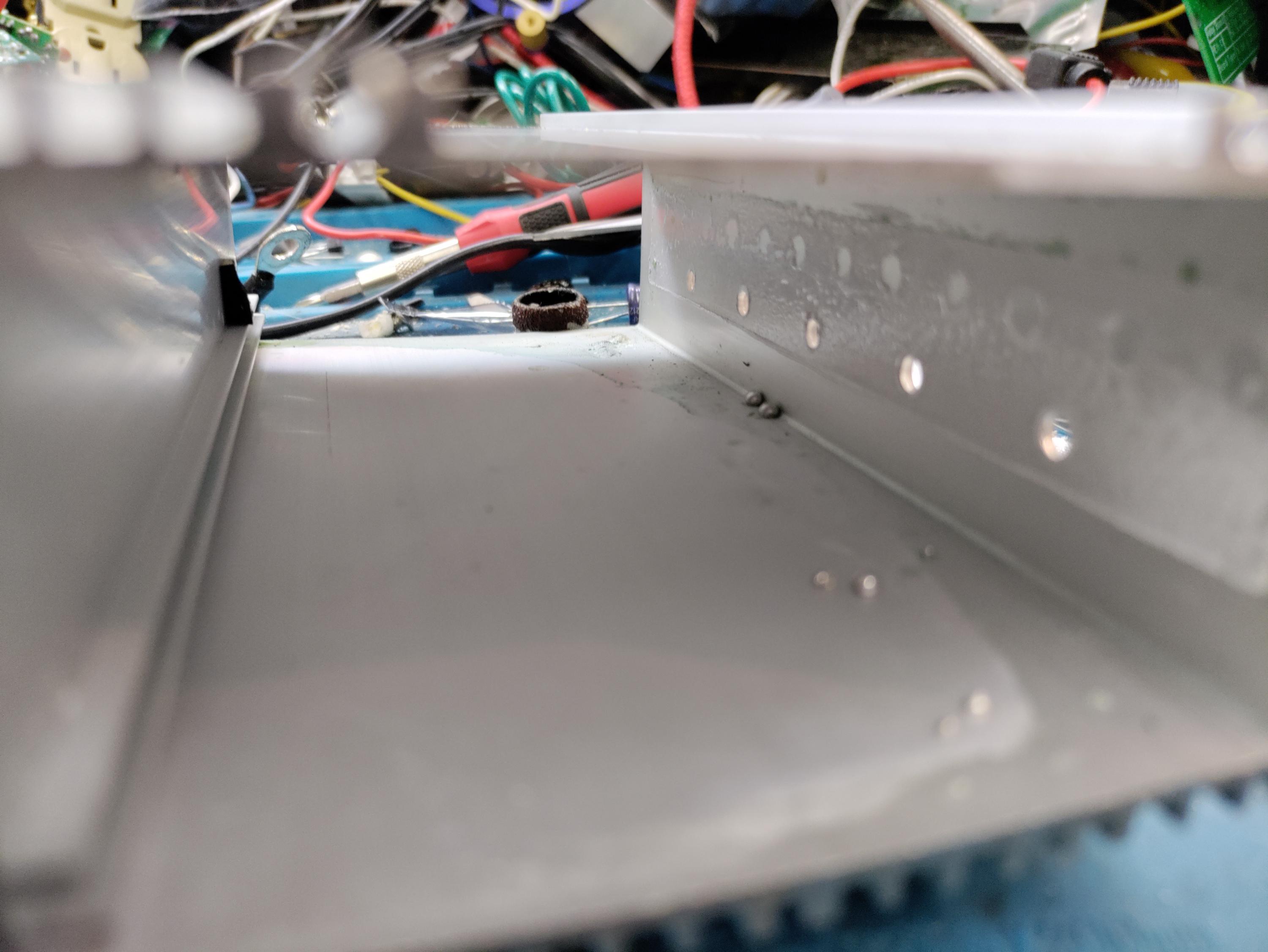

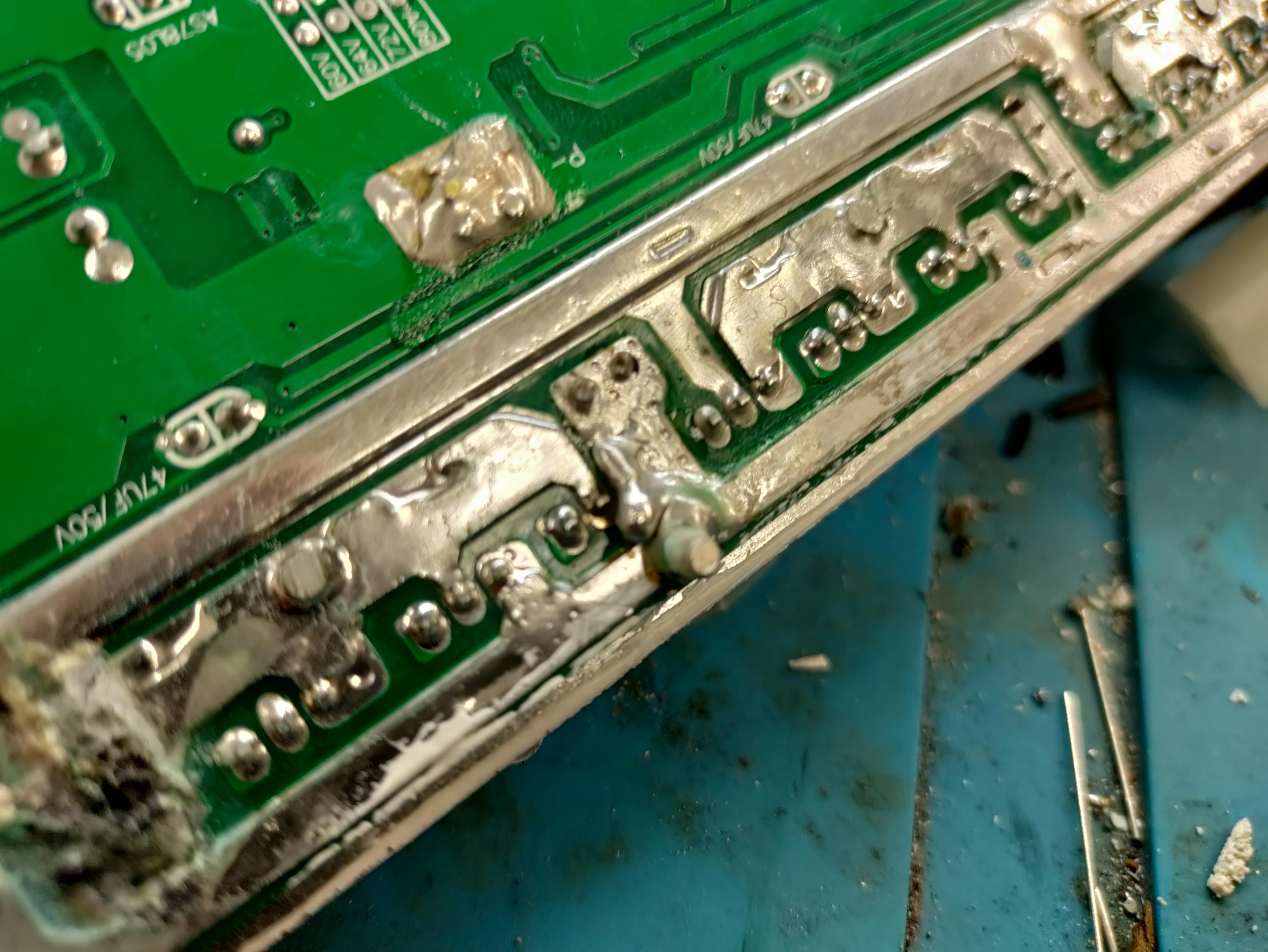

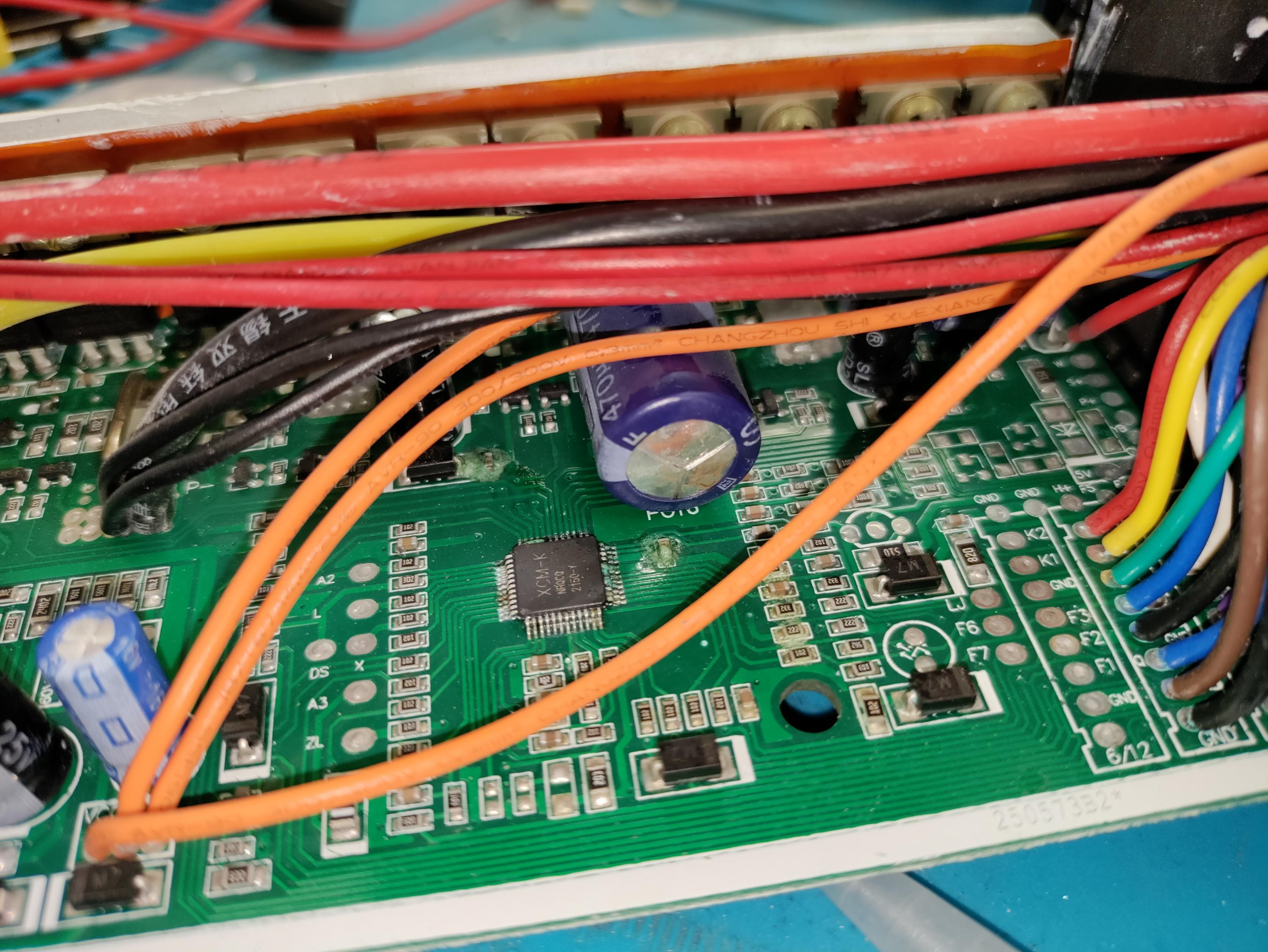

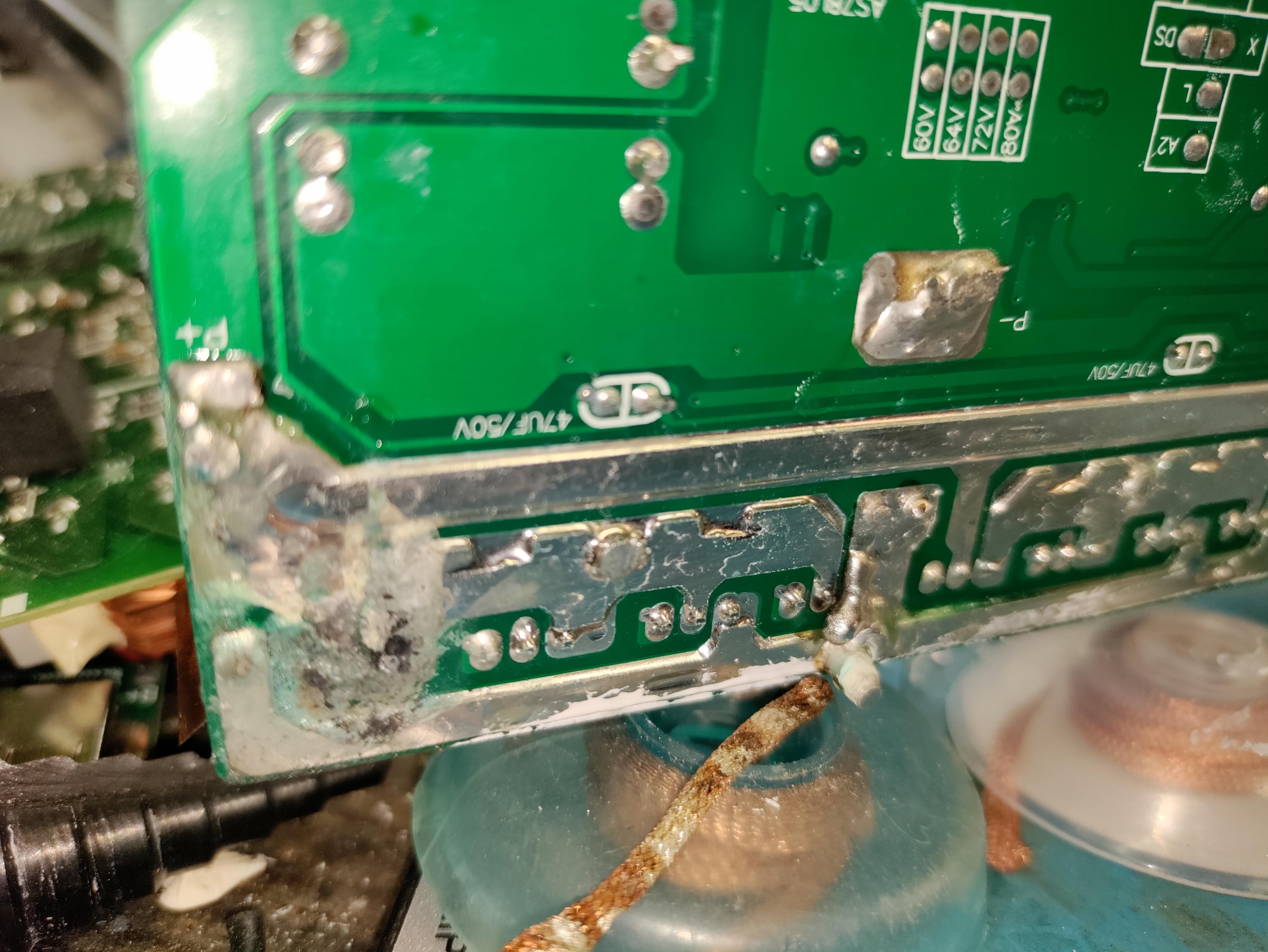

                                        Brand new 48v 1800w BLDC motor driver killed by undersized/poorly made capacitors.
                                        Brand: SLF
                                        Series: BT
                                        Sizes: 470uf 63v, 47uf 63v.
                                        Total number of failed capacitors: 4
                                        All four capacitors are located across the supply lines, and thus shouldn't experience a lot of stress, meaning either the heat killed them ( as the driver did get hot as hell after 10 minutes of use), though this doesn't explain why every other capacitor on the board was left untouched, which leads me to believe that the capacitors overstated their voltage rating, which doesn't seem unlikely, as other companies have done that before. But As a result of the failure, at least four or more MOSFETS have been blown, not sure if it's damaged the motor, but doing a continuity test on it shows really low resistance on all three windings.
                                        Some additional details:
                                        The electrolyte from the capacitors managed to pool up in one corner of the board, causing corrosion in that corner, the electrolyte was also still wet upon taking apart the controller housing, Even managed to spill a bit on my shirt while taking it apart. Before I do much else with it, I'm going to contact the seller of the kit to see if I can get a replacement or refund for the blown controller. And then I may try to repair this one assuming I'm not required to send it back for replacement.
                                        I'm not a expert, I'm just doing my best.
                                        • RukyCon
                                          A Fake Rubycon
                                          • Jan 2017
                                          • 816
                                          #1040
                                          Forgot to mention, The controller only saw about 30 minutes of service before it died. I also just noticed there's a layer of Kapton tape between the MOSFETs and their heatsink, the MOSFETs themselves are all Skysilicon SKD502T parts, rated at 85v, 120A max current. I also noticed that the 5v auxiliary supply appears to be based around a standard two transistor design, even going as far as to use a MJE13003 as the main switching transistor. And the main controller chip seems to be a programmable microcontroller, which basically means if it's fried then there's probably no chance of repairing this thing.
                                          I've also attached some more photos, this time focusing more on the corrosion caused by the capacitor electrolyte.
                                          Edit: just spotted some signs of overheating around a couple MOSFETs, including melted solder both on the board and in the case.
