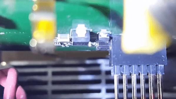

                                    Thomas the Capacitor

                                      wut?

                                        if this means that the gif is not accessible, here - have a zipped avi

                                          Well, even that didn't work too good.
                                          WMP complained of missing codec, as usual (but that's no surprise - who uses WMP anyways, right? ). Meanwhile, VLC complained the file is corrupt/broken, but gave me an option to try and "repair" it. It sort of worked - saw a few frames with a tantalum cap puff some smoke. So I got the joke about "Thomas the Capacitor" now!
                                          BTW, this forum converts all GIF files to JPG, so that's why the GIF didn't work.
