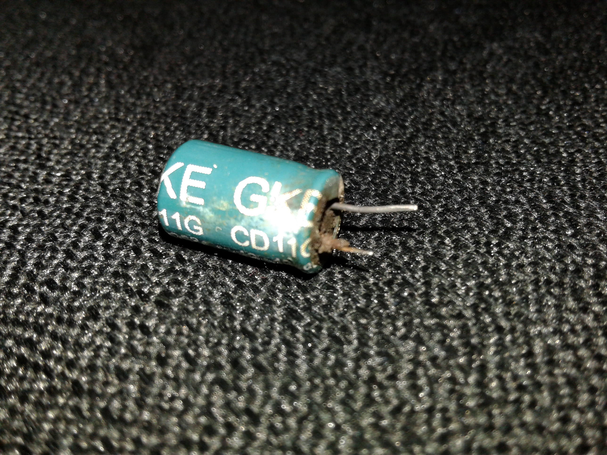

          Re: The Hall of Shame - Badcaps Photo Montage
          This capacitor is from a cheap LED lamp i drowned in salt water.
          Brand: GKE [Garbage Korroded Electrolytic]
          I'm not a expert, I'm just doing my best.

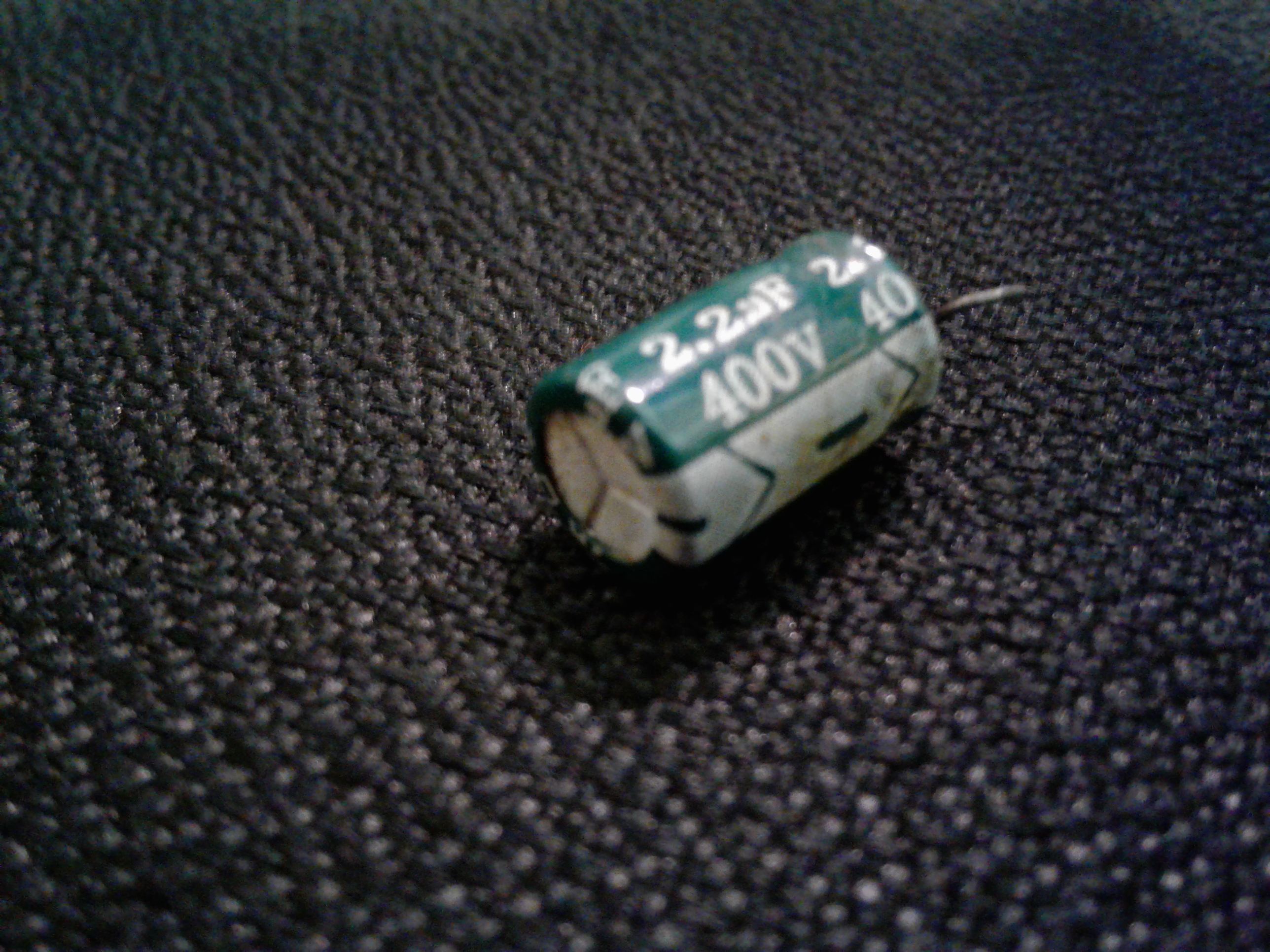

            Wanna D8 Rubycons LLE 3.3/400? I've stocked them especially for lamps with close to no space inside.
            • RukyCon
              A Fake Rubycon
              • Jan 2017
              • 816
              It was one of those dirt cheap bulbs from ebay.
              I wanted to see how they made it only 0.75 cents, and now i know.
              And the LEDs i do get already have rubycons in them. [Well, most of them.]
