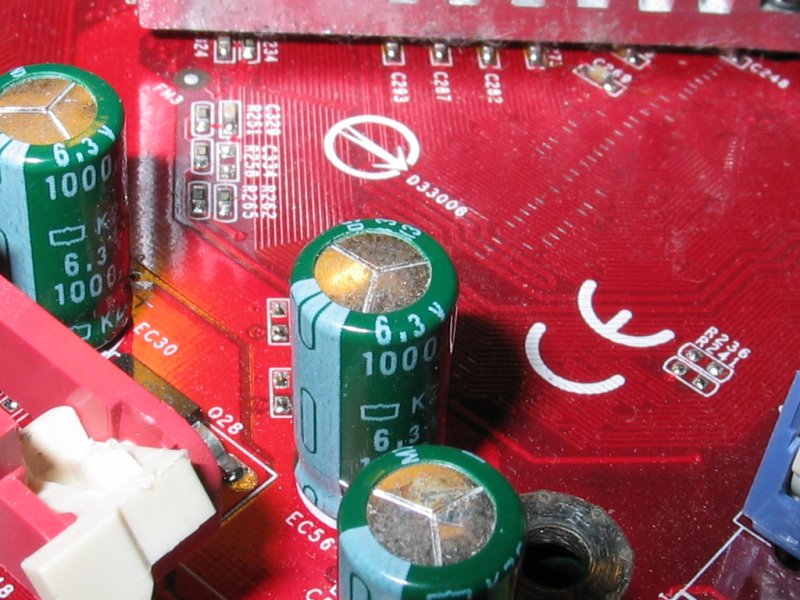

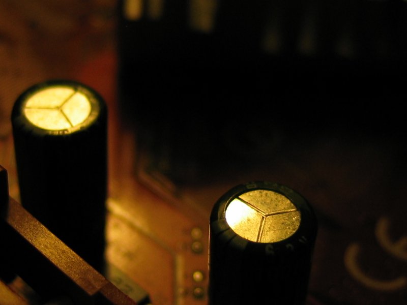

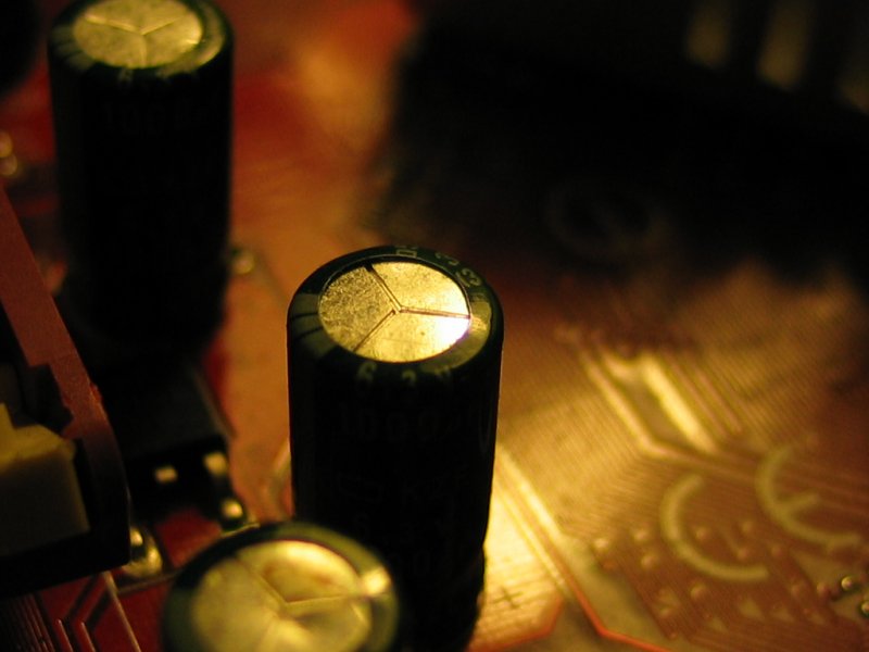

    Well, i guess the only caps with the tristar vent i've seen fail are Samyoung then..
    But the caps in Topcat's photos are defiantely UCC, as they don't have the dot in the center.. Whether they're real UCC or fake we can't be sure yet.. It's hard to tell from the picture the surface "shinyness" of the top of the caps.. The laptop in the other thread appeared to have the real UCC shield logo, but the vent cuts looked deeper and wider..

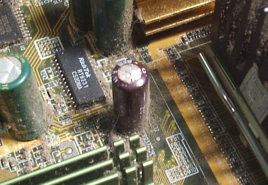

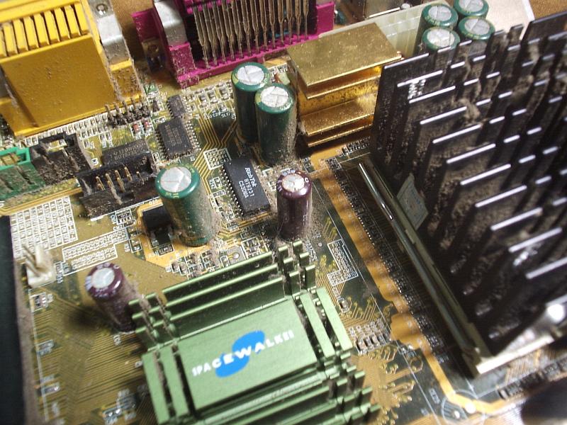

          The second failure Topcat showed us looked exactly like mine failure (black dot in the middle):
          Only far, far worser. In my case, the machine run fanless watercooled for about year and so at 200x13 - 2600Mhz with 1.800Vcore and folding all the time - except for gaming
          Now my PSU was a Antec NEO 480W at that time, full of Fuhjyyu (surprisingly there is Rubycon in the input!) - so no wonder that these caps right on the 12V rail from PSU powering the Vcore give up sooner or later
          I bet even a good cap could give up sooner or later in such enviroment (hot GFX card right bellow, very hot mosfets right on top and Fuhjyyu caps delivering enough ripple right on the PSU...) - but server board with lot's of them and on Zippy PSU - I can't believe how seriously these caps give up
          It should be investigated with great care if they aren't fakes, Topcat. Could you please look?

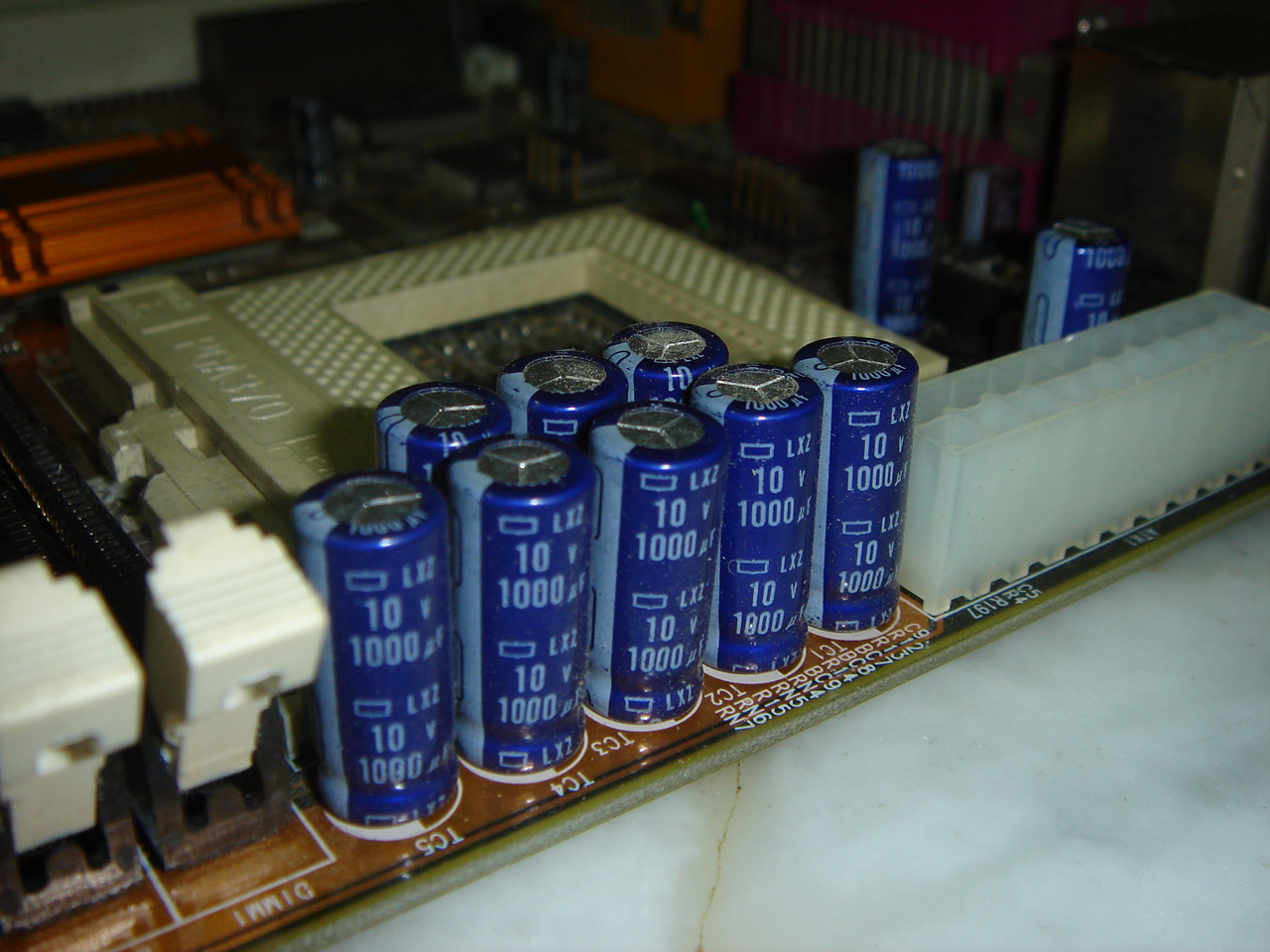

                The one in the middle is a bit bulged
                Here you can compare it with a good one on the left

                  Wait... since when were KZGs green? I always thought UCC's colors were Brown or Black or polymer. Man... I really want to swear by KZGs, but this thread is preventing me from doing so. Guess I have to use other UCC caps.

                    That's a KZE (not KZG), and I don't think there's any reason for concern. The bulge is barely detectable, and it must be a heat/ripple-current issue, probably compounded by a bad PSU. It can happen with any cap that is subjected to excess stress. In my experience, KZE is great in VRMs/PSUs in spite of being aqueous.

                      I've seen green KZEs, also brown. And I've seen LXYs and LXZs in blue as well as brown.
