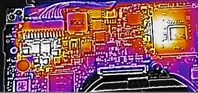

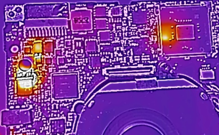

    I am dealing with this LA-G341P, which had heavy liquid damage around the Audio board, Battery charging circuit. I went and cleaned liquid areas and left the audio board disconnected.

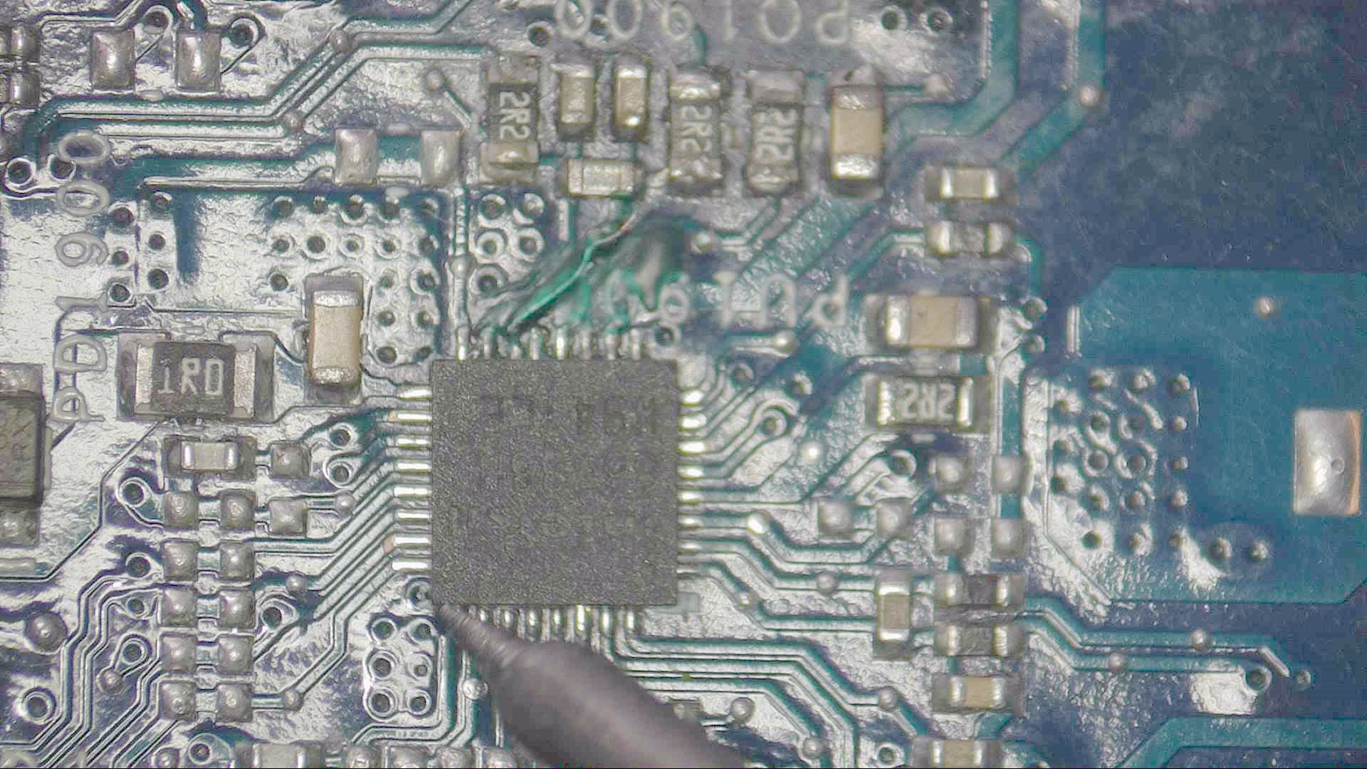

    It had blown PQ1900/02/3 as well as a trace on PU1900. I replaced all 4, and now it turns on and switches off. With a connected battery, it turns on and stays on for a while, even loading the system, then cuts off suddenly.

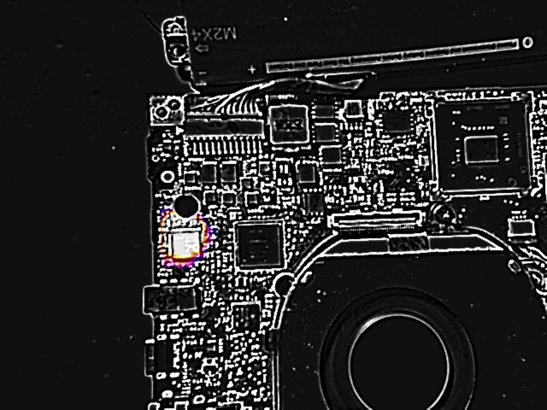

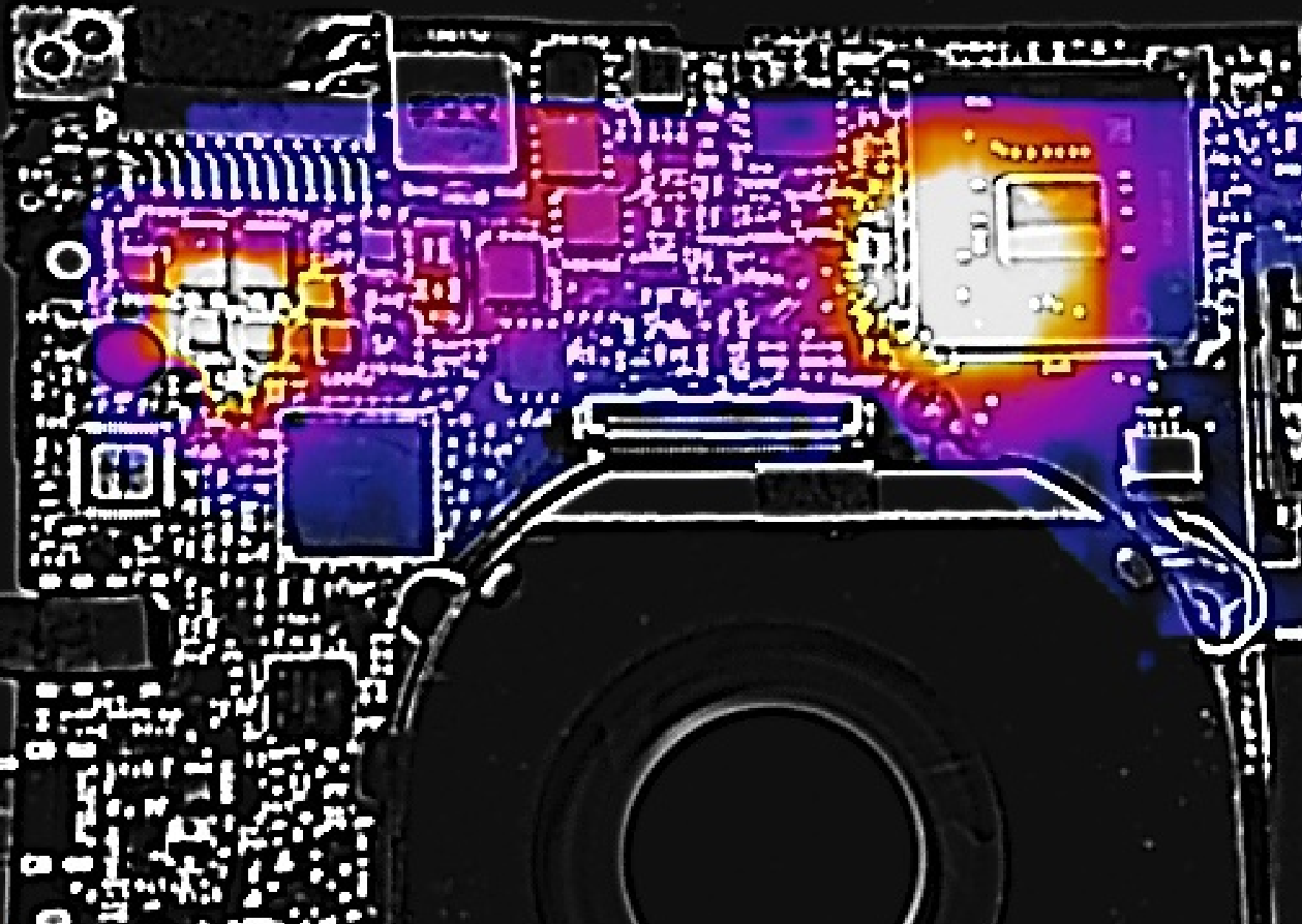

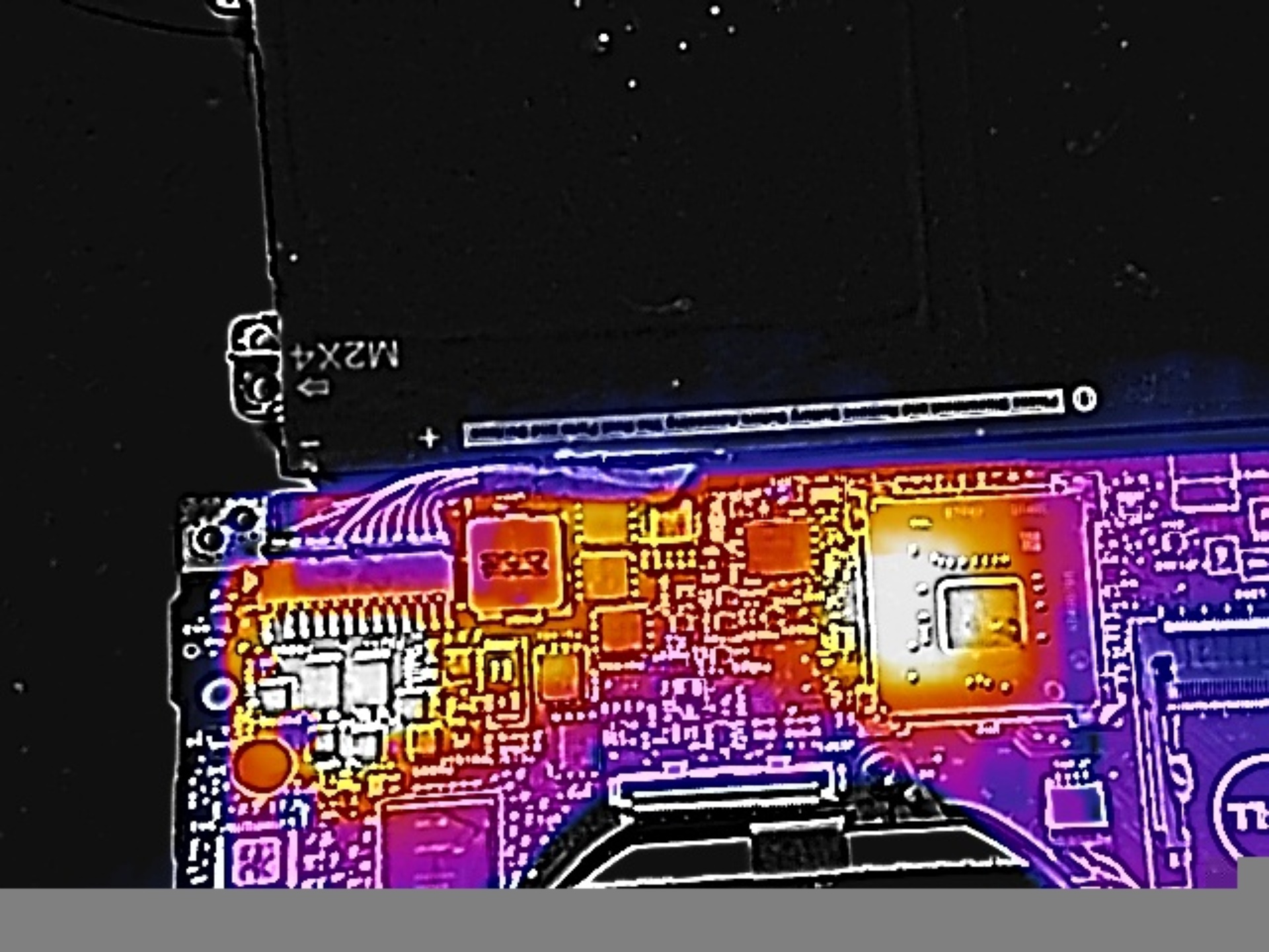

    Charger only - without a battery, the PQ201/PD200 area gets hot. I can see the chipset and CPU also warm up for a second trying to pull up to 2A, then cust off. The Realtek chip gets up to 50*C before the board switches off.
    I have removed it to ensure no internal short is causing the fault, but it's the same. The customer already waited a month for ISL and Mosfets, wont be able to wait another month for Audio IC
    With only the battery connected, it turns on and off and cycles, although the Audio still heats up.
    I have removed the Audio IC again and with battery only turns on for a while and cuts off again. Battery indicator LEDs show that it's empty, though. That may explain cutting down.
    With Battery and Charger - It turns on and stays on for couple of minutes and I get these high spikes of 0.9 - 4A - 0.9A, similiar to a battery charging spikes and perhaps detects that the battery is also faulty. I can see that PQ1905 gets sizzling hot to 60*C and makes sizzling sound with alchochol on it. That whole PQ1905/200/208 area gets boiling on short second spikes.

    Couple 2R2 looks bit corroded, but they all measure fine including their traces

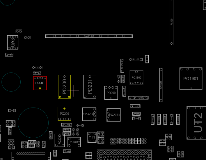

    Something on VBUS_DC_SS seems to pull so much current that causes PQ208 to glow to 60*
    Same with DC_IN_SS for PQ200
    All that said, is there a way to test further without ordering a new battery and audio chip? Just cant hold the customer off for another month.

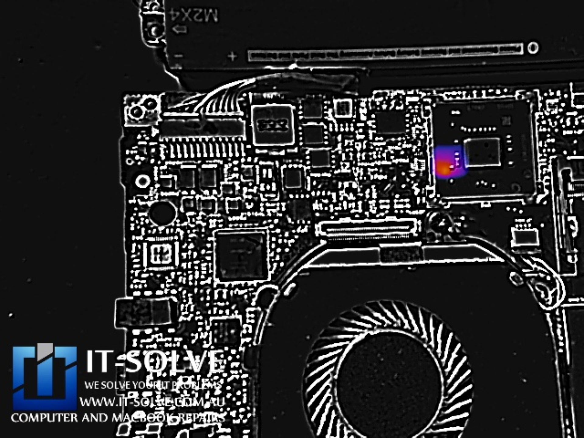

    3. In addition we look at a pretty hot PCH i guess, 60°C or more? First thing i´d try is to find out whether it is shorted or just working (for a short while) and as a result to leave the board as no-fix here and now:

      2. Yes, the second part of the topic was with the removed Audio IC. Still same response, with the difference that only the PCH is heating up.
      3. PCH heating to 60*C, and the whole system seemed to work (as it loaded to the Dell logo and was looking for a boot device before even Audio IC was removed) when it was on a battery only for a short time until it drained.

      Link to schematic - https://www.badcaps.net/forum/docume...top-board-view

          Probed CSMRC lines, even went and replaced slightly corroded 2R2s to make sure they do not muck around. Still same.
          No shorts on any mosfets, or anywhere else for that matter.

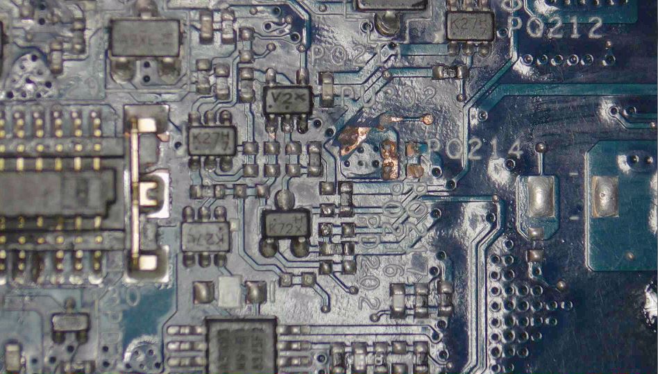

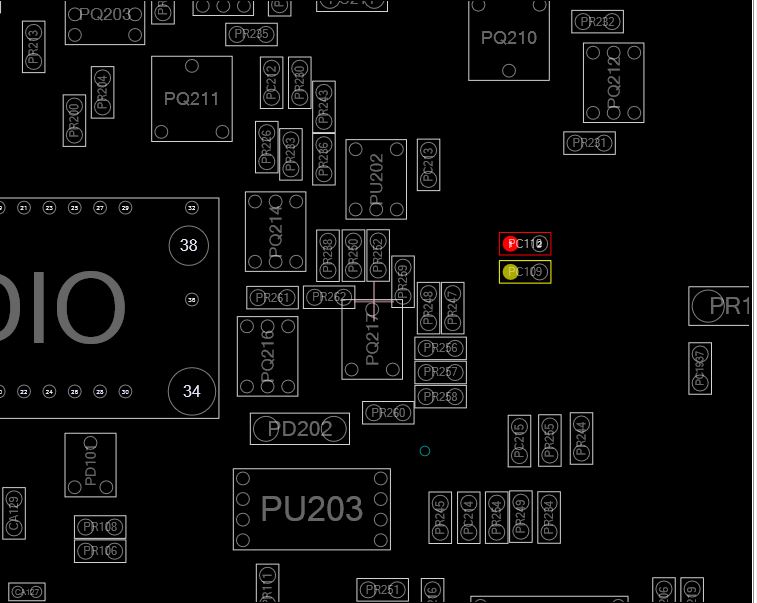

          Only damaged area are the trace on ISL which I reconstructed and these two PC109/10. They are filtering caps with no short on the line and BAT++ voltage being ok there on a battery alone. Unless that upper trace goes somewhere. But I can't trace it down, looks more like a test point.

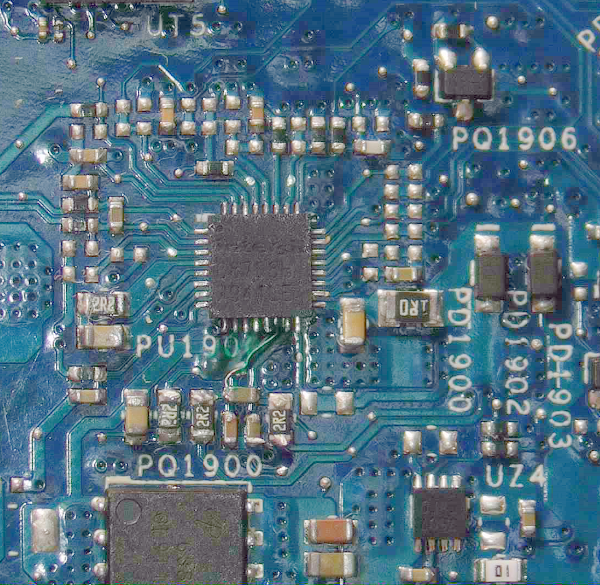

            With this picture, you missed to share in the beginning, the issue makes way more sense now. Maybe no short to GND, but what about internal layers shorted to each other...?
            i wouldn't risk any question marks left and scrape the black carbonized material out till everything looks bright and clean again. After that, if the board still doesn't work as expected, i strongly advice to check whether each pin of the charging controller reaches its destination, so cutted lines and so on and even better, in addition try to make sure, there are no logic or power lines shorted to each other in this area.

              Had to pull the plug, its hard to let go on these almost working repairs, Where you feel you are so close yet so far.
              Separated the layer for the battery charger by removing the coils between V+ and B+ which that burned pad is on, but still not turning on without battery. Only time it turns on is with a battery and charger atm, but is unstable.
              If there is an internal layer short seems to be under mosfet layers as one mosfet sizzles when battery pulls over 2A
