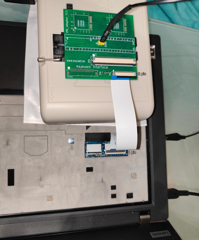

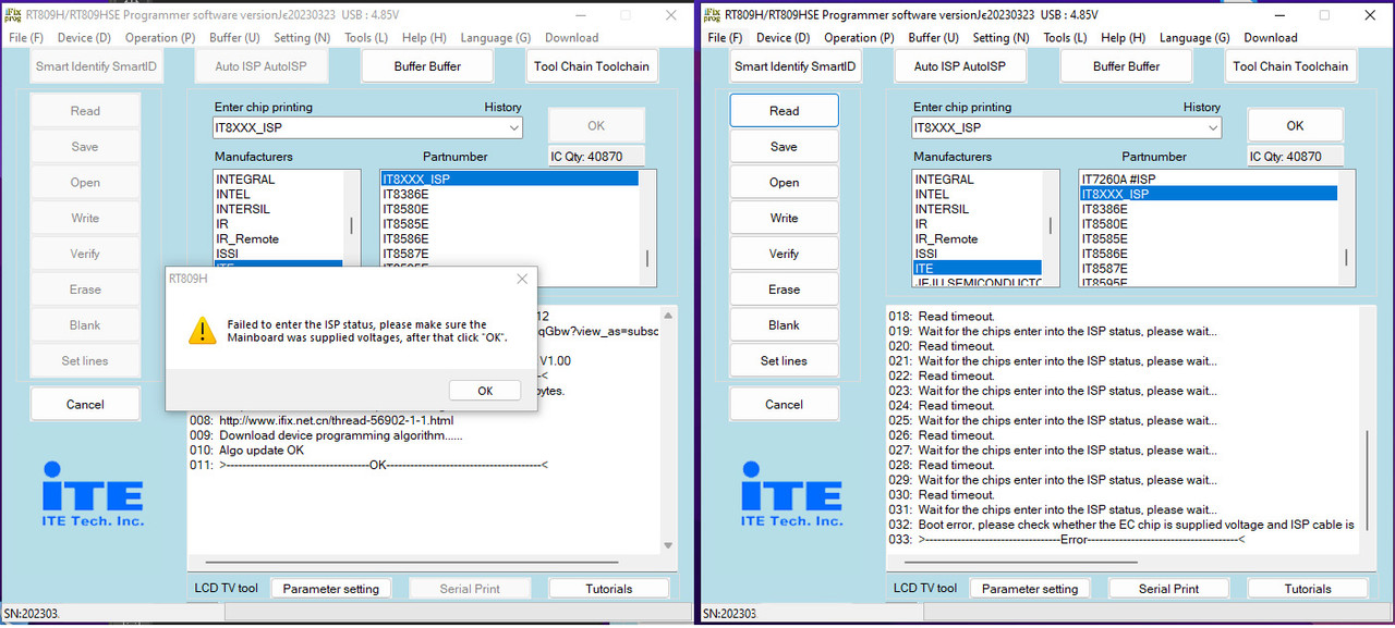

    Hello everyone!
    I try to read the EC ITE/IT8300FN where the bios password is stored.
    The laptop is Lenovo T14 G1 AMD Ryzen 4650U, the MB is NM-C801.
    I can't read the chip with RT809H with ITE board and PFC cable. Might be I need to do something more to enable programing mode(SPI Enable?).
    I saw the post in another forum for T14s AMD (different MB but same EC configuration and pinouts) and one user successfully read and write the the same chip with SVOD3.
    Some details what i did:
    Battery and CMOS battery is unplugged.
    I click Read and then reconnect the battery charger(type c) with different timings to plug in/click on read button.
    I try to click power button, but didn't help.

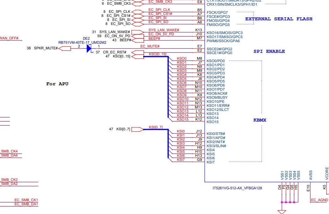

    Traced all pins from MB connector to programmer connector and its fine.
    Double checked diagram pins KSO/KSI.

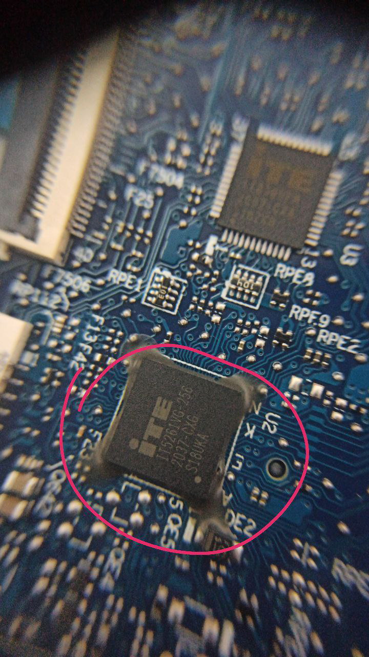

    EC ITE model:
    Datasheet for pinouts:

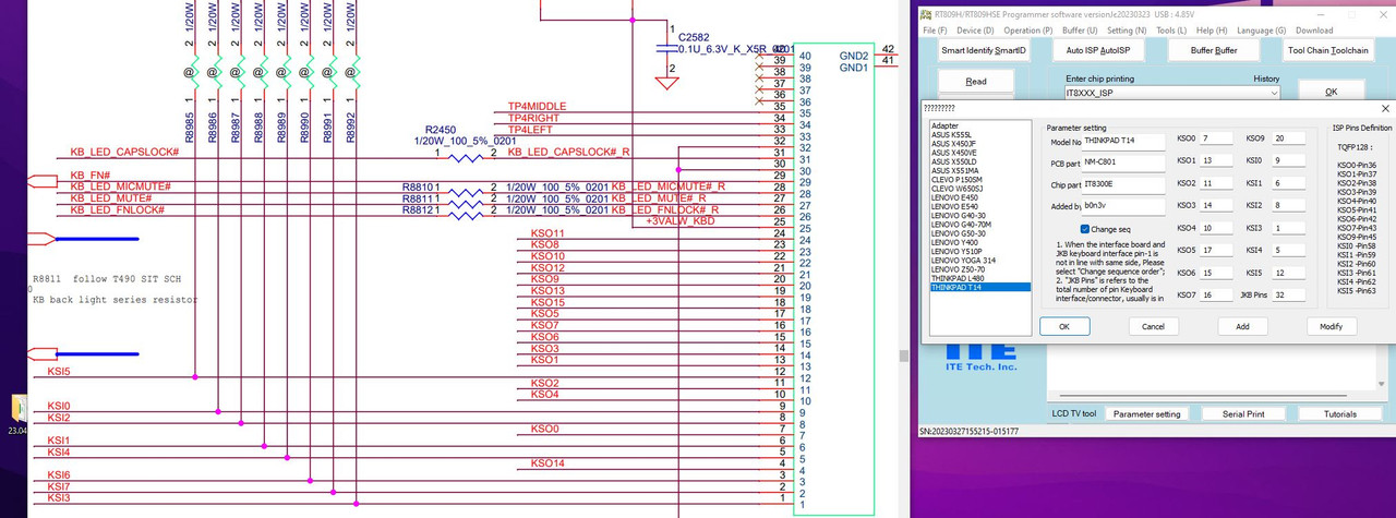

    Config in RT809h, first pin on MB connector is no aligned as first pin on programmer so I checked "Change seq":
    What errors throw:
    How I connect(here is 32pins FPC with 8pins cut=24pins):
    This one is picture of EC, from user in this forum:
    Any help is welcome, thanks!

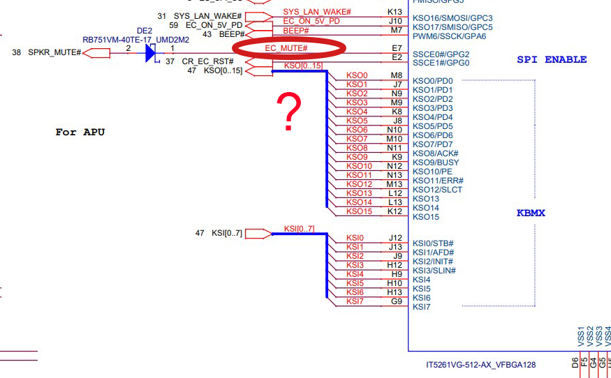

    Did I need to use "EC_Mute" with 100k R to enable 'SPI Mode' or something like that? I don't understand, the RT809h can't read it or i just do it wrong, if someone have an idea for that..

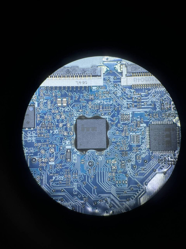

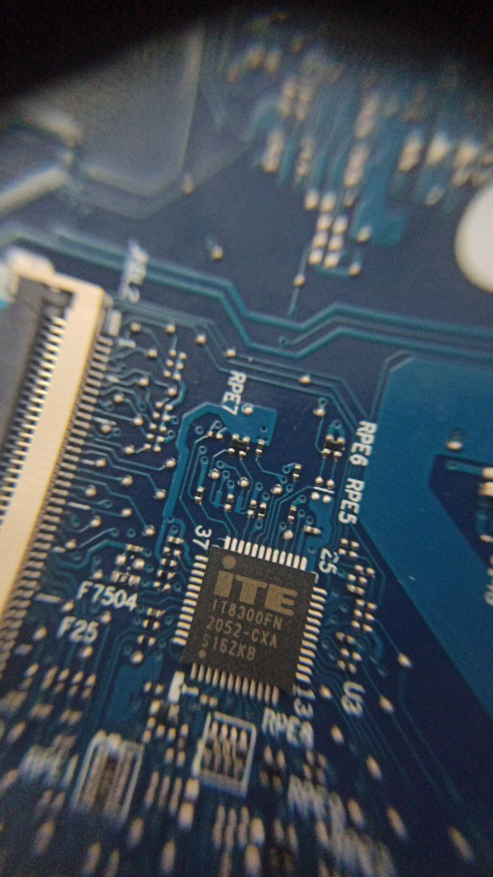

    More detailed pictures of EC:
    Datasheet for ITE / IT8512E, I can't find for 8300:
    Any help is welcome .

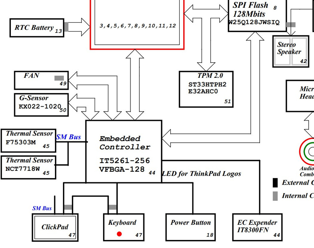

        AFAIK, IT8300FN is not programmable. The other ITE(BGA) is programmable.

            So, where is the password stored then, on the other chip? Do you have datasheet of the other chip with pinouts?
