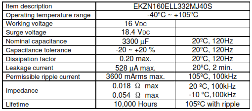

                            #153
                            Re: 3300uF low-ESR caps suitable to PSUs in D10mm - may be possible!!
                            NCC can do KZN 3000 uF/16 V in D10x35 mm, I've asked for 40 mm as it is still OK in most PSU's.
                            I also got the D10x20 mm KYA caps.
                            • Pentium4
                              CapXon Be Gone
                              • Sep 2011
                              • 3741
                              #154
                              3000 or 3300uF? Nice though, KZN has good specs
                              • c_hegge
                                • Sep 2009
                                • 5219
                                #155
                                Would have to be 3300. AFAIK, there's no such thing as a 3000uF rated cap.

                                    #157
                                    Because it is brand new part, that's why they said they only can do 3000 uF capacity. Specs are somewhere between NCC and Digi-Key ATM, waiting for it.
                                    • Behemot
                                      • 4845
                                      • CZ

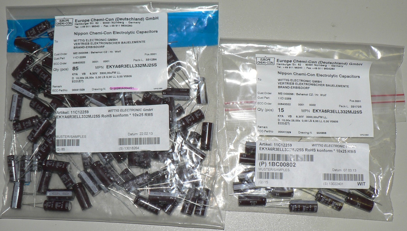

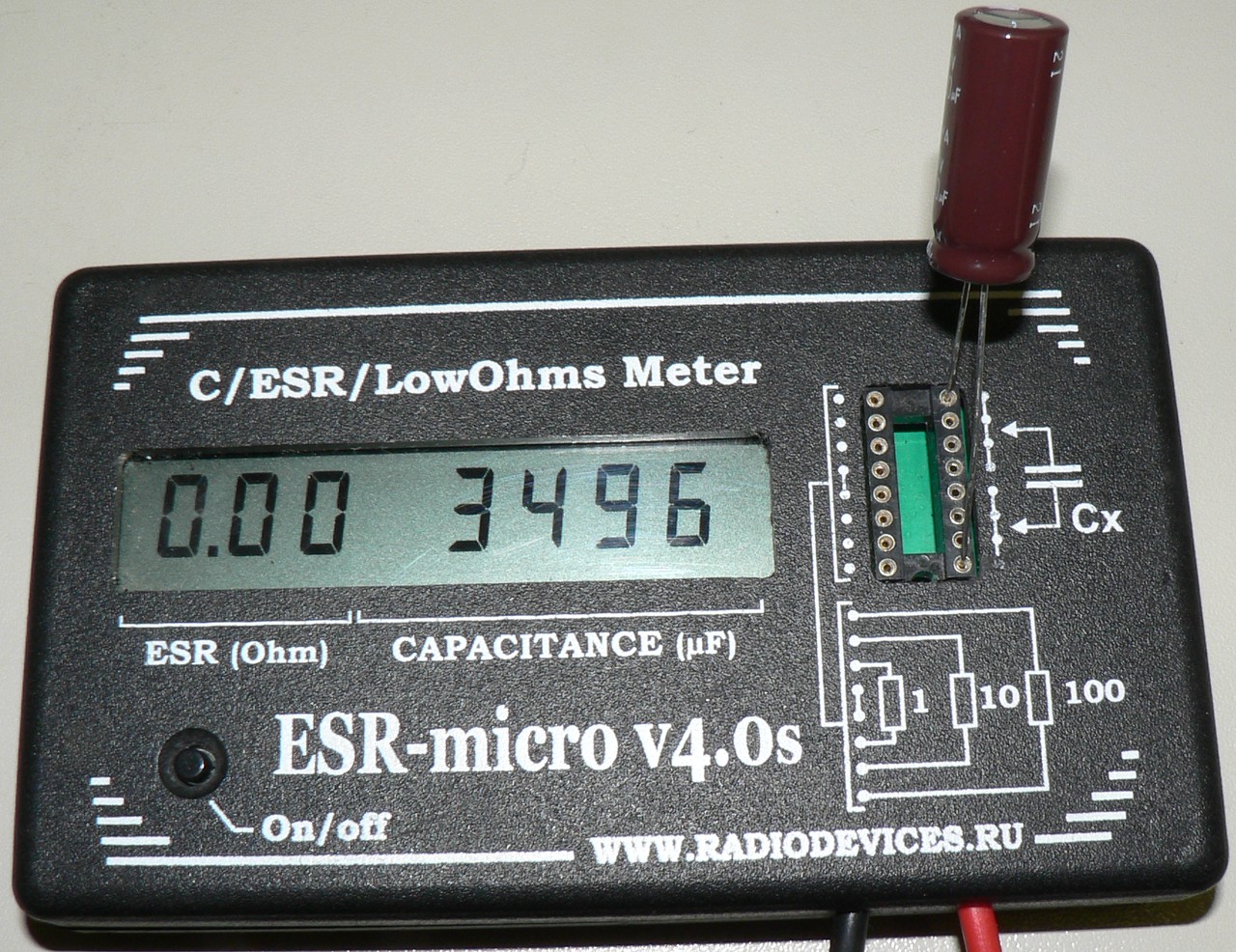

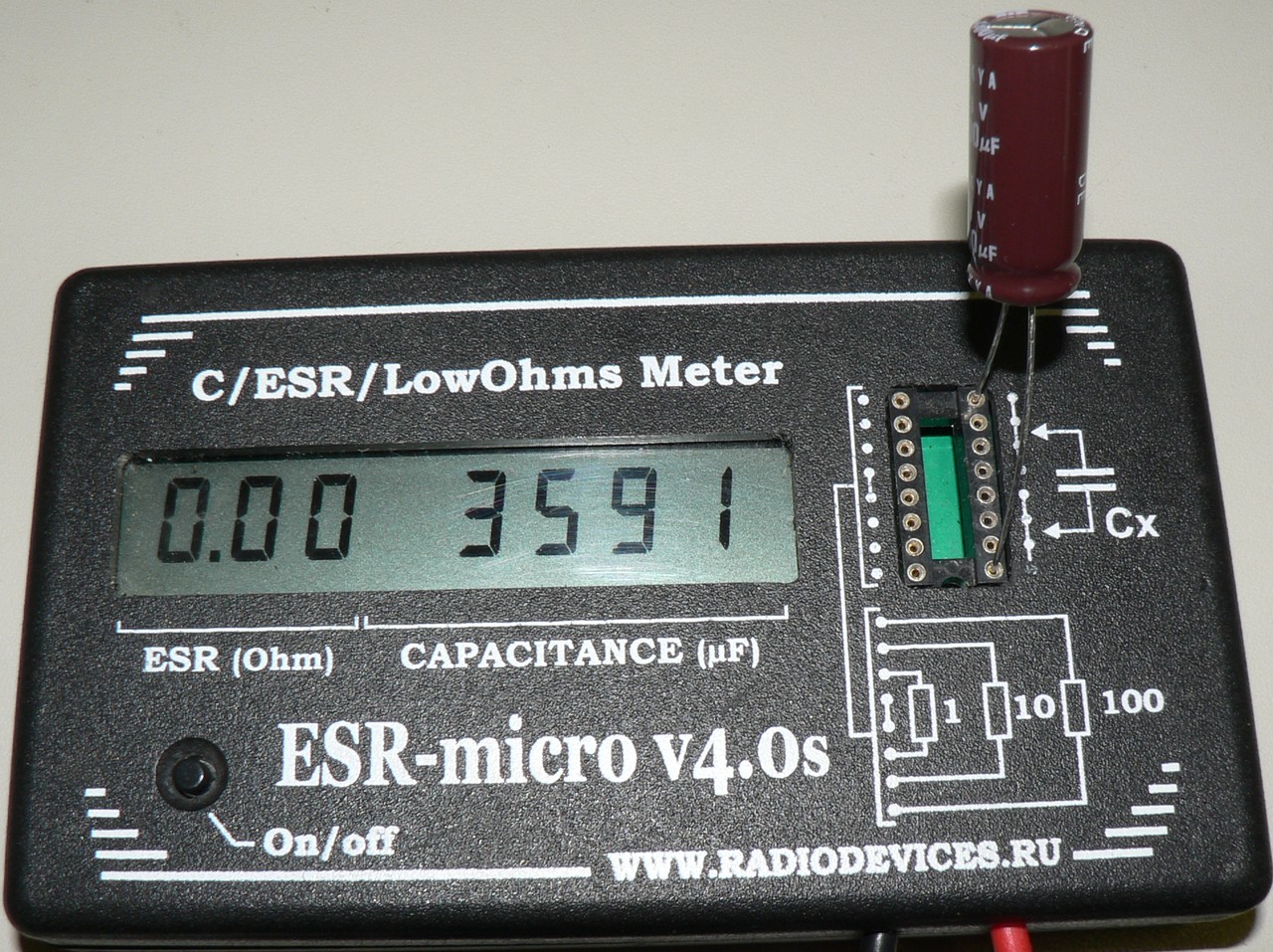

                                      #158
                                      Looky
                                      • mockingbird
                                        • Dec 2008
                                        • 5486
