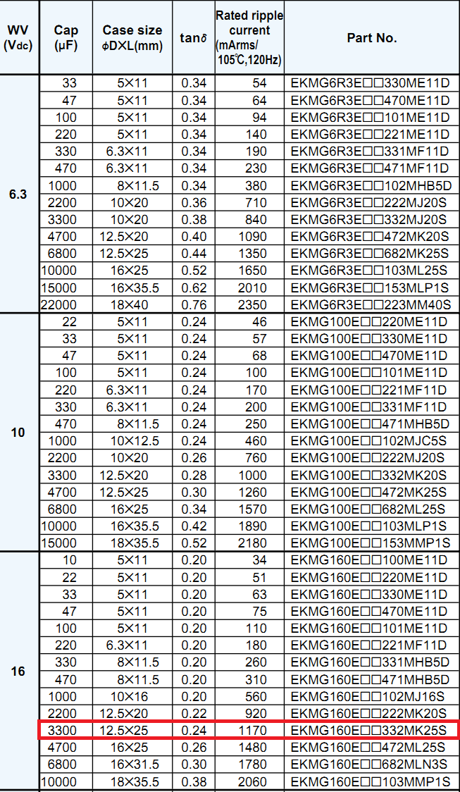

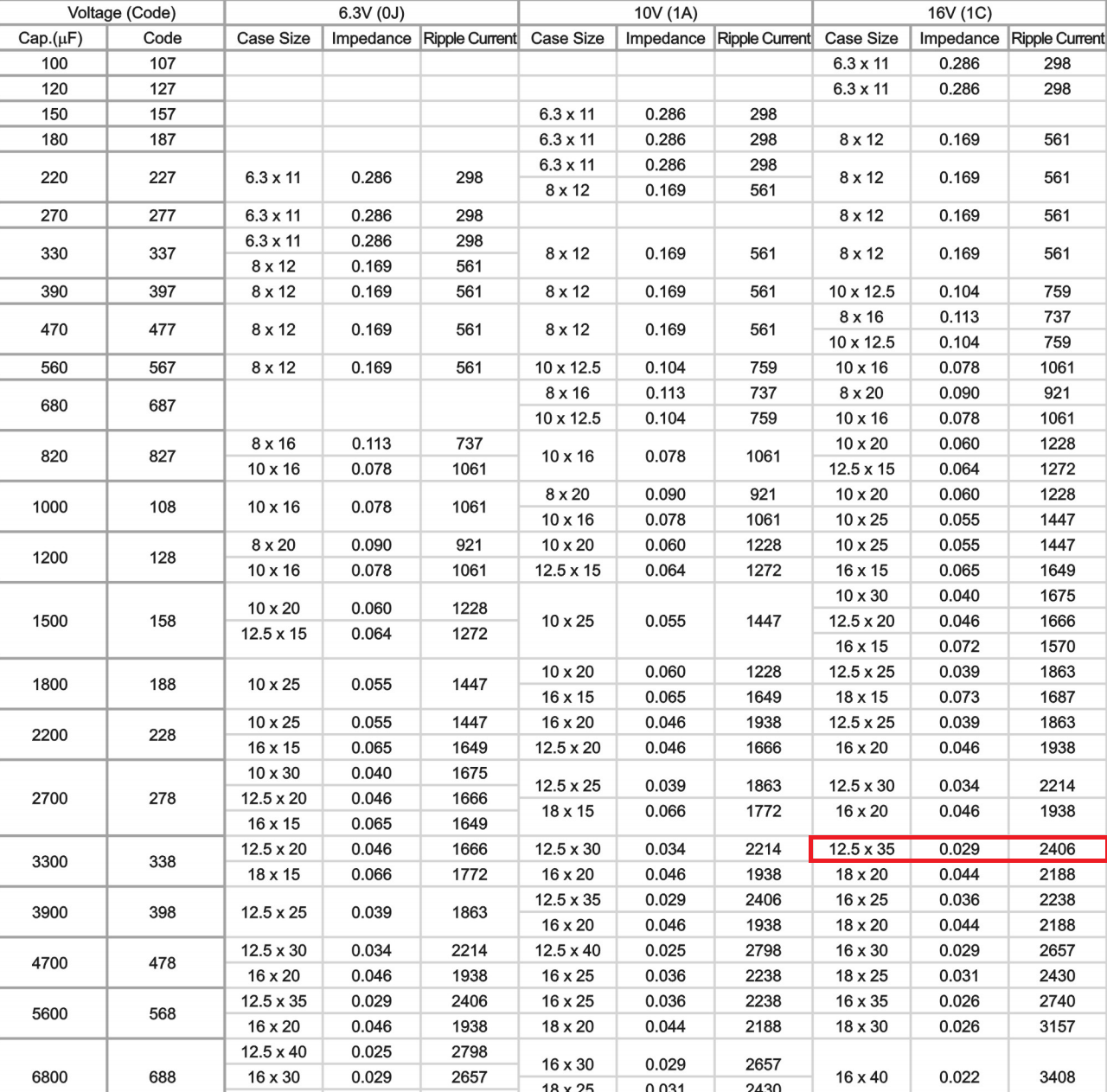

If they'd made them 10x35mm, it would have been ideal. They're a tad underspec'd for my liking. I'm using them right now in a 450W PSU which probably never draws even more than 250w peak and they're fine. But I'd imagine in a hot and heavily loaded PSU, you'd want something a little better. They are a bit puny.
