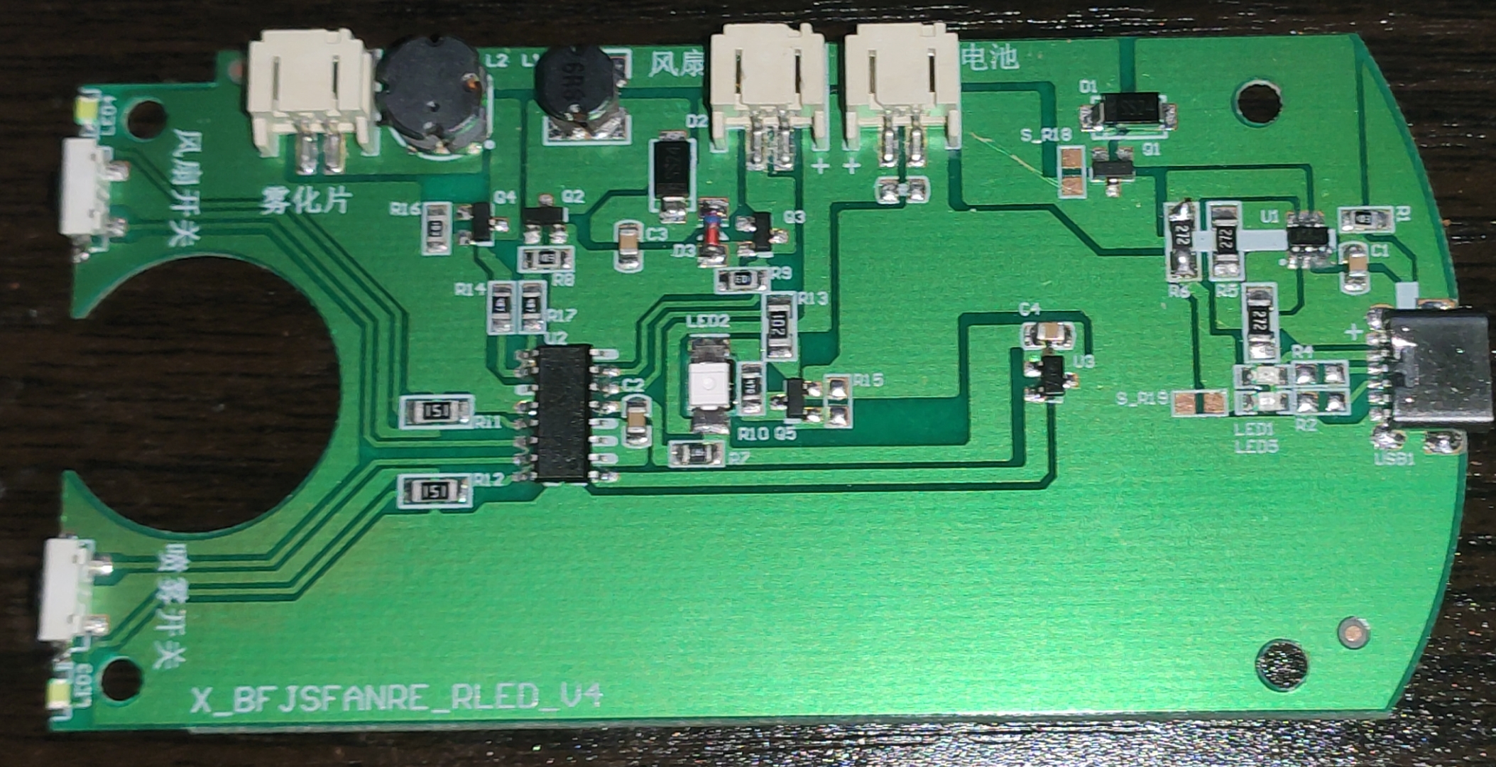

    I am not sure where exactly to put this thread, so hopefully this is the best place.
    I have a USB fan that has suddenly been unable to increase its speed. It's just stuck on the first speed. This fan has 3 speed settings. Each time you press the power button, the speed of the fan should increase.
    The way the button works with each press is: Speed 1 > Speed 2 > Speed 3 > OFF
    Speed 2 and 3 don't currently work any more.
    I suspect the issue might be with what looks to be some kind of driver IC. It is a 16-pin and the fan power switch goes to this IC. The IC has no markings, so I can't find the exact part.
    Does anyone know of a suitable IC replacement that can be bought? I've attached an image of what the IC looks like. If anyone has any advice on how I can check if this IC is definitely the problem, that'll be helpful as well.

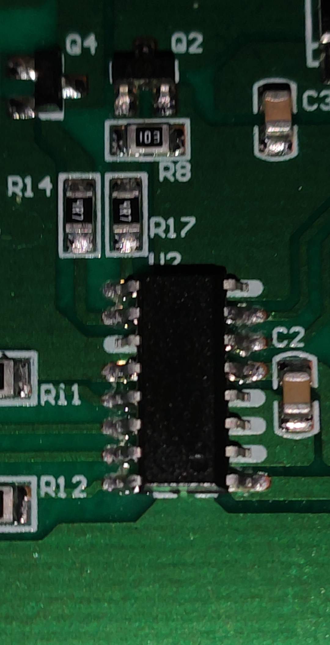

        Weird how the IC has a bunch of pins not soldered and sitting on top of silkscreen. Also, the 4R7 seems low for any pin on a SOIC-16.
        Can you show us pics of the whole board.

          Re: Suitable replacement IC?
          Originally posted by stj
          does the button still turn the fan on and off?
          Yup. The button still performs those functions as normal. It just no longer increases the fan speed when I continue to press the fan button.
          What should happen is I press the button and the fan comes on (speed 1). If I wanted to increase its speed, I press the button again. This should cause the fan to speed up (speed 2). If I press it again, the fan will enter speed 3 (highest speed). If I press the button one last time, the fan turns off (as it should).
          Right now when I try to initiate speed 2 and 3, the fan does not speed up. The final press still turns off the fan as normal.
          @sam,
          There doesn't seem to be any markings on the IC. It's blank.
          @red,
          I've attached a pic of the whole PCB. The other switch on the PCB is for another function I haven't used. It's for some "water mist spray"
          https://flyingtiger.com/en-gb/produc...-light-3048154
          That's a link to what the fan actually looks like.
            Could the USB IC be responsible for the speed control issues? There is a 6-legged IC near the USB port. There's also some LEDs nearby. One is green and another is red. The green LED looks to be for when everything is OK and working. I've seen the green LED shining when I used the fan before.
            When the fan is plugged into a power source and the fan is off (not spinning), I notice the red LED is faintly flickering red. I don't know if this is normal behaviour. When I turn the fan on, the red LED goes solid red. The green LED is still on as well.
            The markings on the USB IC look to be "LPS BMCH1". I could not find anything about this from a Google search.
            I did find this https://www.mouser.co.uk/ProductDeta...ym3GprBA%3D%3D which looks like it could be an IC like this. On the datasheet, it mentions a FAULT pin. Could the IC be detecting a fault of some kind and that's causing issues with the speed control?

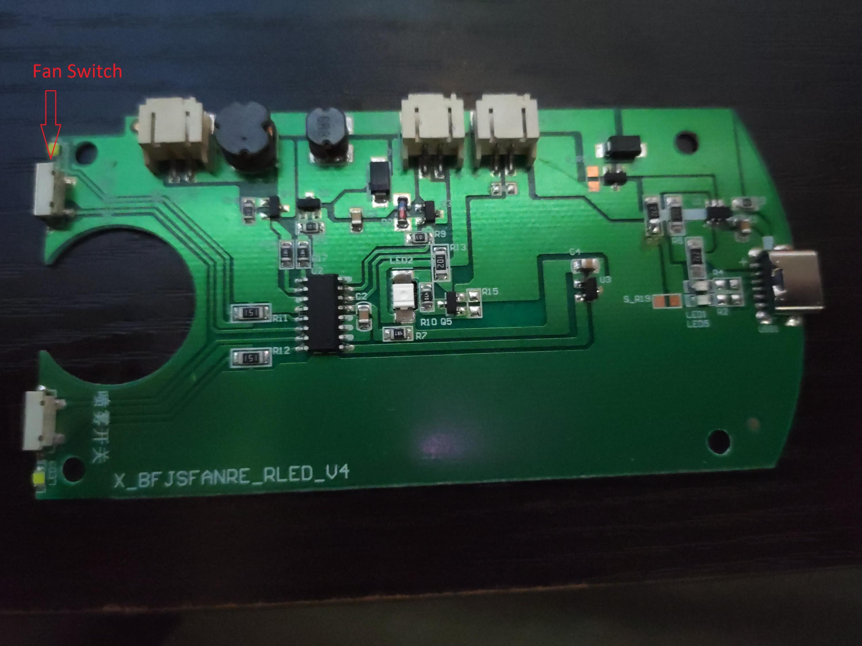

              Which connector is going to the fan ?
              The IC near the USB port will be a voltage regulator. The black IC will be a cheap microcontroller. The fan speed will be controlled by a PWM signal. If you have a scope you can monitor the driving signal to one of the small transistors.

                Re: Suitable replacement IC? .PCB - X_BFJSFANRE_RLED_V4
                The middle connector is the one for the fan. I don't have a scope unfortunately.
                I did check the pins on that microcontroller IC and the upper pin on the left side of the IC has voltage that changes with the button presses.
                On the first press (speed 1), the pin reads 1V. The 2nd press (speed 2) reads 1.4V and the 3rd (speed 3) reads 1.8V. I don't know if these values are good/normal, but this does tell me that something is happening. I followed the voltage to Q2. It's on the left pin. The lone pin at the top has 4.74V.
                The voltage at the fan button is around 4.14V. This does not change. If I hold the button down, it reads 0V, but otherwise it just stays at around 4.1V.
                Another thing I find odd is the behaviour of the red LED (It's the top one in the LED1/LED5 area). It's flickering red when the cable is connected, with the fan switched off. When I measure the voltage on the fan button, the red LED goes solid red. It also goes solid red when I turn the fan on normally.
                I don't know what the supposed function of the red LED is, but I can only assume it's not for anything good. There's already an LED for power (it's green), so the red must come on when something is wrong.
                  check all transistors, diodes and caps for shorts.
                  the chip obviously works,
                  it's probably using one transistor to vary the voltage to the motor and another to just turn it on and off.
                  the part with 5 or 6 pins is the usb charging chip,
                  too bad about those missing resistors R2 and R4, i suspect they are to activate intelligent usb powersupplies.
                    • 31111
                    btw, the picture is not clear enough to read the markings on the transistors,
                    but those inductors make me wonder if atleast one of those "transistors" is actually some type of voltage regulator.
                      I've attached another pic of the PCB. Hopefully you can see the markings on the board more clearly. If not, I'll try to take another.
