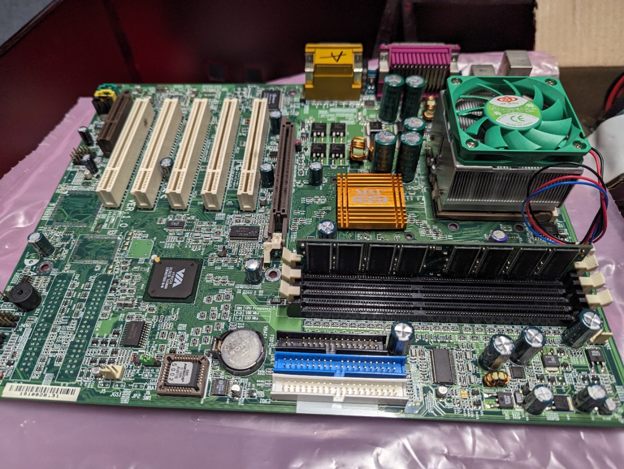

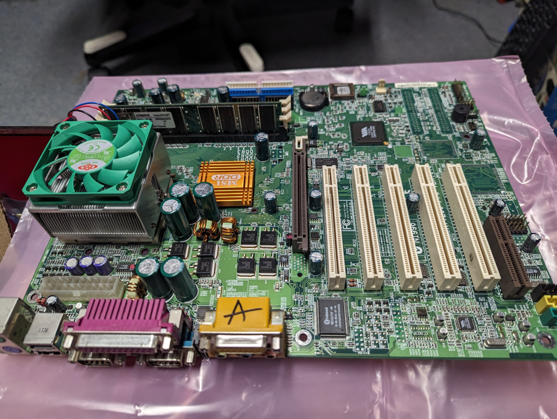

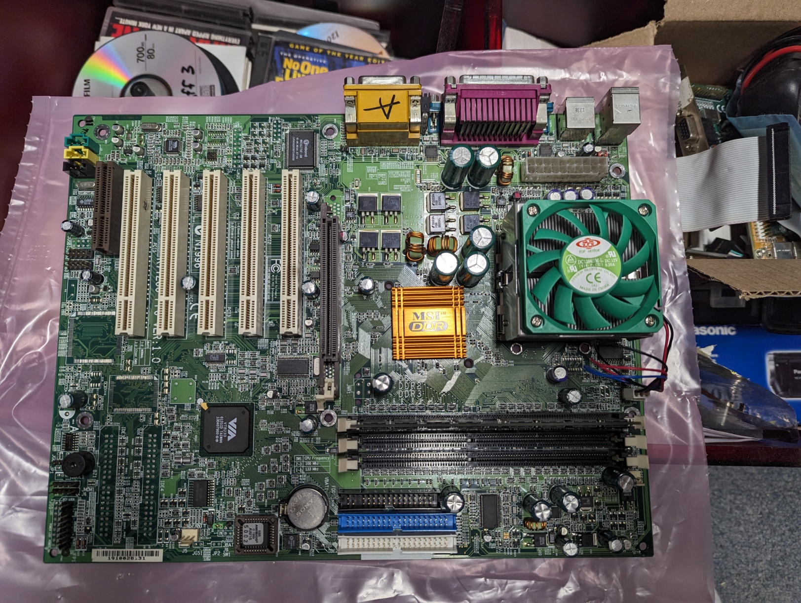

        Here's some pictures of the board. You can see a few of the smaller no name 6.3v 1000uF caps are bulgy. but the slightly larger 1500uf caps are no names as well and they currently look okay, but I'd like to change them.
        The large chemi-con kze 4700uF caps all look okay on both boards and unless someone tells me there's an issue with those from that era I'm not really inclined to replace them
        As stated, I have some Rubicon YXS series 6.3v 1000uF caps I can use for the small guys where a few are bulging. enough to replace all on both boards and then some. I don't have anything to measure esr or anything off existing caps which is why I'm hoping someone more knowledgeable can verify. But even if i had something to measure them

              The Chemicon KZE caps can stay - these are pretty good stable series.
              The Sanyo OSCON caps are polymers and likely will never have any issues for the lifetime of the board's use.
              Tayeh and Chhsi need to go for sure.
              By the looks of it from the pictures of this board, two of the KZE filter the 5V rail for the CPU VRM, while the other three KZE and the Sanyo OSCON filter the CPU V_core. Everything else appears to use linear regulators on the board, so no need to care too much about ESR.
              The Chemicon KY caps you have should be fine to use for the 10V 1000 uF caps, provided height is not an issue, as KY is a little taller. If height is an issue, Rubycon ZLQ 6.3V 1200 or ZLH 6.3V 820 uF will work fine too - at least these tend to be the cheaper low-ESR caps right now in USA (and maybe whole North America.) I use these a lot of all sorts of motherboards. Panasonic FR, FM, and FS are good too. Since ESR is not too important for this particular board when it comes to the 10V 1000 uF and 1500 uF caps, even Nichicon HE will be fine.
              On that note, Nichicon HD is also fine (it has slightly better ESR and RC than HE... though I find HE to be more reliable in high-heat areas.)
              Finally, you mentioned you have Nichicon HM caps in stock. Before you use these anywhere, make sure their date code starts with H06 or higher. H05, I'd say is marginal (usually OK for the 16V and higher voltage parts, but might not be for the 6.3V and 10V parts.) H01-H04 should be avoided from the HM & HN series - these are known to have problems. Another one to avoid is Sanyo WF series.
              *EDIT*
              The Nichicon PLG 10V 820 uF caps from the first link (PLG1A821MDO1TD) will likely be OK to use for both the 1000 uF and 1500 uF caps... but at over $2.50 a cap, I don't see a reason to go with these, especially considering the board uses linear regulators throughout (except the CPU VRM) so it won't care. In fact, linear regulators on some old hardware might not like ultra-low ESR polymers as much... but that's super-rare. As for the 6.3V 1500 uF Panasonic caps from the 2nd link - again, those would also be fine for both the 1000 uF and 1500 uF caps if you have more of them. I know going from 1000 uF to 1500 seems a bit too much, but IME most boards don't care. Manufacturers don't do it simply because it costs more and is not really needed. I tend to do it when I'm out of specific size/capacitance caps (very often) and just want to test the hardware or get it fixed quickly.
