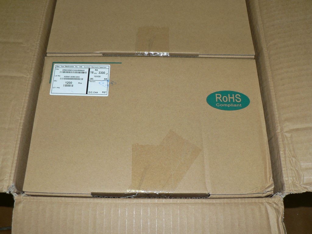

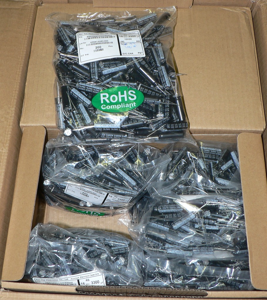

                  Here it is. Final price is to be set at 5,2 CZK a piece for those who have been willing to had a piece of the initiall shipping. Please PM me regarding payment and shipping if you are still interested.
                  For anybody else, the price is as follows:
                  CZK 10,4 (< 10 pcs), CZK 9,88 (>= 10 pcs), CZK 9,10 (>=30 pcs), CZK 7,28 (>=100 pcs).
