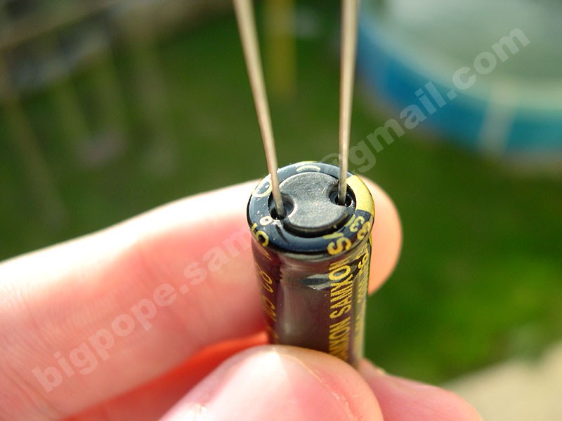

    I finally (damn Topcat had them far sooner, damn customs and slow post in my side ) finally got these caps to test them out. So, let's check the first testing batch of very likely best electrolyte caps in the world:
    [/URL]

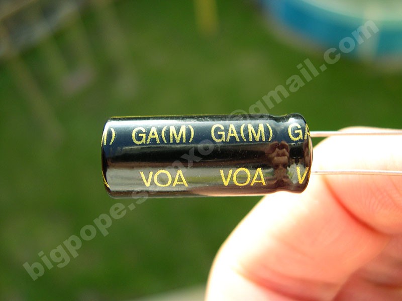

    Different font used...
    [/URL]

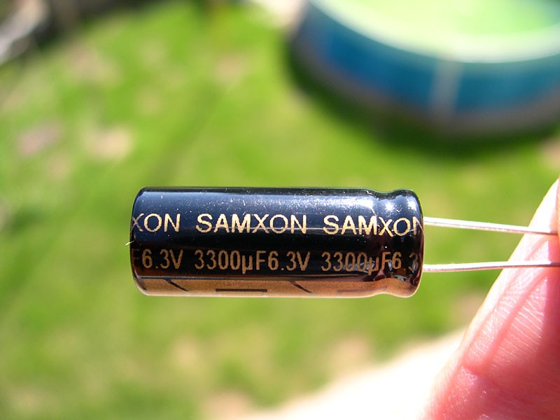

    And yes, it IS a GA
    [/URL]

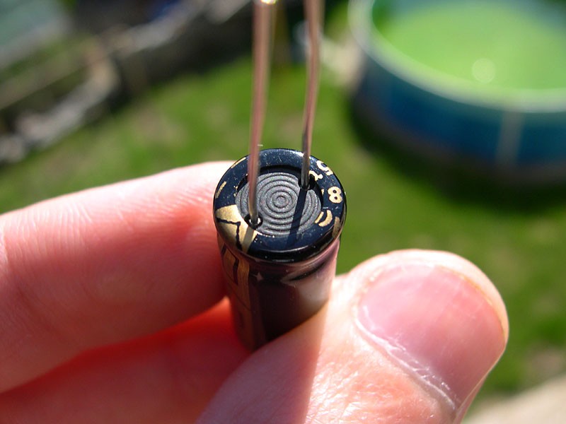

    Typical bottom of testing production series

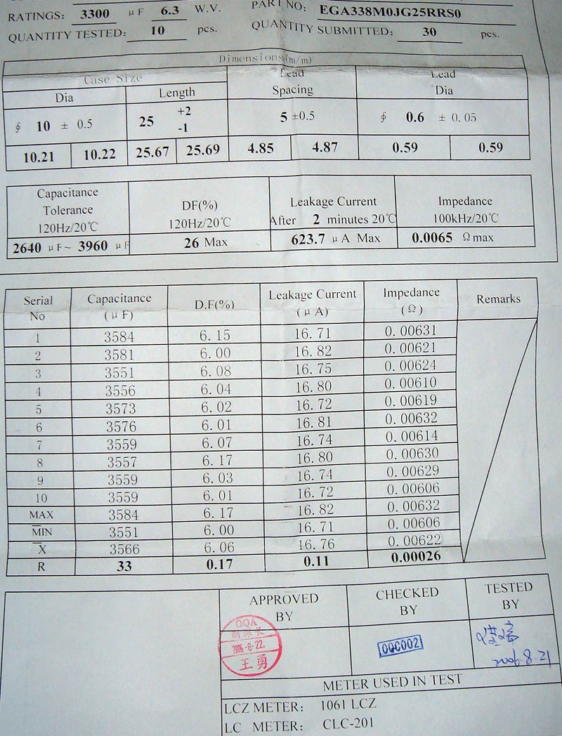

    They are ATM only 30 of them in the whole world, but if they turn out to be good, then they will start mass production. And one gotta admit that the Nichicon HZ line got owned, look, the best of these has just 6.06 miliohms! Ooooh!
    [/URL]
    Now let's see how much do they degrade in time - if more that other hi-end caps brands types, even only the HZ line come close to THAT

        the bung is different from the GC and GD i have. i recall gsc, teapo, and ost have the same bung
        samxon please use another type/model of bung
        days are so short when you actually do something..
        • trodas
          • Jan 2006
          • 770
          • Czech republic
          Re: Samxon GA
          From my experience, these bottom seals (bungs) are used for low-series production at Samxon. These d10 2200uF 16V Samxons GD have them as well - and no other caps from Samxon have them and since I did made some pictures for list of the Samxons for Big Pope, I have now a reasonably big pile of Samxons
          The "public" GA ones in mass productions will have normal bungs taht Samxon, Panasonic, Rubycon, Nichicon and others using

            Re: Samxon GA

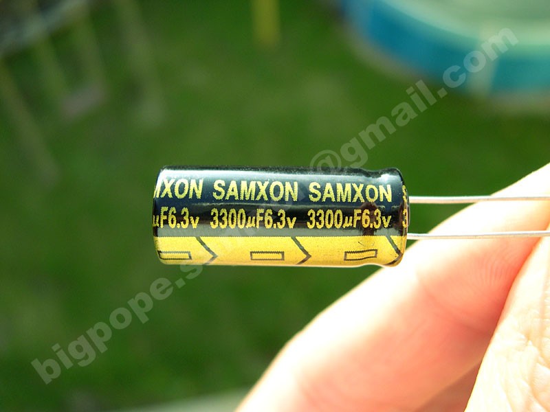

            And the final production line of GA caps are there

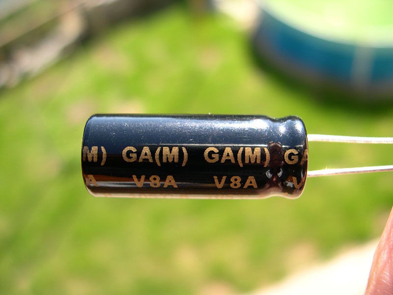

            As you can see, font get back to Samxons normal:
            [/URL]
            From both sides
            [/URL]
            And exactly as I said before, the testing rubber sealings are standard now:
            And so far, I can't complain - if they won't work excelently, I will not be able to type these text

                      But what is a bung, and does it make a difference?
                      • gonzo0815
                        • Feb 2006
                        • 1600
                        Re: Samxon GA
                        A bunge is the rubber seal at the bottom of the caps. It probably dosen`t mather, but it is a distinguishing mark to identify counterfeit byond other marks.
                        • willawake
                          Super Modulator
                          • Nov 2003
                          • 8457
                          • Greece
                          Re: Samxon GA
                          that is correct, what matters is that it is made from EPT or similar material which will not degrade and shrink with age. what design or colour it is does not really matter.
