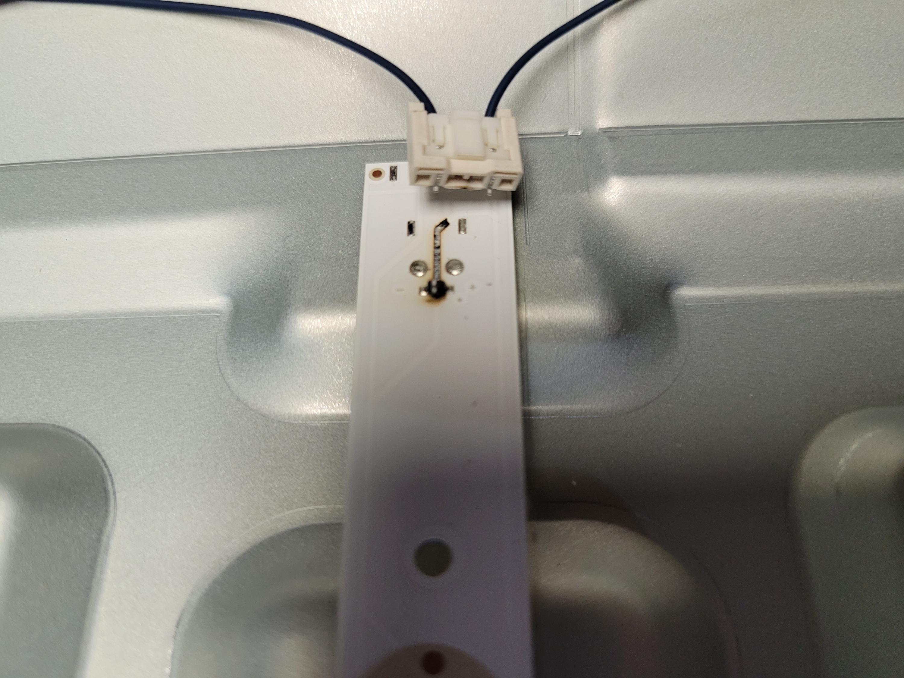

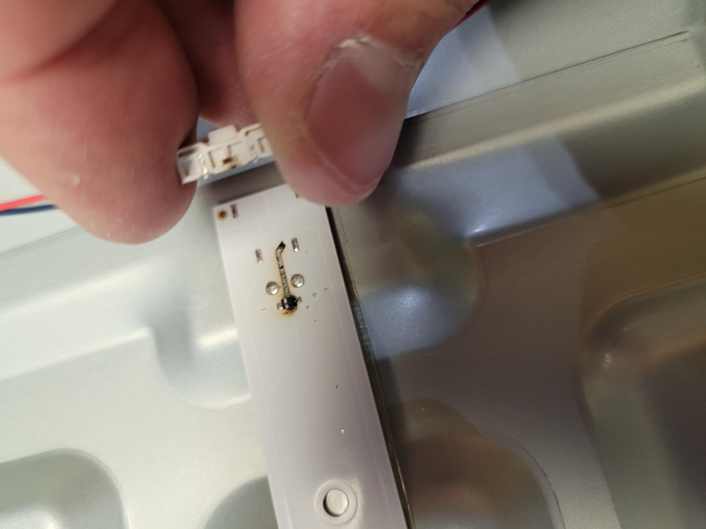

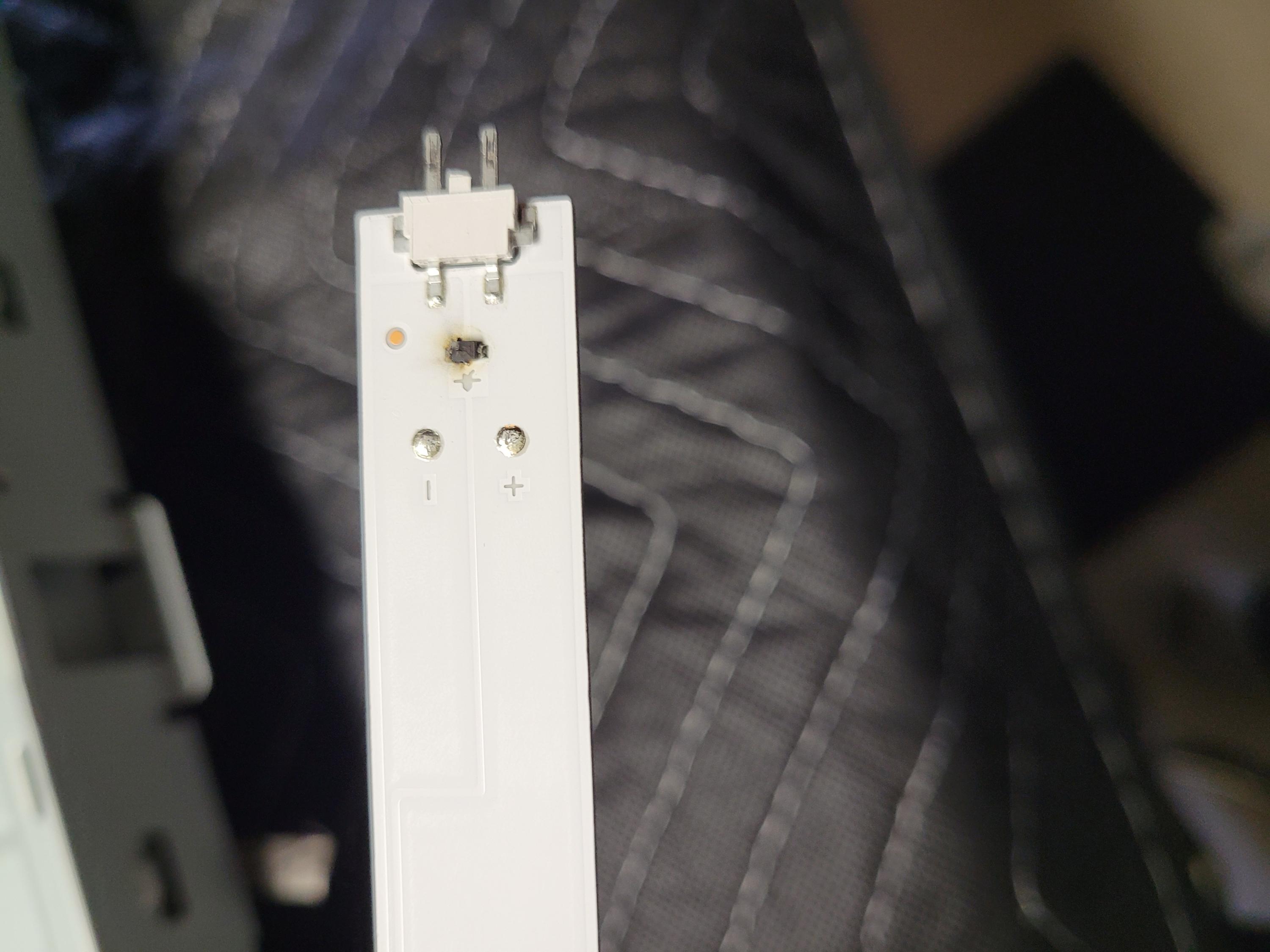

                  Ordered some LED's from shop Jimmy. Got the TV torn apart today and think I found the culprit as you can see in the photo. I will update once I get the parts and get it put back together.

                    Re: LG 55UJ6300 Very Dim
                    On that model the LEDs turn blue as well. Best to replace them all with the TV apart.
                                  I found the culprit after tearing the TV back apart. Now I need to get the parts warrantied by shop jimmy.
                                    did you test the new leds before installing them? is that burnout in the exact same place as the original fault?
                                    • dhoff024
                                      • Mar 2013
                                      • 96
                                      I did not test the new ones before installing. This burnout is not in the same spot.
