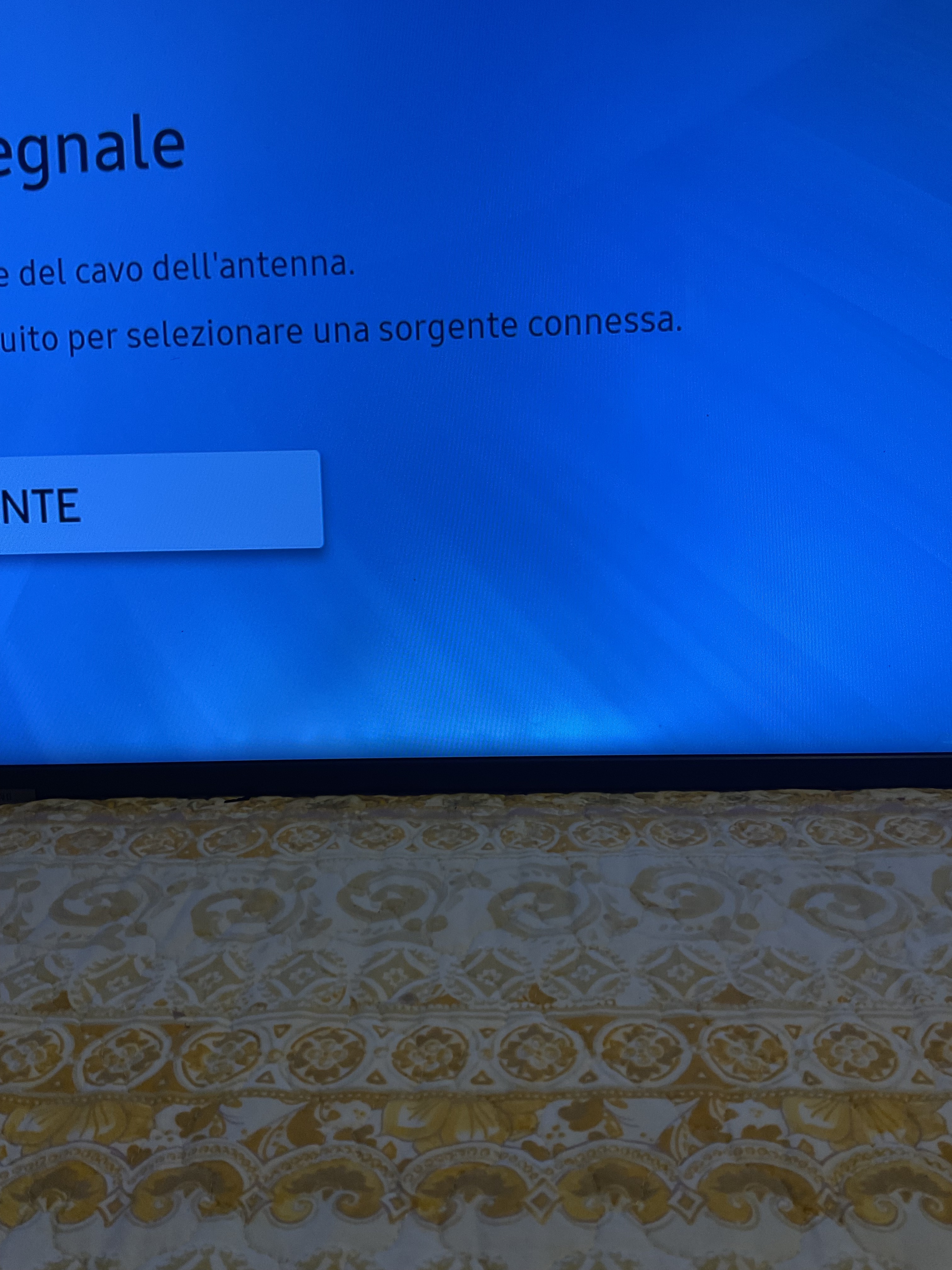

    Hi guys, I changed my backlight to a 5g in Samsung but the broken leds burned the thick plastic panel . I give the photo. Do you think if I try to rotate the panel, with the botton on the top I have a good image? Becacause now how u can see, on the light color I sse the leds because of the burned on the plastic diffuser.

    It's not possible. You'll have very bright light downstairs and very dark upstairs.
    Another diffuser.

      thanks yokoono...so i dont have solution, thanks for your answer

        You can replace it with another broken TV diffuser. Needs to be edgelit though otherwise no solution. Yes cannot rotate it. Cracked screen TV usually works

          thanks, im trying to find but i dont find the same model...my mode is ru7105 i find MU KU but i think it s not the same...with ru but different number...can you say me what model have the same diffusor panel if you know....

            Maybe try a tv repair shop, they may have saved one they can sell you. If you find one make sure you keep the backlights set to 60 percent or less to avoid melting the new sheet. Have seen some more resistant sheets for sale on aliexpress but who knows exactly which one you would need. Might be pricey too haven't looked in a while.

              Likely MU or KU will work. Just needs to be edgelit. I know MU is edgelit in america, KU also might be but I can't remember NU will also work. AU8000 would probably work also. Although the diffuser is slightly thinner on that model.

                thanks to everybody i ll try to find
