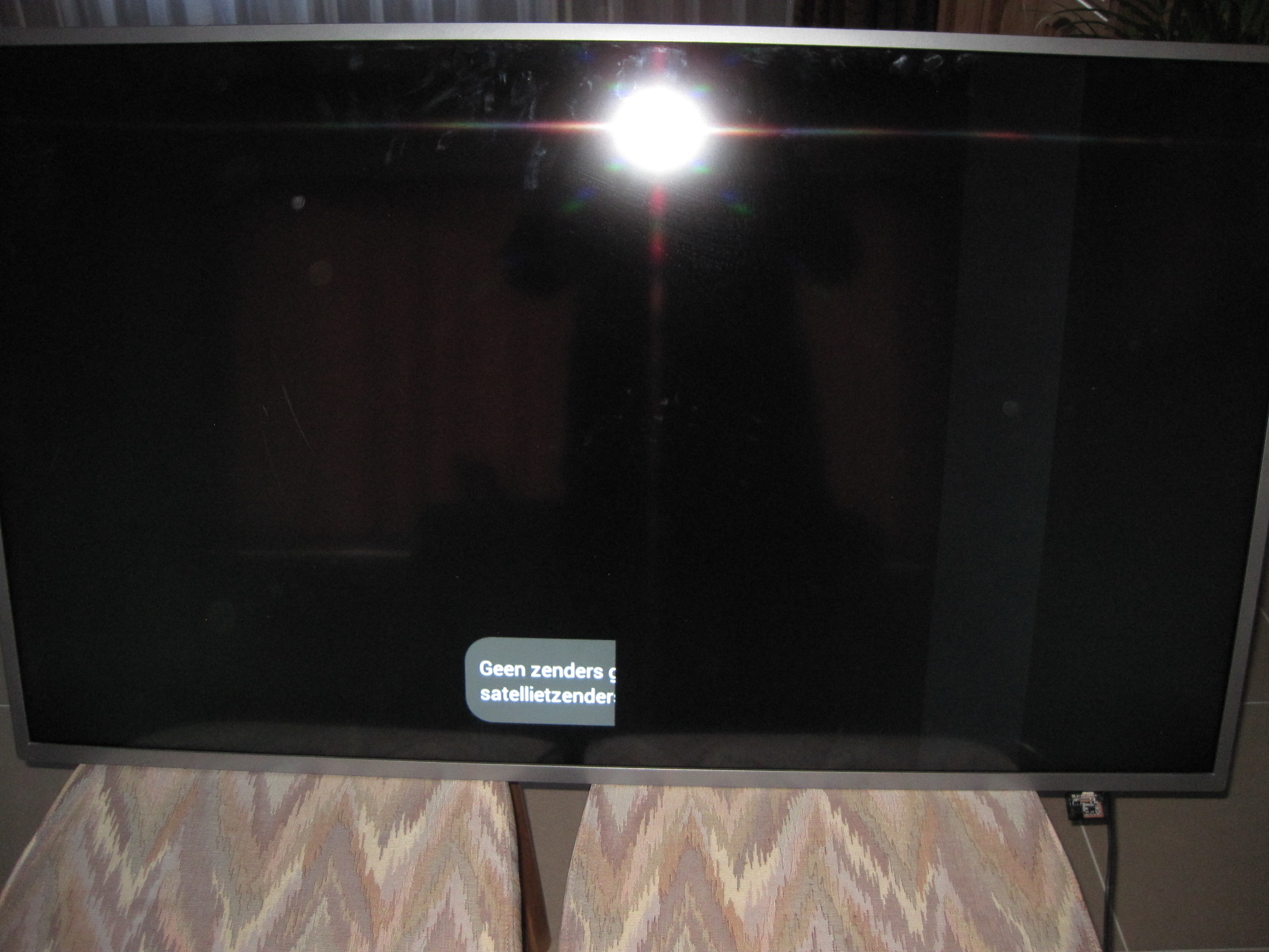

    Philips 50PUS6262/12 (chassis TMP17.7E LA) no picture

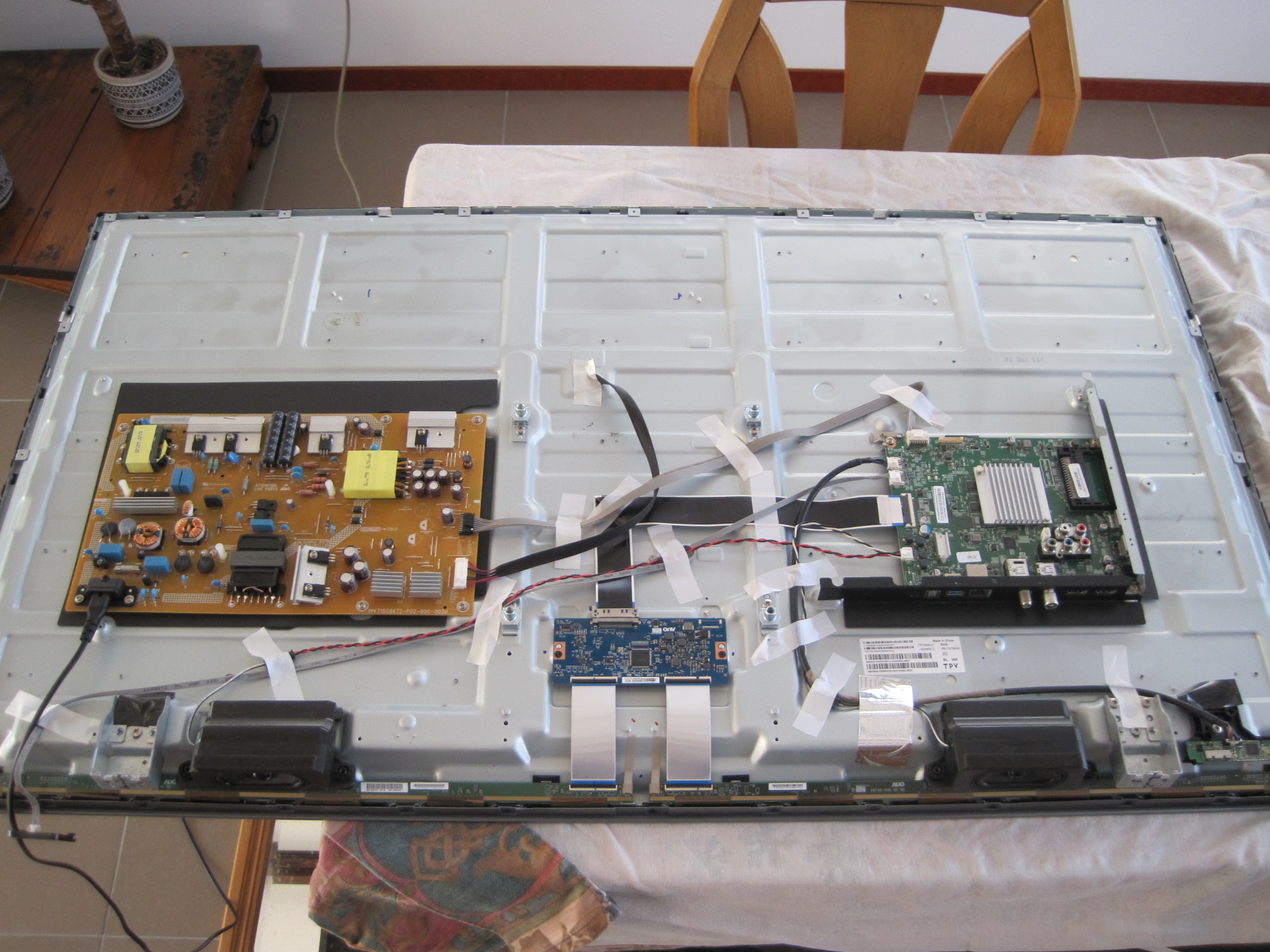

    This is my first post on this forum, and my first attempted repair of a modern flat-screen LCD-TV (though I have repaired a few LCD-monitors, all with Elco-problems (high ESR). I have repaired my fair share of TV-sets and VCRs in the past ('90s) and was fairly familiar with the different Philips chassis (KT-3M, K12, K2, K3, K7 are some that come to mind). So I have a fair bit of experience on old sets. Obviously, modern TV sets are quite a different cup of tea.... no HOT or flyback-transformer inside, for starters....
    The set came into my possession by accident, for parts. ('you dabble in electronics, perhaps parts from this TV will be of use to you', was the comment.) I have no further information on prior history or problems with the set.
    The TV is a Philips 50PUS6262/12 (chassis TMP17.7E LA), judging from the date codes on the ICs it was produced in 2017. I have found the service manual for this set on this forum https://www.badcaps.net/forum/attach...2&d=1622724712.

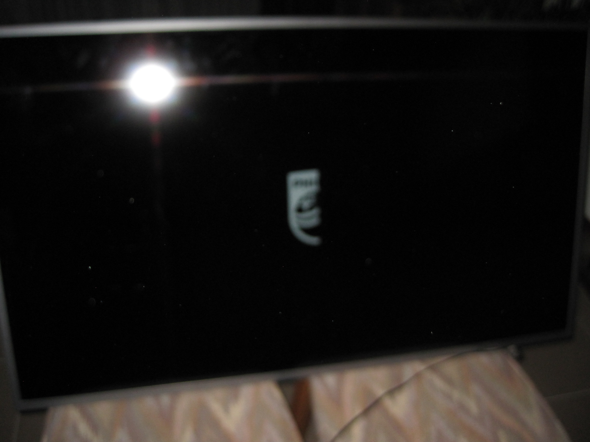

    The TV-set responds to turning on by remote-control: backlight turns on, red standby light goes out. However, nothing appears on the screen. (fully black, with backlight shining 'through').
    The decorative LEDs (Ambiance lights) in the back of the TV turn on and respond to the remote-control.
    When turning off, the backlight goes out and the red stand-by LED turns on, as should be. Ambiance LED-lights turn off a few seconds later.

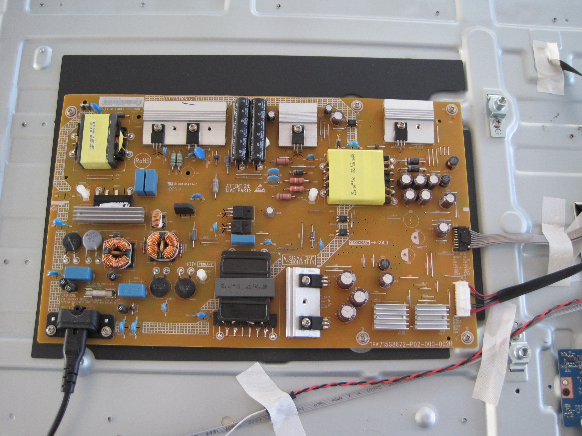

    All voltages on the Power Supply board measure ok (apart from a missing 3.5V, which seems to be normal for this set, according to other posts in this forum).
    I have not checked the elco's for ESR; none appear bulged (not a guarantee, I know) and all the voltages check out ok. I will however check ESR and report back.

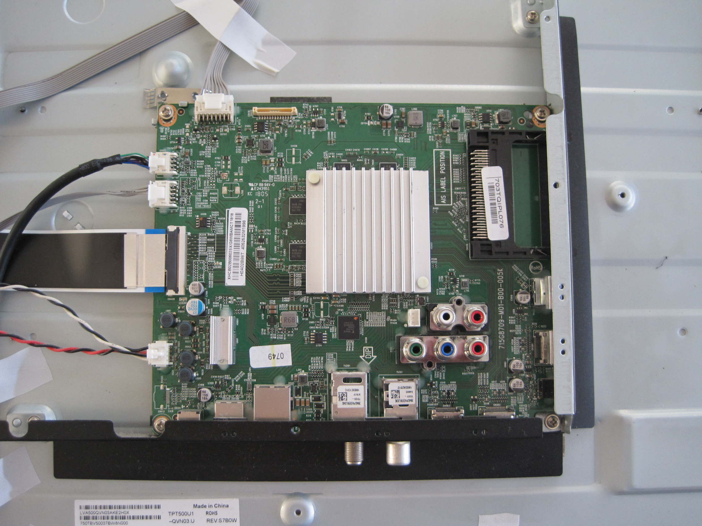

    The two green LEDs on the computerboard/mainboard do light up constantly. I assume this is normal/expected behaviour.
    - just about all mounting screws (from both powersupply board and mainboard) were rather loose. I tightened these, hoping a bad ground was the issue. I didn't notice any different behaviour from the TV set after this.
    - When I was fiddling about with the boards (bending, pressing, checking for bad contacts) suddenly a loud bell-sound was heard (old-fashioned doorbell, ring-sound). This startled me a bit. Not sure what's the purpose of that sound. It happened a few times more.

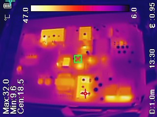

    - Have sprayed copious amounts of freeze-spray on the various boards in an attempt to locate a thermal problem. I did not observe any effects.
    - When disconnecting the cables going to and coming from the 'small board in the lower middle', i.e. the one that interfaces the mainboard/computerboard to the two screenboards, the screen turns entirely white for a fraction of a second.

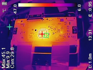

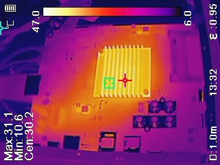

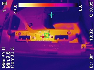

    - When checking with the Thermal Imaging Camera, no obvious faults were spotted. No semiconductors that got very hot or remained very cold. The large heatsink on the mainboard/computerboard got warm, so it appears to be not entirely dead.

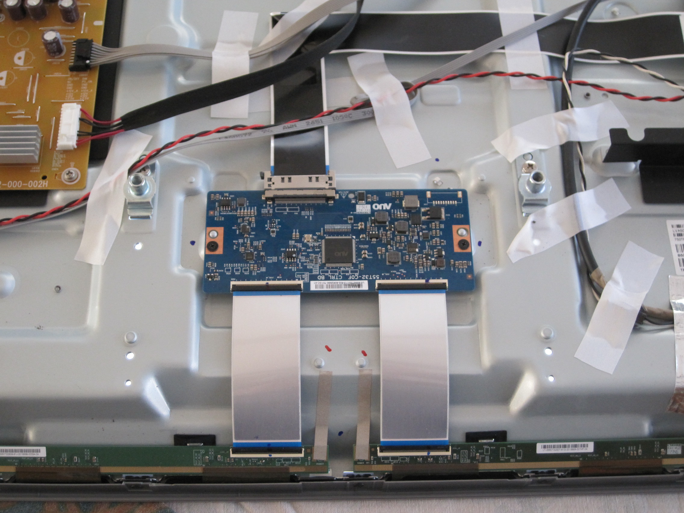

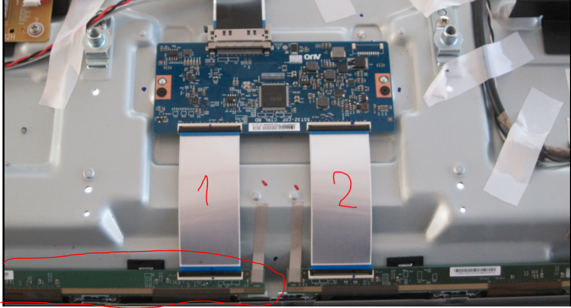

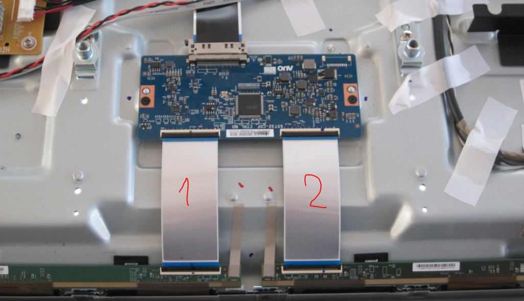

    Disconnect 1 cable on the T-CON board and try to turn it on, then connect 1 cable and disconnect 2 cable and also check if the image is on the screen floor.
    • HP32Sii
      • Feb 2023
      • 8
      • netherlands
      Re: Philips 50PUS6262/12 (chassis TMP17.7E LA) no picture
      Thanks for the speedy reply!
      After disconnecting cable 1 of the T-con board, a picture appeared on the left part of the screen; initially half the Philips-logo, followed later by a half-displayed message at the bottom stating 'Geen zenders [missing text]' (i.e. no stations found) and 'satellietzenders [missing text]'. In the right-half of the screen there does appear a grey vertical column though. See images below.
      Re-connecting cable 1 and disconnecting cable 2, no image appeared, i.e. completely blank screen. No logo, no vertical column, nothing.
      Same completely blank screen when both cable 1 and 2 are connected.
        So the problem is in the left bar or in the panel itself, on the bar I can short-circuit or have low resistance smd ceramic capacitors, check them with a multimeter.
          I have checked the ceramic capacitors on that long & narrow PCB at the bottom of the TV. None had obvious shorts (<30 ohm). Tomorrow I'll test to see if they're perhaps low-resistance (but above 30 ohm).
          I have also tried swapping the two flatcables (that you numbered 1 and 2) to verify that the problem wasn't in the cables themselves. But the set responds identically so the cables are obviously not the problem.
          I fear that if I can't trace the problem to the ceramic capacitors (or resistors or one of the two transistors/fets/?) that my options for repairing this TV are exhausted?
            try the "tape cut-off method" https://www.youtube.com/watch?v=pfrRhw7-ZII
              30 Om is already low resistance, compare with another bar, just turn off the 1st and 2nd loops when measuring.

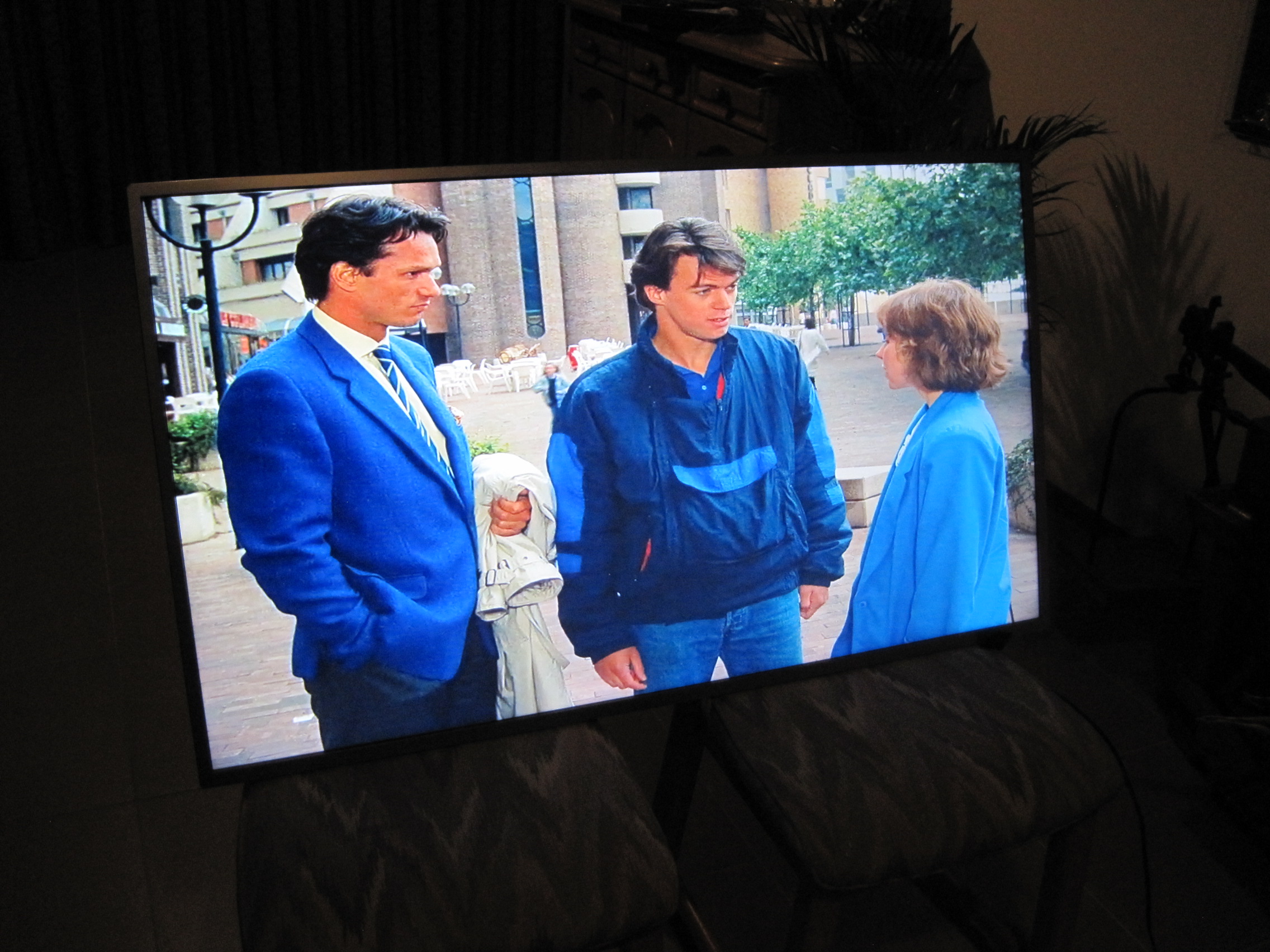

                            Good news: by masking the 8 clock lines in the flatcable to the defective board, picture was restored.
                            I was curious and couldn't wait till tomorrow with the masking-tape trick. Tomorrow I will have to narrow the problem down to the particular bad clock-line, but even as it is now, with 8 masked clock-lines, I could live perfectly fine with the TV.
                            I expect image quality would improve by restoring the 7 non-offending clock lines, which I will do tomorrow, but as said, image quality is perfectly fine for me as it is now.
                            So definitely not finished yet, but the results so far are very encouraging!
                            Thanks for everyone who responded and helped in the troubleshooting, especially Iotas and Nomoresonys!

                                Update: I tried unmasking various clock-lines (CL1 to CL8) in an attempt to isolate the error but the only effect was a worsening image, with sometimes white/grey vertical columns or complete loss of picture.
                                So in the end I decided to stick with simply masking CL1 to 8 and call it a day. The only noticeable effect is a very very slight flickering/change in image intensity every 1.5s or so. Very hard to notice so not a problem for me.
                                Hopefully this thread will prove useful to others with similar problems.
                                Very happy with this TV, it will make a nice addition to the living room. The TV is a bit overkill for me as I haven't watched TV for about 15 years. Let's just say it's better for my bloodpressure....
                                It will only be used to view documentaries and movies from an USB-stick. So most of the functions of this TV will go unused. Which seems a good thing, considering the reviews on the net of this TV. People seem to have a very low regard for this model. Much of it due to slow software and software errors/bugs. I must admit I've encountered one myself already, where, after slightly adjusting volume, the TV kept turning up the volume higher and higher till maximum. When lowering volume, it kept adjusting itself till sound was mute. Unplugging fixed this.
                                Seems a pretty basic function to foul up for the manufacturer. So not surprised about the plethora of complaints about slow and buggy software, as Diah also mentioned. Current firmware version is TPM177E_012.004.070.051; I may try a downgrade.
