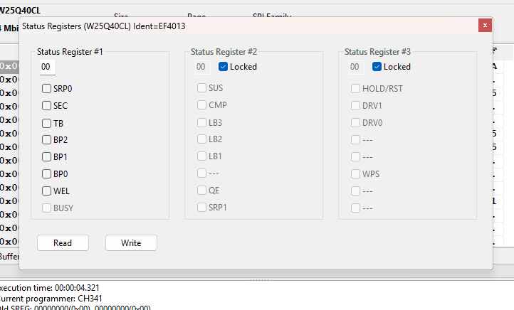

                  Status register for 25Q80 (0x98.0x02).

                          Hi, when I want to write the status registers I don't have the same thing at all as in your image.Click image for larger version
