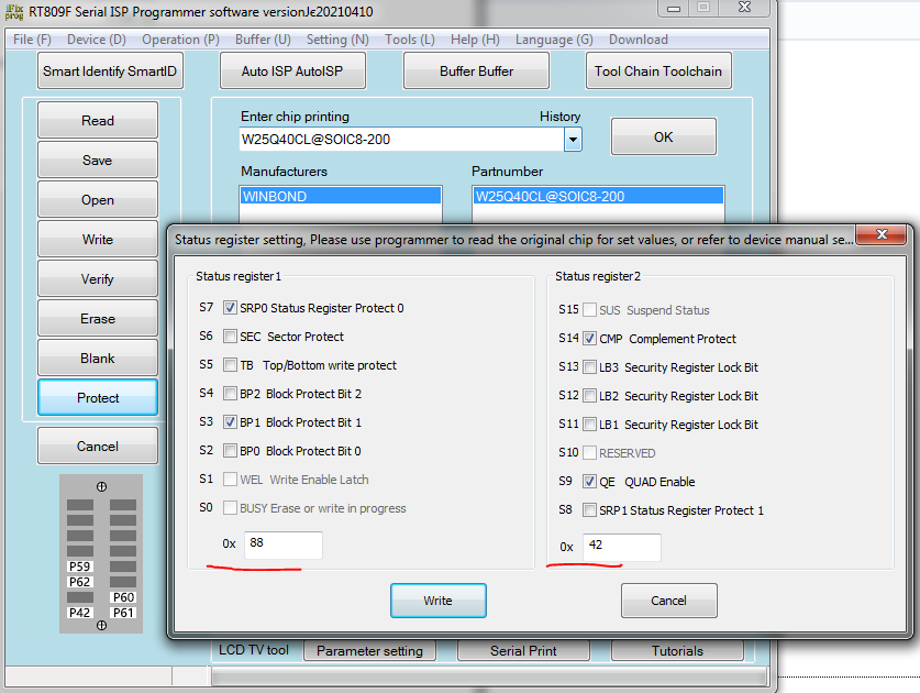

      I have a motherboard from Samsung UE49MU6202, code BN94-12424C and don't have stand-by led active, attached 25Q40 that probably need to be fixed.

            I see that you write in the post:
            In the program:
            1. Click "Detect Chip" and select W25Q40CL and "Select IC".
            2. Click "Unprotect".
            3. Click "Erase IC" and "Yes".
            4. Click "Open File" and select your corrected Dump.
            5. Press "Program IC" and "Yes".
            6. Click "Verify IC".
            7. Press the down arrow to the right of "Unprotect" and select "Edition SREG", put a check mark on S7, S3, S14, S9 and press "Write" and "Yes"
            7. Close the program. Ready.

              On RT809H interface must be set anything in tab Protect when you read W25Q40 ?
              Because i see your info when you have to click to programming IC's...

                    Write down any dump (you need to look with which one it will start, it can start with any) after recording, set S.R. 0x88, 0x42 and hit "write".
                    And it is not clear why you are erasing two microcircuits, what else have you erased? There is one chip 25Q40.

                      I erase two ic's and write each of them with those two versions received, set SR as you recommend you, tested one by one but no stand-by led active...

                        I wrote this instruction for CH341A (AsProgrammer and NeoProgrammer)

                                          lotas modifying are correct , the problem with active STBY LED indicator are HW issue not SW.
