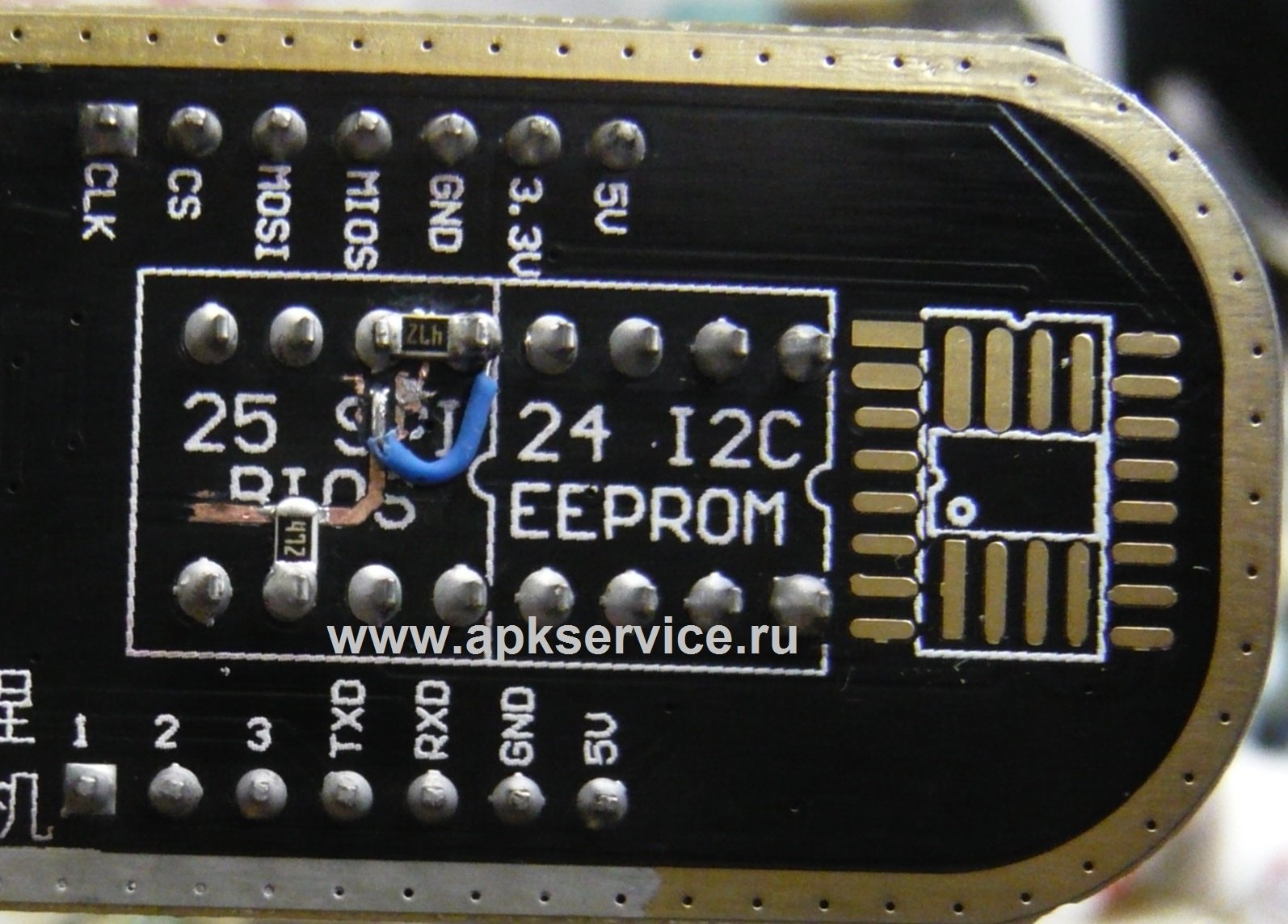

    Re: Un50mu6070 Mainboard issue

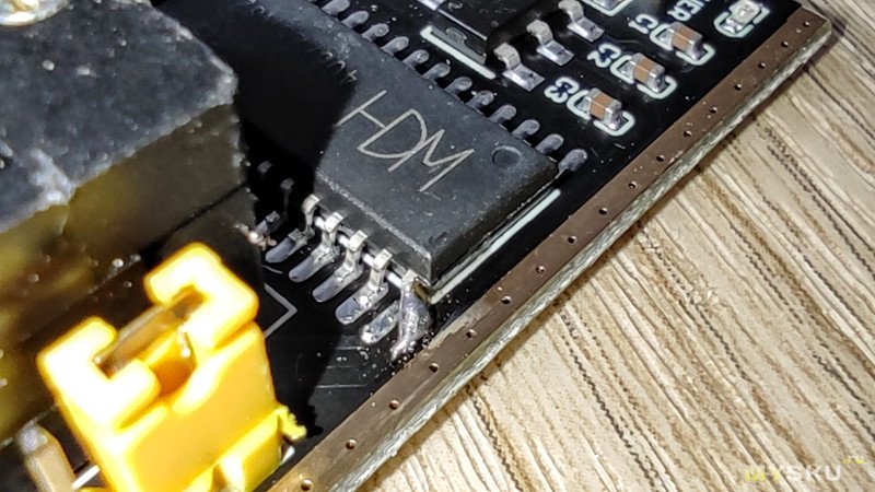

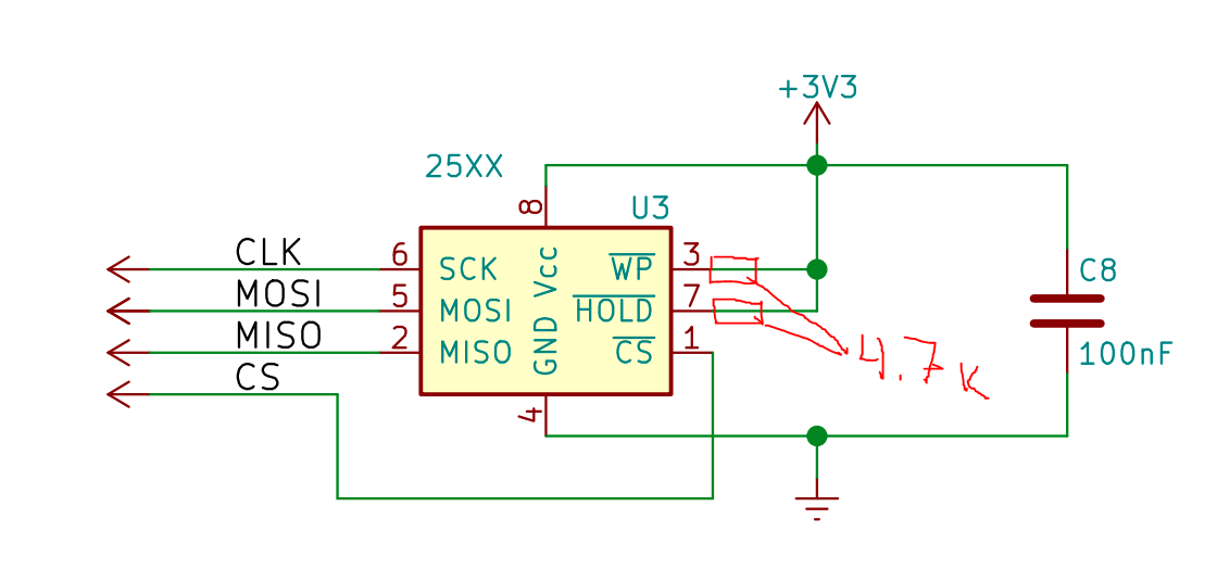

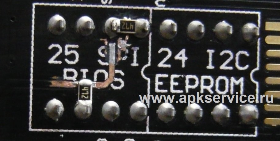

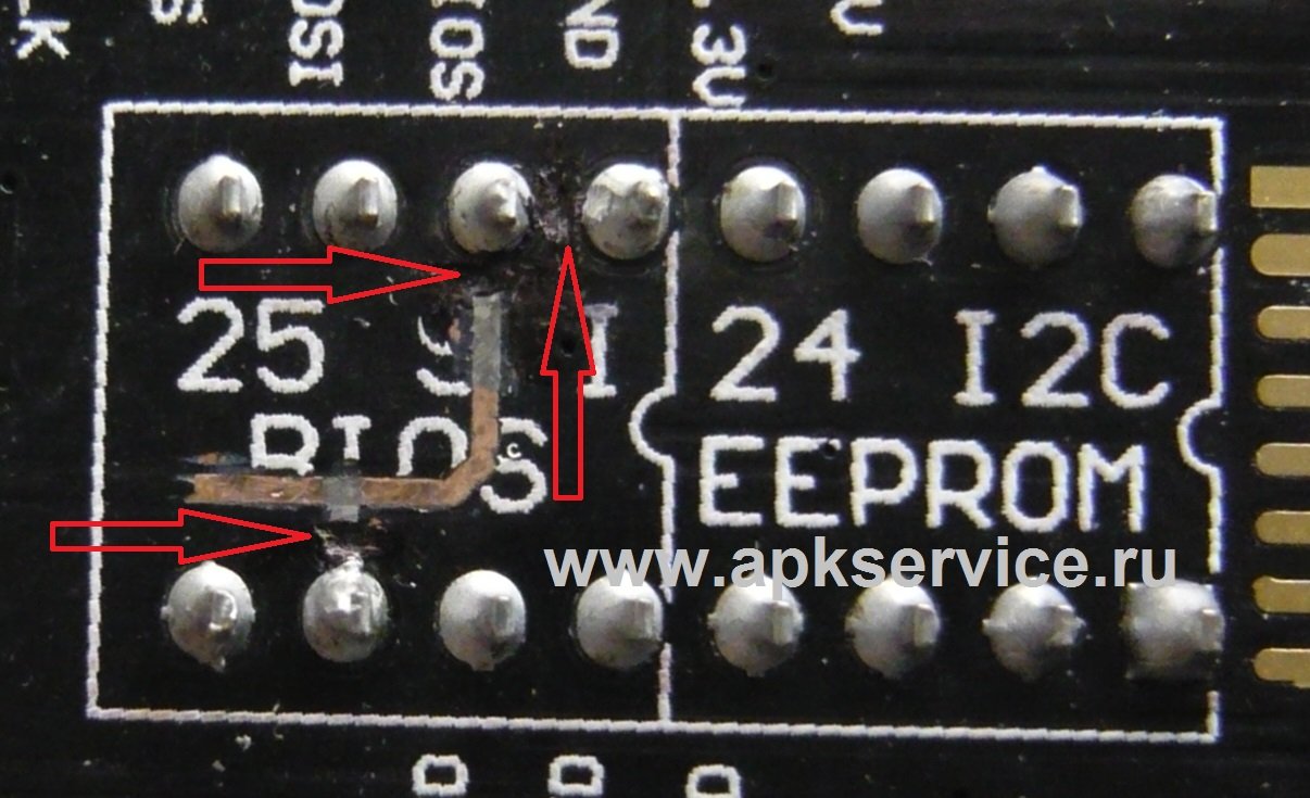

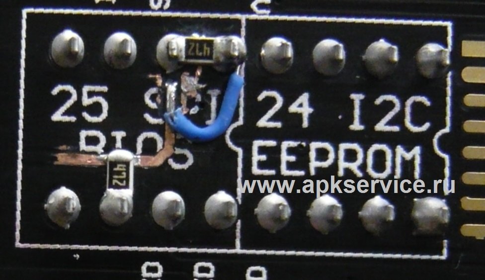

    1. Cut the tracks in three places
    2. We solder the 4.7k resistors into place
    3. We restore the VCC circuit (8 pin power) using a jumper
    4. As a result, it should look something like this
    • lotas
      • Jan 2016
      • 4451
      • Russia
      #42
      And also the cost of powering the matching lines of the chip of the programmer itself from 5v to 3.3v.
            Is this modification required only for the register problem?
              Will the programmer work fine for other chips as well? I mostly do eeproms 24CXX and 25QXX at home,also for reading and programming radios that require ISP connections.
              Yes, everything else will work as well.

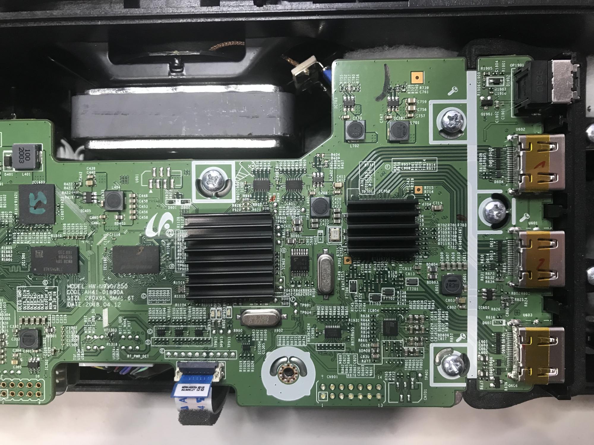

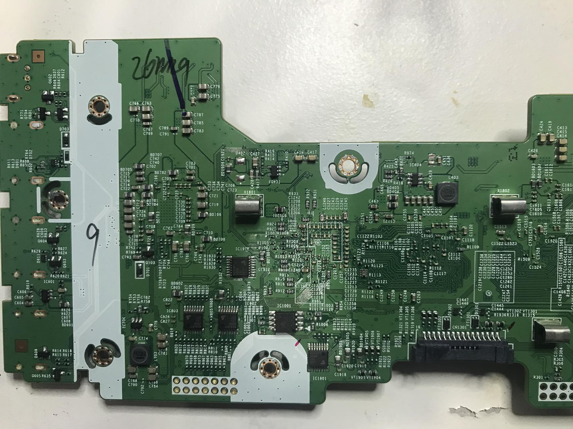

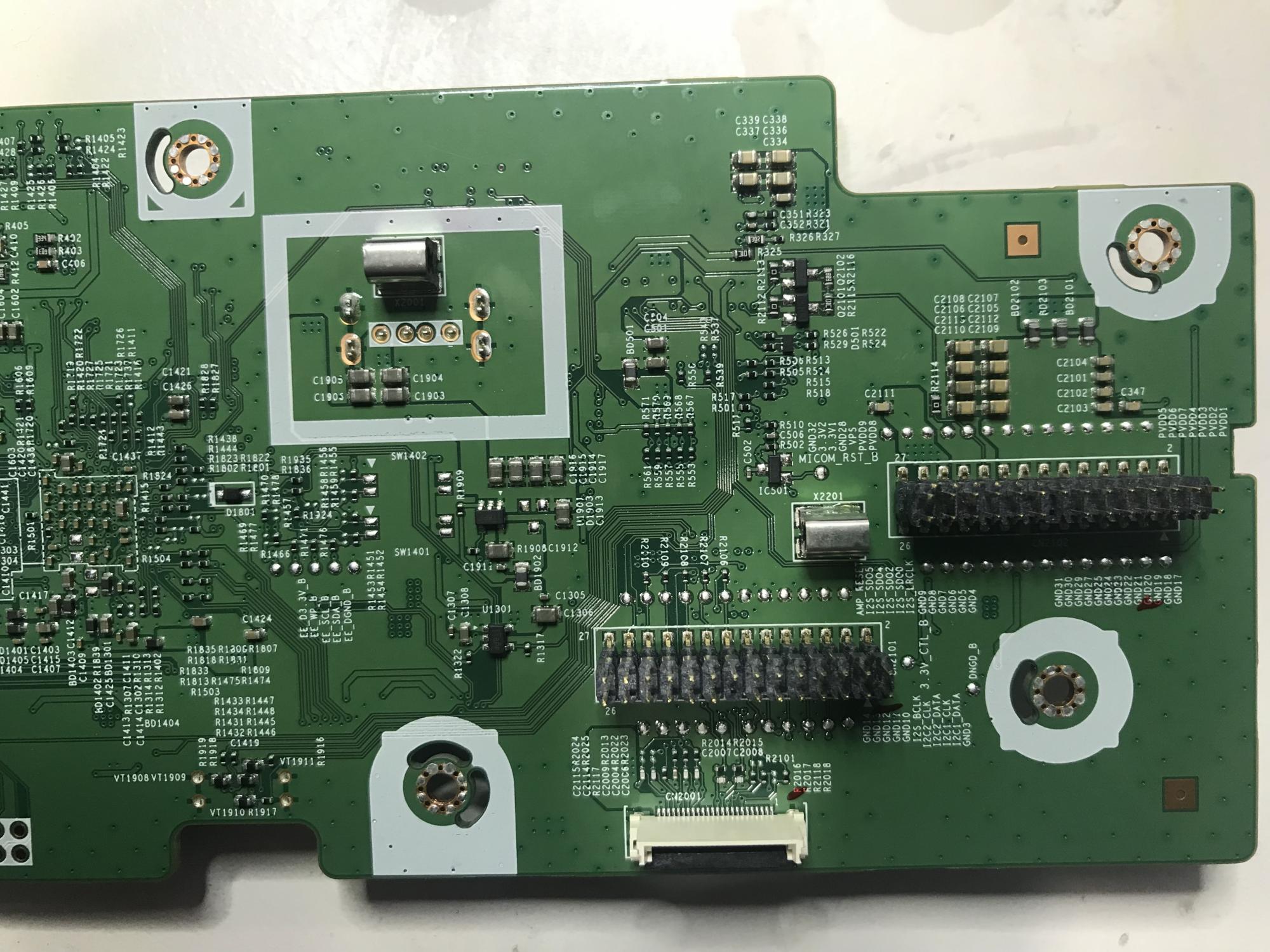

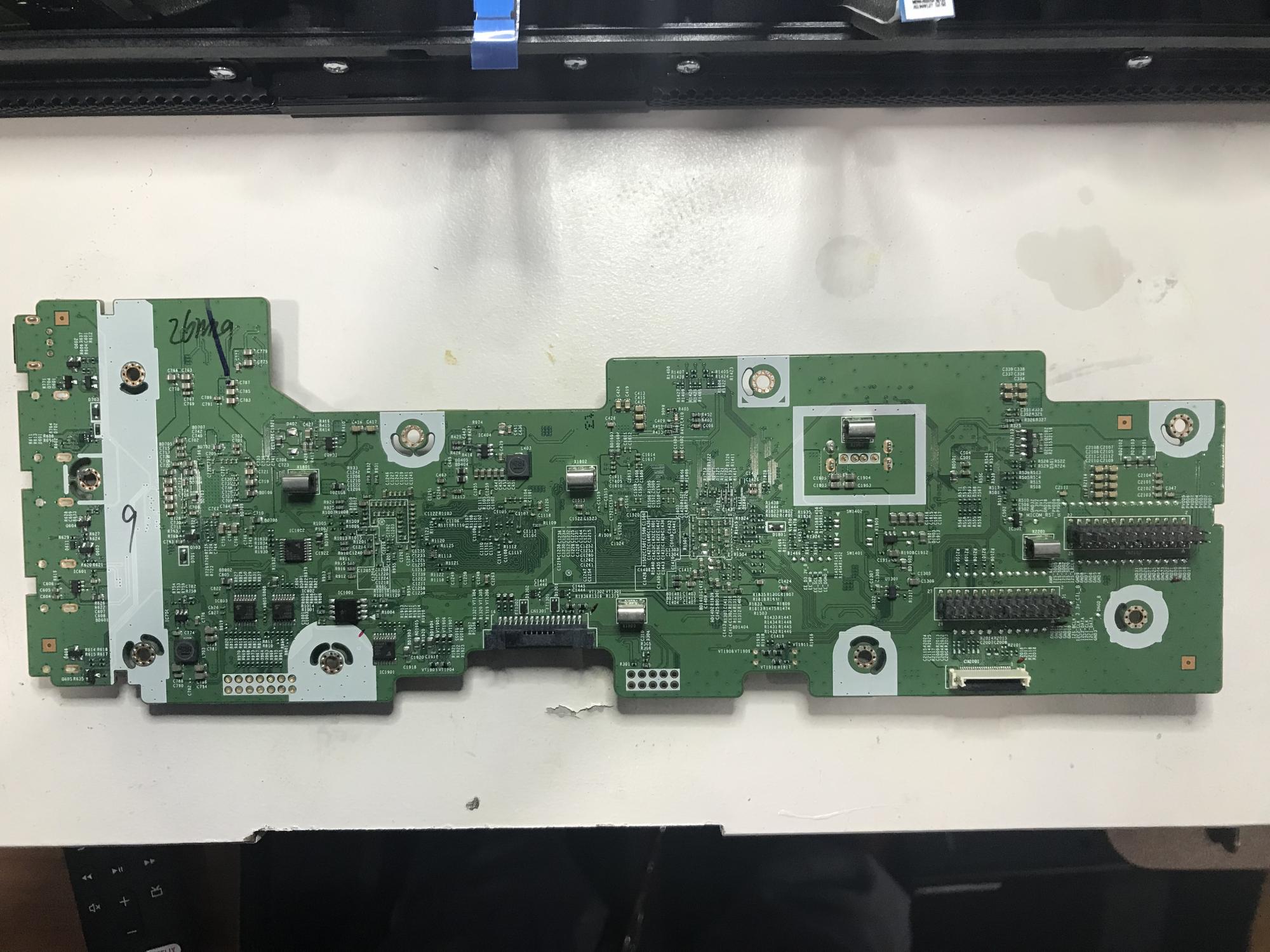

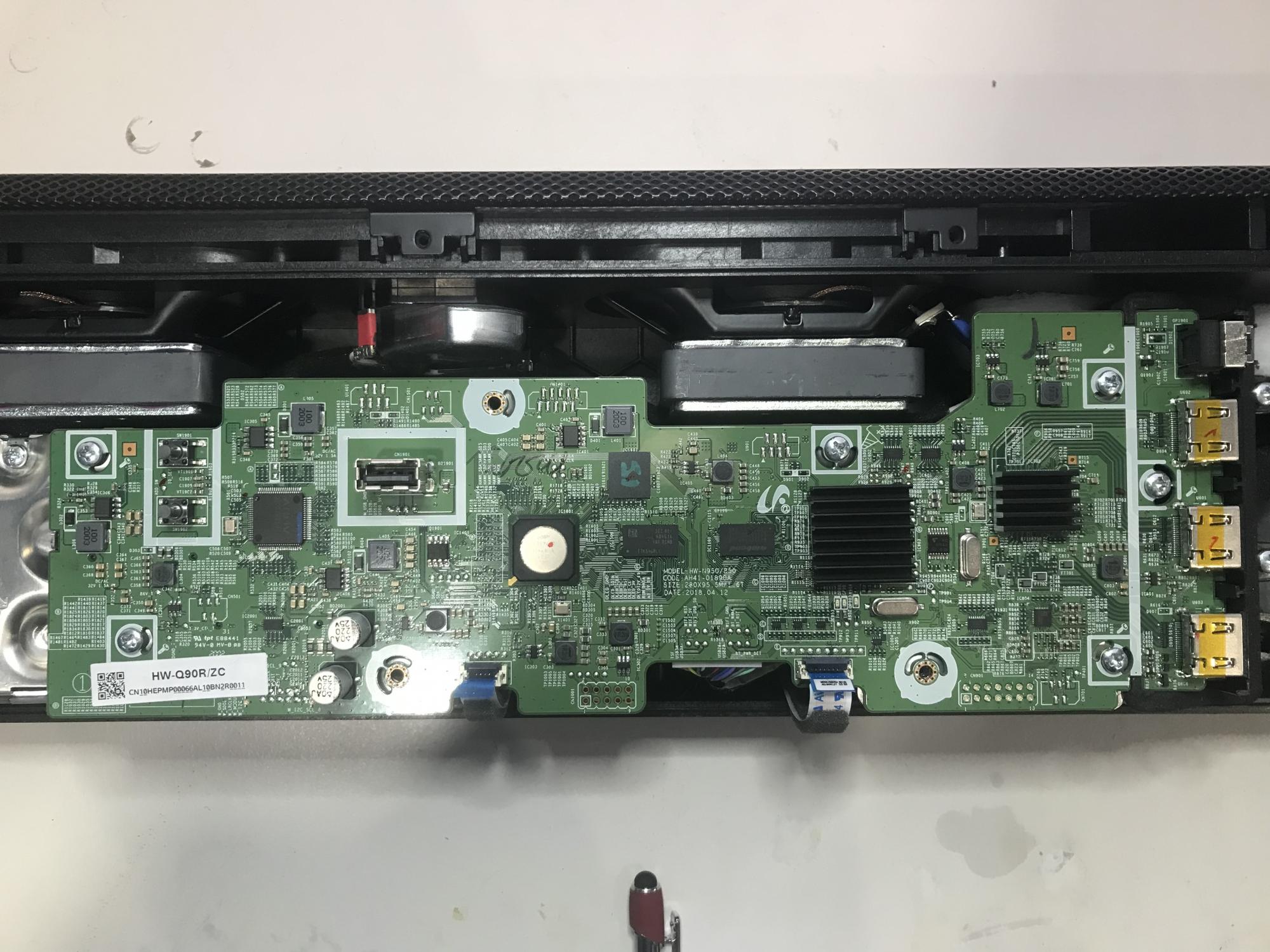

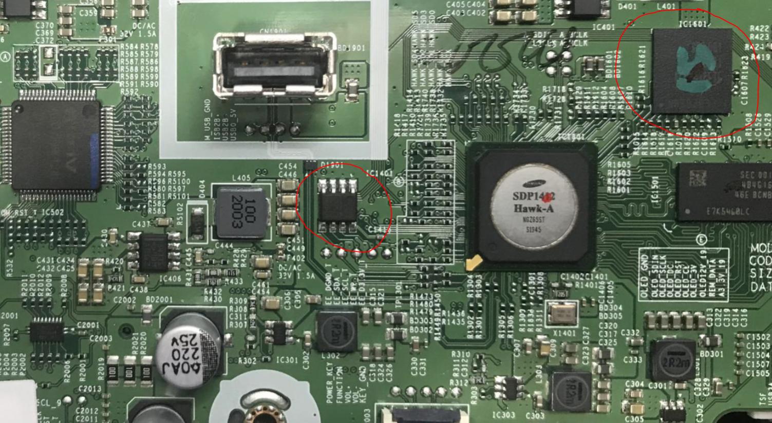

                                    Hey Lotas,
                                    Here are pics of the motherboard just to follow up
                                    • lotas
                                      • Jan 2016
                                      • 4451
                                      • Russia
                                      #58

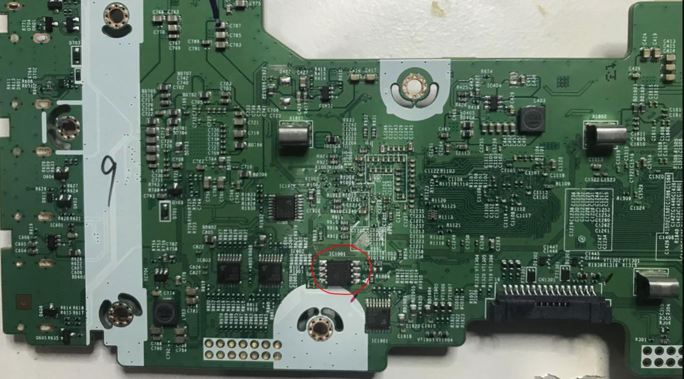

                                      Hello here the firmware is in 3 chips EMMC, EEPROM, SPI FLASH.
