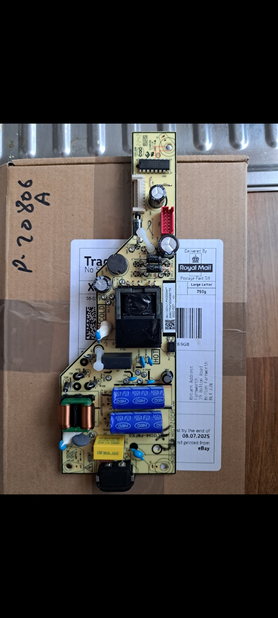

    Originally the tv arrived with dimmed backlights (not failed leds) but everything else worked ok. Adjusting backlight in menu did nothing but voltage changed on dimming control pins,
    0% p_dim at 1.65v and a_dim at 1v
    50% p_dim at 3.3v and a_dim at 1.65v
    100% p_dim at 3.3v and a_dim at 2.88v
    Changed backlight leds anyway as always like to have complete peace of mind they wont fail shortly after selling the tv. No change as expected!
    Leds are 2 rows of 15 6v leds.
    On inspection of the power board found diode MBR3200 shorted so replaced with SR3200 but no change, so then changed backlight control i.c GB98TDN which then appeared to fix the issue but 2 or 3 minutes later the tv powered off completely with no led indicator, the only voltage on power to main board plug was around 2v on the 12v pin. Found mosfet PCO158D shorted so replaced and again seemed to fix the issue but 2 to 3 minutes later back to just 2v on the 12v pin.

    I believe you need to change all 3 of those that you changed at the same time, so one doesn't keep blowing, maybe make sure the blue ceramic caps are all ok, have seen them cause odd problems.

          ok so have now changed all 3 - diode, mosfet and led driver i.c, the diode and led driver i.c seem to be ok comparing readings out of circuit to new components so just the mosfet blown this time.

            Been running the tv with backlight at 45% for a good few minutes more than it lasted before so fingers crossed. Shall increase the backlight once happy its ok at 45%.
            I did also check the blue ceramic caps beforehand and all seemed good.

                just curious but would a power board from a 43" or 50" of the same tv range work i.e 43rp620k, 50rp620k?
                I did buy one in the hope it would but backlights just flash on and off as soon as power is applied. I guessed it only for 43 or 50" with fewer leds to run i.e 40" 21 leds, 50" 26 leds rather than 55" with 30 leds.
                With the leds disconnected the tv turns on and operates fine.
                Though it was sold and advertised for 43, 50 or 55".

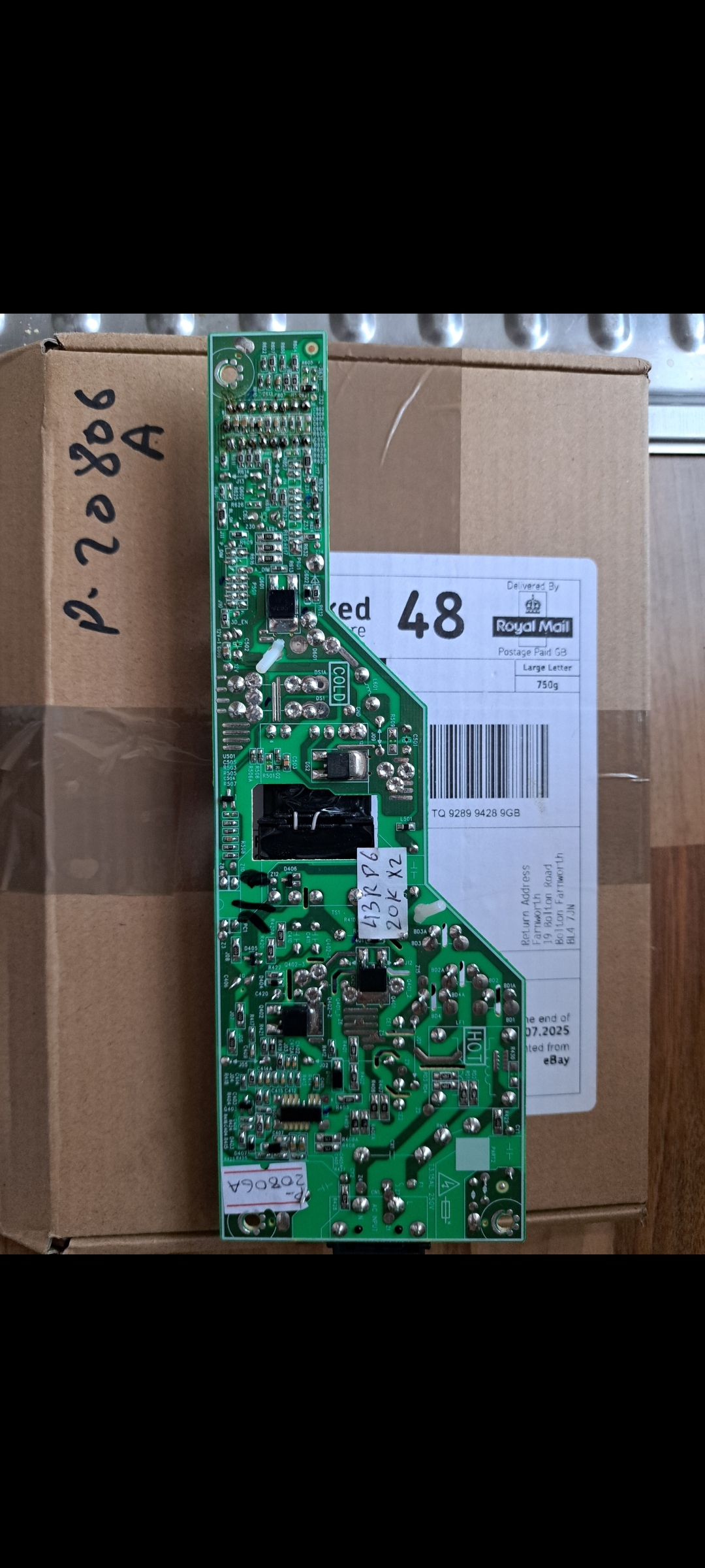

                Perhaps just needs repairing properly as the only replacement on the board is the led i.c driver, and not done very good at that as can be seen from the photo. Its possible it was replaced and only tested briefly rather than bench tested for any length of time and as I have seen it may work for a few minutes before something else fails.
                The board was purchased on ebay and received no response from the seller so may name and shame!
                As a note on the 43" power board the MBR3200 diode is a HER303G and the PCO15BD mosfet is a CS630A4H.
