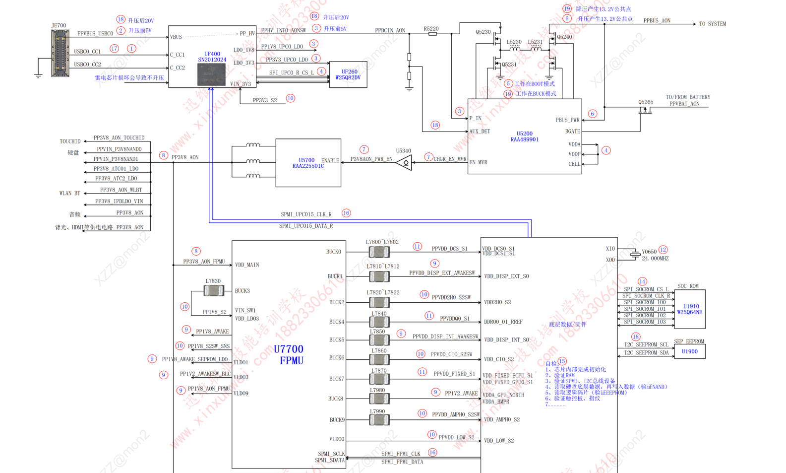

    Customer plugged in samsung monitor into the board and used it as a power supply, killed UG800 and UG400. I replaced those two with an exact donor board we had In stock and working, board pulls 5volts and then gets like 2.89 amps on the left side. The singular port is the port that failed. Used a perfectly working chips from donor (board was locked) Now I only get 5volts 0 amps on that power and then 20volts 0 amps on the two left side ports, I checked for DFU and nope nothing, computer not turning on. No shorts present anymore. I am confused as I used the exact components from an identical working board. So I am now stuck tracing the issue. I am only getting 12volts at PPBUS_AON . PP3v3 is present and P1v8 is present but nothing. I also put it into the battery and nothing. So I'm lost now. Very confused where I am missing as there are no present shorts here. Am I missing something?

    PPBUS_AON is dialed up / down over SMBUS. Confirm the voltage to ground on the SMBUS lines used by this regulator. Also suggest to measure the voltage to ground of the SMBUS lines used by the battery BMS.

          Something could be wrong here. Remove all power. Meter in resistance mode. Measure the resistance to ground on each of these SCL / SDA lines. The TVS ESD diode may have triggered. Have not checked the schematic but for a while, the boards contain a small TVS ESD diode on the battery connector.

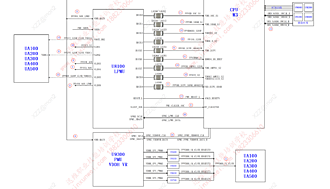

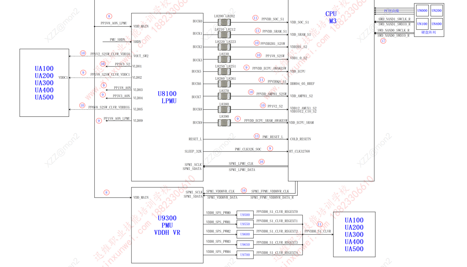

                Would you have the timing diagram for the power sequencing for this motherboard?
                See attached. Can zoom in on any area of interest on this drawing.
                Click image for larger version  Name:	A2991_power_sequence1.png Views:	0 Size:	525.0 KB ID:	3723114
                Click image for larger version  Name:	A2991_power_sequence2.png Views:	0 Size:	402.6 KB ID:	3723115
