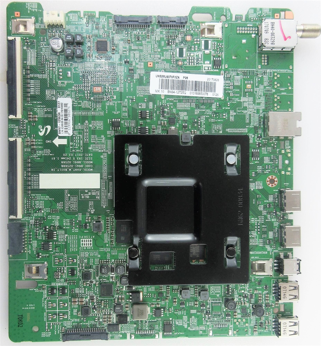

    I'm having trouble with this TV.
    I have confirmed backlights work and power supply is good. There is no tcon on this model.
    Issue is the main board. When plugged into the power board the voltage drops from 13v to 9v. all pins that are supposed to be 13v are 9v. . But I cannot find a replacement board anywhere so I'm trying to repair the bad components.
    Also to note I tried unplugging the 2 lvds cables to rule out panel issues and same problem persist.
    Just need a little help tracking down the bad components.
    Any help would be greatly appreciated.

    Re: Un50mu6070 Mainboard issue
    It is a software fault, try to locate an 8 pin chip with marking 25xYYY where xy varies, then freeze it with butane gas or compressed air can, wait 5 sec. then turn on tv..

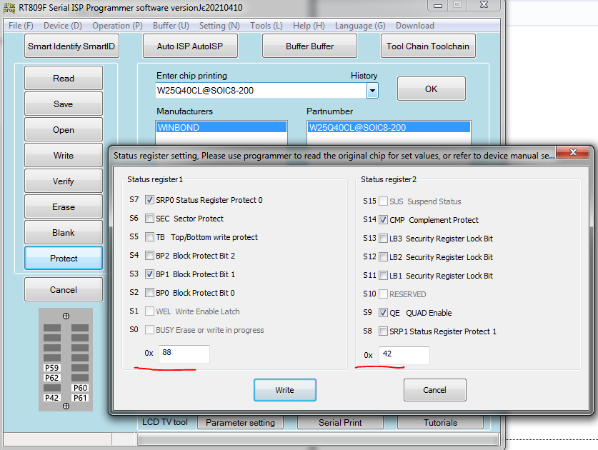

                                Try it, but when writing this 25Q40 you need to correctly set on the programmer "STATUS REGISTERS"
                                0x88, 0x42.

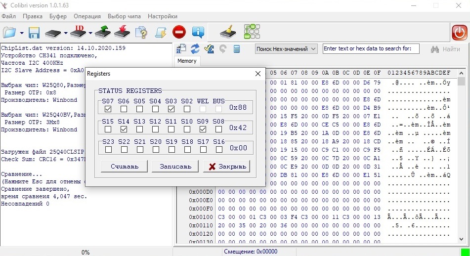

                                  "STATUS REGISTERS"
                                  0x88, 0x42.
                                      I programmed the old chip and it still won’t work when I installed it. I made sure the status registers were set to 0x88 and 0x42.
                                      Not sure if I’m doing no something wrong since it’s my first time feeling with eeprom.
                                      I do get a message saying chip may be protected. To hit unprotect and check data sheet. Not sure what that means.
                                      I push Unprotect. It seems to have something to do with the status register.
                                      Any ideas?

                                      • lotas
                                        • Jan 2016
                                        • 4649
                                        • Russia
                                        Hi, what is your programmer?
                                        Read the contents (dump) again and upload them here.
