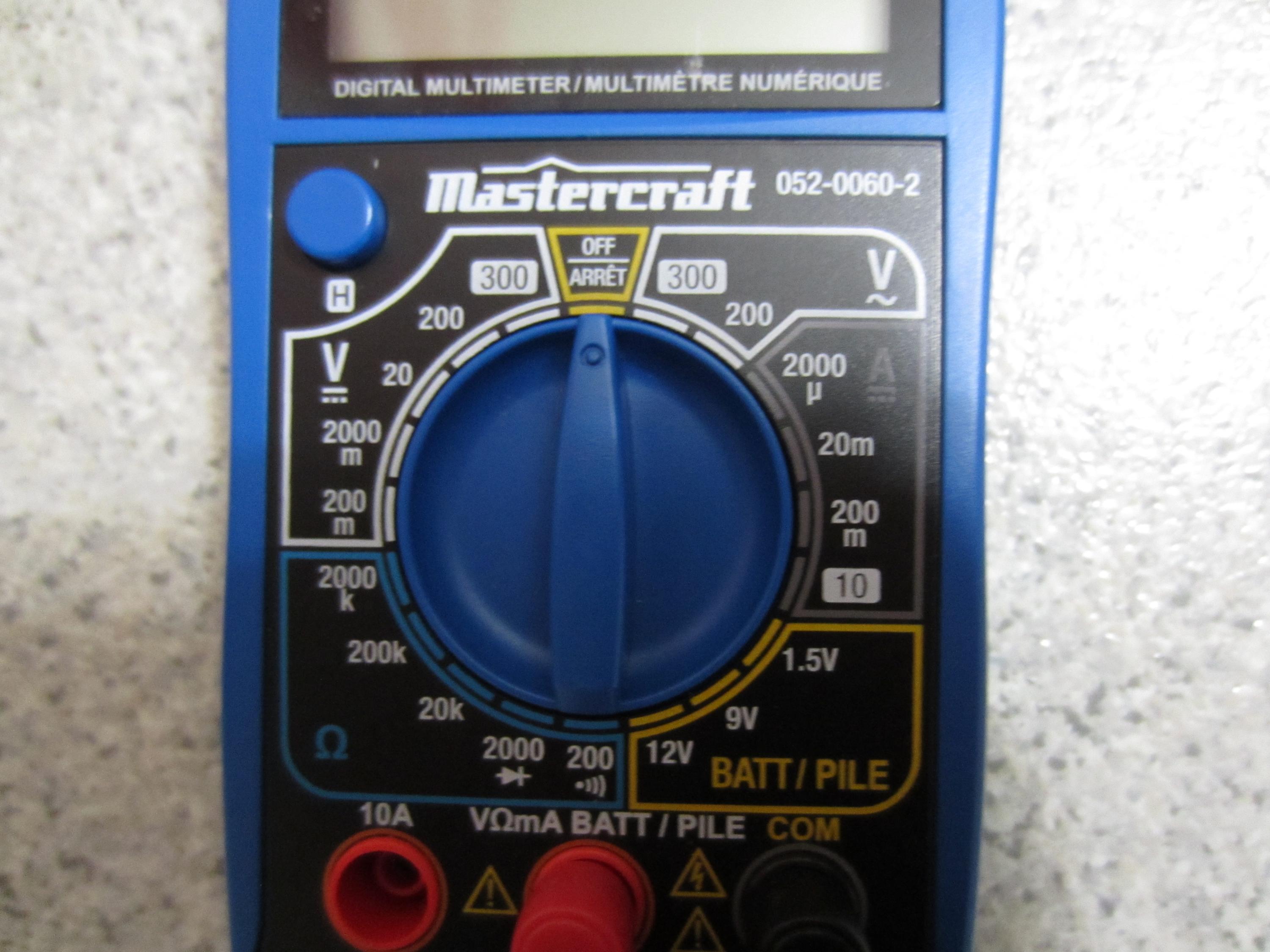

        I think the maximum voltage for my multimeter is 300V.
          #64
          Re: Sharp LC60C6400U - 2 long binks, 5 short blinks error code
          What kind of meter do you have? Pictures of it?
              Here is my multimeter. Maybe it can handle it, I am a noob remember. I'm leaning towards powerboard failure, just need to figure out the components that need replacing. If the ICs on the flex cables fail is it always obvious? I inspected them all and they look very clean or new without and melting or burning on them. Also LED strip is 100% clean looking (now I know when they die sometimes they look the same) but I saw a youtube video of a couple burned ones on a strip out of a similar 60" Sharp where one looked black and another brown. Also I know that an LED strip problem has it's own blink code.
                #67
                Get a new meter so you find out if the PFC Voltage booster is working or not.

                          • 6647

                                Your meter might not be ideal for some measurements, you can pick up a digital one at a big box store for around 10 bucks.

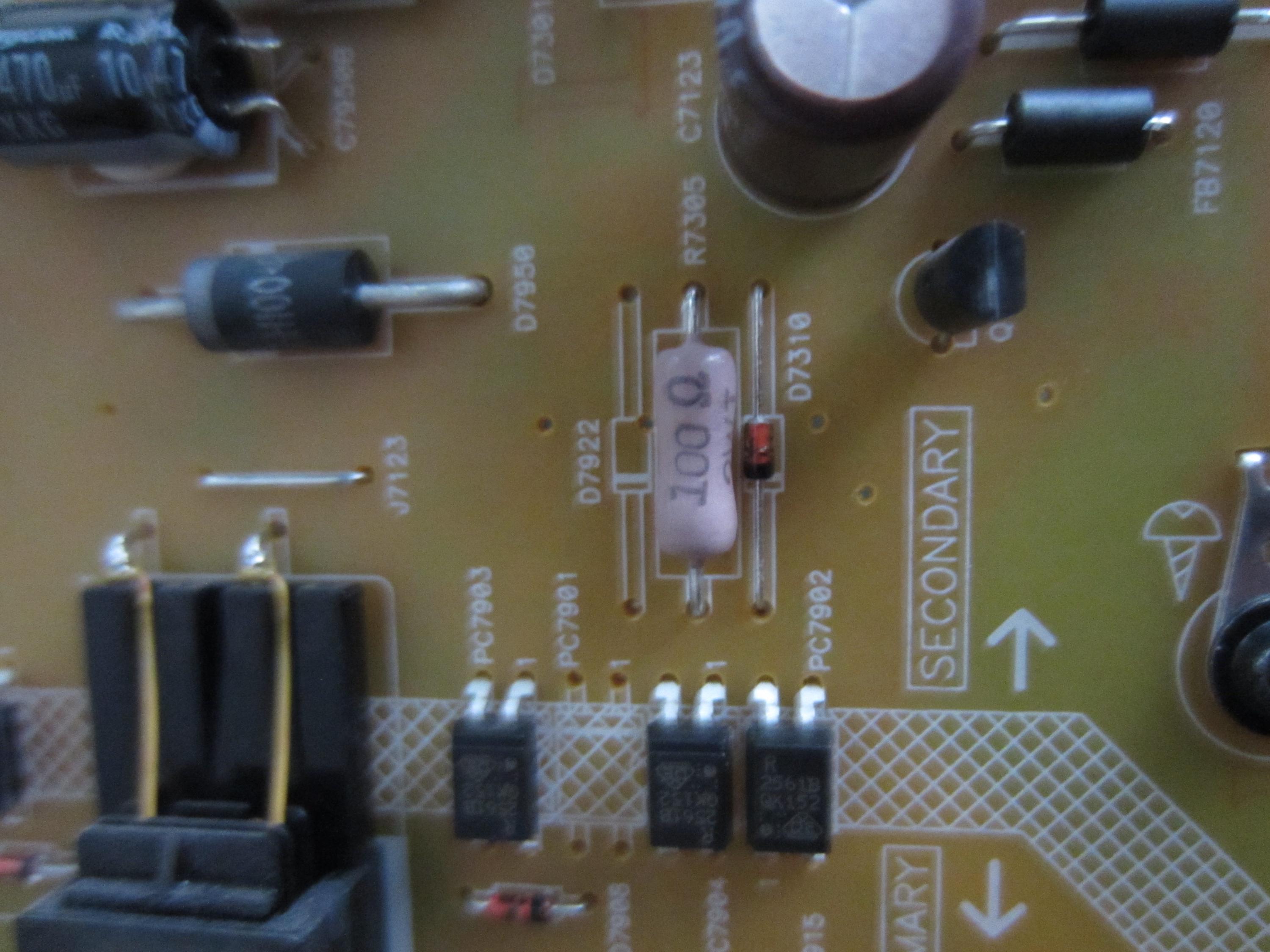

                                  I'm going to remove R7305 and test it with my multimeter since it's a component that can be fried in similar models IE: LC-70 series
                                  Since there is a repair kit including the KIA378R12PI I think I'm on the right track now.

                                    Looks like 100 ohm resistor with the writing 2WJ on the side.

                                      Hello R_J
                                      Originally posted by R_J
                                      I don't know exactly which board you have but Sharp did have a problem with D7805 shorting. might be worth checking. original diode is NUR460, change to MUR460
                                      Can you give some guidance how to test this diode with my multimeter?

                                        #79
                                        Originally posted by Noobwithamultimeter
                                        Hello R_J
                                        It's a diode, Use diode test, it should read open one way and .5xx or .6xx the other way. If it reads shorted then it needs to be replaced with the newer version.

                                          #80
                                          Thanks. It's reading .500
