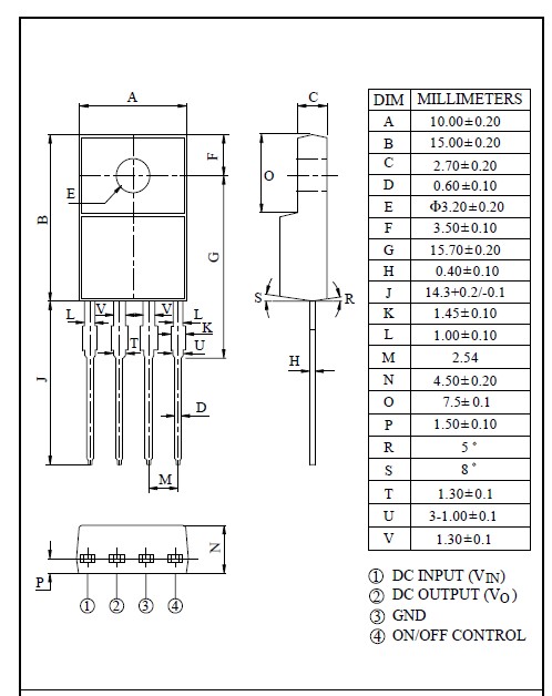

    Hi, long time browser - first time poster. I got my hands on a Sharp LC60C6400U and from what I could find on youtube similar models of this set have a 12V power regulator that fails called "KIA378R12PI". So I go ahead and order the part, install it and badda-bing my set worked right away. Only a problem - it failed after about 3 hours. So I re-attempted my solder joints and it was back in business, for a couple of days. Failed again with the same error code. I think to myself no worries I have 4 spares since I bought a 5 pack in case anything went wrong. But now after roasting the solder pads away I'm onto my 3rd regulator, the TV is powering on but I am realizing it's getting toasted by something elsewhere in the circuit.
    I looked up the power board to replace it but it's no longer being supplied but apparently they still sell repair kits for it on shopjimmy. By the looks of it there could be as many as 16 additional components that need repair to get this sucker back up and running. https://www.shopjimmy.com/sharp-runt...rd-repair-kit/
    Current voltages of my regulator (going top to bottom) are 28V 25.7V 0V 4.8V
    Now these first two numbers seem very high for a 12V regulator so it's just a matter of time before this current fix fries, but that picture looks awesome. No lines, no issues, backlight seems ok. Just need a way to turn it on I think.

    Can you check what the output current of the regulator is using your meter.
    The data sheet indicates the maximum input voltage is 28V but the power dissipation is 1.5W without a heatsink and 15W with an adequate heatsink.
    With 28V input to the regulator and 12V output then that's 16V dropped across the regulator and if the current flowing through it was 1 amp then the device would be dissapating 16W.
    I would also check any capacitors across the output of the regulator.
    Can you put the voltages against the pin names

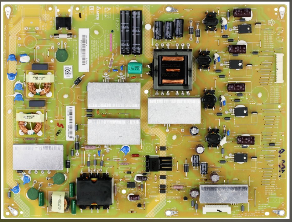

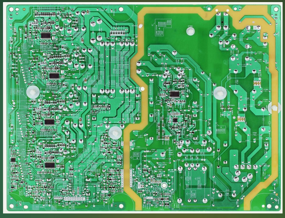

      Looking at Shopjimmy's photos, I think the regulator gets it's supply from either D7130 or D7131 so I would also check those diodes
      Photo's courtesy of Shopjimmy

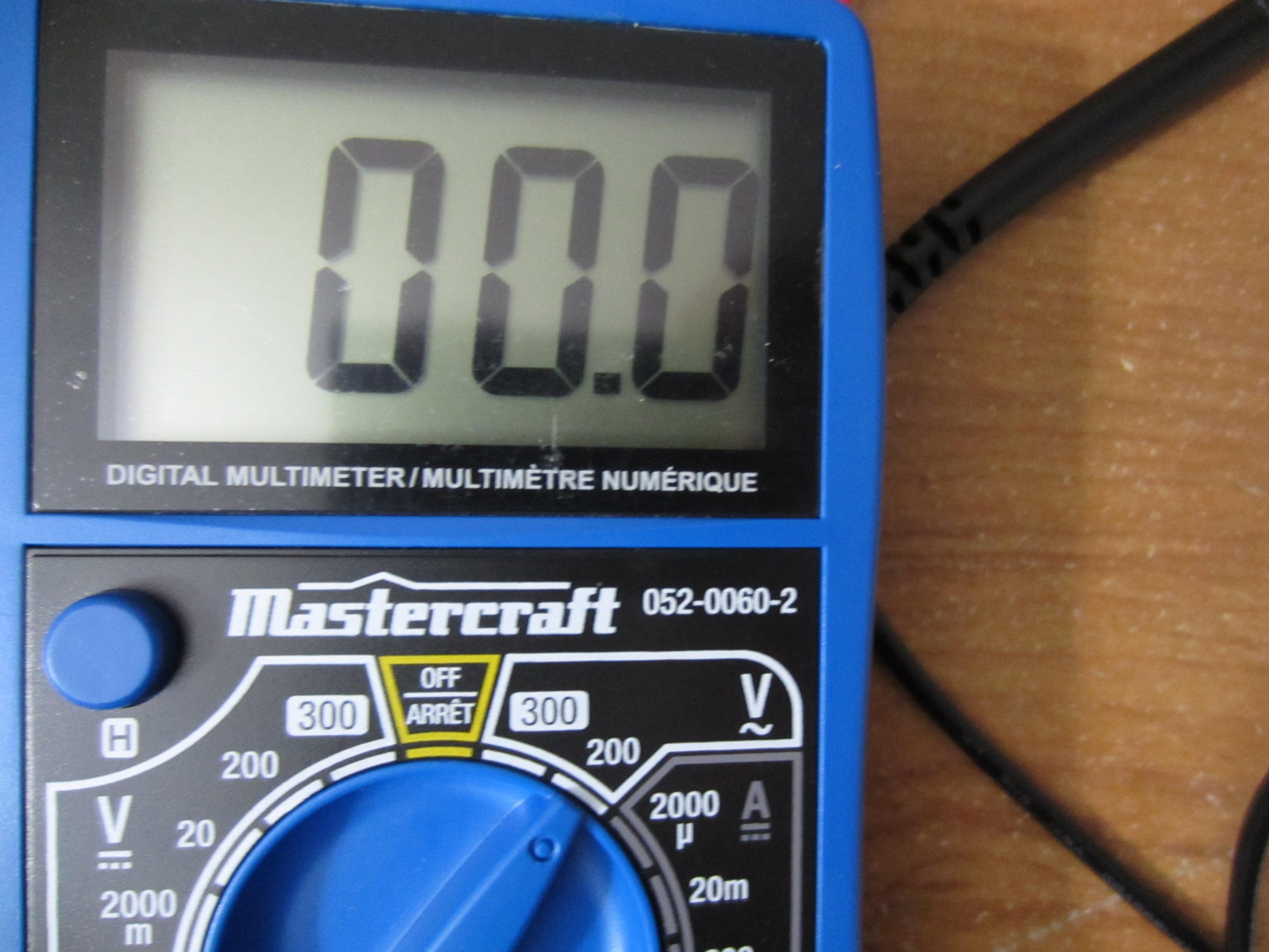

        Before I take my next reading can you help me with my multimeter settings, is this the right spot to have it set on? (I'm a noob)
            Your neter is set to 200V AC (~ = AC) and needs to be set to DC voltage
            • dick_barton
              • Aug 2015
              • 6643
              • Wales
              Re: Sharp LC60C6400U - 2 long binks, 5 short blinks error code
              DC voltage is the V with the flat and dotted line underneath it.

                  After switching my multimeter to 200V AC now the readings are correct!
                  (1) 13.0V
                  (2) 12V
                  (3) 0V
                  (4) 2.5V
                  I'm REALLY just crossing my fingers that both previous attempts were simply bad soldering on my part but I have the sneaking suspicion that the regulators are failing. Only time will tell as I am going to use the TV as if nothing is wrong starting tonight and I will monitor the temp. Since I have the back off the TV I will run a small fan pointing at it as I go.
