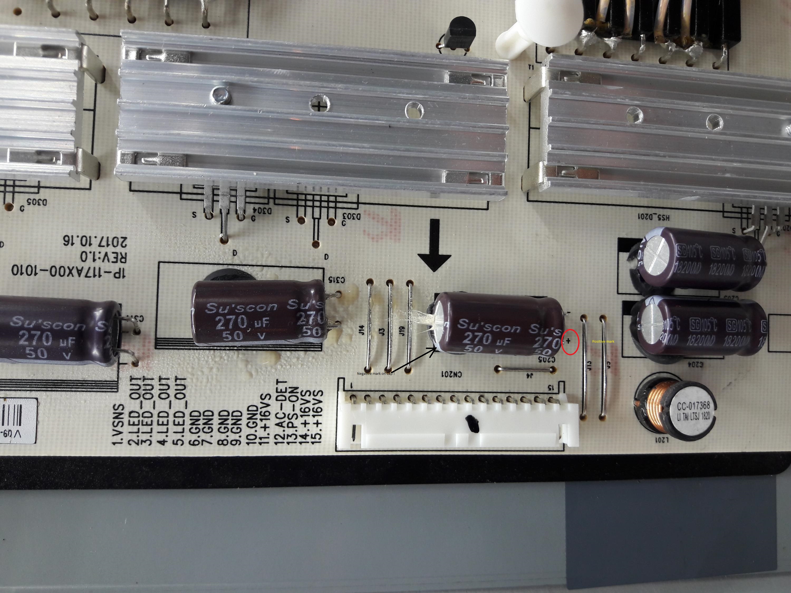

                  I took out the C111 cap and the other one, put them on my ESR Meter. they are 22uf 50v and they are reading 0.6. SO I assume they are good.
                  • rebelkustoms
                    • Sep 2015
                    • 150
                    #29
                    Re: VIZIO D60-F3 Wont Power ON, No Standby, No Picture, No Sound
                    I just soldered in the C9 and C111 caps that I took out and tested with the ESR and I plugged in the board without the load to test the pins and the C205 Cap Failed and popped. For what reason I dont know but here is a photo.

                      I suspect that C205 was bad, as in shorted and that is what was killing the voltage, If it was caused by anything else I suspect C203 & C204 would also have blown. Remove C205 from the circuit and monitor the +16VS voltage on CN201, I suspect the voltage will now be there. The board will operate without C205 installed for testing
                      The fact the cap blew would suggest there is voltage now getting to it and I bet the power supply is working.

                                  Check that the white line running along the capacitor has its nearest pin connected to the negative pad "-"

                                    I found the reason the cap blew, dumb mistake on my part, there are 2 different value caps right in that area and when i took them out to test I accidentally swapped spots, so the cap that blew was in the wrong spot and got damaged. My mistake.
                                    I had to order a new cap so I just spent 5 bucks and got new nichion caps for the C9 and C111 spots and ALL the caps down the connector side of the board. With those in and the Transformers resoldered I am still getting 0V on all the pins. No Standby or anything.

                                        The reason C205 blew was because it was in backwards. And there WAS voltage (wrong polarity) across that cap for it to blow up.

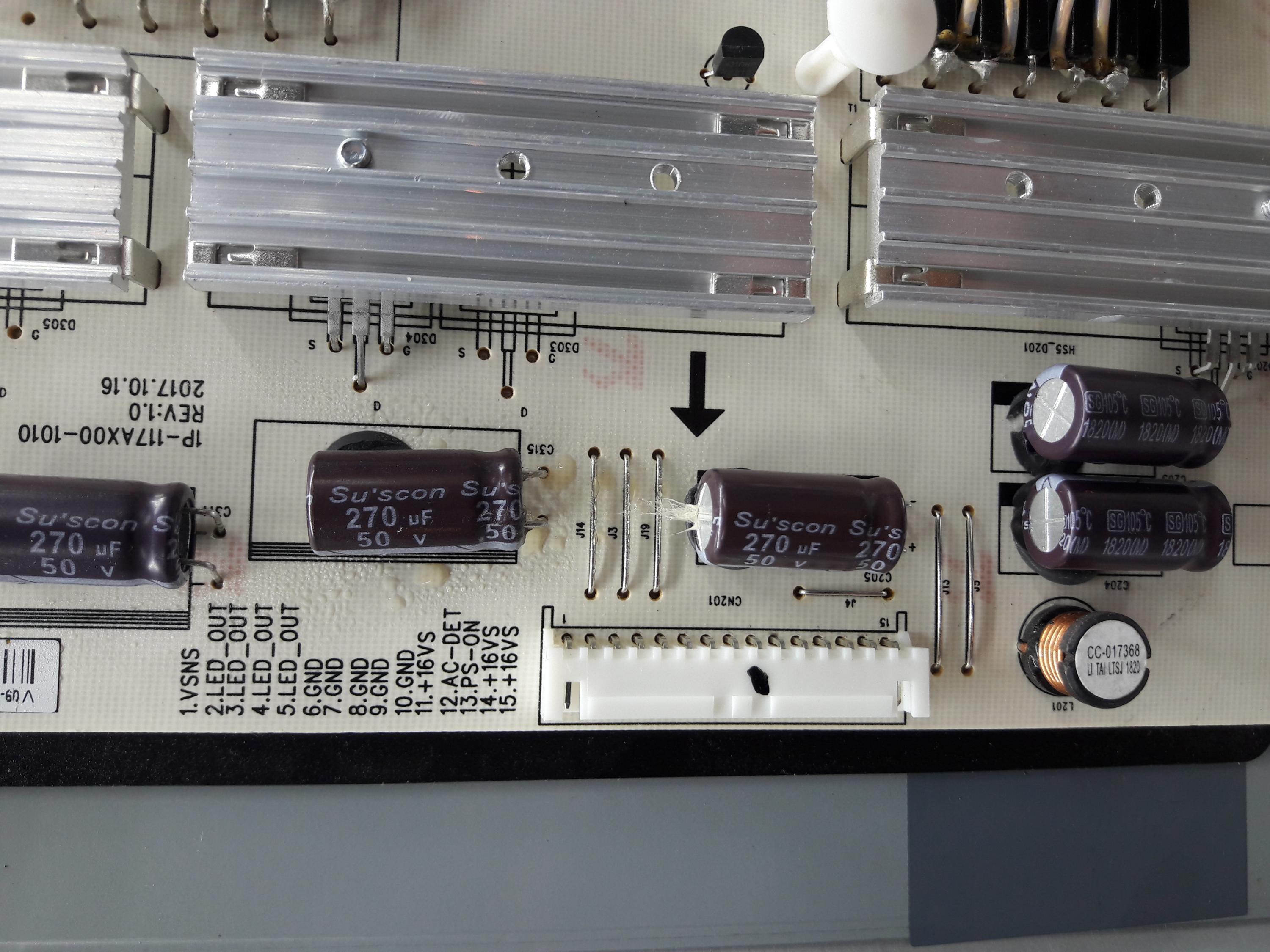

                                            Need help.
                                            I have a samsung un60j620dafxza led tv. When I plug it in it has no display, no sounds, and no standby lights.
                                            So I opened the tv and disconnected the power to the mainboard and the backlight powered up. This according to many people says that this is a mainboard
                                            problem. I checked the voltage coming from the stb and I read 1.3 volts on pins 1,3,5 and 7 which are low volts instead of 13 volts which i think the lcd panel
                                            might be drawing too much power from the power supply that it prevents the right voltage going to the mainboard....
