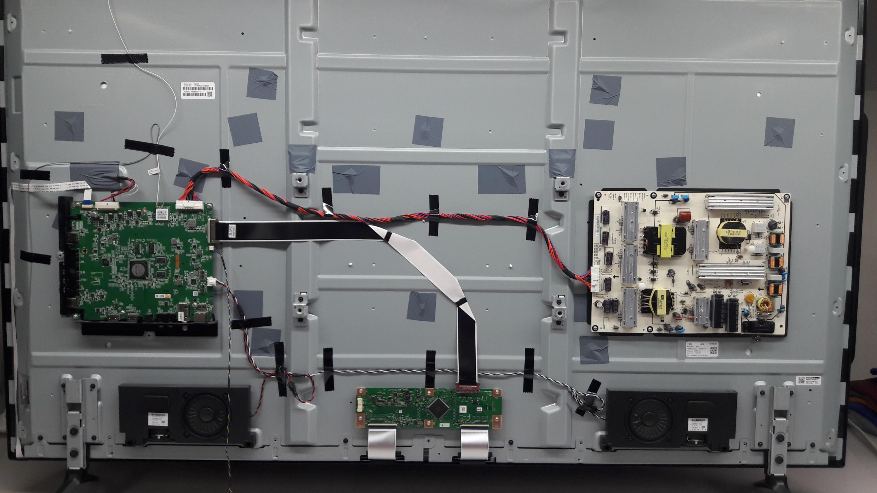

    Can we see the pictures of the whole backside of the TV showing all the boards so we can see how all the boards are connected together?
    • rebelkustoms
      • Sep 2015
      • 150
      Re: VIZIO D60-F3 Wont Power ON, No Standby, No Picture, No Sound
      Sure, sorry

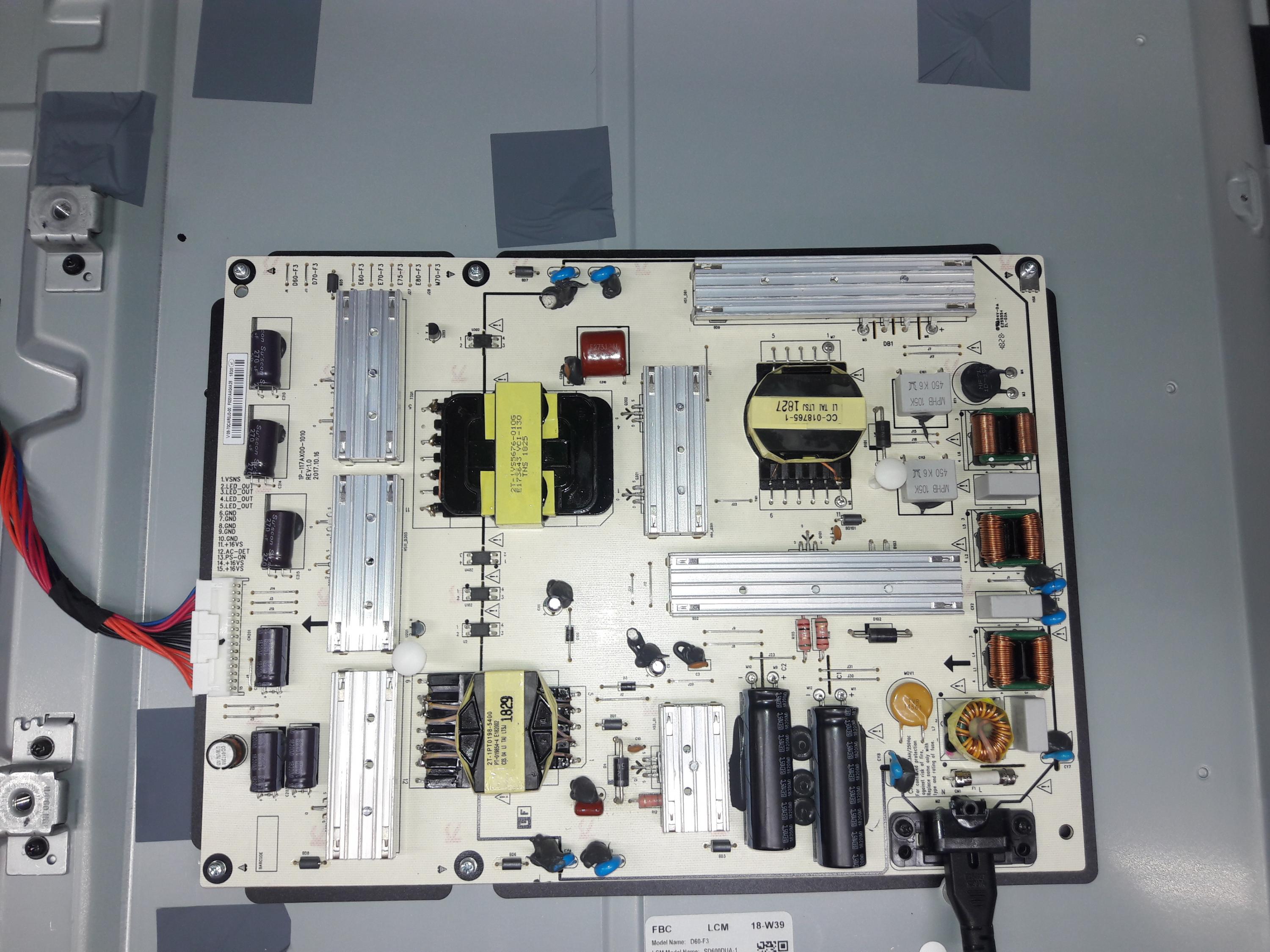

            The first thing I would do is remove the power supply from the tv and inspect or resolder the connections on the transformers, they like to develop poor connections and go intermittent.
            Also check the solder connections on any of the components mounted to the heat sinks .

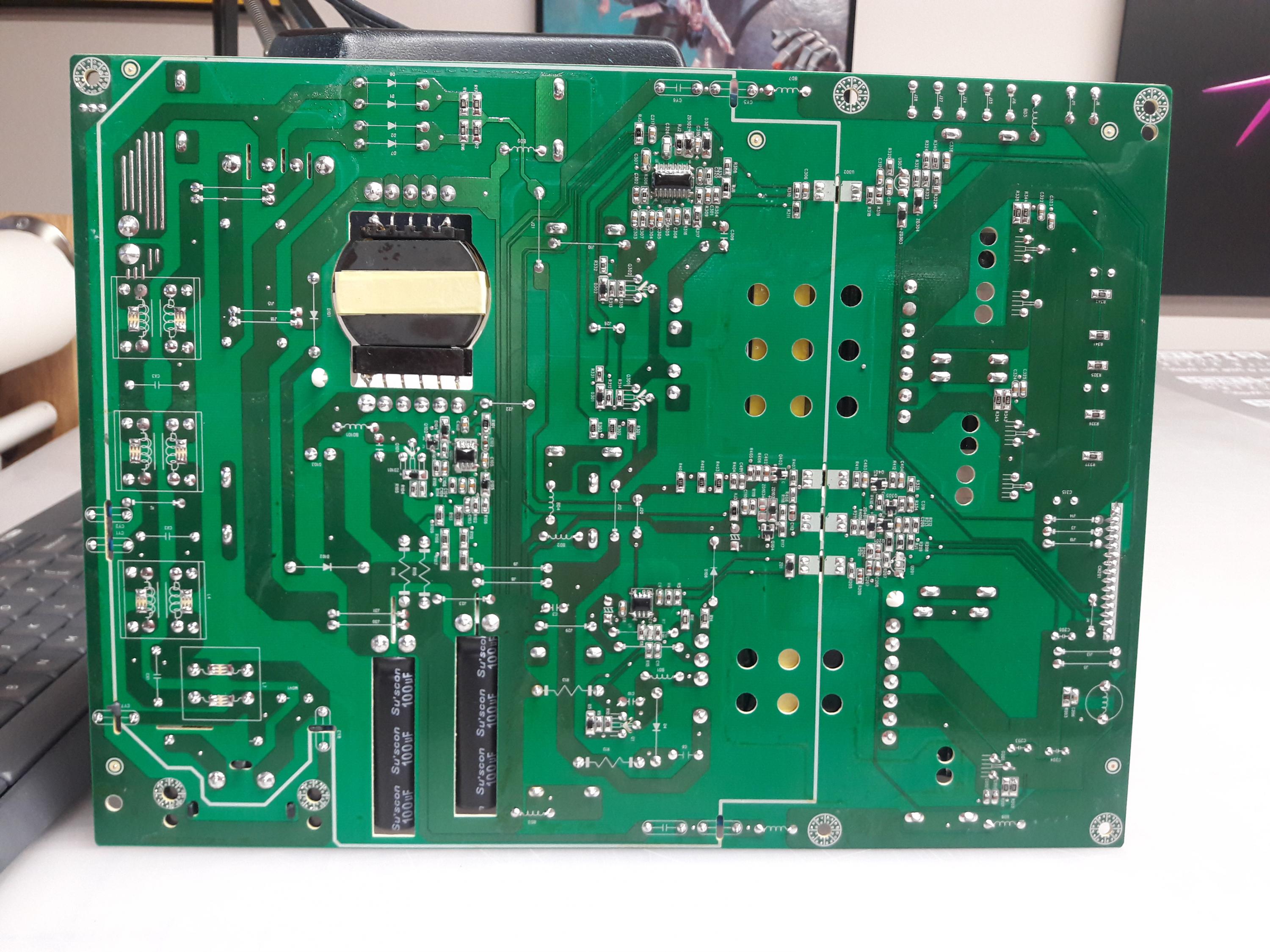

              Show us good clear straight shots pictures of the whole bottom side of the power supply board.
              • rebelkustoms
                • Sep 2015
                • 150
                Here is PS shot.
                  You probably already did, maybe check those 2 diodes D102, D106, D103, maybe heat up your electrolytic caps with a hairdryer and see if it wants to start up if it does, you probably have a bad cap or 2 or more, test power cord for continuity. Seems like the caps should be ok tho, they've only been out for 2 years.
                    There seems to be a residue of some sort around the large transformer in post #8 poking through the circuit board. Can you see where it has come from?
                      The residue just seems to be glue residue that seems to be all over the board. not specific to that area.

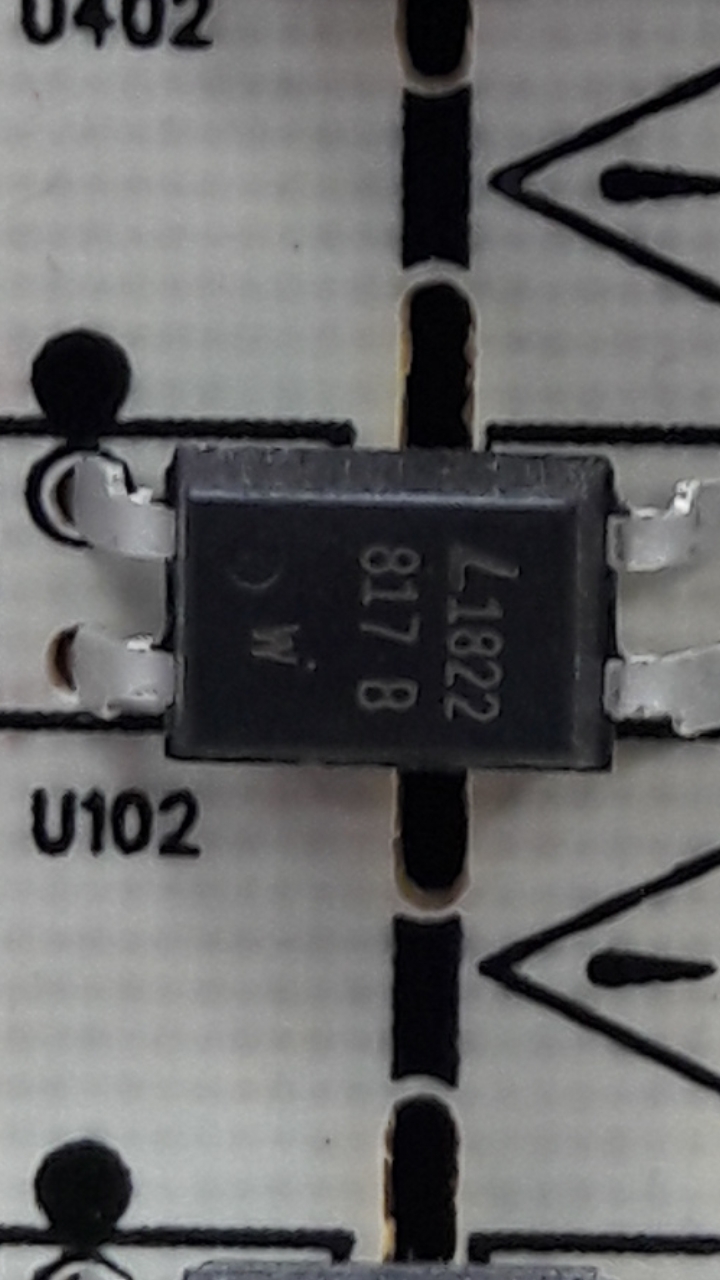

                                    Are you getting any voltage on the +16VS on plug CN201? What about the voltage on D3?
                                    Can you read the number on U1?
                                      The voltage on D106 is jumping around because the ic is likely operating in burst mode.
                                      I am getting jumpy voltage all <1v on bith +16 pins. So No voltage on that.
                                      D3 is 14v
                                      I dont see a U1. is it one of the 3 U2, U102, and U402?
                                        U1 is on the trace side, it is the standby ic. on the other side of D3. Check that D201 dual diode is not shorted
