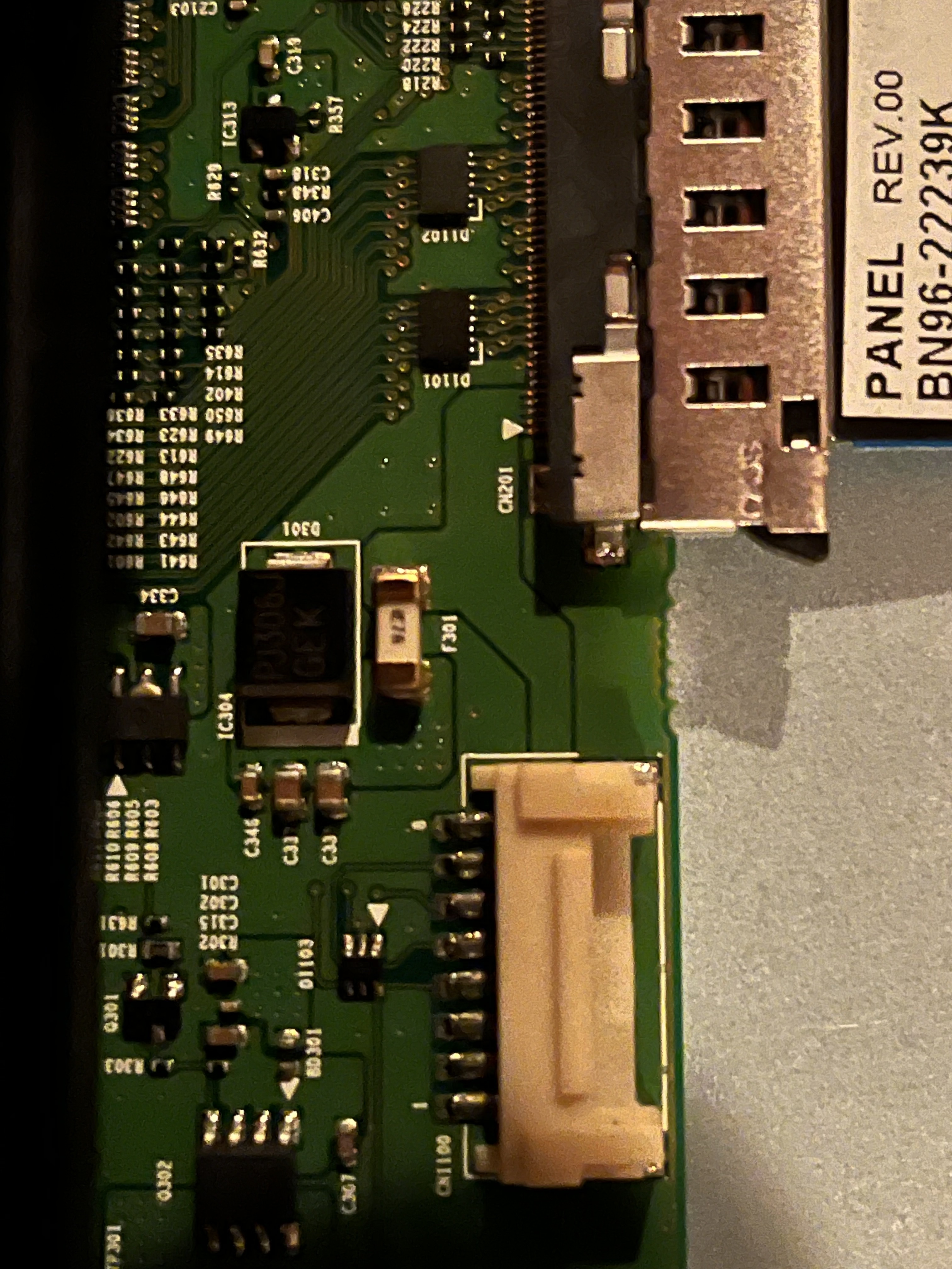

    I ordered a supposedly ‘new' Tcon board this time, and upon installation get no picture at all. Reinstall the old Tcon board, and the picture returns again for the previously mentioned 10-15 minutes. I returned the ‘new' Tcon board as defective, and they sent me a replacement. Same symptom. Black screen on power up. Once again, Reinstall the old Tcon board, and the picture and menus return again for another 10 minutes. Power cycle returns picture.
    I'm skeptical that I received two defective Tcon boards, but it seem odd that the symptom is worse with the new boards than with the original board. Looking for any recommendations before I scrap this TV completely and move on.

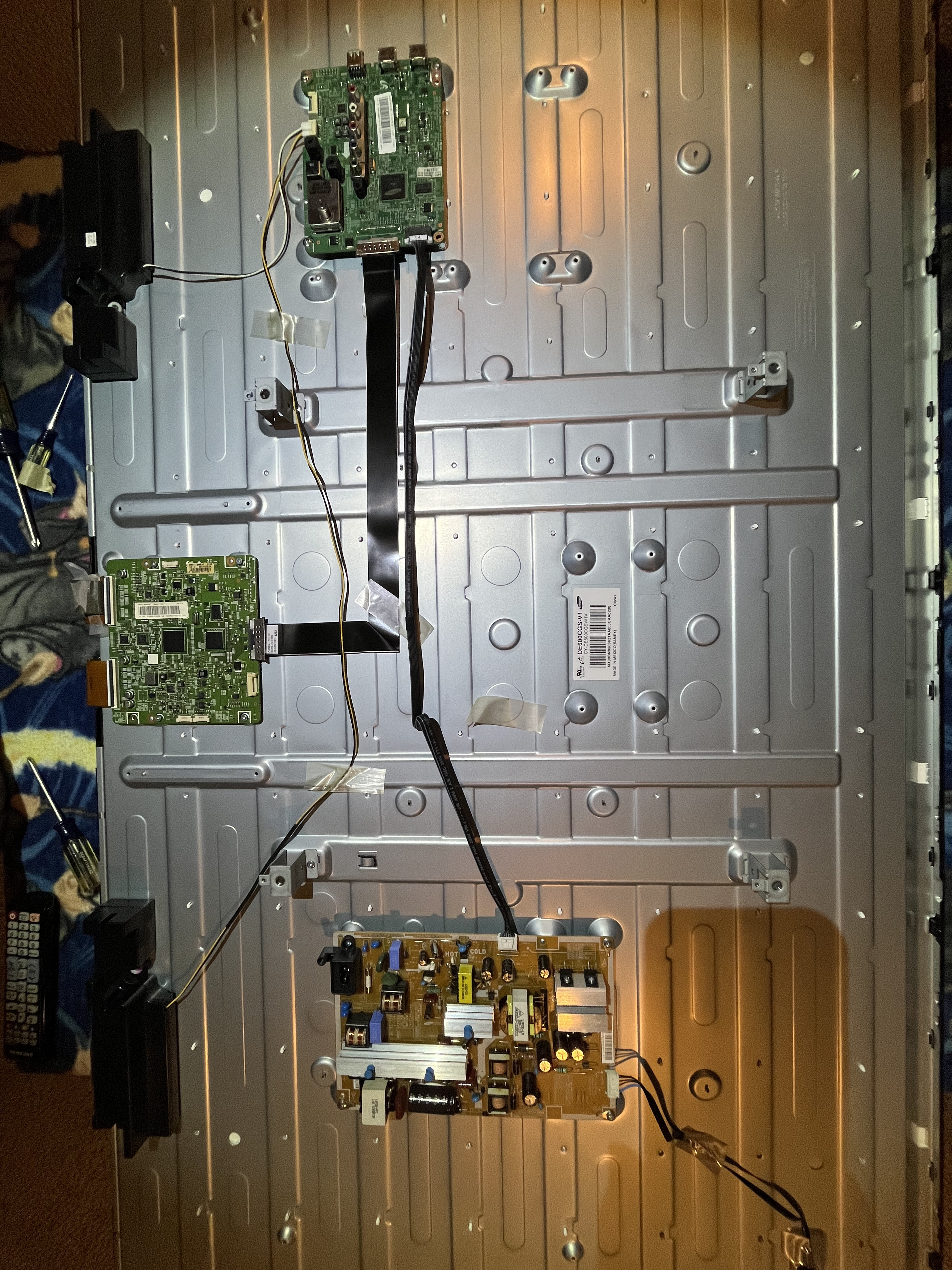

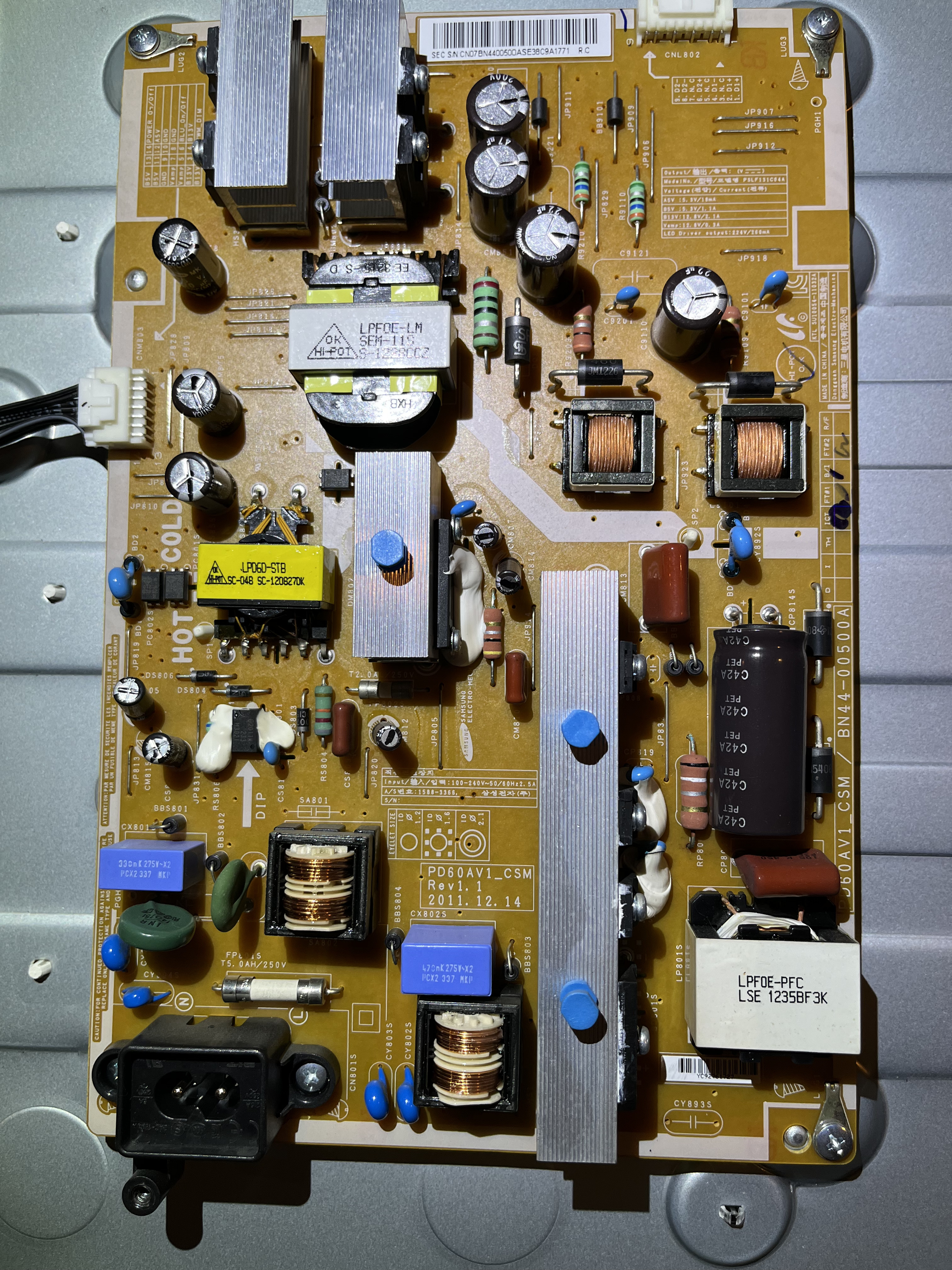

    start to upload photos of the whole set back and the PSU..
    it sound from yours trying its Caps issue at PSU rail 12V t-CON.... photos will tell more about this rail direction

      Attached are pictures of the power supply as well as the whole TV back. I didn't notice any swelled caps.

        yours T-CON VCC 12V fed from mainboards.. you need to check at time the issue appears if you still have 12V on the T-CON fuse close to LVDS socket.. we need to know if it remains 12V or go low.
        incase its remain 12V and there no change at this rail you need to disconnect half of the screen from T-CON and check if the issue appears too or picture remain on at half screen

          12V remains at fuse F301 on the T-Con board before and after the picture is lost. It does not fluctuate from a full 12V (12.38 to be exact).
          I disconnected the connector from the right side of the T-Con board (viewed from the back) and the picture remains on the right side of the screen temporarily, and eventually goes black (left side of the screen was white, then went black)
          I disconnected the connector from the LEFT side of the T-Con board (viewed from the back) and the picture remained on the left side of the screen temporarily, and eventually goes black (Right side of the TV was white, then went black).

            it sound right now we do have here cutting signal from mainboards, please try use Freeze air can on the mainboards to see if the picture stay longer
            if no change try freeze the T-CON

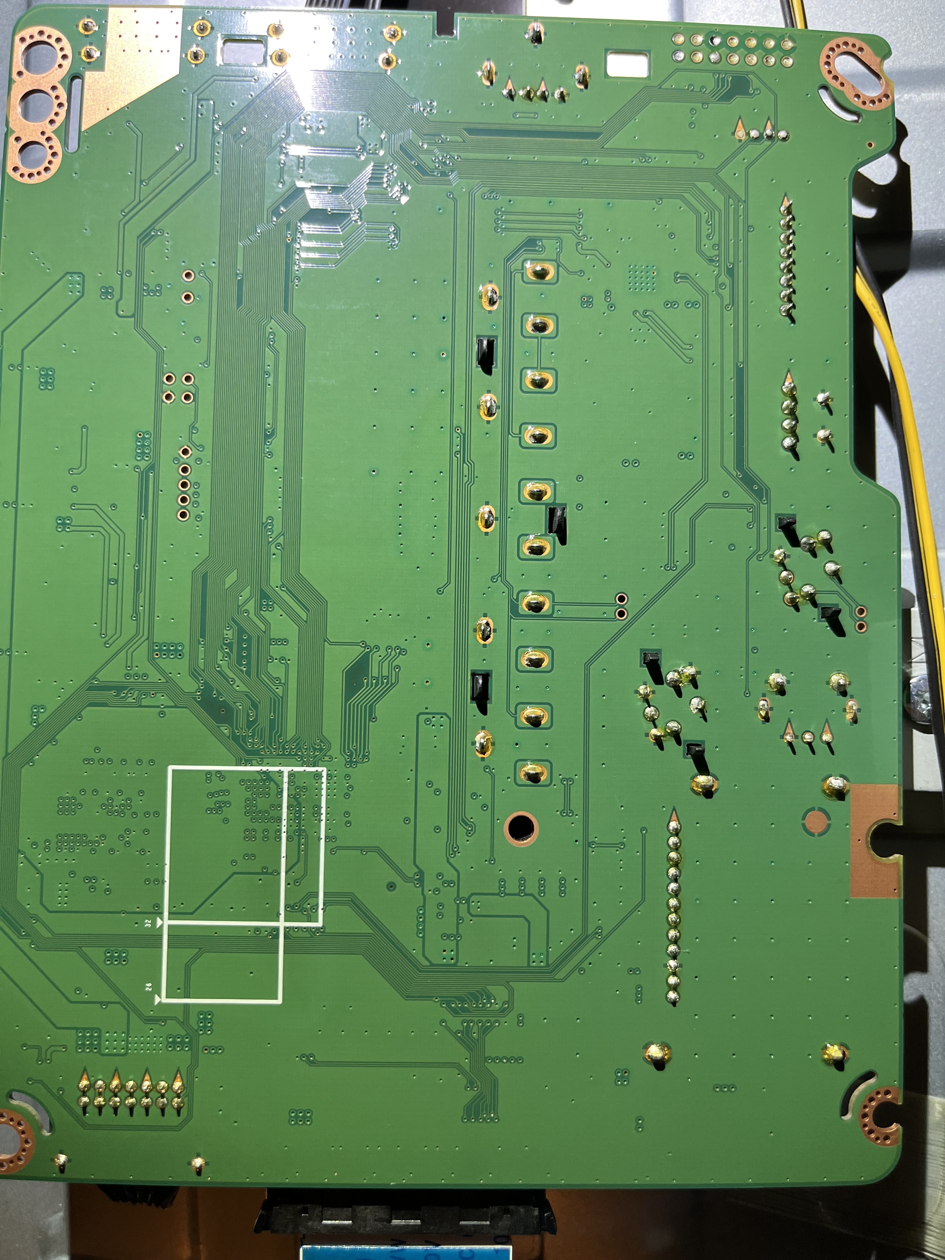

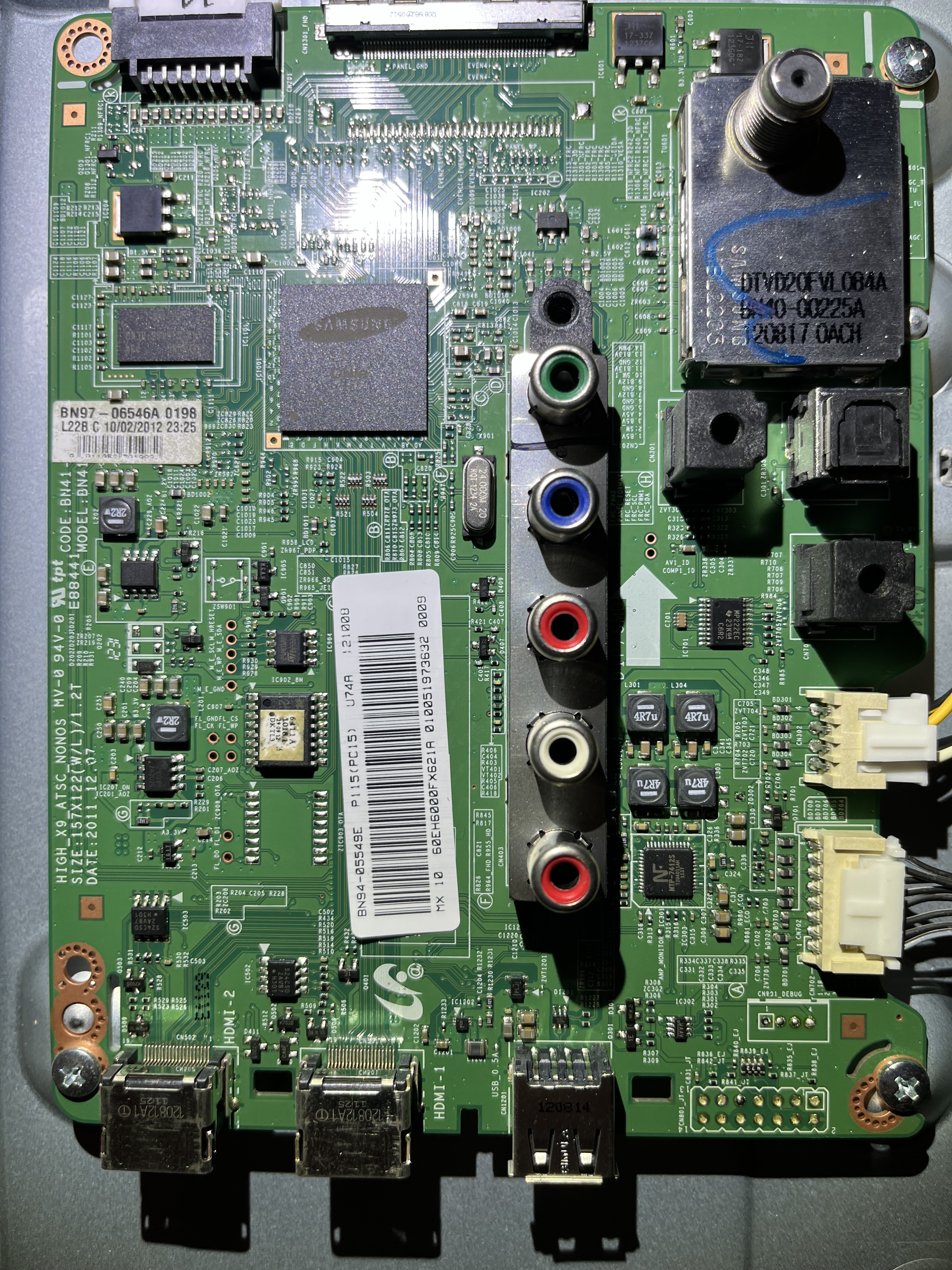

                          let see the mainboards clearly from the top and downside

                            Seems like there isn't much left other than the main board. I hate just throwing parts at a problem, but should I order and replace the main board? Power supply seem OK?

                              put movie or photo on USB stick and play it on the TV as USB source... let see if the it remain on

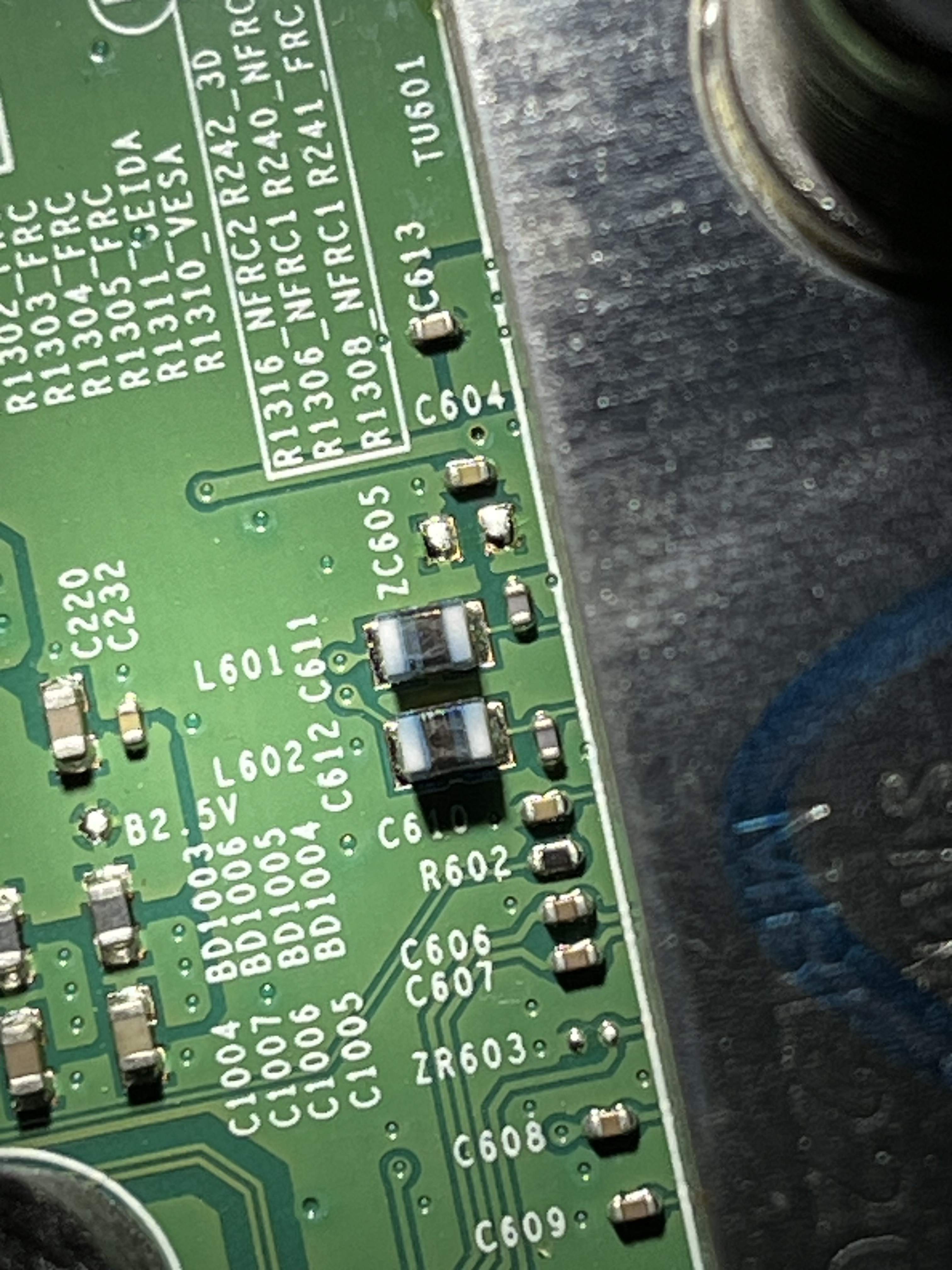

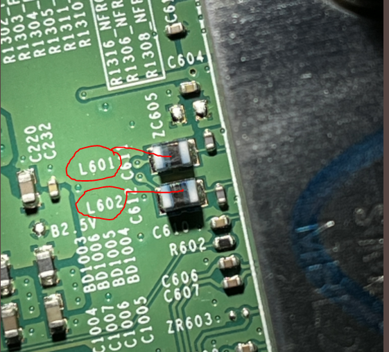

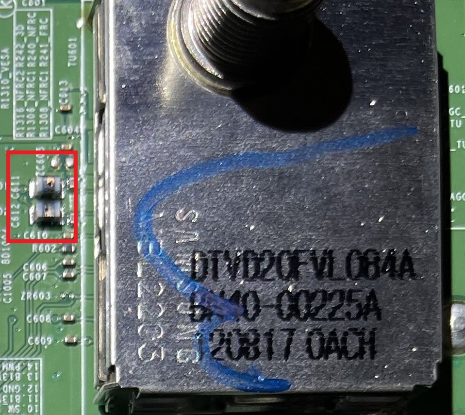

                              and check this 2 marked in photo they look funny

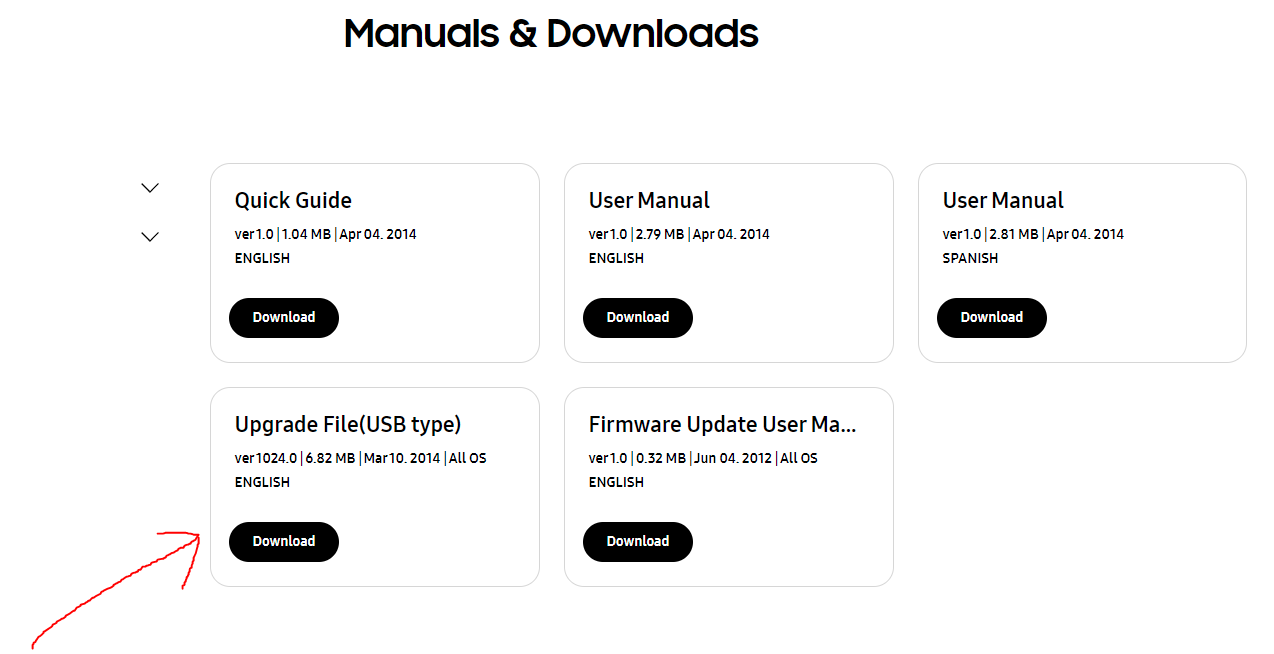

                                Try updating the software via USB. https://www.samsung.com/latin_en/sup...XZP/#downloads

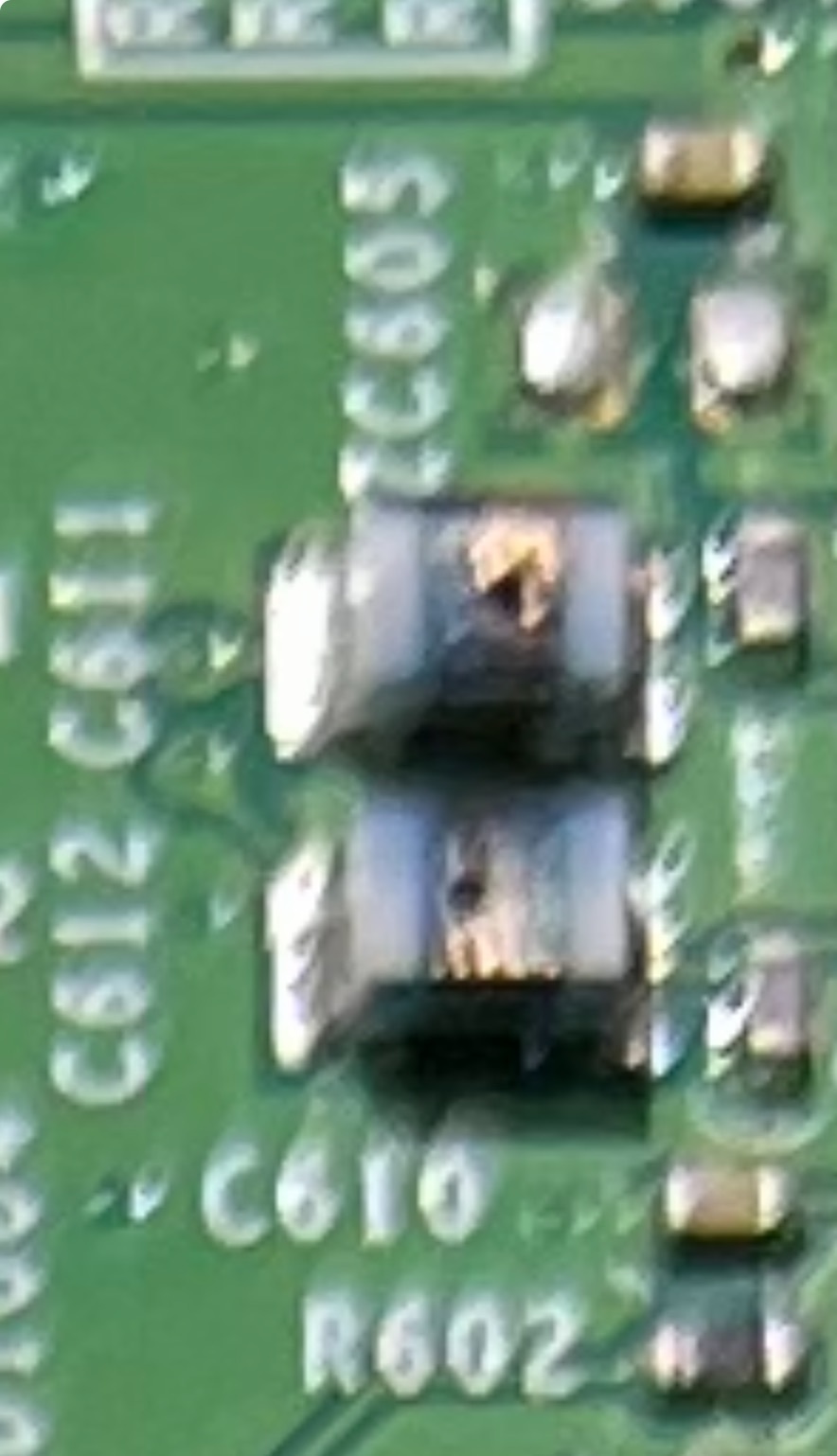

                                  Those caps do look rough. That was a good catch. I took a picture of those caps as close as I could. The second picture is the original posted above, but enlarged. It looks even worse, but I wonder if that could just be the photograph.
                                  Any idea what the value of those caps may be? I'm not sure I'm up to replacing surface mount caps free hand. I worked in component level circuit board repair decades ago (1998) and used a microscope to replace these kinds of parts as well as multi legged chips. I don't have access to that kind of equipment, and my 55 year old eyes aren't what they used to be!

                                    These are coils, chokes.

                                      yes L601 602

                                        Firmware upgrade made no change. USB exhibits the same symptom (both before and after the firmware upgrade).
