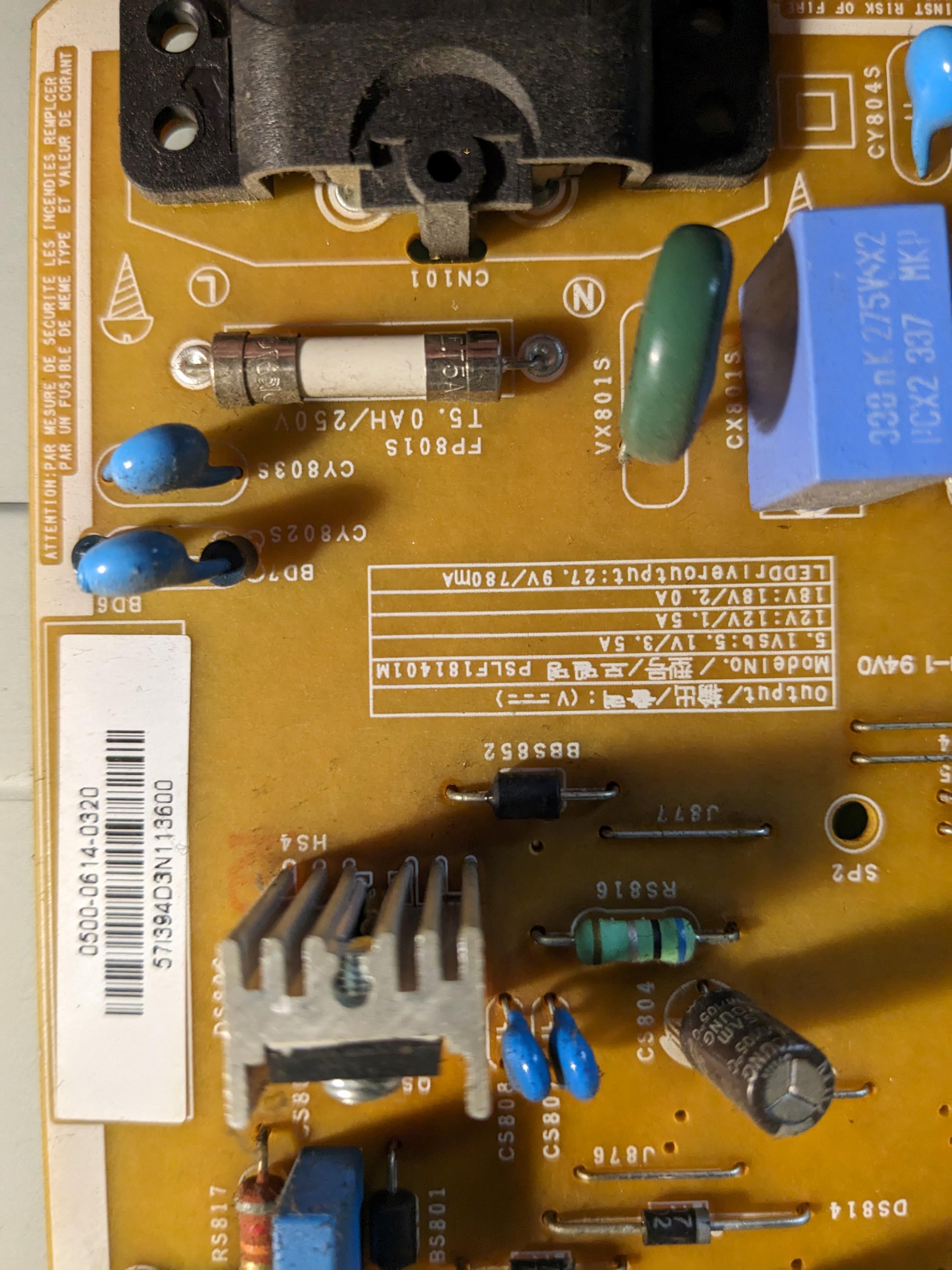

    Which power supply is in it? post pictures so we can see what we are dealing with.
    The first voltage you need is the standby voltage, if it is missing nothing works.

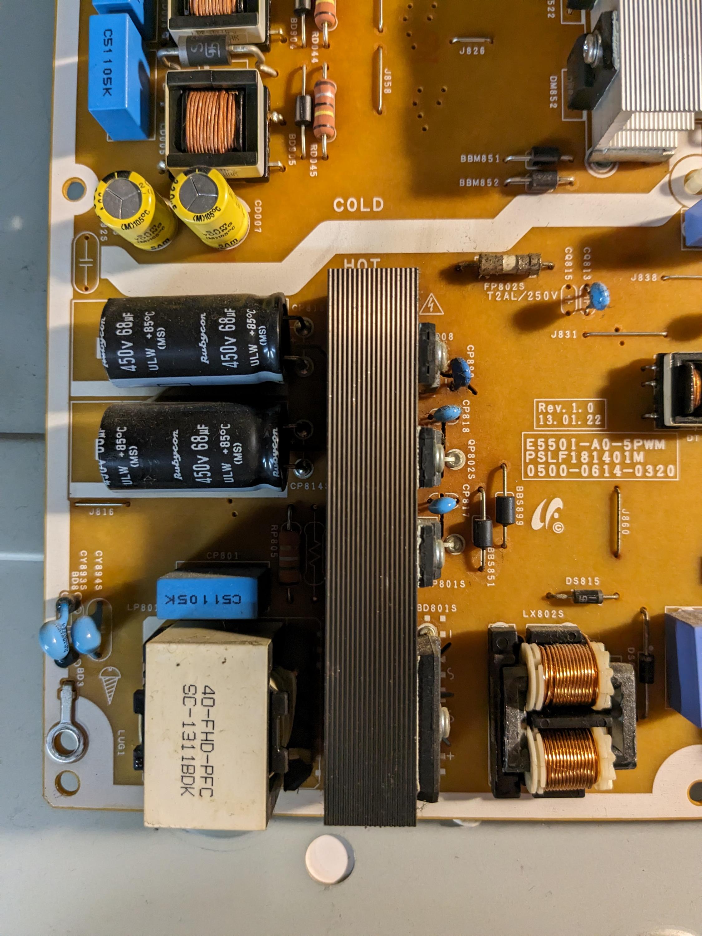

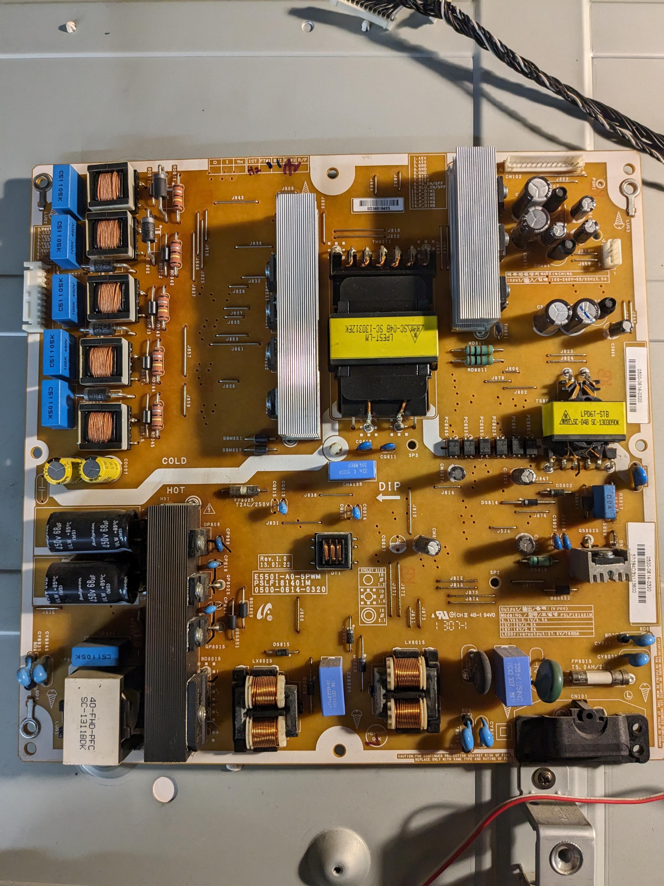

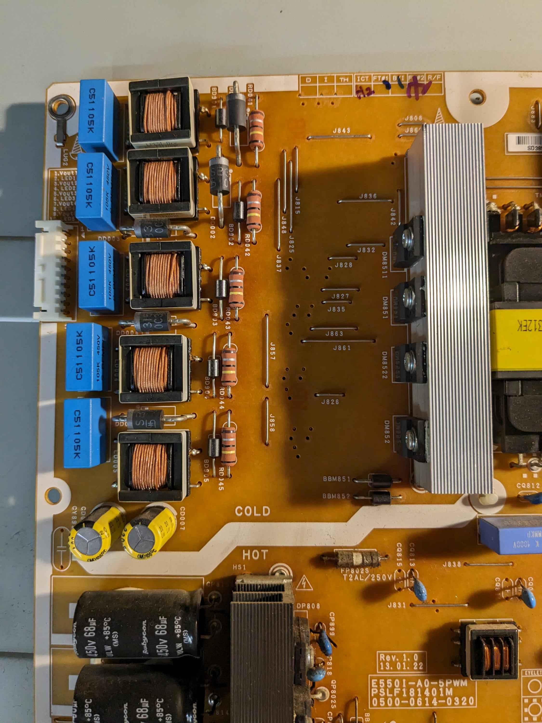

      Pictures are attached. Thanks for the reply! I can post pics of the bottom later if needed.

        Re: Vizio E550i-A0 no power, no standby light
        Check FP802S fuse, if it is good, Check if you have A5V on J807 jumper or pin 1,2 of cn102

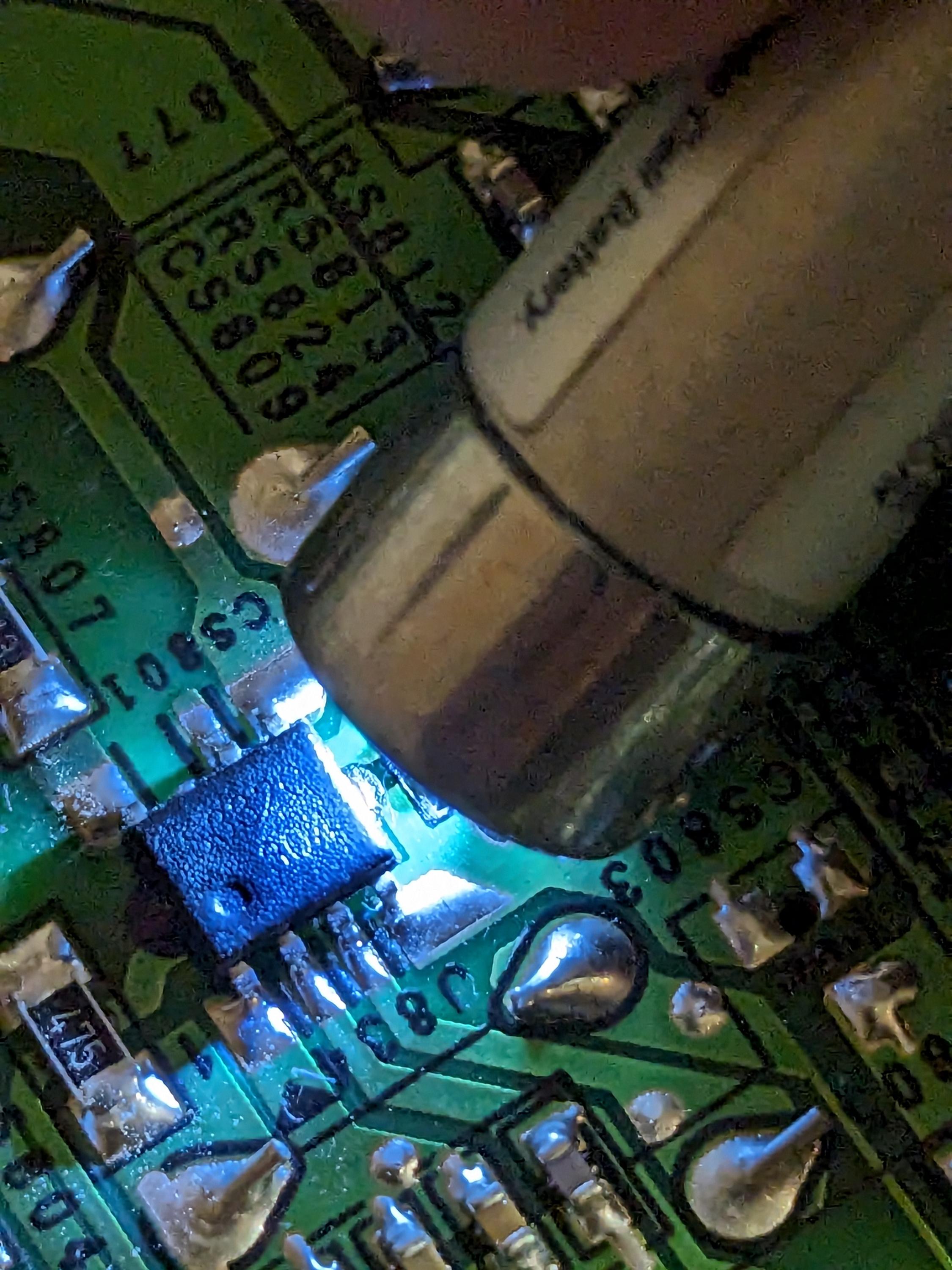

                          I can't really make our exactly what it says. Check the attached pic and see what you can read. I can definitely see the numbers but can't differentiate between S 3 and 8.
                          It looks like it might say S3320 and 304
                            Looks like a S3320, same as SEM3320, I don't see a datasheet but I suspect the ic is ok,
                            CS804 is the vcc capacitor, the ic will provide a small current to charge the cap, then DS802 supplies the run voltage, so check that diode, and check RS815 [000] 0Ω resistor. The normal run voltage across CS804 is likely around 15~20vdc
                            You may also want to check that RS807, RS806 and RS805 (243, 24KΩ) are good, sometimes one of them can go open, also RS802, RS803, RS804 (475, 4.7megΩ)
                            And check that the standby output diode DS853 is not shorted, It is likely ok but worth checking that it is not killing the standby voltage

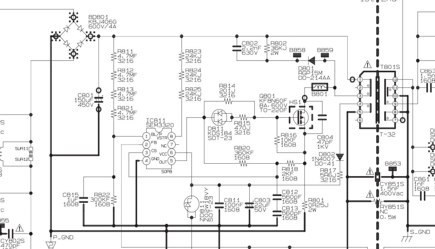

                                    x_orange90_x , this schematic is for the standby circuit and is very close except for the component id's IE C803 = CS804; D802 = DS802
                                    Also this schematic does not have a pfc circuit like your board does, yours will have an additional supply (DS814) off the standby circuit to feed the pfc circuit vcc.
