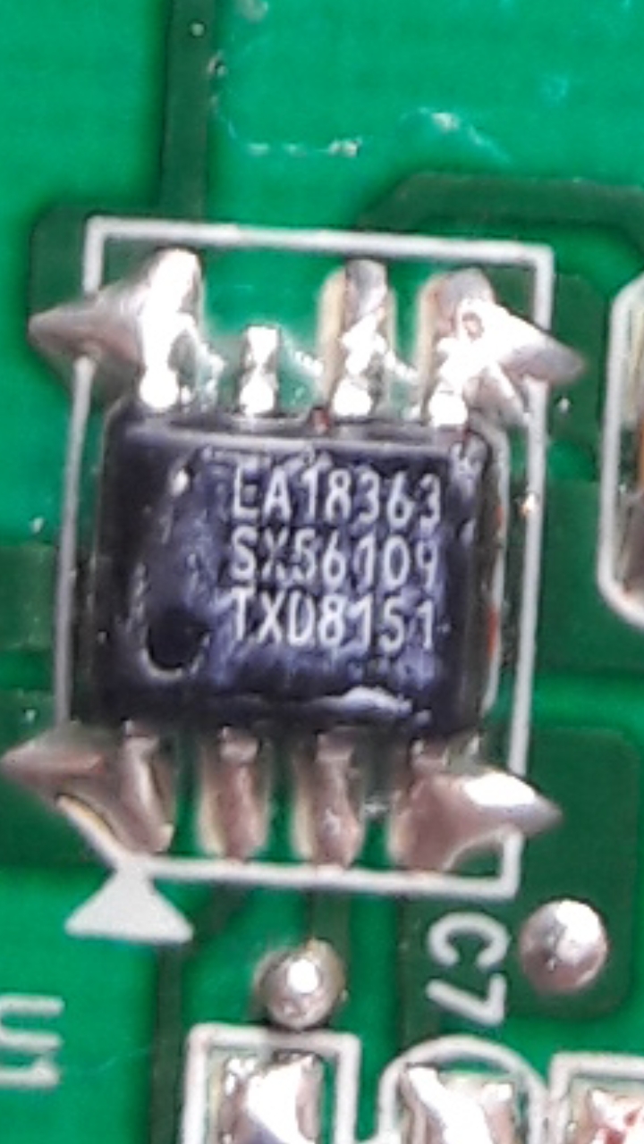

                            I was finally able to melt the glue or resin or whatever off the U1 IC. Here is a pic of the number and I will post a datasheet that I think belongs to it.

                              Datasheet
                              https://cdn.badcaps-static.com/pdfs/...8c3268d871.pdf
                                #55
                                Re: VIZIO D60-F3 Wont Power ON, No Standby, No Picture, No Sound
                                TEA18363 spec.

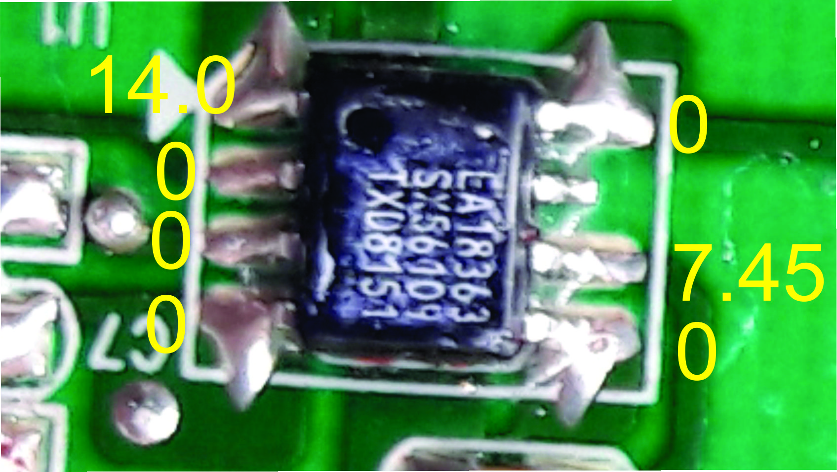

                                Use negative leg of the main filter cap (450450VDC rated cap) as the ground ref. for the Hot side circuit, then report the VDC reading of each pin of the IC.
                                Be real careful since you are working in the hot deadly side of the circuit so do not touch anything with your body or your hands, at least plug this power supply board by itself into the GFCI outlet, no need to have any other boards connected to this power supply board, also do not let the meter probe slip on you.
                                  #56
                                  TEA18363 spec.
                                  Tested a few times here is what I got.

                                      #58
                                      That is strange that you do have more than enough VCC (14V, per spec sheet the Vstart is between 13.4 ~ 16.4V) for the IC to run, and once it is running the Vcc is supplied by the Aux winding of the transformer to keep it running.
                                      But I also do not expect HV pin to be 0V since it is fed through resistor network so it should have Voltage at that pin.
                                      Right now the IC is dead bu that VCC of 14V is coming from some where.
                                      Normally at startup the HV provide the Vcc to startup the IC and once it is running the Vcc is provided by the Aux winding. Something is not making sense right now.
                                      I would check the resistors connected to HV pin 1 to see if they are OK or not, also check the resistance between hot side circuit ground and IC pins.
                                        #59
                                        Ok you were correct, it didnt make sense. I put the IC back under a microscope and scraped a bunch of that coating off that was originally on the top of the IC and it was on all the pins too so it was insulating the HV pin from reading. It was like liquid resin or hot glue. At any rate I am reading 103V at HV now that it reads.
