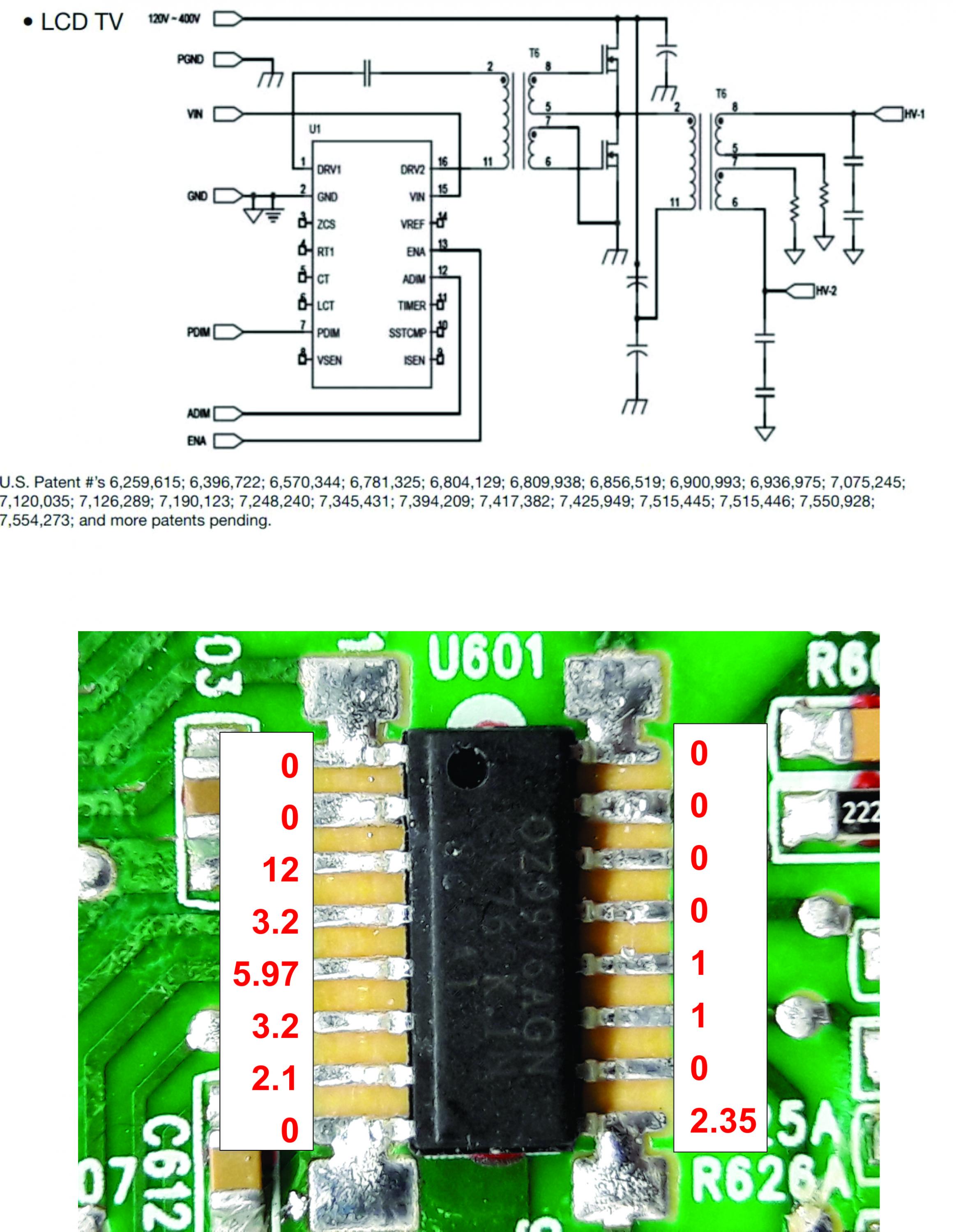

        Re: TCL 65S517 No Backlight, Picture and Sound OK
        Originally posted by budm
        What Voltage do you get on pin 5 and 6 of TS3, and pin 1 and pin 16 of the OZ IC with ref to GND?
        Hi Budm, I get -35 mv on pins 5 and 6 of TS3, I included a diagram of what every pin is reading on the OZ IC next to its diagram
          #44
          So there is no activity at those pins of TS3.
          The confusing part is that the application circuit pinout does not match the actual part, I.E. the VCC pin, the ENA pin 13, etc. but at least the GND pin and the transformer driver pins do match.
          So does the the Voltage on pin 4 (ENA per RJ) change state when TV is OFF and when TV is turned ON?

              #46
              SO as far as TS3 goes, pins 5 and 6 are 0v when off and go to -36mv when the set is turned on.
              Pin 4 (being 4th pin down the left side in the pic) goes from 0v off to 3.2 mv when ON.
              Pin 13 (being 4th pin down on the right side of the IC in the pic) goes from 6mv OFF to -35mv on.
              Could this thing be diagramed upside down or something?

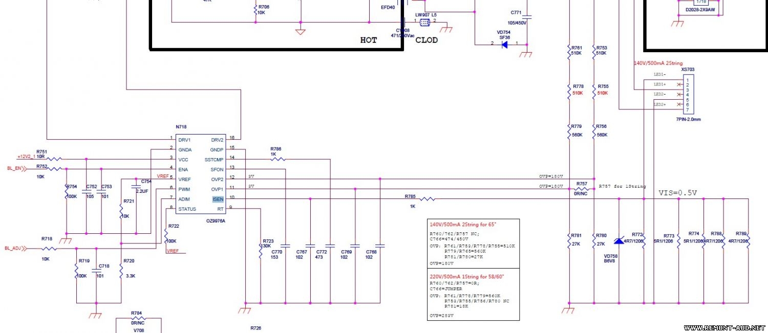

                #47
                I think I found the correct pin out for OZ9976AGN
                So pin 4 is ENA (BL-ON), so do you mean 3.2V, not 3.2mV when TV is on, correct?
                The IC has VCC, ENA, PWM control all present but it still does not drive the TS3 transformer.

                  #48
                  Yes your schematic makes more sense. Mine was right from O2 Micro datasheet idk whats with it.
                  Yes pin4 (as per your schematic) gets 3.2V with the set on.
                  At TS3 it gets a few mv while off and goes to -35mv when turned on.
                  Does signal/Voltage travel through TS2 and QW3/4 to get to TS3 or the opposite? I dont know much about circuit flow I am just looking at the physical pathways.

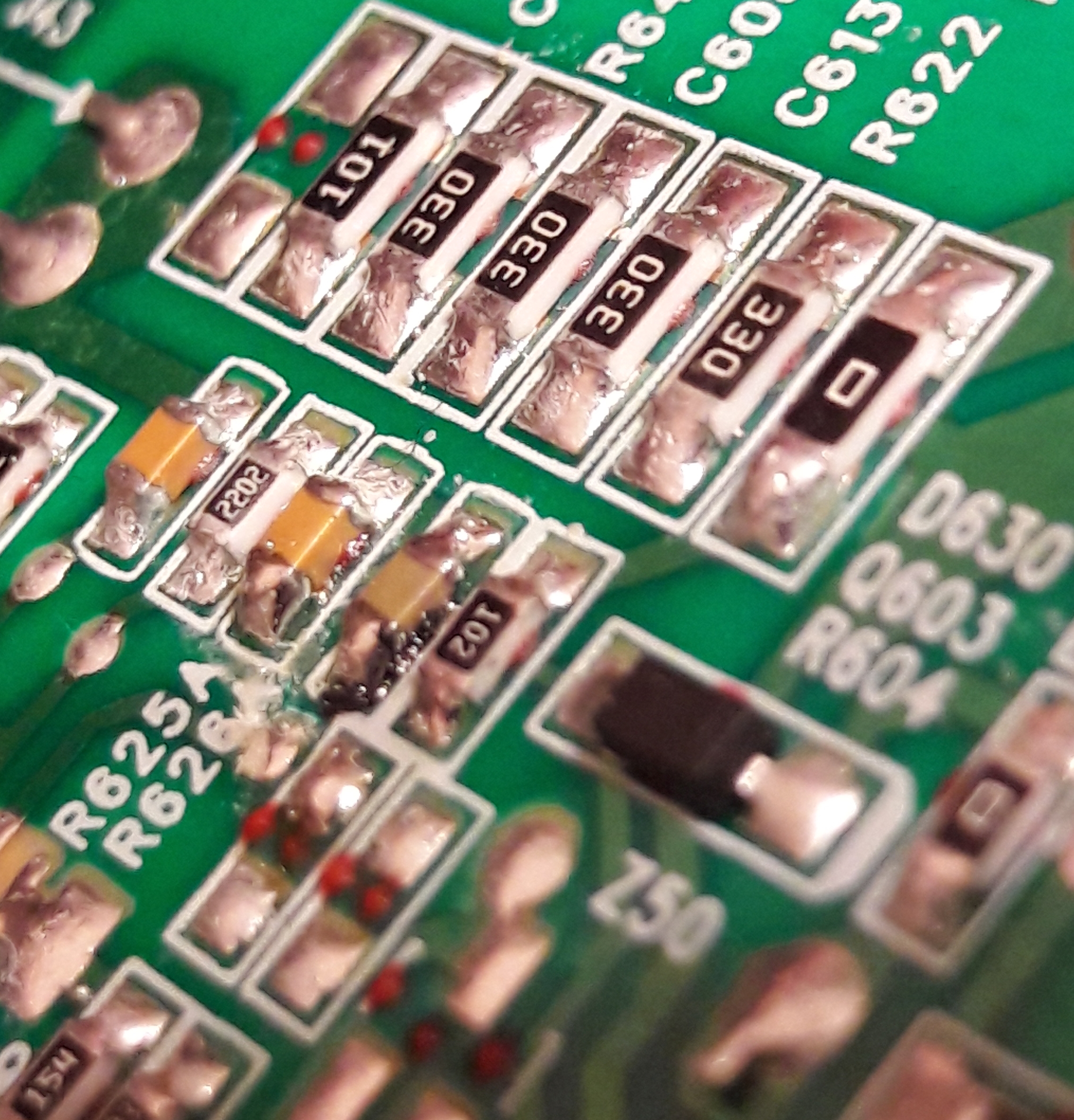

                                  #56
                                  What's going on with C412, C431 and C432? They look ill, what's on the top of them? If that's leakage then they are shot.
                                  • rebelkustoms
                                    • Sep 2015
                                    • 150
                                    #57
                                    Those are all fine. Must be a bad pic. Just for fun I desoldered and checked them all with my ESR and they are all 3 good.
                                    • rebelkustoms
                                      • Sep 2015
                                      • 150
                                      #58

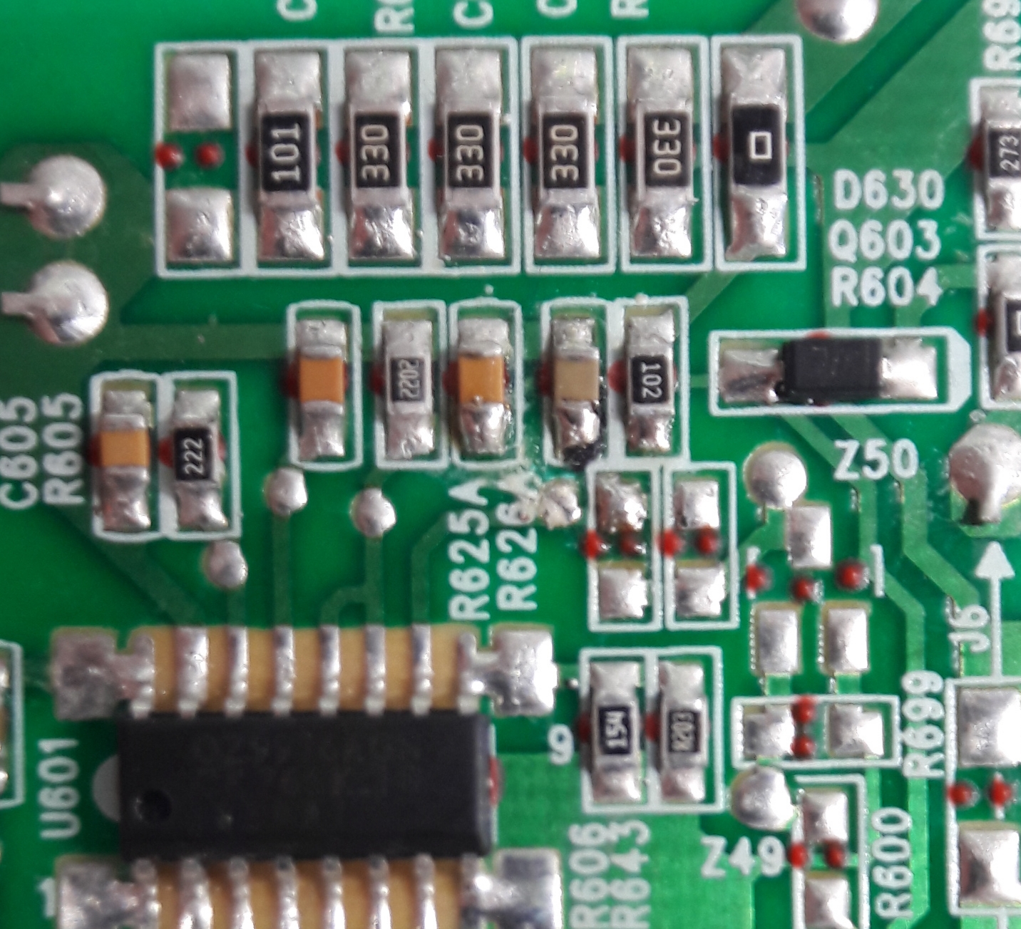

                                      So I kinda ran out of things to test on this thing so I was visually combing over the board. Paying attention to the area around the OZ 16 pin IC. I was testing these 330 resistors and they are testing around 7.8 Ohms which from what I understand is pretty off.
                                      Then I saw this surface mount cap next to them right near the IC and it looks like it is leaking black. It took FOREVER to get a good pic but I think you can spot it here. Let me know what you think. There looks to be some corrosion nearby too.
                                      • vinceroger69
                                        • Mar 2012
                                        • 6714
                                        • uk
                                        #59
                                        i would certainly change that smd capacitor (certainly discolored etc) you should be able too remove and measure one of the other ones so you can get a replacement
