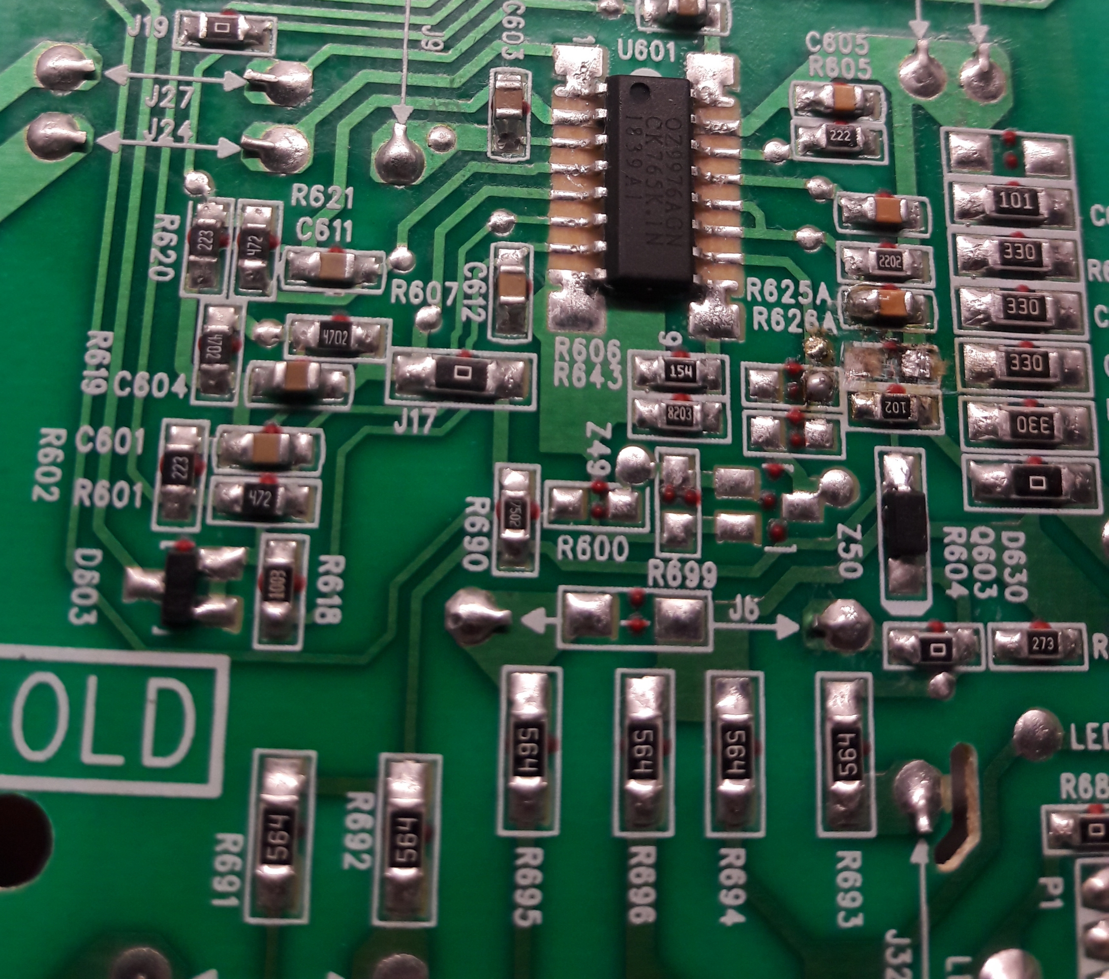

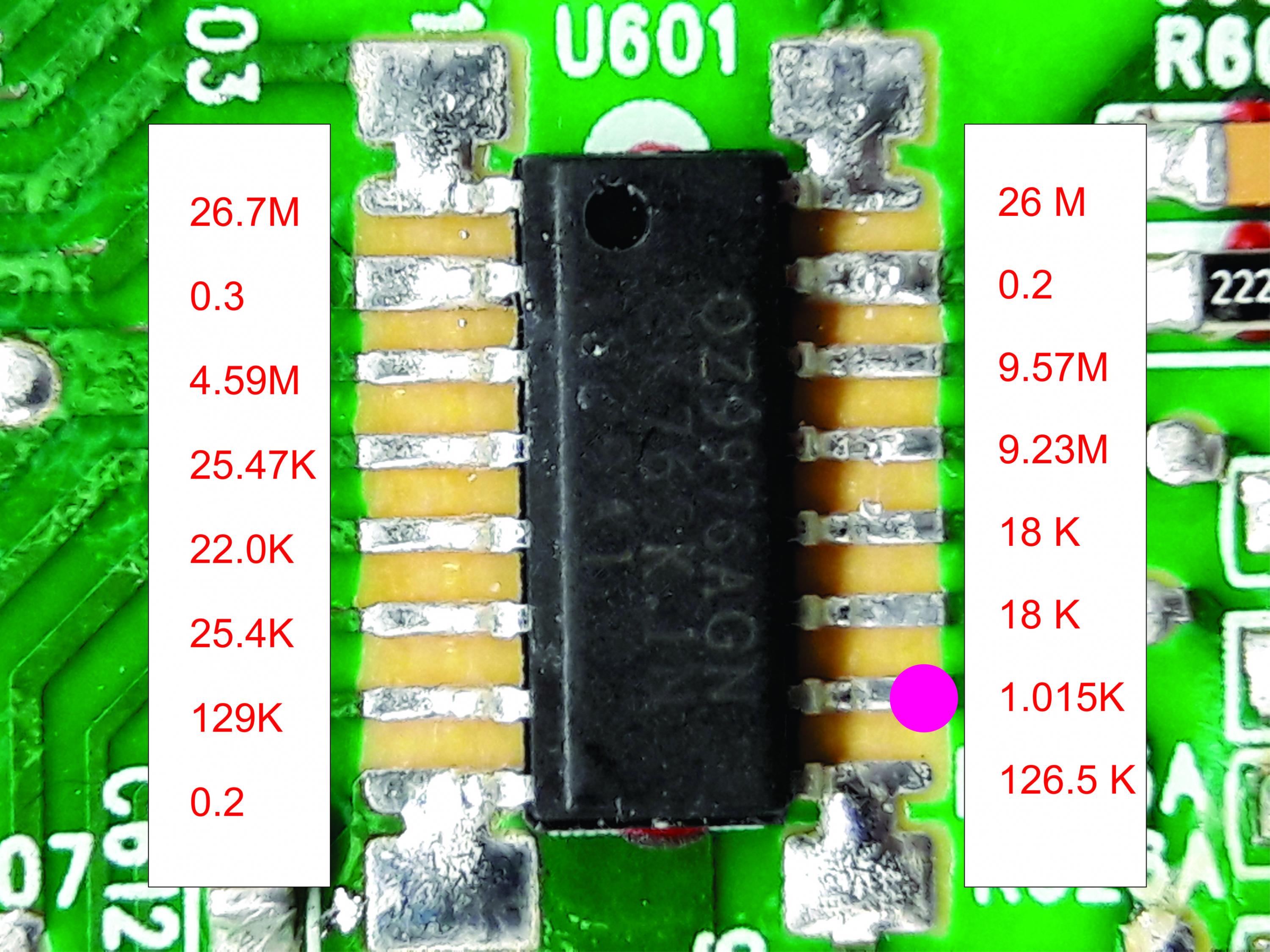

    I tested them all. Here is an attached picture. the pin with the PINK DOT leads straight to the Surface mount cap that I pictured earlier that I desoldered so it seems to have a weird reading. It took the solder pad with it so....shit. But let me know what you think and where you are headed with this.
    I am not above buying another power board but I am not seeing my series for sale. There is a model that looks identical but not sure if it will work. Yhanks for the help as always.
        Pin 8 (Status) shows as 0.2 Ohms?
        if it is that is not right based on the diagram.
        https://www.badcaps.net/forum/attach...9&d=1602826861
        Can you see what are connected to pin 8?

          Re: TCL 65S517 No Backlight, Picture and Sound OK
          That is correct. I tested again and it only show .2 ohm. I included a good pic of that are on the board. It looks like it may lead through the capacitor to the right C612. It also looks like the trace supplies those 2 resistors R6060 and R643 and maybe leads through Z49.
            #65
            It looks like pin 8 is tied to ground, so that resistance is correct.
            Can you leave your Voltmeter (Set meter to 200VDC scale) probes Red on Cathode of D615, Black on Anode of D618 then turn on the TV while watching the meter to see if there is any activity.

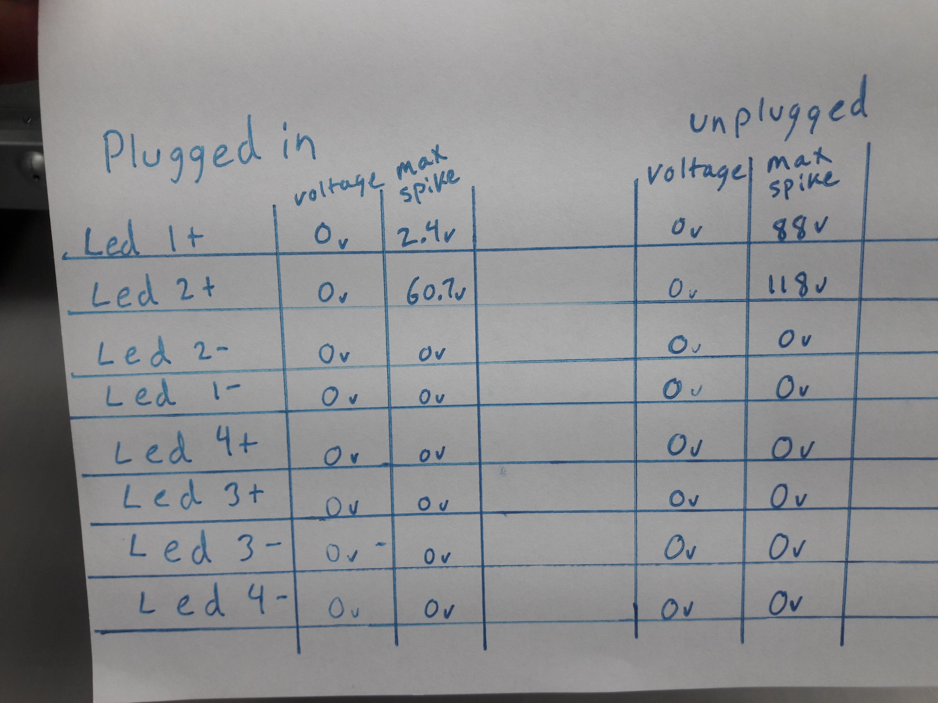

                    In your post #1:
                    I checked the red and white and black and brown cable pins coming from the bottom left PS board (guessing by where they are running these are the LED supply lines) I have 0v on all of those while powered on.
                    Repeat the test of your post #1 on the LED connector LED connector in place and not in place, make sure to keep the meter probes (Black on chassis, Red on each pin of the LED connector at a time) in place before turning on the TV, do the test on each pin of the LED connector.
                      See attached
                        #71
                        OK, so the Voltage on the LED connectors are not all 0V after all which throw us off on troubleshooting based on the reading in post #1.
                        The one on LED1+ when connected looks really bad.
                        Do you have LED tester? At this point we need to test the LED strings.
