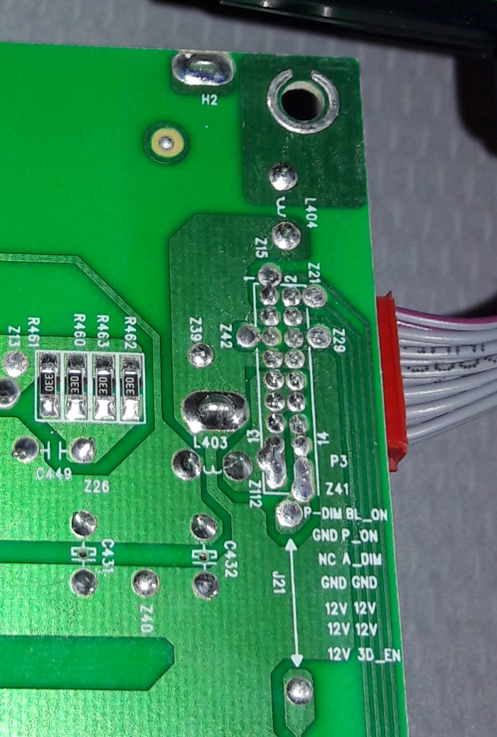

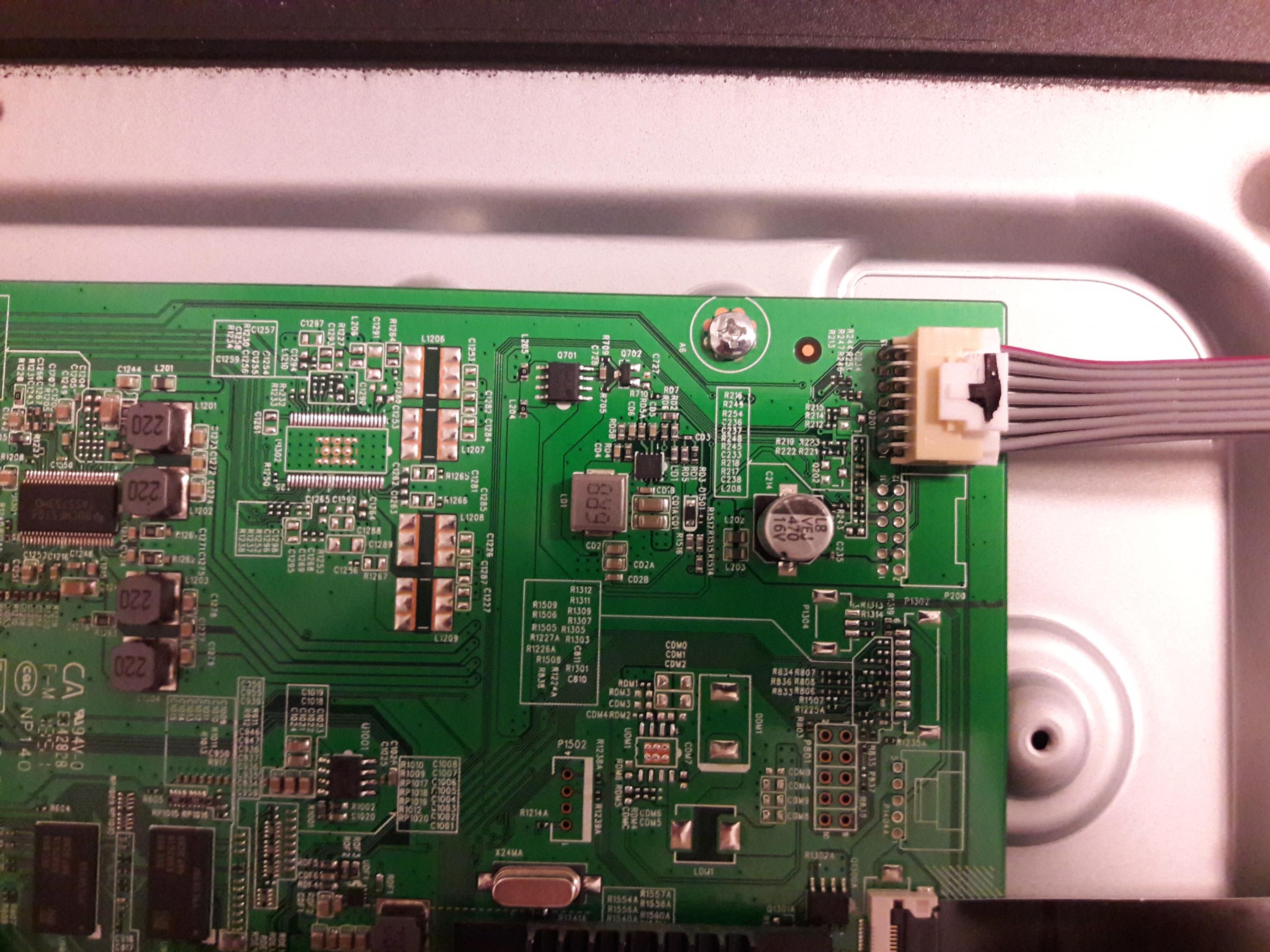

      There are 14 pins on that red connector,
      Your report on the pins does not help since you do not provide the pin number and also you should look at the bottom side of that power supply board to see if they print the pin names on the bottom side of the board.
      • rebelkustoms
        • Sep 2015
        • 150
        Re: TCL 65S517 No Backlight, Picture and Sound OK
        Sorry, I flipped the Main Board when I was first testing to look for pin outs, I hadn't noticed this cord had a double pin set. my mistake. here are voltages and a picture of the bottom of the PS for reference.
        P-Dim=3.26v BL_ON=3.26v
        GND= -34mv P_ON = 2.34v
        NC=0 A_DIM=12mv
        GND=-35mv GND= -35mv
        12V = 12v 12V = 12v
        12V= 12v 12V= 0v
        12V= 12v 3D_En= 0v

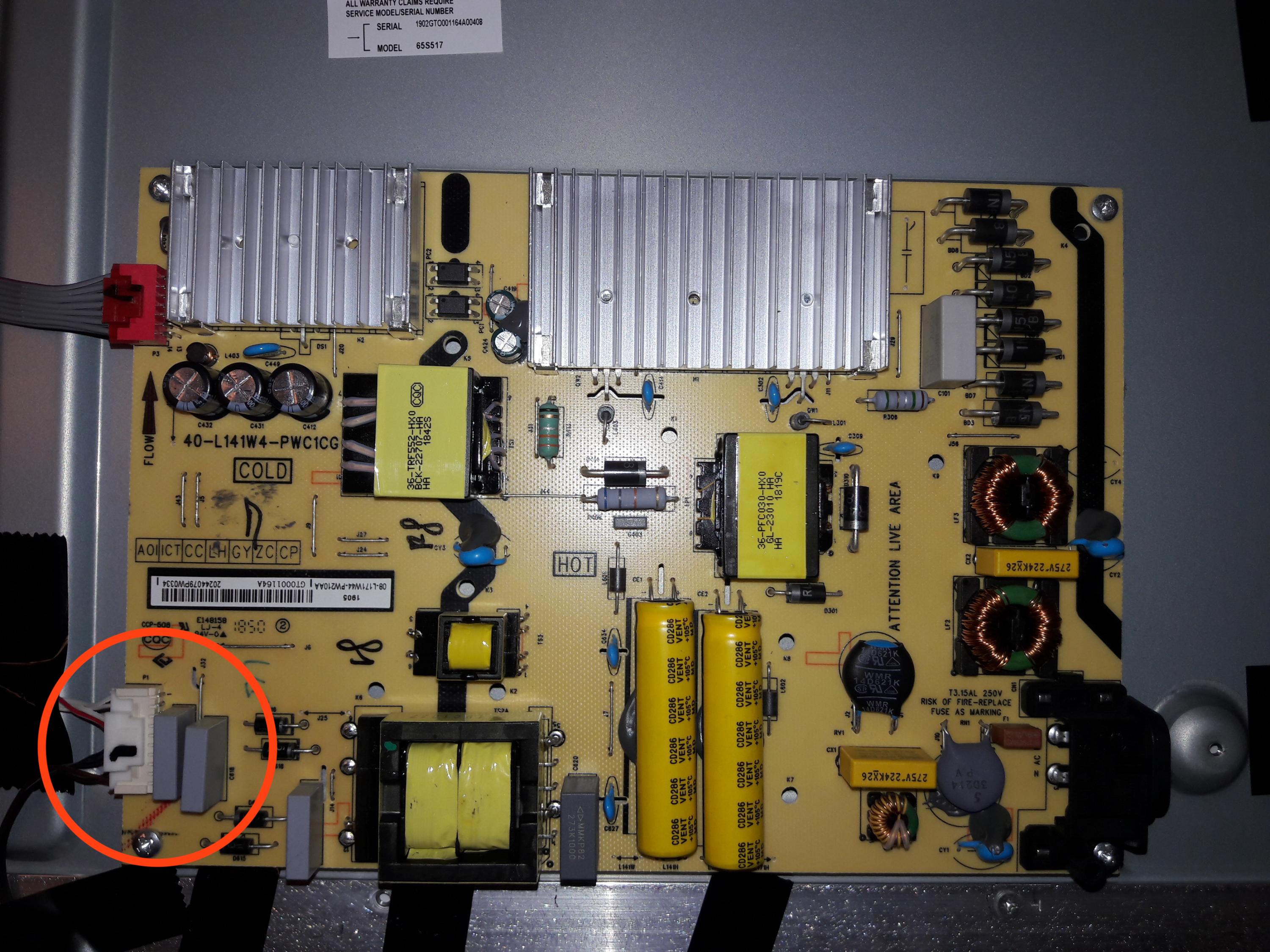

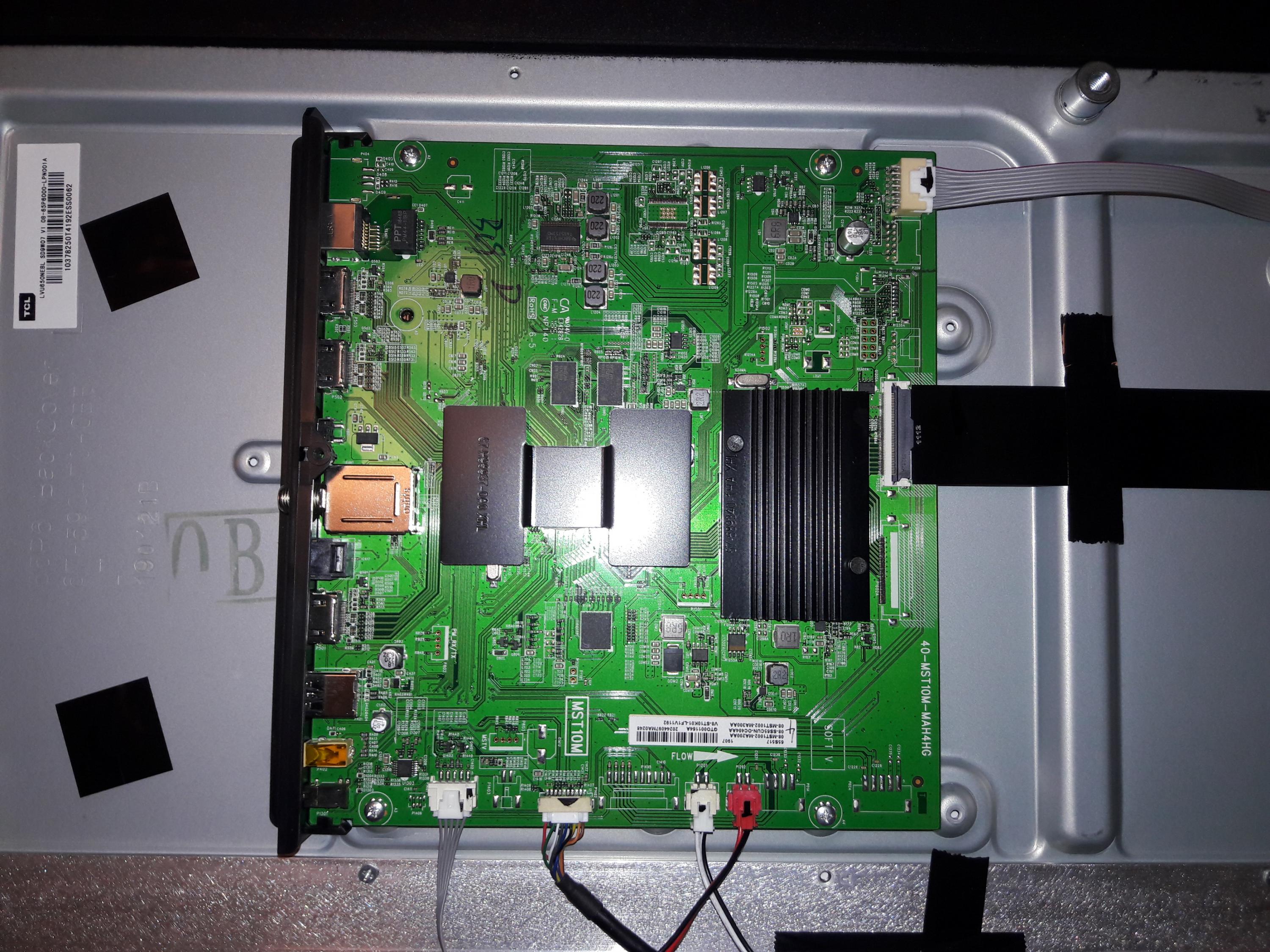

          Pics

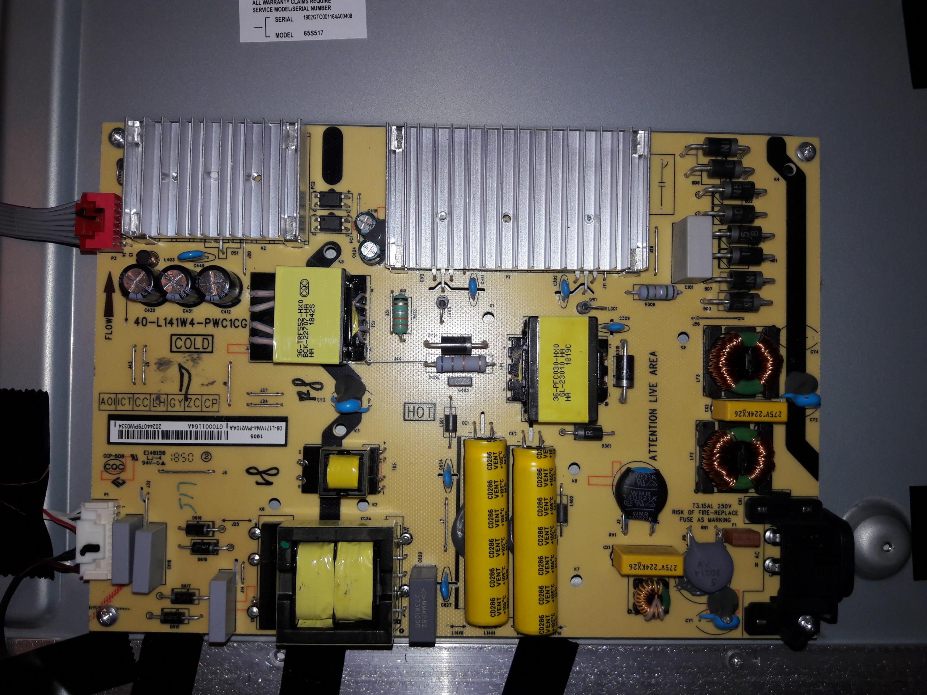

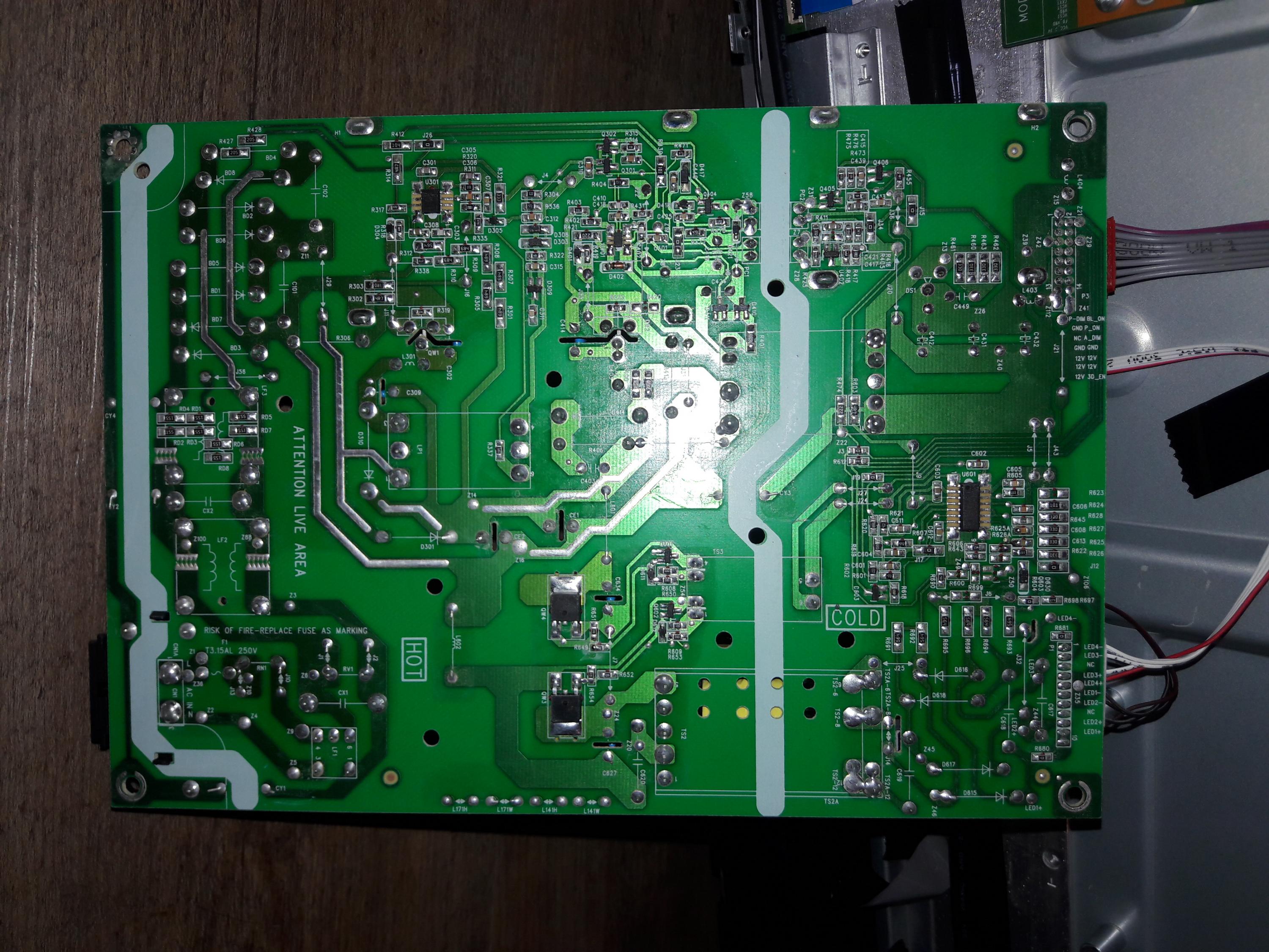

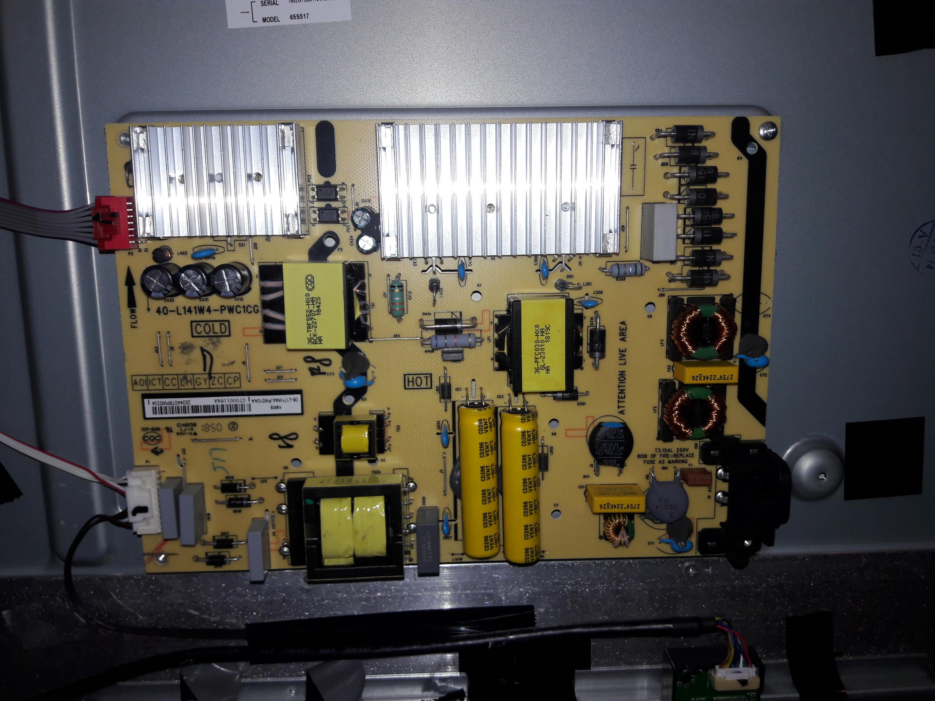

            Lets see good clear straight shots pictures of the whole bottom side of the power supply board so we can see if the LED connector has pin labels or not.
            • rebelkustoms
              • Sep 2015
              • 150
              Here are the front side and back side photos
              • rebelkustoms
                • Sep 2015
                • 150
                I am not getting any voltage over a few mv on any of the LED backlight plug pins. Same with the LED Backlight plug unplugged. Should I try to test for continuity across the LED strip -/+?

                  while the set OFF remove the LED socket from PSU. and measure with Ohm the 2 SMT resistors R581 R580
                    Are you getting about 380 ~ 400 VDC measured between the two legs of the main filter caps CE1, CE2?

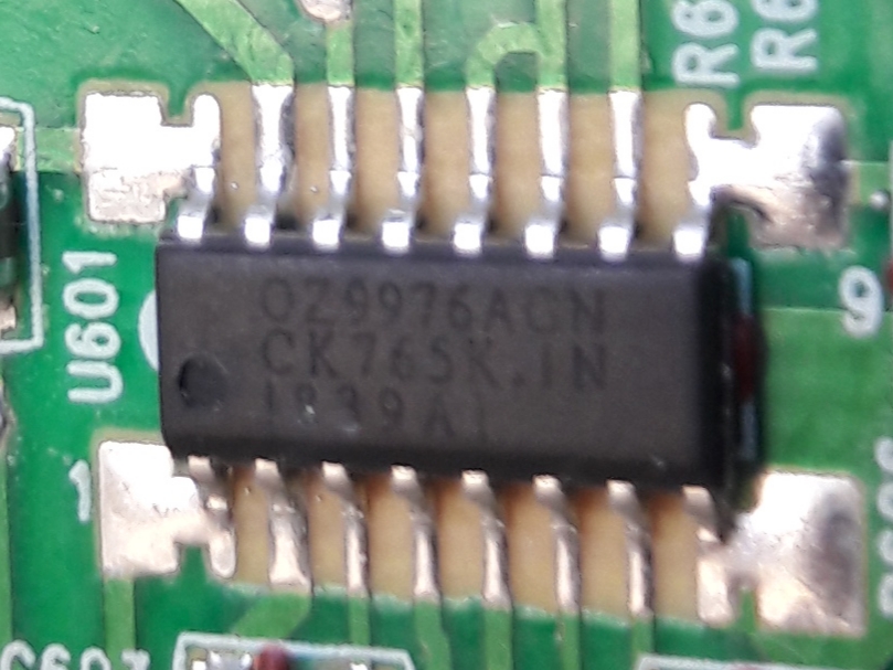

                              What is the P/N of the LED driver IC U601?
                              Also check that rectangular grey cap C620, it looks like one of the leg did not poke through to the bottoms side of the board.
                                    Here is what is on the IC from what I can read
                                    OZ9976AGN
                                    CK765K. 1N
                                    1839 A1
                                    Also that was just a bad picture angle on the Capacitor 620, Both legs are through the board and the joints look good.

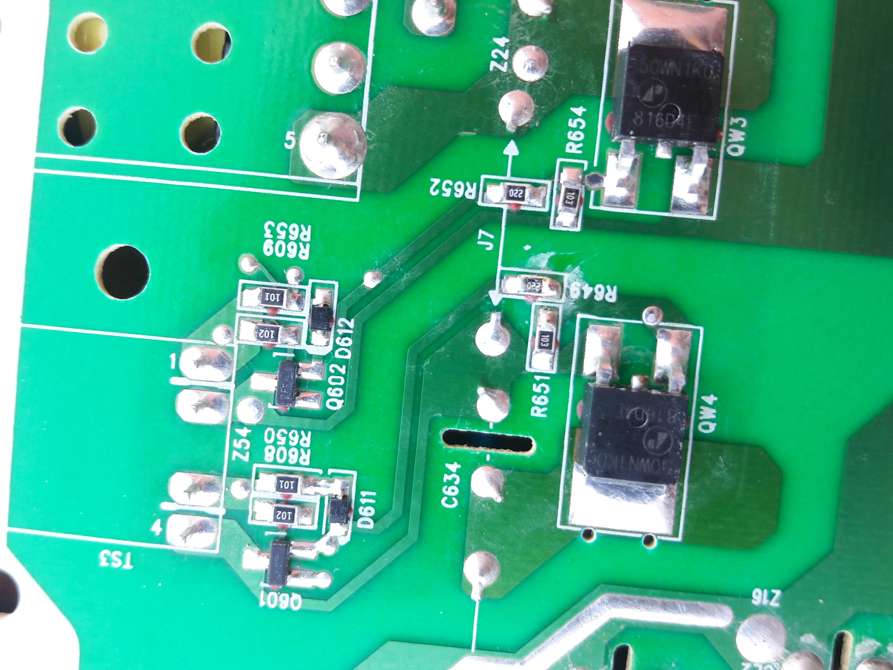

                                      I am about to resolder TS3, I included a pic there is a resistor on the hot side R649 that has some weird coloring around it. Not sure if it is flux or a light corrosion but it looks odd. Thoughts?
                                      Also when you say resolder the driver circuit what are are we talking about on the hot side?
                                      • Diah
                                        • Feb 2013
                                        • 6461
                                        you can do measure on QW3 /4 if there voltage.. be sure only to use HOT area GND probe
