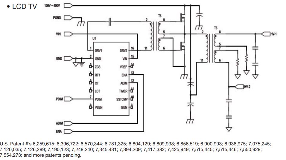

    TS3 is the Gate drive transformer for driving the MOSFET's QW3, 4.
    The primary side of TS3 is driven by that LED driver IC U601. I would not remove TS3 at this point.
    Need to look up the specsheet of U601 to locate the VCC pin and ENA pins to find out what Voltage it has on those pins.

          I pulled the spec sheet. I see the ENA pin, but which would be considered the VCC pins? Would it be one or both of those top driver pins? Sorry I dont read a ton of schematics. Mostly only on Pinball Machines.
            Re: TCL 65S517 No Backlight, Picture and Sound OK
            So what is the P/N of the IC?
            Vin = vcc

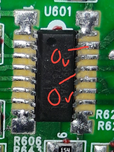

                Vin = vcc
                So if I am testing this right as per the picture i drew on, neither of those pin have voltage. I was guessing that 1 on the board denotes 1st pin on that IC.

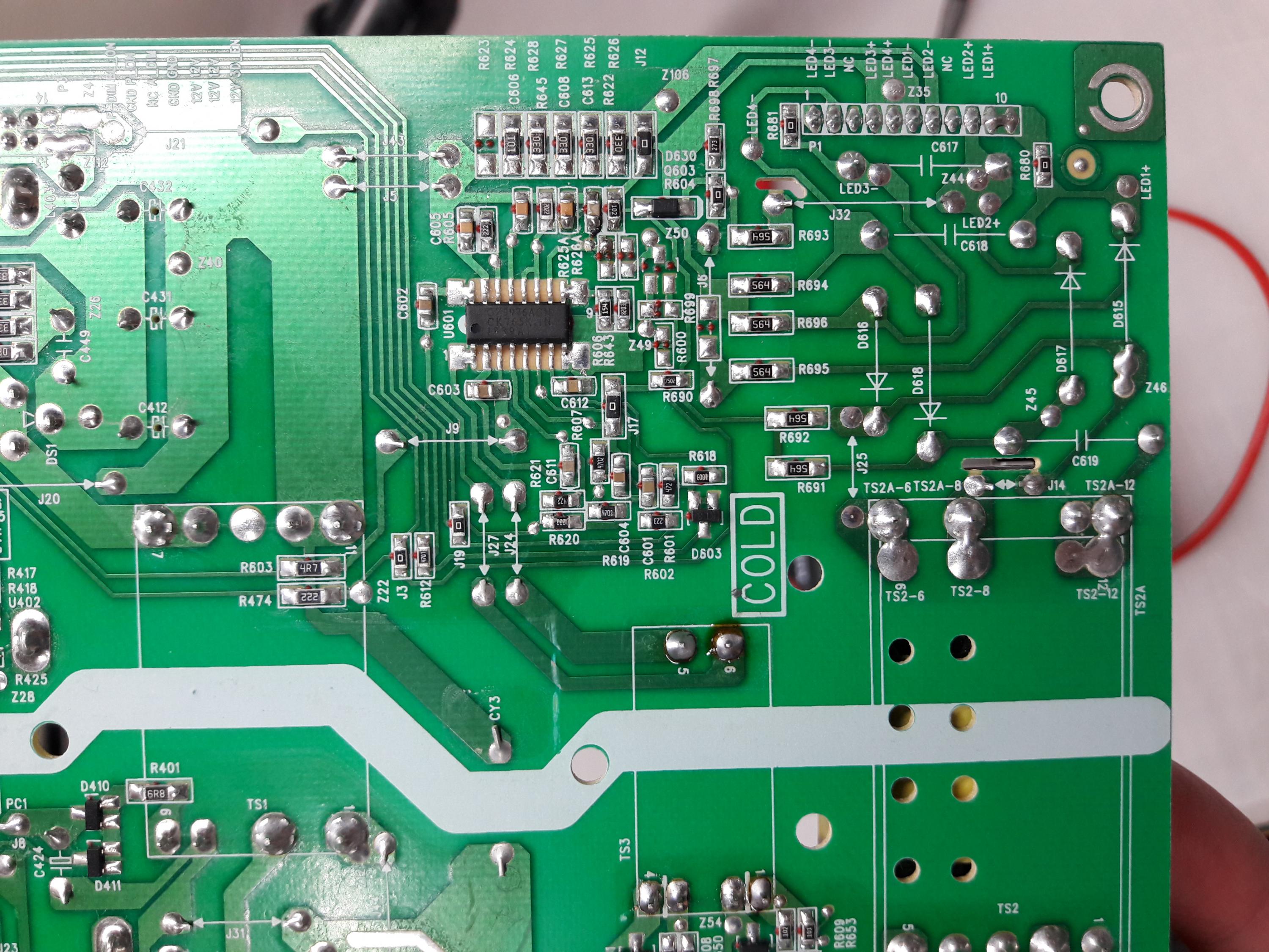

                  If you follow the trace from pin 15, it connects to J5 & J43, that is ground. I would check pin3 for VCC and pin4 for enable (BL_on)
                  Check the voltage between hot ground (L602) and VBUS+ (L601)

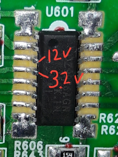

                    #29
                    So if I read that right I get P3-12v and P4-3.2V. The pins I tested are noted on the pic.

                      #30

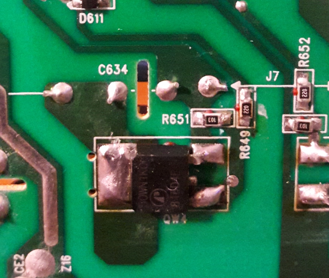

                      I think I spotted your problem... R649 (22Ω?) is blown/missing, it should be the same as R652. I suspect QW4 could be damaged as well
                      So you have good vcc and the enable is also ok, Check the VBUS voltage, careful this is the hot side of the power supply.

                        #31
                        Sorry the pic was kinda bad I guess. R649 is present and reads 22 ohm just like R652. I am not really sure where to check the VBUS voltage at and where to put my ground probe, Iam doing a few things I have never done yet here. Lead me there and I can test them.

                          #32
                          ok, it was just the picture. you can check the VBUS voltage between hot ground (L602) and VBUS+ (L601) But I suspect it is ok.

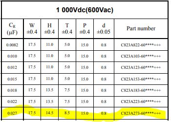

                            Checked the Vbus voltage and I get 396V between those 2. I desoldered the C620 cap. Im not really sure how to test one of these, I usually test the round electrolytics. I do have an ESR meter and a Klein DMM with capacitance but there is no farad values on the top of this cap. It doesnt look bulged but I cant find a video on how to test these that is in english.

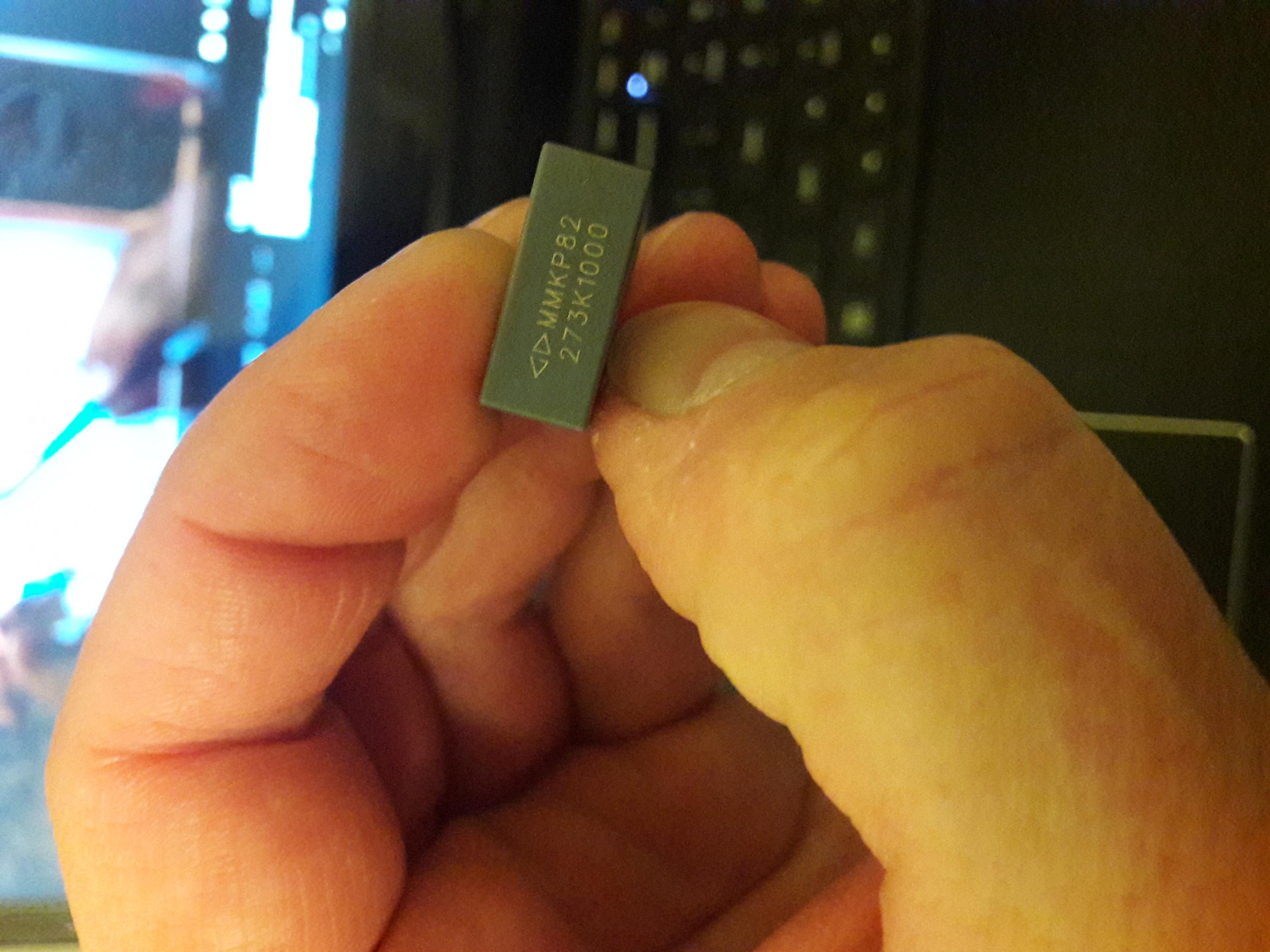

                              I think I found the Data Sheet. I decoded the cap to this line and it looks as if it should read .027uf. In capacitance mode on the meter it reads 26.96 nf so am I safe to assume it may be good?

                                #35
                                That capacitance is ok.

                                    #37
                                    Hi RJ, Do you have the link to that good clear pictures of the power supply board?
                                    It is strange that the VCC pin does not match the app schematic of the IC.
                                    At this point it looks like the IC is not driving the TS3 Gate drive transformer.

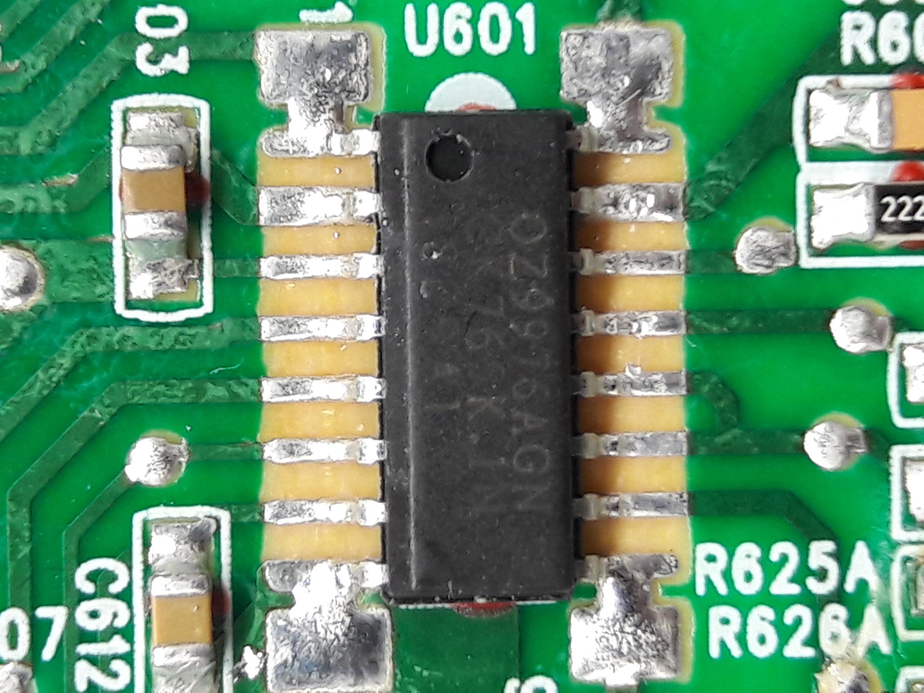

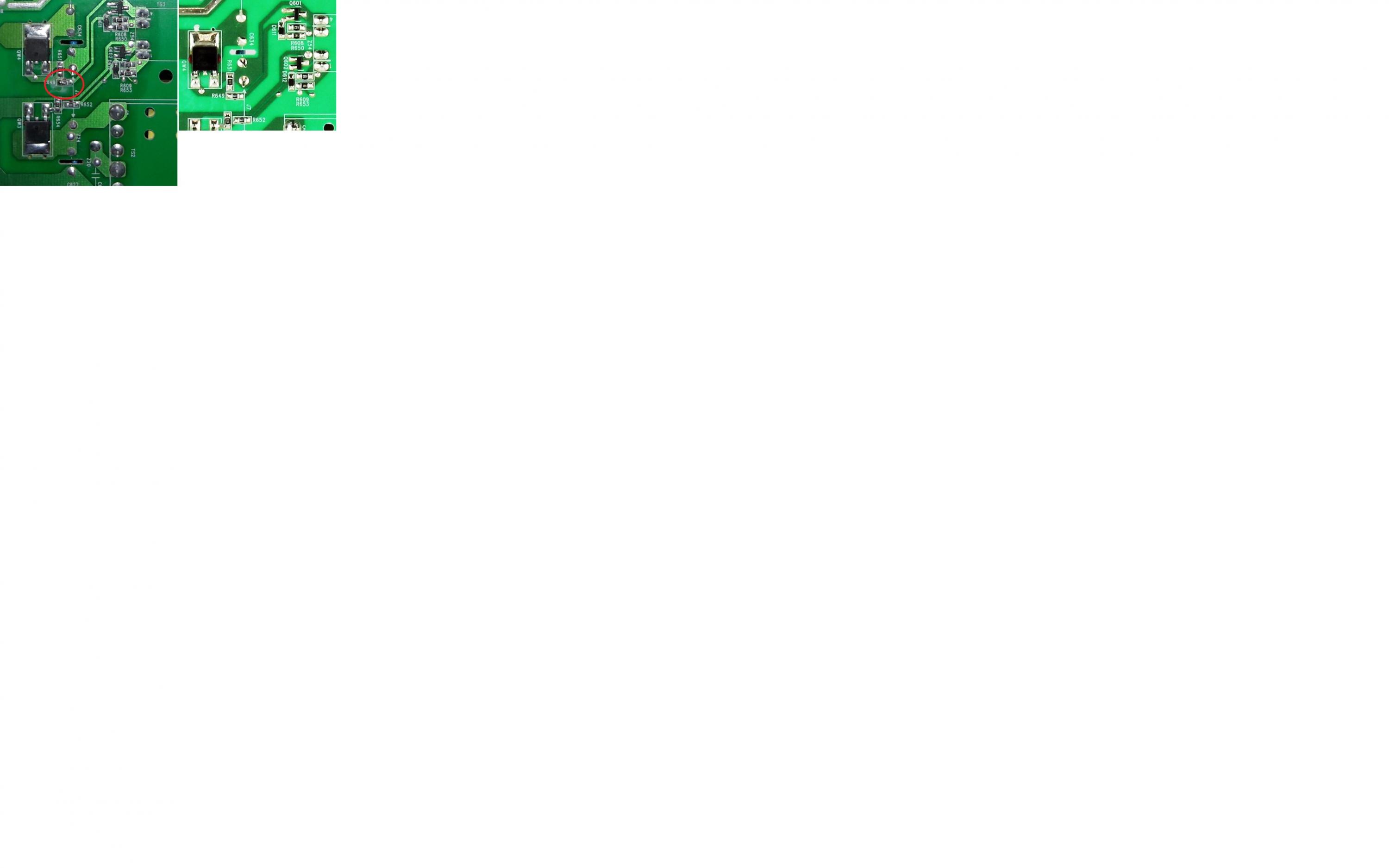

                                        #39
                                        Here is a better photo if you are trying to follow traces from the IC
