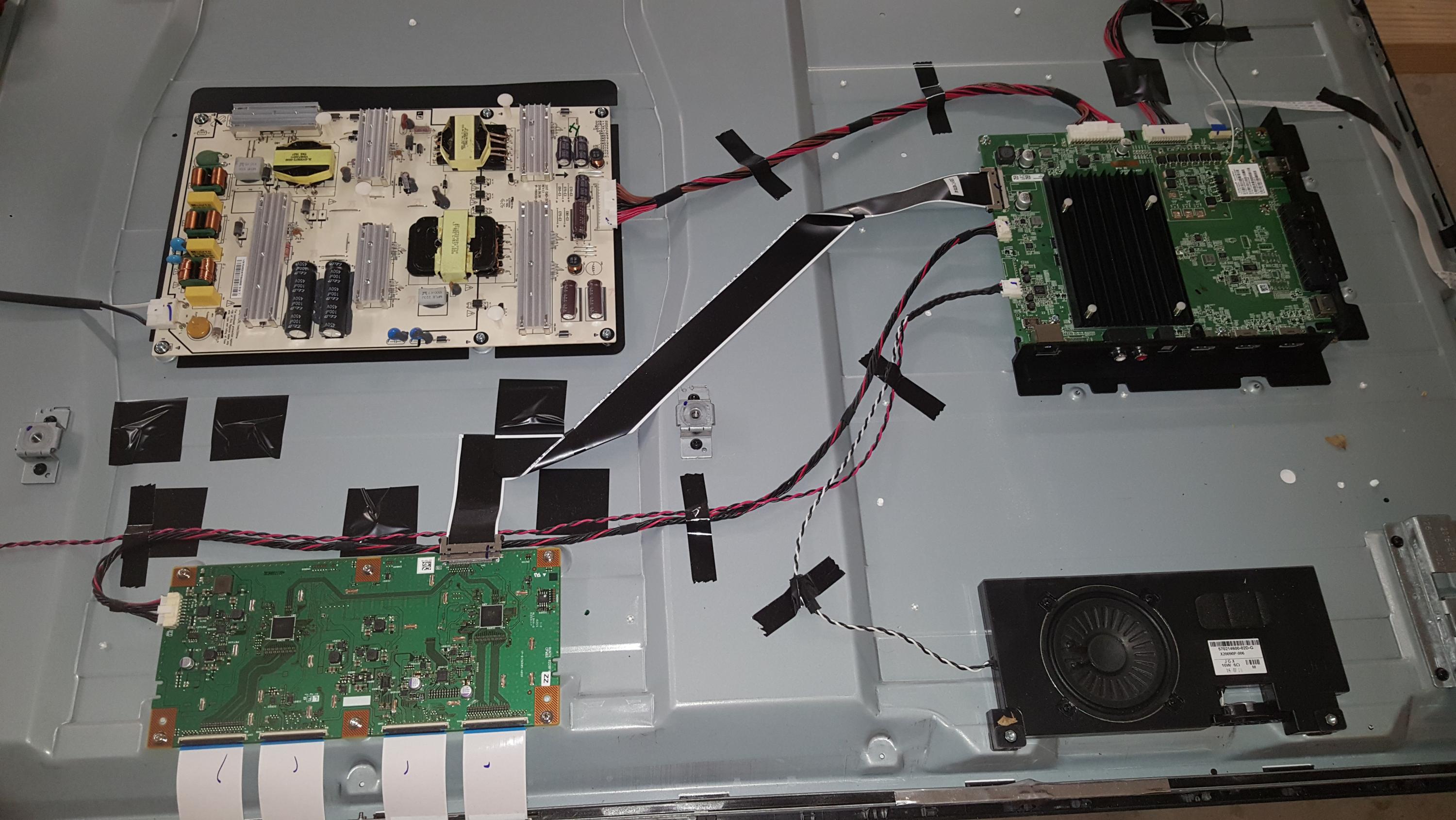

      Update: I pulled the back.
      The unit has a Power Supply Board, Main Board and I believe a T-Con board
      1) I tested the power supply connector going to the Main board. The LED power is 57v on 4 pins. The voltages are not listed, only LED Out on those 4 Pins and other listed voltages on the power supply board are correct.
      2)The connector on the Main board going to what I believe to be the LEDs has Zero voltage on 4 red wire pins pins.
      3)From the main board to the T-Con, there is 12v on 4 red wire pins.
      I am guessing that this is a main board issue but not 100% sure.

        you will likely get better response if you post picture of the back layout so people can see exactly how things are connected along with some good pictures of the boards in question.

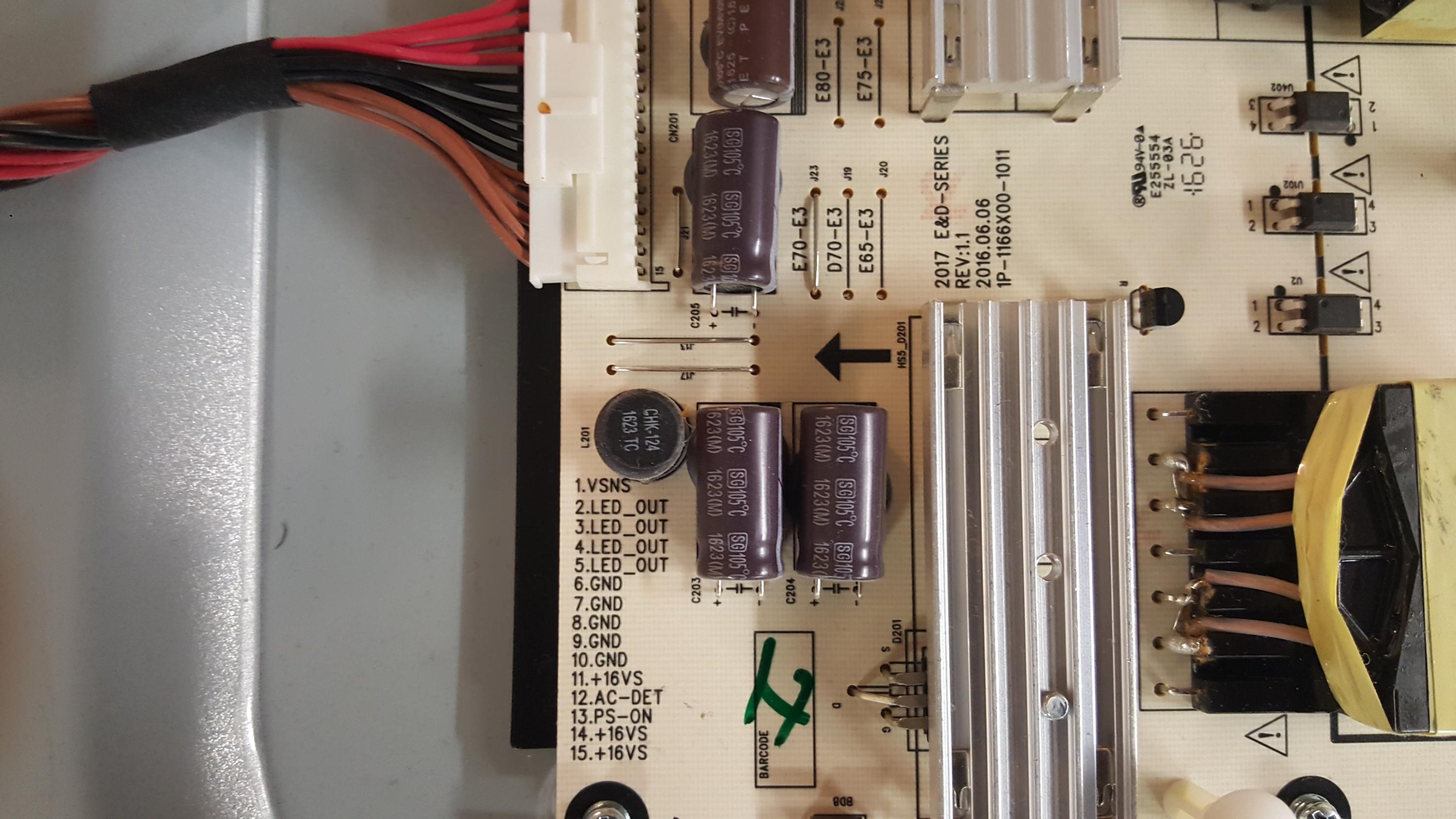

                    Re: Vizio E7-E3 Black Screen
                    Shopjimmy pic. of powerboard. https://www.shopjimmy.com/vizio-09-7...ard-e70-e3.htm

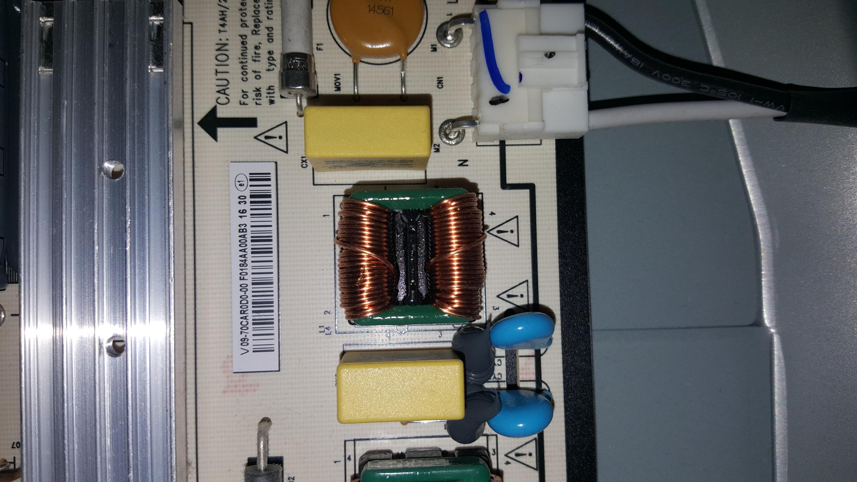

                            Here is the bar code label of the power supply that is on this unit.

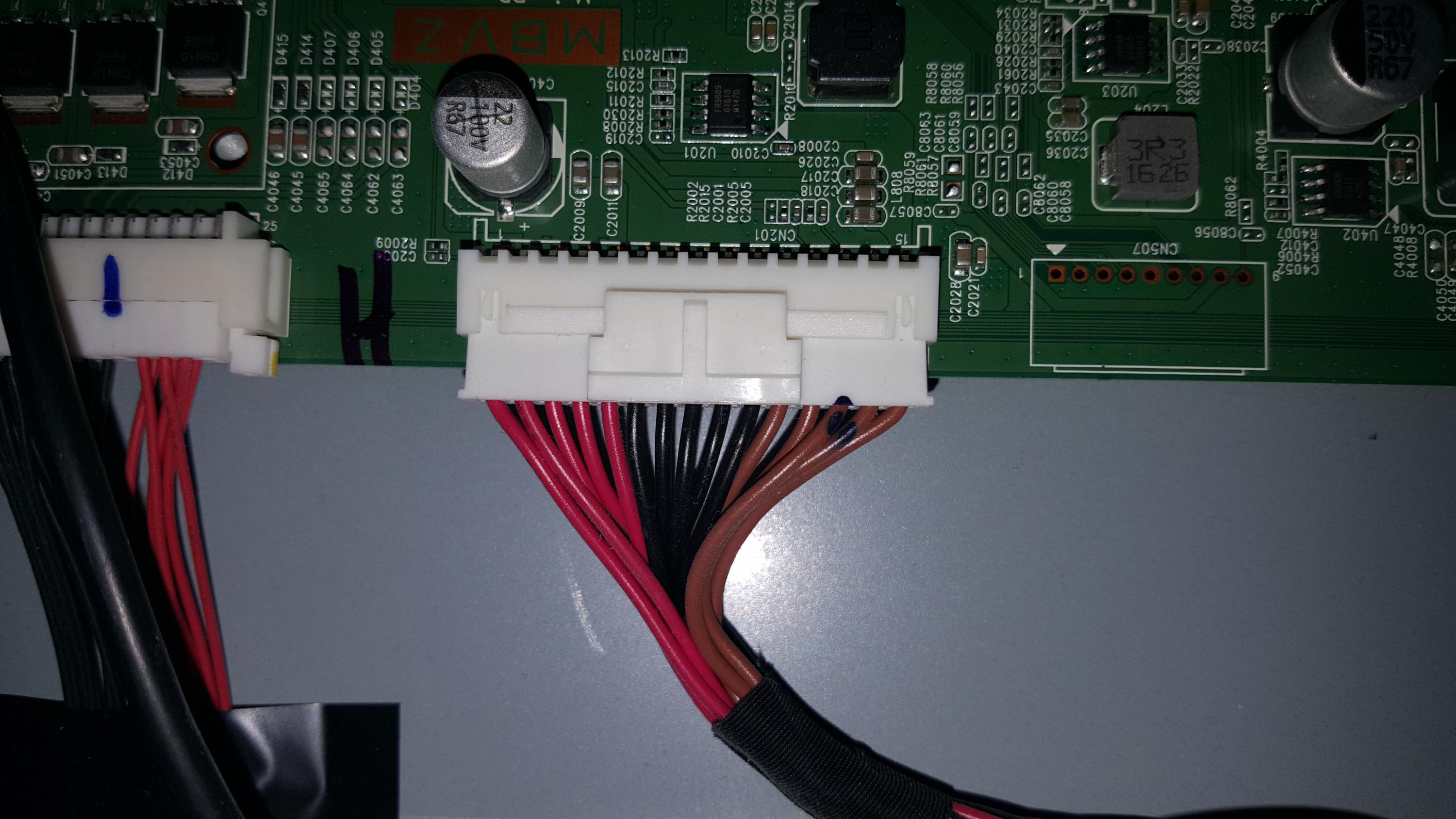

                                  In the 185418 photo the LED connector is the top connector going to the panel as shown in the 185826 photo. I checked all pins on that connector and all had zero volts with the unit turned on and grounded to the chassis.
                                  The lower Connector is the harness coming from the PSB and I will get all voltages later today.
                                    https://www.badcaps.net/forum/attach...5&d=1545151445
                                    The LED connector (the one on the left in the picture), how many red wires and Black wires? I expect to see Voltages on the red wires, if I am correct, all the red wires should be all tied together to feed the + Voltage to the LED strip's Anode.
