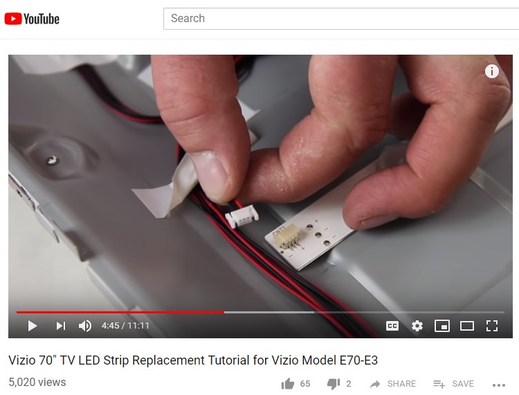

    Hi Bud, on your points.
    1) When I looked at the E70-E3 LED replacement video on youtube, what I saw, correct me if I am wrong, was 6 rows with two strips per row.
    1 Full row/ 2 strips = 18 LEDs with 9 per strip 9x2. If as you say VF = 3.1v x 18 =55.8v per row.
    Maybe I am not thinking correctly. As you mentioned 1 red per row and one black per strip.
    As for the black wires, I am not familiar with how an LED circuit works but if I understand correctly, there SHOULD be in this case of 57v per red, 28.5v(57v/2) on each black wire?
    2) With both of those being low, would that indicate a faulty PSB in addition and irregardless to whatever else is going on with the LEDs? Replacement/ repair PSB?
    3) I will have to ask my brother on this. He asked me about the "half black" some time ago but never addressed it at that time until it went full black as it is now. Answer later today after I ask him and I will try disconnecting the T-Con ribbons from the panel.
    4) I will get the part number for IC U400 later today.
    Thanks again. You are teaching an old dog new tricks.

        1) As I explained how the LED strips are connected, you have 12 LED strings = 12 Return black wires, 1 wire is shared by two LED strings so that is why it has 6 red wires. Each LED string has 9 LED's and 12 LED drivers, each driver drives 9 LED's.
        May be you need to invest in LED tester so you can test the whole LED string without opening the panel.

          I understand, However you had mentioned voltage on the black wires. In this case of 57v on the Red, should each black show half of the 57v?
          Right now of course I get 0v on those. But when all is working should they read half of the 57v?
          If I purchased an LED tester, could I unplug the connector from the main board and probe one red wire and just probe each black wire until I hit the correct corresponding black wire to light the strip?
            #45
            Re: Vizio E7-E3 Black Screen
            57V is fed to the Red wire which is Anode pin of the LED string, the Black wire is the Cathode return which the current returns to GND via the PWM controlled MOSFET and the current sensing resistor.
            When it is working , the Voltage on the black wire will depend on what the total Vf of the LED string is, the Voltage on the black wire is the Voltage drops of the MOSFET + Vdrops of the current sensing resistor, typical is about 10 ~20V range.
            "If I purchased an LED tester, could I unplug the connector from the main board and probe one red wire and just probe each black wire until I hit the correct corresponding black wire to light the strip?" That is correct.

              Ok, I unplugged the T-con from the panel, no change. I reconnected the panel and disconnected the VSNS cable and no change.
              In regard to probing the black wires, I should find 2 corresponding black wires to 1 red wire?
              The U400 is an AS3820
              I also went back and looked at the youtube video. It appears that the output from the main board plugs directly into each strip. i.e. no board in between the MB and the LED strips.

                "It appears that the output from the main board plugs directly into each strip. i.e. no board in between the MB and the LED strips." that is correct, you see only one red wire because it is shared between the two LED strips (1 row of LED strip).
                AS3820 LED driver, see how the LED's string are driven as I already explained.

                                        Can you answer one more question please?
                                        I am still confused about the voltage on the black leads coming back from the strips.
                                        Not fully understanding why there is voltage going in but not coming back.
                                        In my simple mind, I am thinking about water flow with a single hose feeding both strips and a hose on each strip coming back with equal water flow from each of the strips or half of the water going in. What happened to my two water supplies coming back?
                                        Sorry to be such a newbie but I am trying to learn.
                                          #60
                                          "Not fully understanding why there is voltage going in but not coming back." That is still puzzle to me too.
