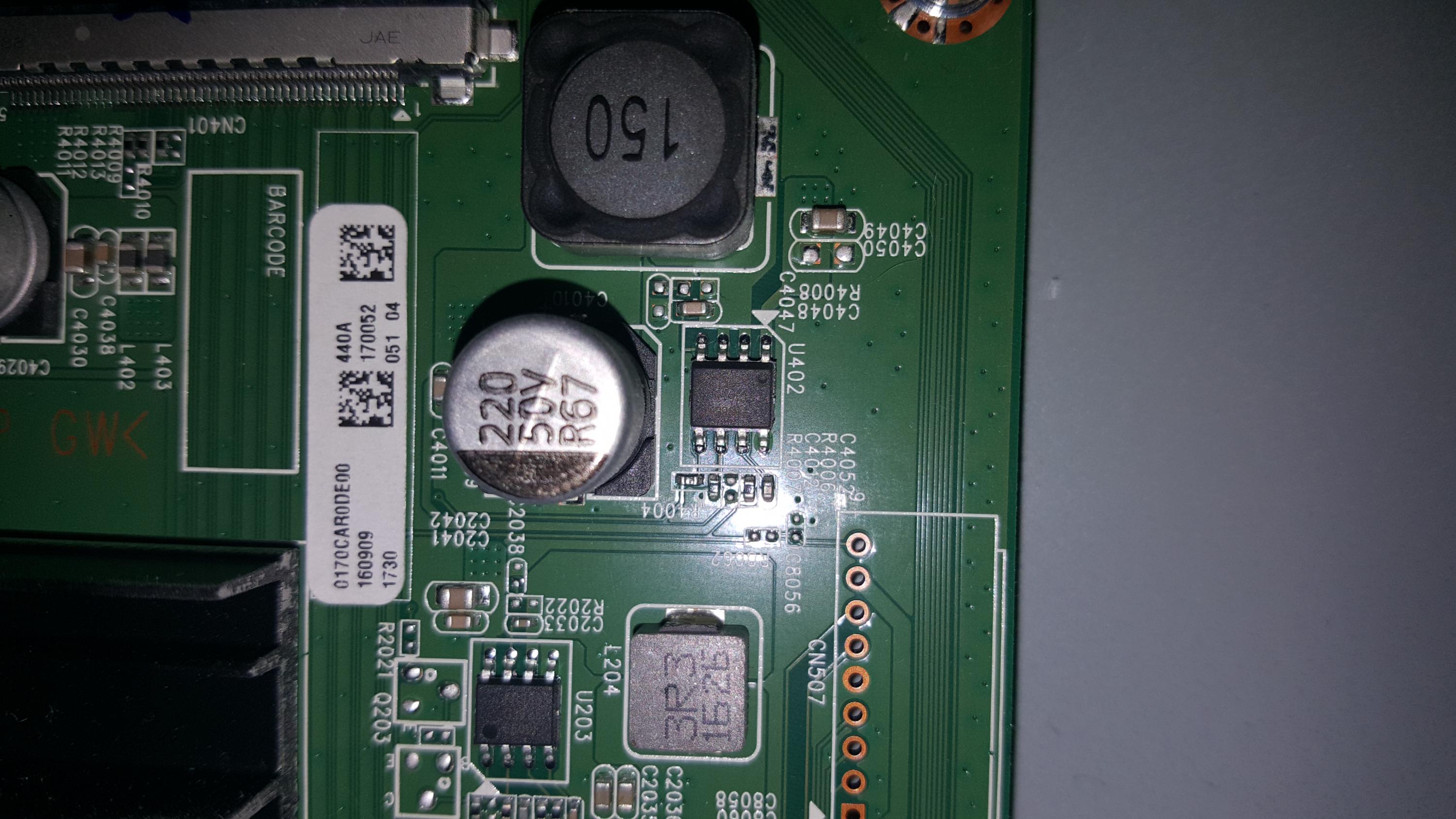

    Hi Bud, well let me get you the all the voltages
    On the PSB with unit ON
    1 VSNS= 2.4
    Pins 2-5 LED_Out = 57.0
    6-10 GND= 0
    11 +16v=16.2
    12 AC_Det=3.9
    13 PS_ON=4.9
    14+ 16V= 16.2
    15+ 16V=16.2
    Powered Off:
    1=0
    2-5=0
    6-10=0
    11= 16.2
    12= 3.9
    13=0
    14=16.2
    15=16.2
    On the Main Board LED Connector there are 6 red=57V and 12 Black=0V

      Maybe try unplug powerboard from backlights, see if the filter cap voltages go above 279.
                      No change in voltage with LED connector unplugged from Main Board.

                        Ok, do you have voltage at the test point on the connector going to the backlights, like in the sj video in post #29?
                          I have 57v on the Red Wires and 0v on the black wires.
                          I did not recheck the voltage on that connector with the LEDs unplugged.
                          After watching a SJ video on this unit, there are 6 rows of LEDs which would coincide with the 6 Red leads and the 12 black leads. 1-Red and 2-Black for each Row.

                              I have a question about the LED circuit. Why are there 2 ground/ black going from the MB to the LED circuit? What is the purpose of the 2nd GND/ Black?
                                #35
                                Re: Vizio E7-E3 Black Screen
                                You have 12 LED strings that is why there are 12 Black wires for the Cathode return for each LED string and 12 PWM Controlled power MOSFET's to maintain constant current for each LED string.
                                There must be common failure that cause all 12 LED string not to flash on at all, it is almost impossible to 12 failed LED strings. You can have one or two fail LED strings but the good one should at least flash on and then the protection circuit kicks in due to bad LED string.
                                I still wonder about the PFC Voltage which not at typical value of 380 ~ 400VDC range.

                                  The 12 strings goes with the video I watched. 2 wide and 6 rows. 3.1v x 18= 55.8v or the 57v on the LED side.
                                  So if I understand correctly, you are leaning the same way nomoresonys is leaning. A bad power supply board/ component? If so would the symptom of half the screen black first followed later by both sides be the same result of this PSB/ component?

                                      I am thinking about the 380-400v caps PFC.
                                      If one went bad would that take half the screen and then the second failed taking the rest of the screen?

                                        1) So I look at the SJ video, each LED string has 9 LED's, two LED strings are connected together so both strings use 1 common red wire and two black return wires, one for each string, that is why you have total 6 red wires and 12 Black wires.
                                        So if they are 3V LED, then total Vf (Forward Voltage for each string will be about 3V x 9 LED's = 27V, if they are 6V LED's then total Vf for each string will be 6 x 9 = 54V.
                                        You indicated that you do have 57V feeding the Anode of each LED string so I expect to see Voltage at the Black return wire of the LED string, but you indicated all 0V which does not make sense that all 12 LED strings went open circuit.
                                        2) About the two main filter caps that shows about 300VDC instead of typical 380 ~ 400 VDC, those two caps are connected in parallel, so that will not be the cause of the half screen problem.
                                        3) Your LCD panel looks to be made by Sharp, and these Sharp LCD used in many 70" TV's and typical failure is due to side tab driver, which based on your prescription about half screen is dark seems to point to the problem on the panel, the T-CON on this TV also controls the backlights so you may want to try disconnecting those 4 flat ribbon cables between T-CON and the LCD panel to see what happen. It may be that the T-CON is locking down the backlights circuit. BTW, when you say half screen is dark, is it like completely black? Or something like this: https://www.reddit.com/r/VizioTV/com...n_vizio_e70e3/
                                        4) The main board IC U400 is the LED driver, what is the P/N of that IC?

                                          Maybe check those little capacitors on tcon for shorts, diode mode, probe on each side, tv unplugged.
