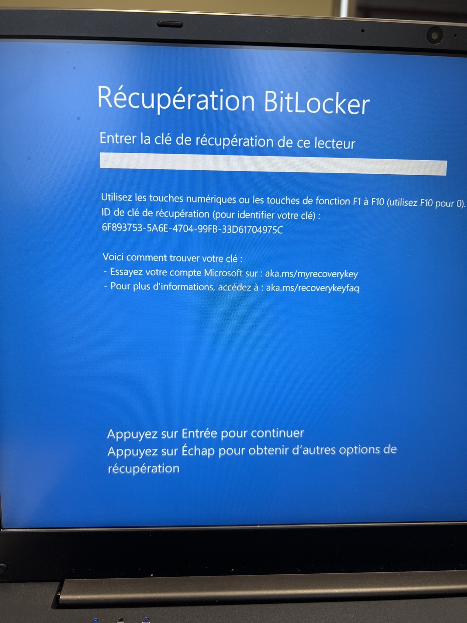

          • wizard13
            • May 2021
            • 13
            • ccc
            try this one
            Thank you very much for your answer but this one does not work, I am attaching the photos. I've never seen this kind of message before.

              try this one
              With this BIOS the computer turns on immediately but I'm stuck on the bios I can't do anything, as shown in the photos attached just before. So there is clearly an improvement because it did not turn on at all but despite that I cannot use the PC
                reinstall windows, bitlocker is ssd encryption, formatting ssd will get rid of it. I don't understand "I can't do anything" since I see you can navigate between tabs.

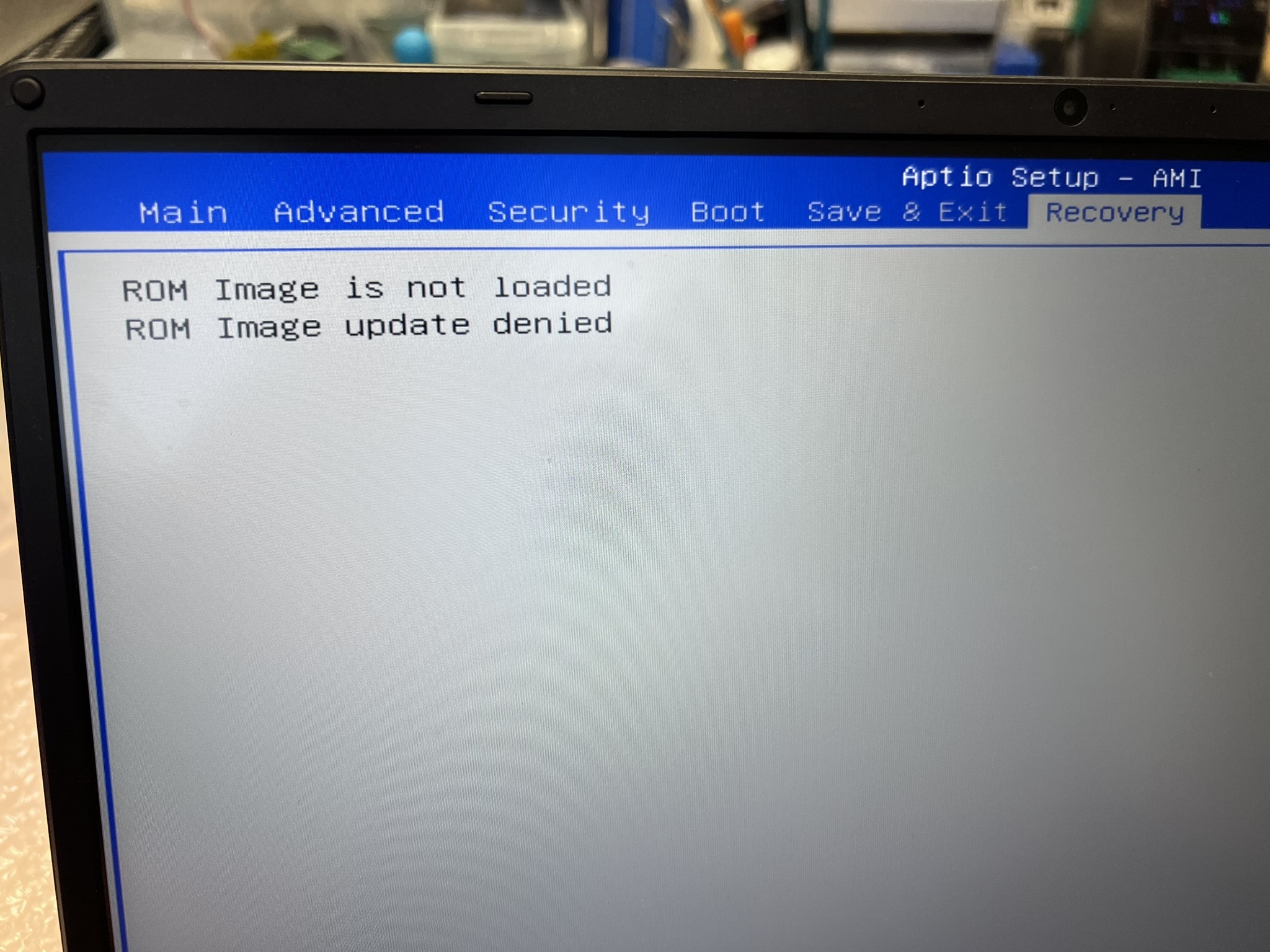

                • wizard13
                  • May 2021
                  • 13
                  • ccc
                  No it doesn't work, I have access to nothing in the BIOS I can't go to the Boot menu for example.
                  I only have access to the "Main" and "Recovery" tab which tells me: Rom image is not loaded
                  Rom image update denied
                  I can't boot from a USB stick for example, that's what I mean so in my opinion the BIOS is incomplete or corrupted​
                    file is extracted from bios update, so look for hardware problem. If "BIOS is incomplete or corrupted" be sure your laptop stays with black screen ...

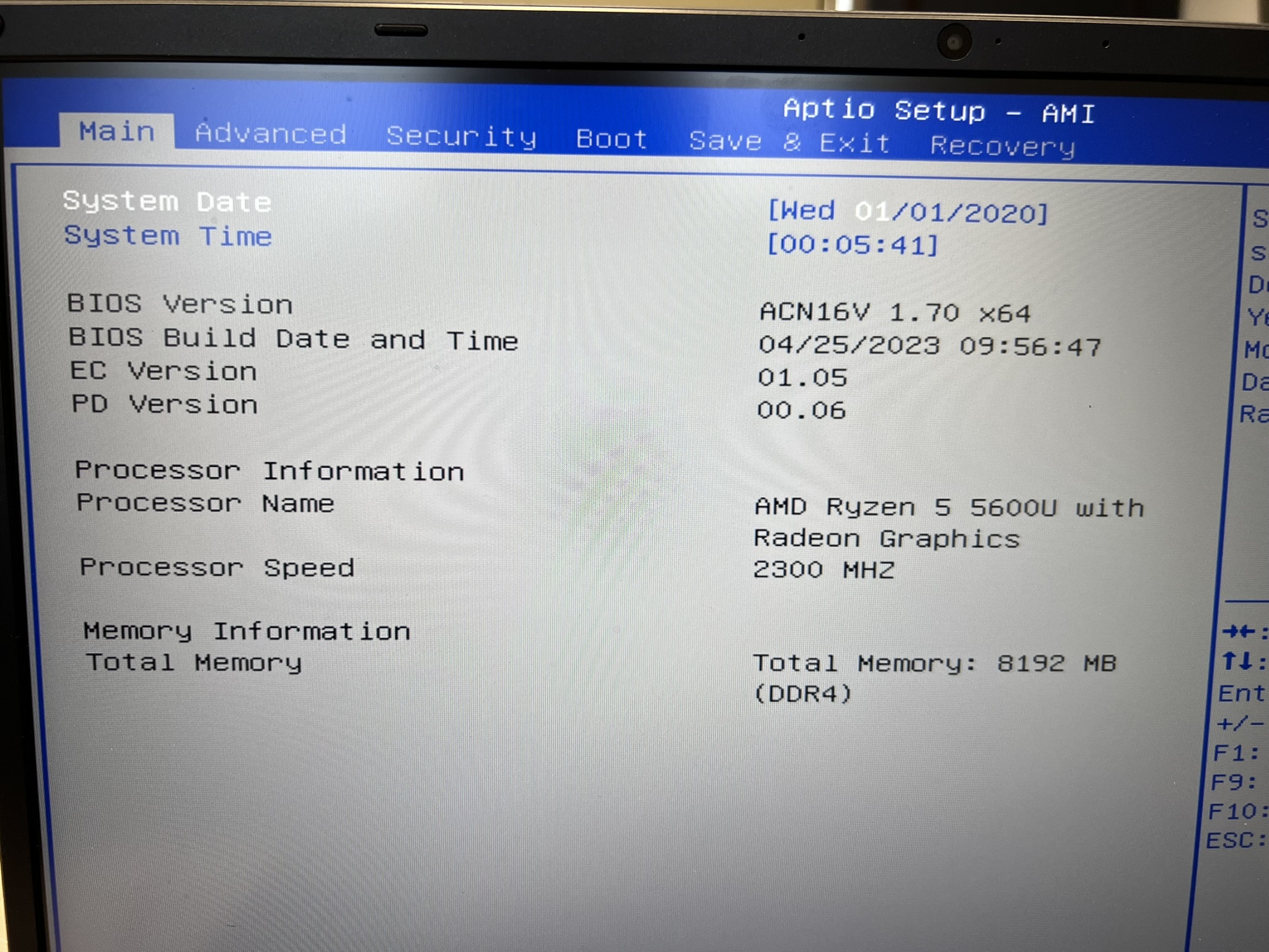

                    • wizard13
                      • May 2021
                      • 13
                      • ccc
                      I just found the problem!
                      When I flashed the image with my CH341 it didn't work, I just did it with a T48 and this time it works correctly I have access to the whole menu.
                      Thanks for your help​
