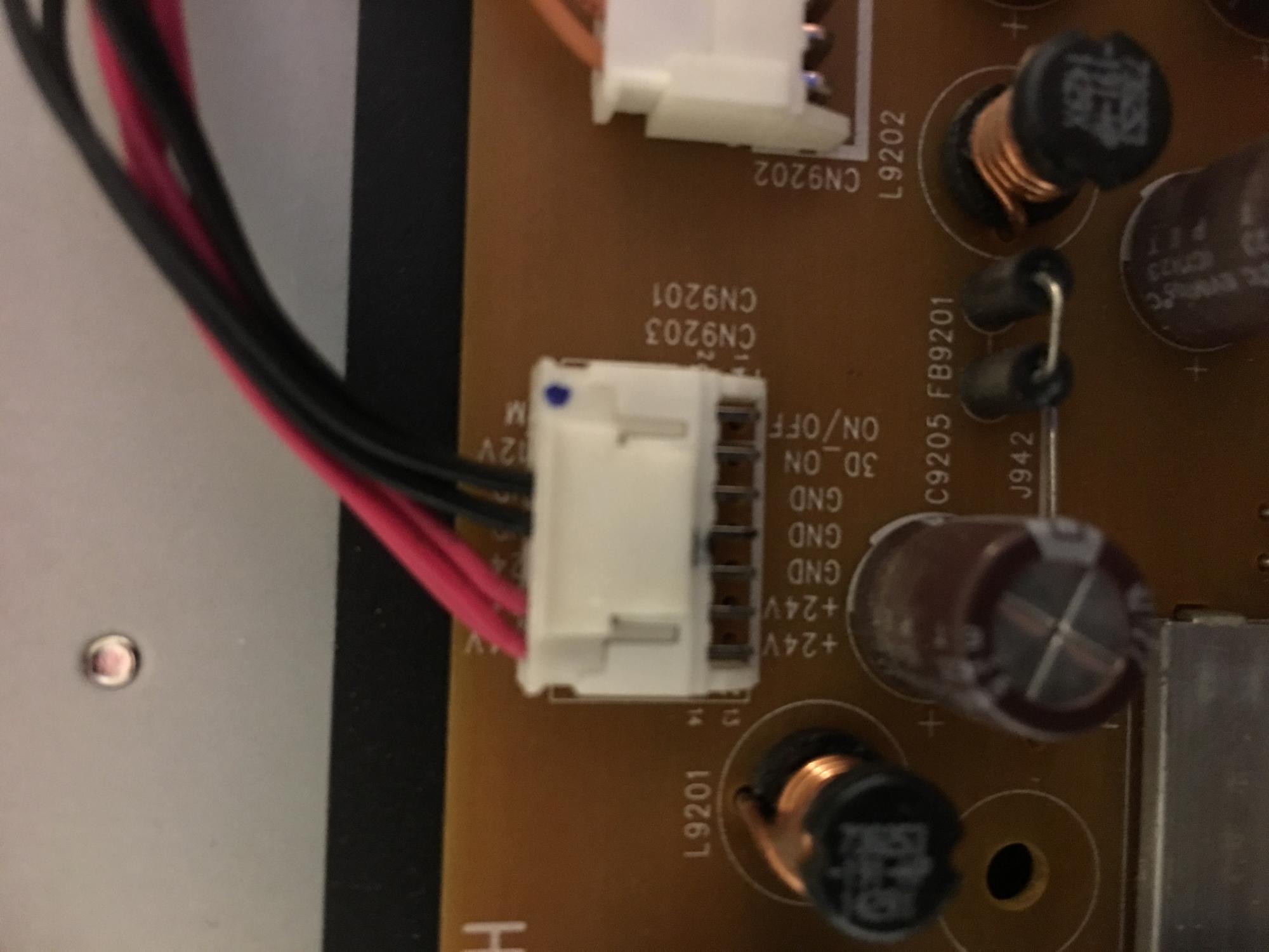

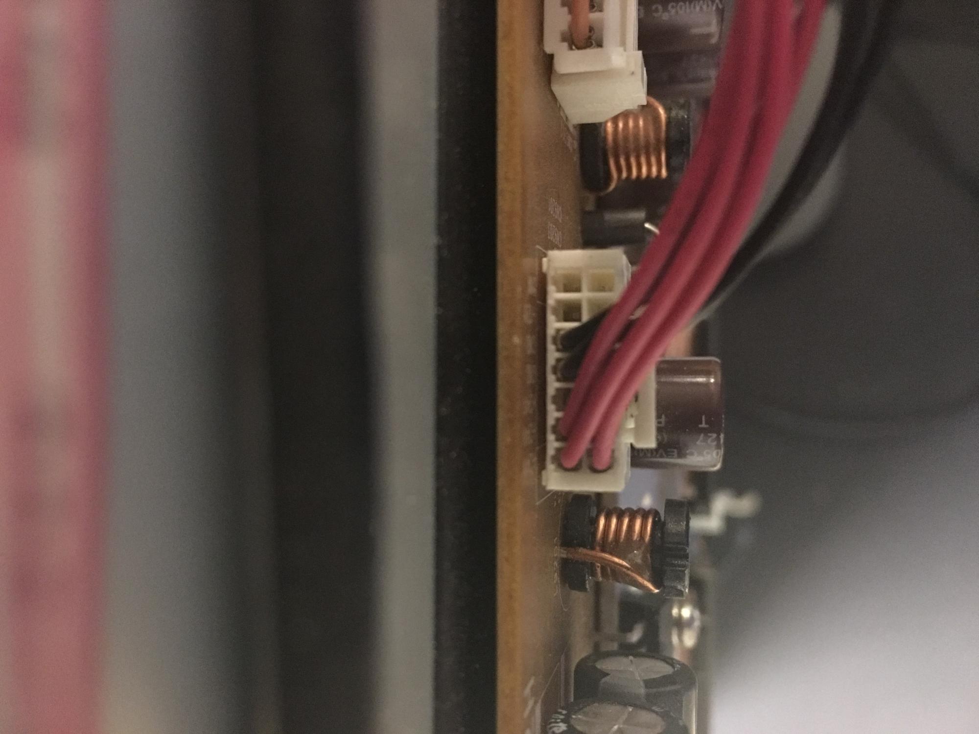

      I do not have a cn9101/3 connector on the power board. I do have cn9201/cn9203 that has 14 pins. (1st pic below)

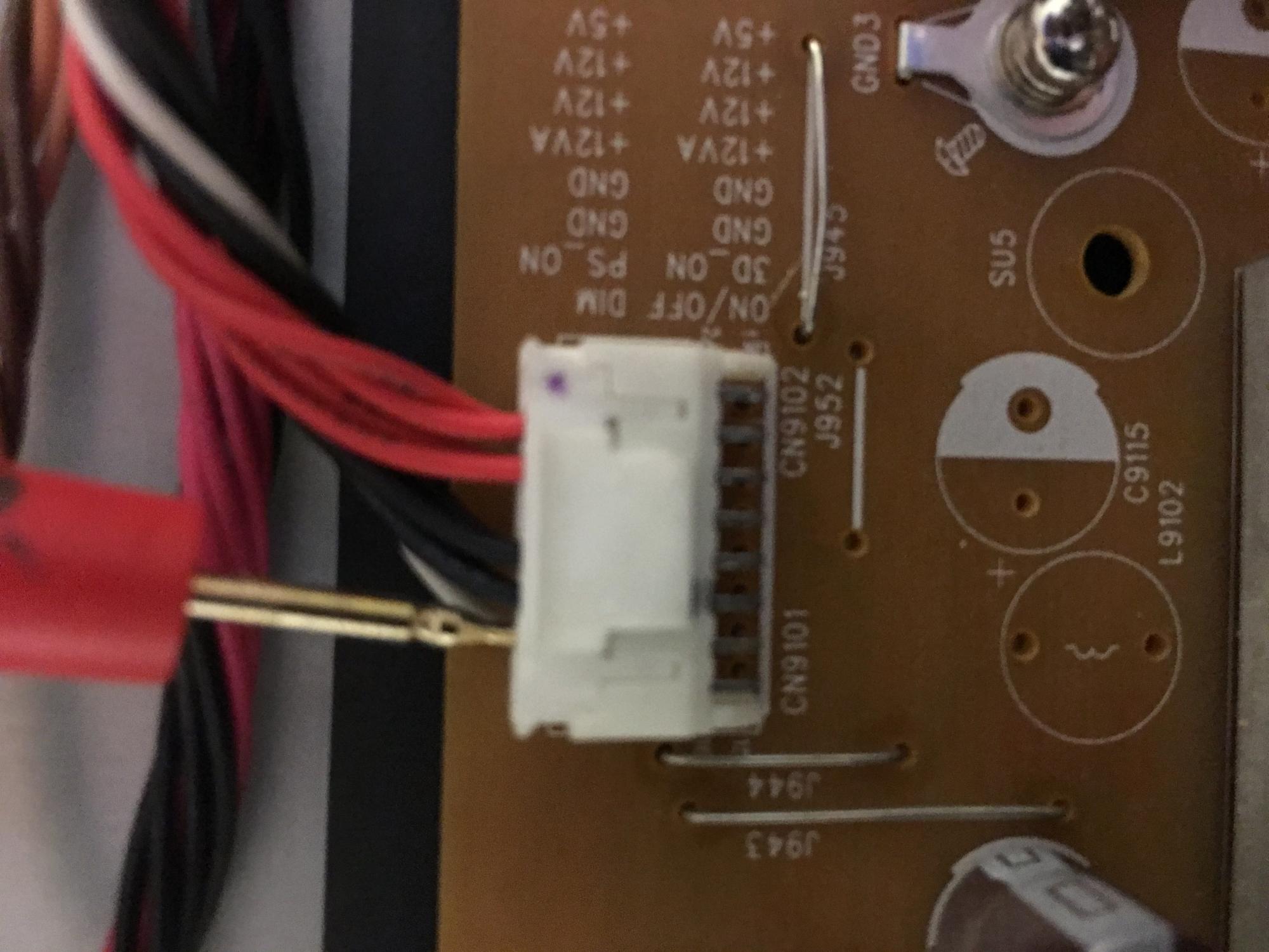

      Cn9101/cn9102 has 16 pins and has PS_ON and when the set is powered on it has 2.87V. Standing by it gets 80.8mV until power button is pressed when it gets 2.87V.

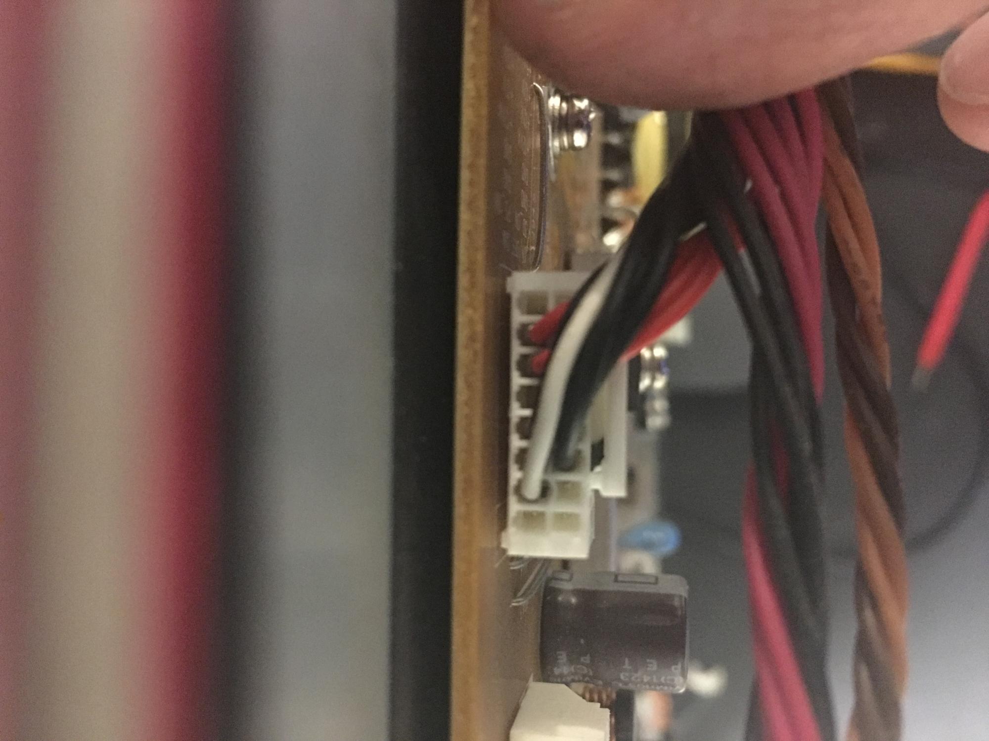

        I ment cn9101/cn9102. I will just refer to the function and not the plug
        So the PS_ON is the white wire? and it changes from .80 (stby) to 2.87 (ON) correct?
        When the power supply is tured ON do you get 24 volts?
        If you don't get 24 volts, check the voltage on optocoupler ic9103, pin 1 (pin2 should be ground) and see if it changes when the power button is pressed?

            Yes PS_ON is a white wire and yes those readings are correct.
            On c9201/c9203 on the 24V pins they all do get 24V when power is on to the power supply.
            Ok so on pin 1 of ic9103 when set is turned off I get 250mV and when turned on I get 1.13V. That is all.

                      Re: Vizio P502UI-B1E No Picture Flashing Standby Light
                      https://www.badcaps.net/forum/attach...8&d=1556390413
                      OK, with better picture now I can see that there are now wires for the ON/OFF and DIM pin.
                      OP: "have confirmed the set is not running and there is no picture on the screen when using a flashlight so definitely not the backlights."
                      So right now he does not have backlights, correct? I wonder why OP indicated that "definitely not the backlights".
                      The MCU should also send the signal to turn on the MOSFET on the main board to supply the switched 12V to the T-CON board.
