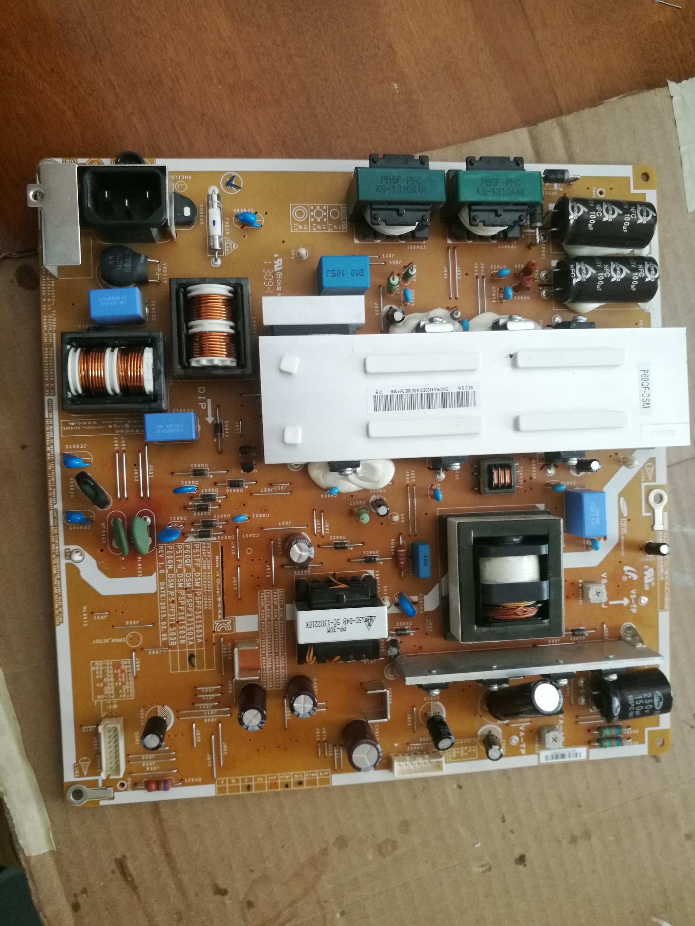

    The TV is a 2013 Samsung plasma, model # PN60F5300AFXZA.
    Snagged it up in non-working condition a couple years ago. Previous owner said that sometimes he could get it to come on after repeated tries but other than that he couldn't get it to turn on.
    Personally I haven't been able to get it to turn on at all. The standby light comes on solid when plugged in, but pressing the power button results in the standby light flashing once every 4 or so seconds. No "click" noises, no light from the panel at all. Just the flashing standby light.
    No visible cracks in the panel so I started by pulling out the power board and checking voltages. Everything seemed within spec. VA was 56.7v and VS was 212v, but I have no idea if those numbers are good because I haven't yet identified the table on the board itself or a service manual.
    EDIT: Found the table on the back. It says VS should be 200-215v and VA should be 54-62v, so my readings (212v and 56.7v) were within range.
    I replaced all but the biggest 3 or so capacitors as well but nothing has changed--it still does the flashing standby light.
    Hopefully it doesn't need a new main board since buying a replacement at ~$150 wouldn't be worth it. Any suggestions on what to try next? Thanks.

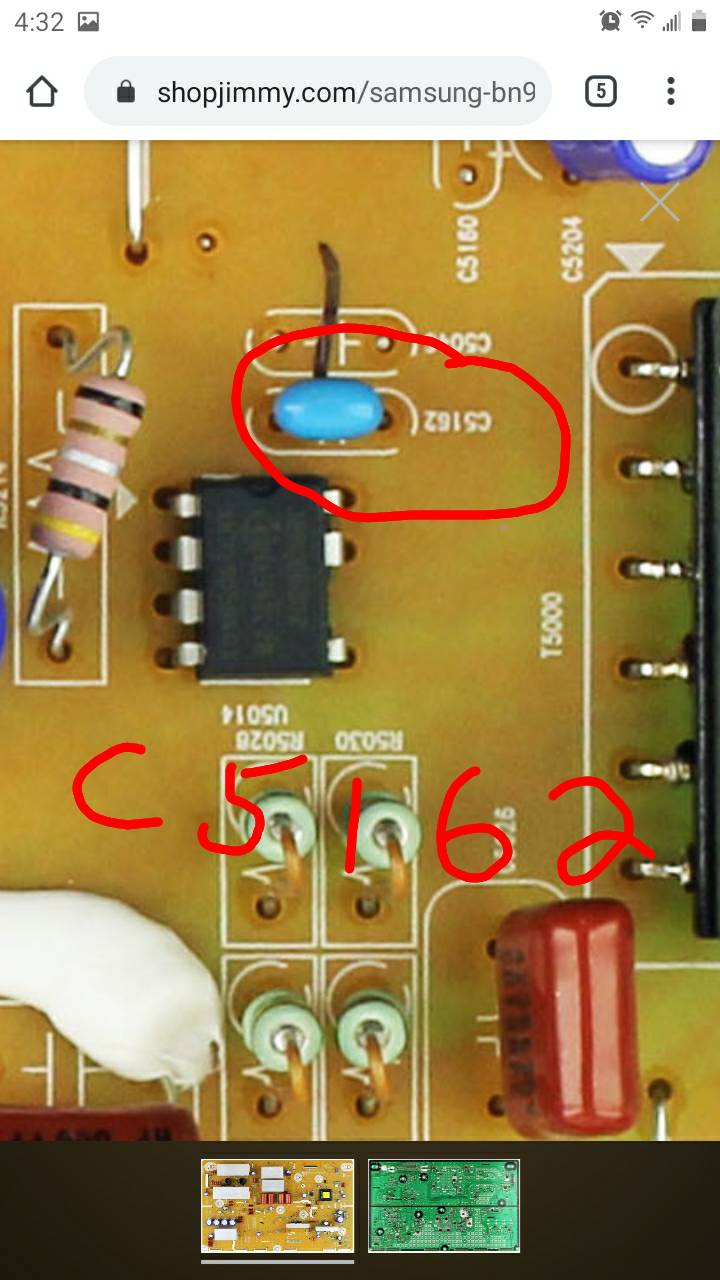

        If your y main looks like this one, replace this capacitor. It's a 10uf 50v.

          maybe it's my browser but I'm not seeing any images

            I missed the "pulled the power supply and checked the voltages". You could check the PS-ON voltage with the mainboard connected, and see if it changes when the power button is pressed, Can you access J875 on the power supply board?
            I believe there are 3 blue 10µf/50v caps that need to be changed on this Ysus board, I don't remeber which ones they are, tvtimmy likely knows which ones they are.
            One might be C5162?

              Is this the y-main cap (106 at C5162) everyone is referring to (in this thread and this one and this one)?
              https://www.digikey.com/product-deta...CT-ND/12760769
              EDIT: no, that is definitely the wrong part. I didn't notice that it was surface mount.
              I'm not seeing ceramic caps on digikey that are 10uf at 50v. Would it be a bad idea to swap it out for an electrolytic cap?
              EDIT 2: I was in the wrong section. Looks like there are plenty of 10uf 50v ceramic caps

                      Oops, here is the picture.
                      • 7ony
                        • Aug 2020
                        • 9
                        Re: Samsung plasma - flashing standby light
                        Thanks. I just ordered 10 of these replacements: https://www.digikey.com/en/products/...465-ND/2815395
