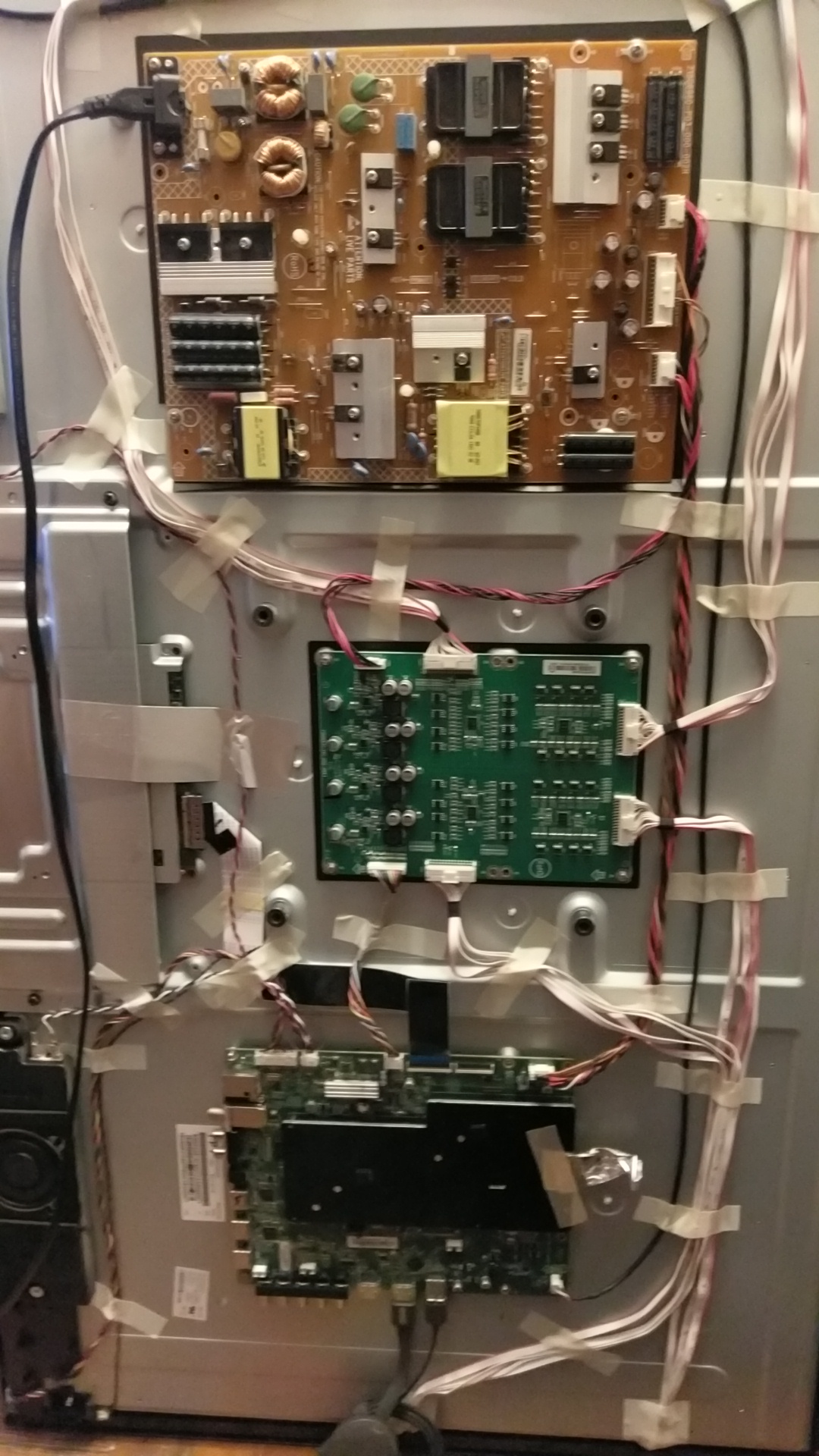

    Ok so when I plug it in the standby light comes on and goes out. Then I hit the power button and it does the same thing but I can see the light from the optical port and the lights are flashing on the network port when I plug in an ethernet cord. After about 5 mins the stand-by light flashes like 23-24 times then the power goes off. I don't see the optical port lit up any more or the network port. I've got a new power supply and changed the eeprom on the Main Board still no change.

      Re: Vizio P502UI-B1E No Picture Flashing Standby Light
      Could be backlight failure, check the numerous posts/threads on backlight testing.

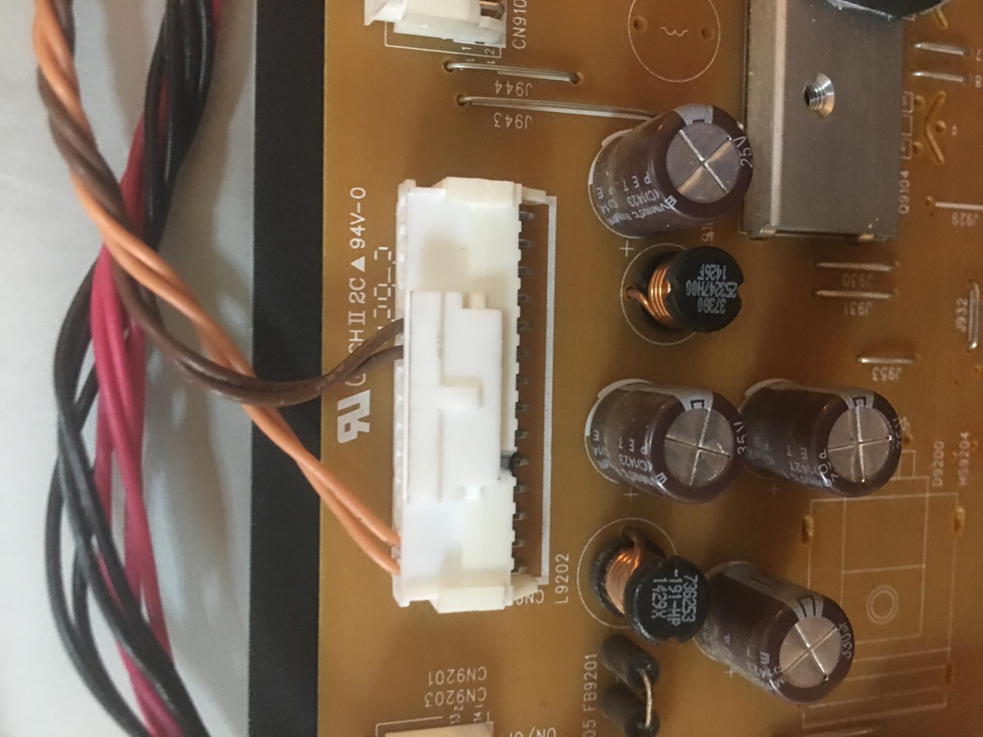

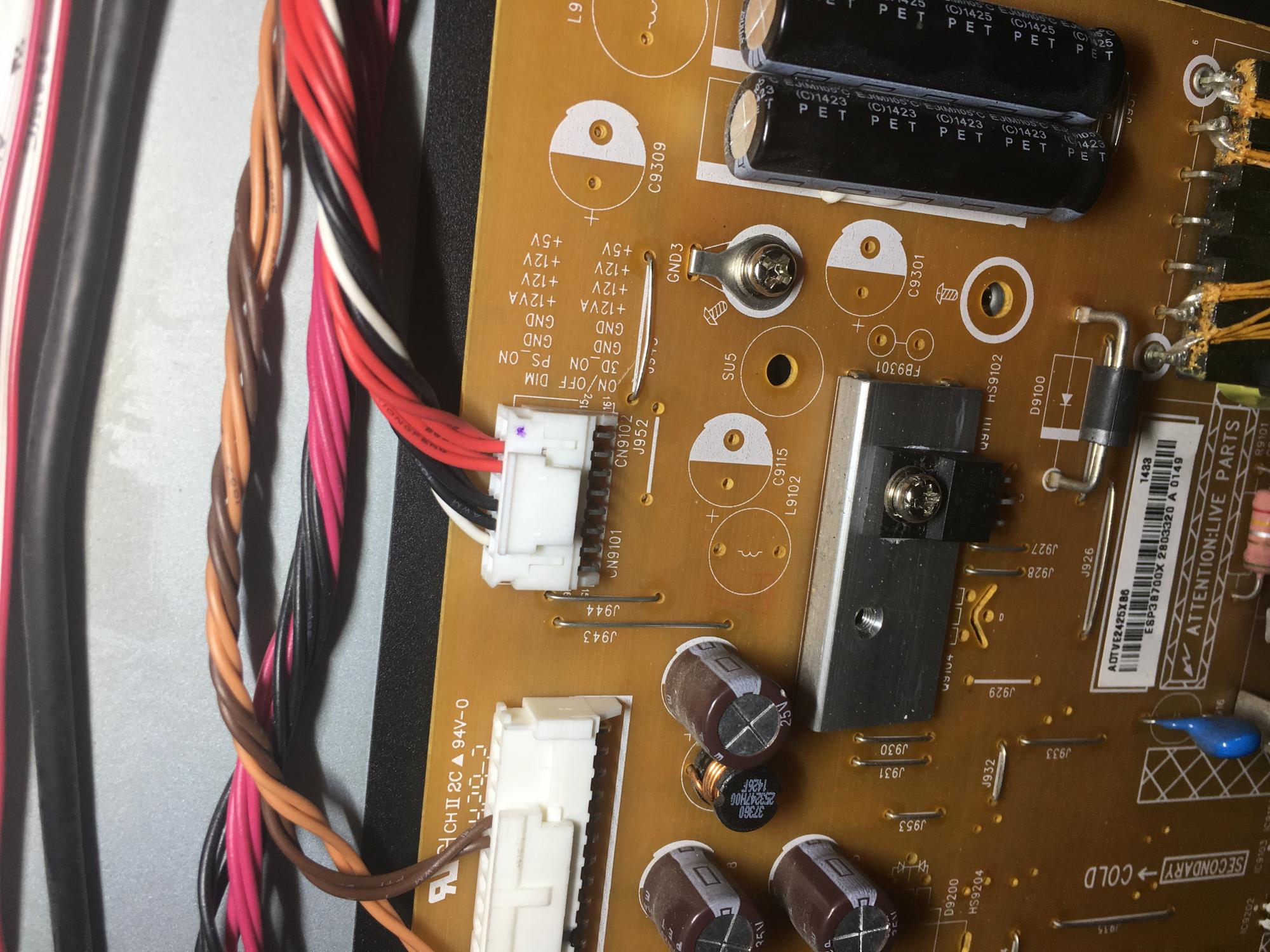

                          I cannot find ic9301, I have found ic9103. I did look on the back and closest I found was ic9201.
                          Ok so pin 15 & 16 for cn9101/cn9102 are blank(no pins in the harness either). J945 does not have 5v either. Not even when I attempt to power on the set.

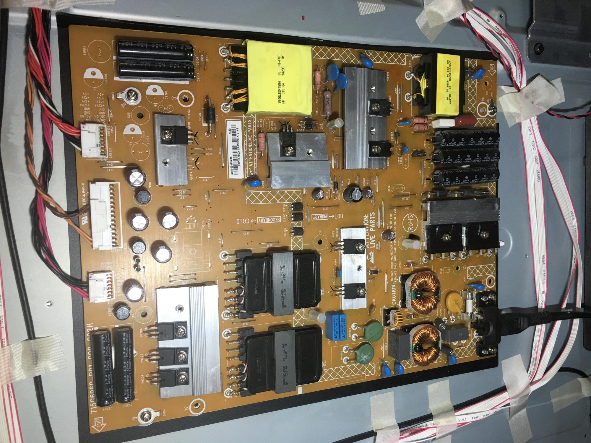

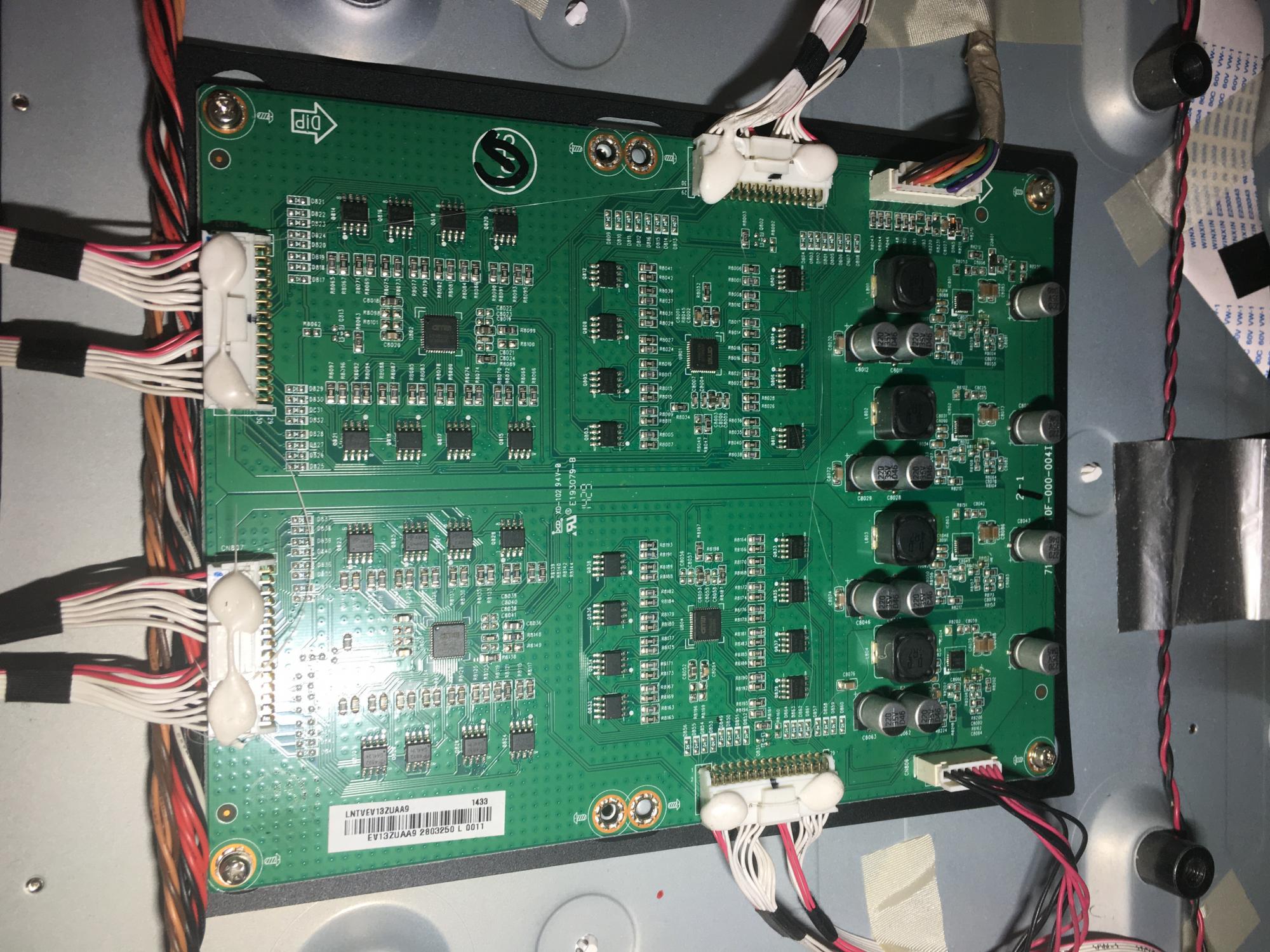

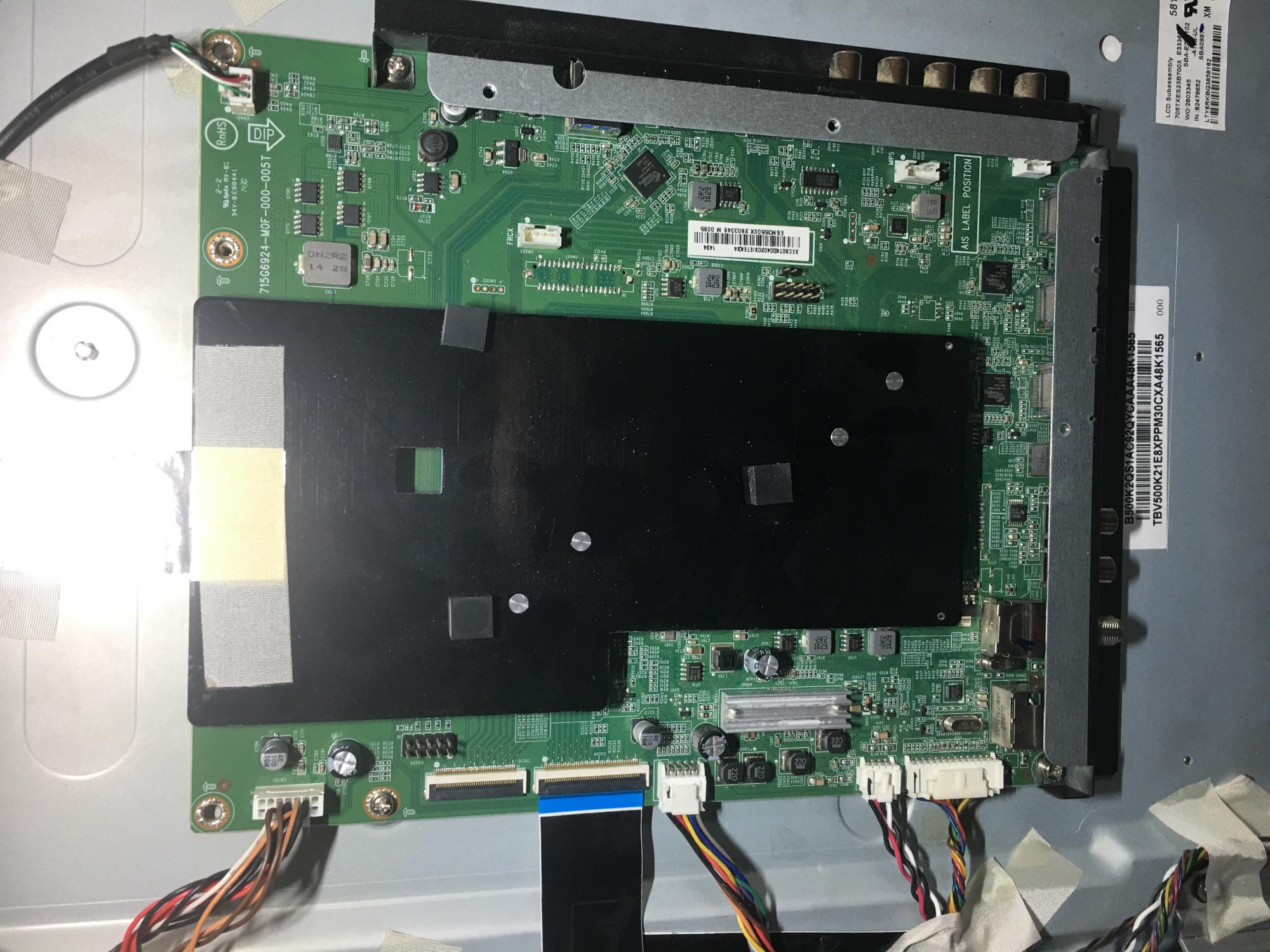

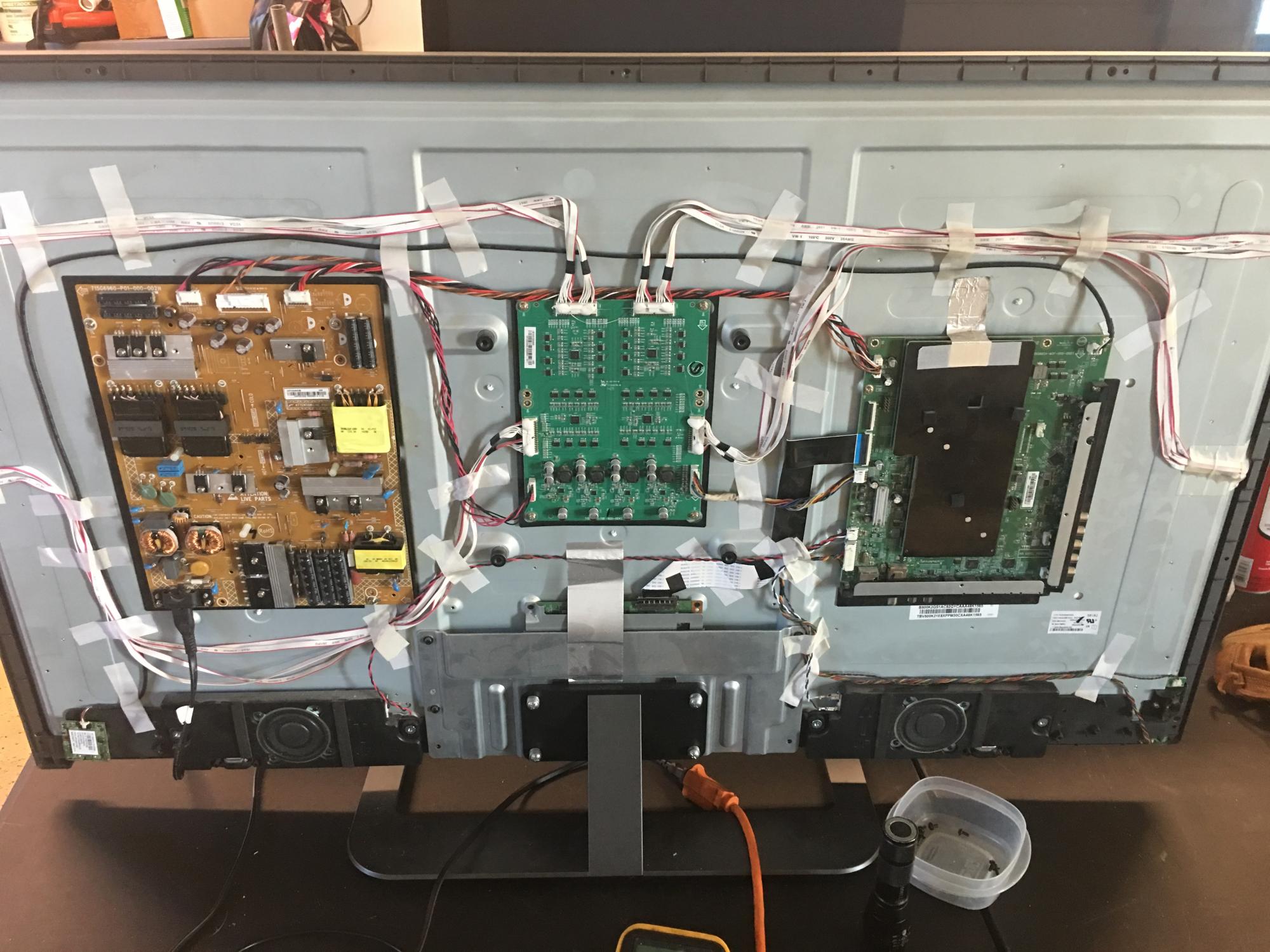

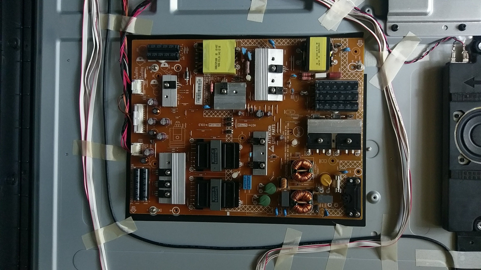

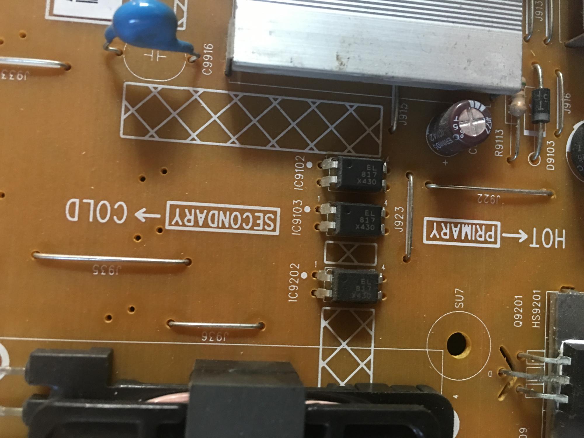

                            Here are photos of my boards
                            • budwich
                              • Jul 2015
                              • 3097
                              where are looking for the 5v? As you indicate and show in the pictures, 5v is not sent from the power board as there is no wiring.
                              • R_J
                                • Jun 2012
                                • 9624
                                After a closer look at the SJ picture, this board does not use 5volts for standby and uses 12V volts instead, Are there any wires going to the +12V on CN9202?
                                Its hard to trace the pictures sometimes, for example, this board does not use +12VA as well (L9102 not installed)
                                So this board must use +12 volts for standby to the main board, I suspect the main board has the +5 volt regulators etc
                                Check on your main board and see if you have any voltage on FB703 (next to CN701)
                                Also are you sure you got the correct eeprom for your board? Which one did you order?

                                  • JDMRpr78
                                    • Feb 2018
                                    • 31
                                    Cn9202 is the 14 pin single row connector pictured with only 4 wires (2 peach/2brown). Brown is ground and peach is +24VA
                                    I assume you meant cn9101/cn9102 which does have 6 terminals labeled as 12v. Only 4 of them have a wire in them. The two without are the +12VA. All four of them do have 12v.
                                    FB703 does have 12 volts on both sides of it. So if it uses 12v for standby then maybe I do have a bad eeprom, though I read bad stuff about the main boards on these TV's all the time.
                                    Any way to tell if my eeprom is any good?
