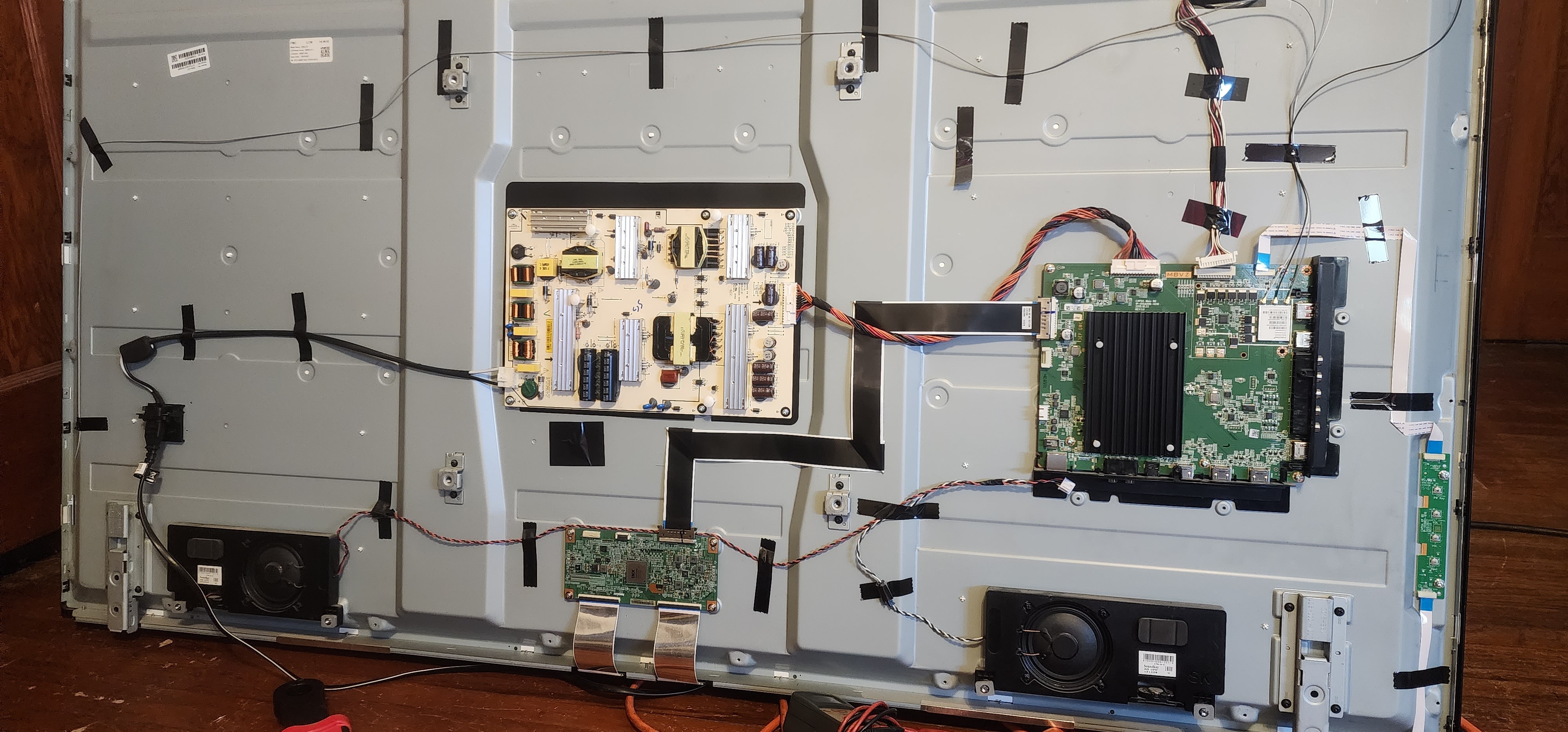

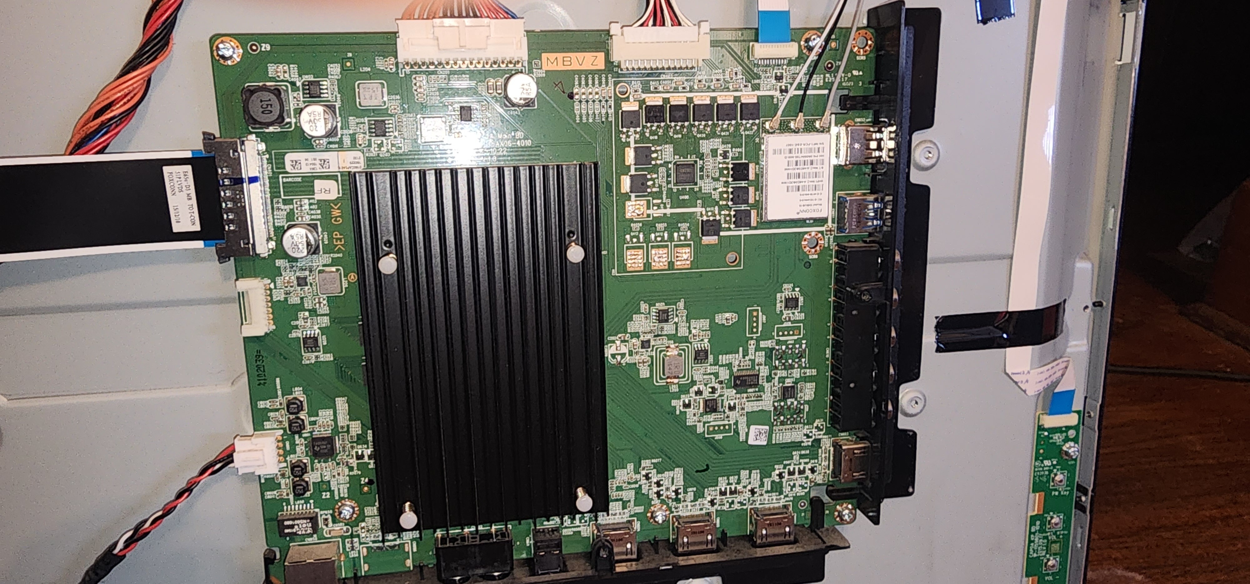

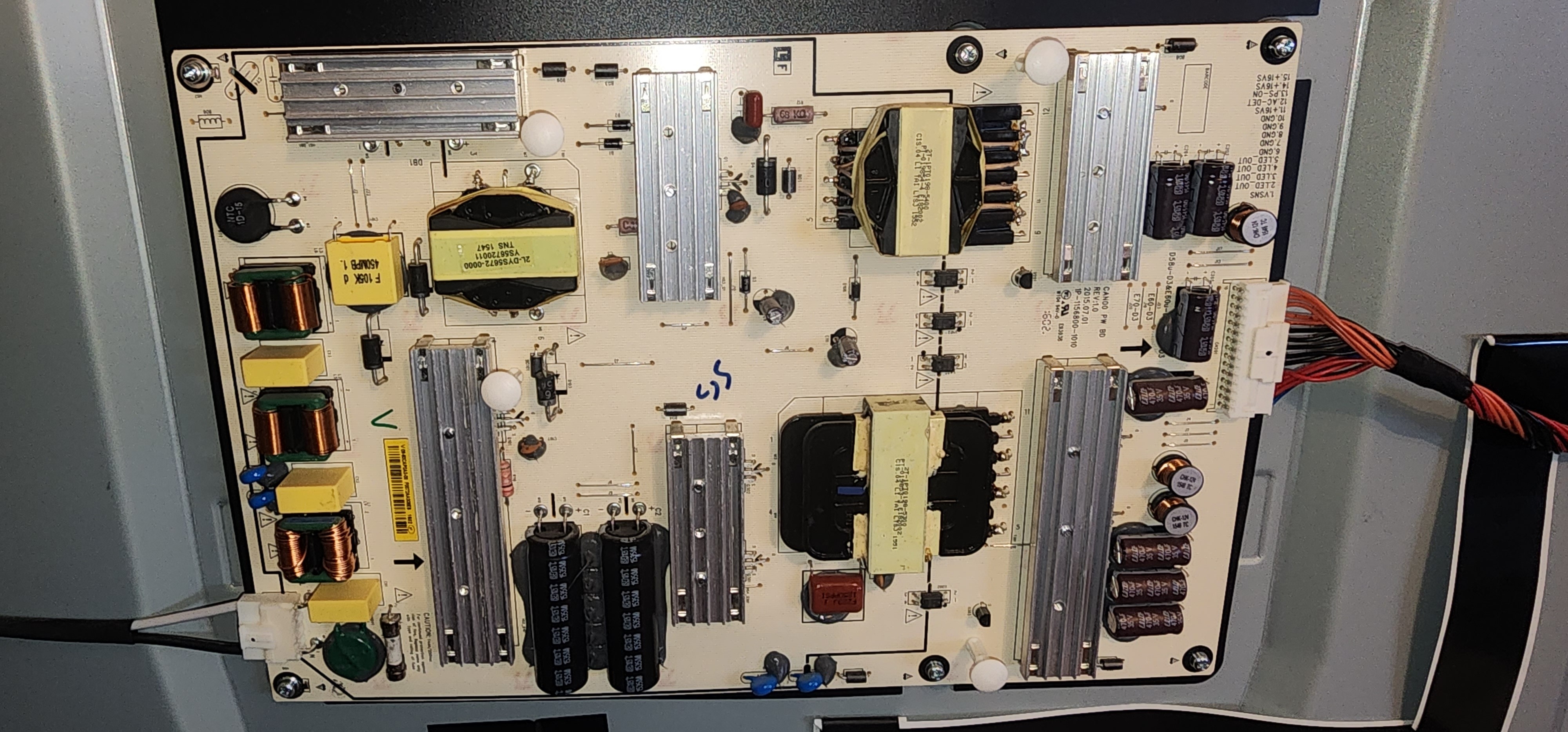

    Have vizio E60u-D3. No standby light. Have searched and read all D??u-D3 posts. posts with same symtoms fixed by new power supply, one guy needed back lights also.
    main boards are kinda spendy and, out of stock alot of places. i would like to fix my board.
    PS voltages
    1 VSNS -2mV
    2-5 LED-OUT -2mV
    6-10 GND -2mV
    11 +16VS 16.29V
    12 AC-DET 3.929V
    13PS-ON -3mV
    14 +16VS 16.29V
    15 +16VS 16.29V

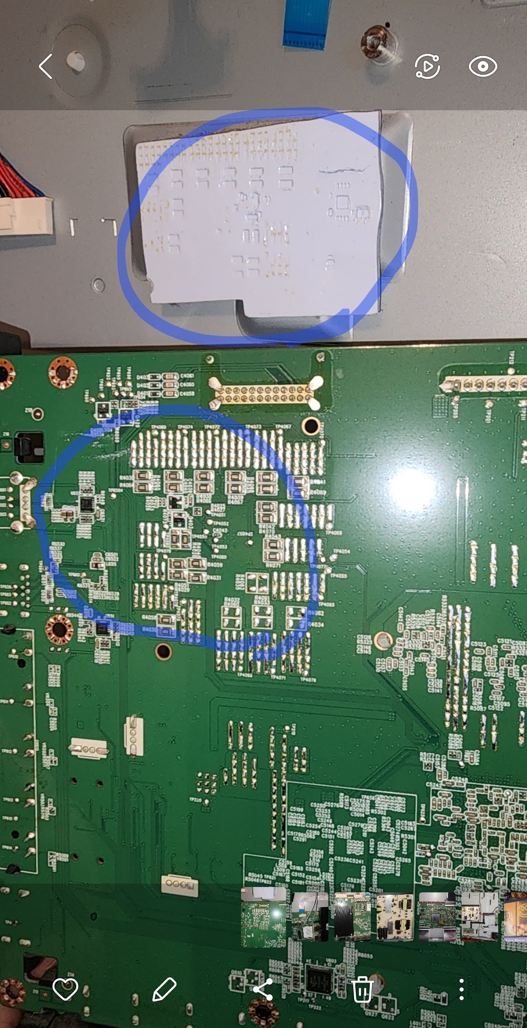

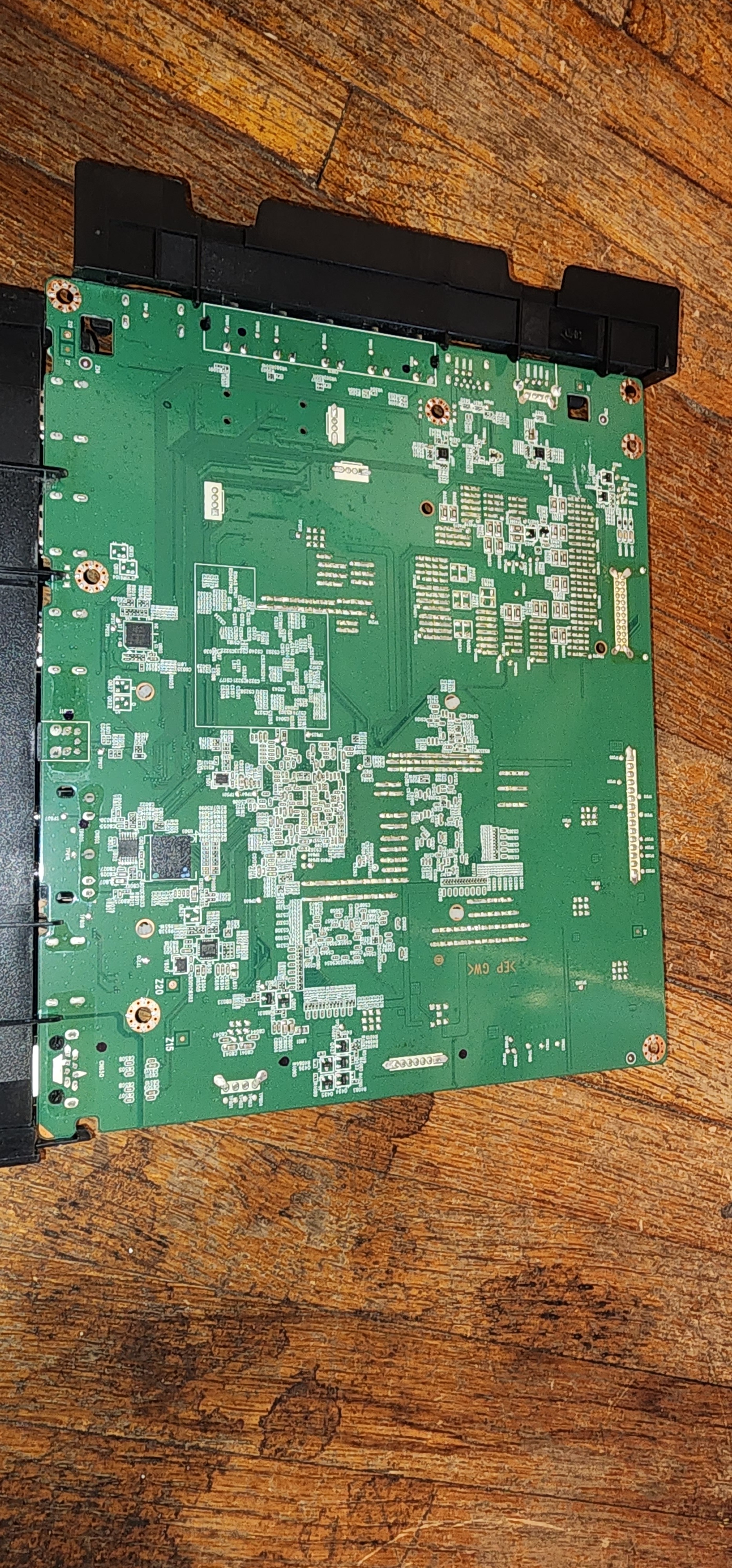

        You can see impression of components in this two sided tape. Not sure if that would cause a heat issue for them.
        someone said follow the power in on main board to see if it gets to main chip. Not sure how to go about that. Also seen someone comment that vizio has problems with voltage converters or regulators. Assuming the 16 to 5 volts needed for ps-on. Willing to learn have tools and access to more. Looking for some direction from more experienced persons. Thank you, great site and, people!
