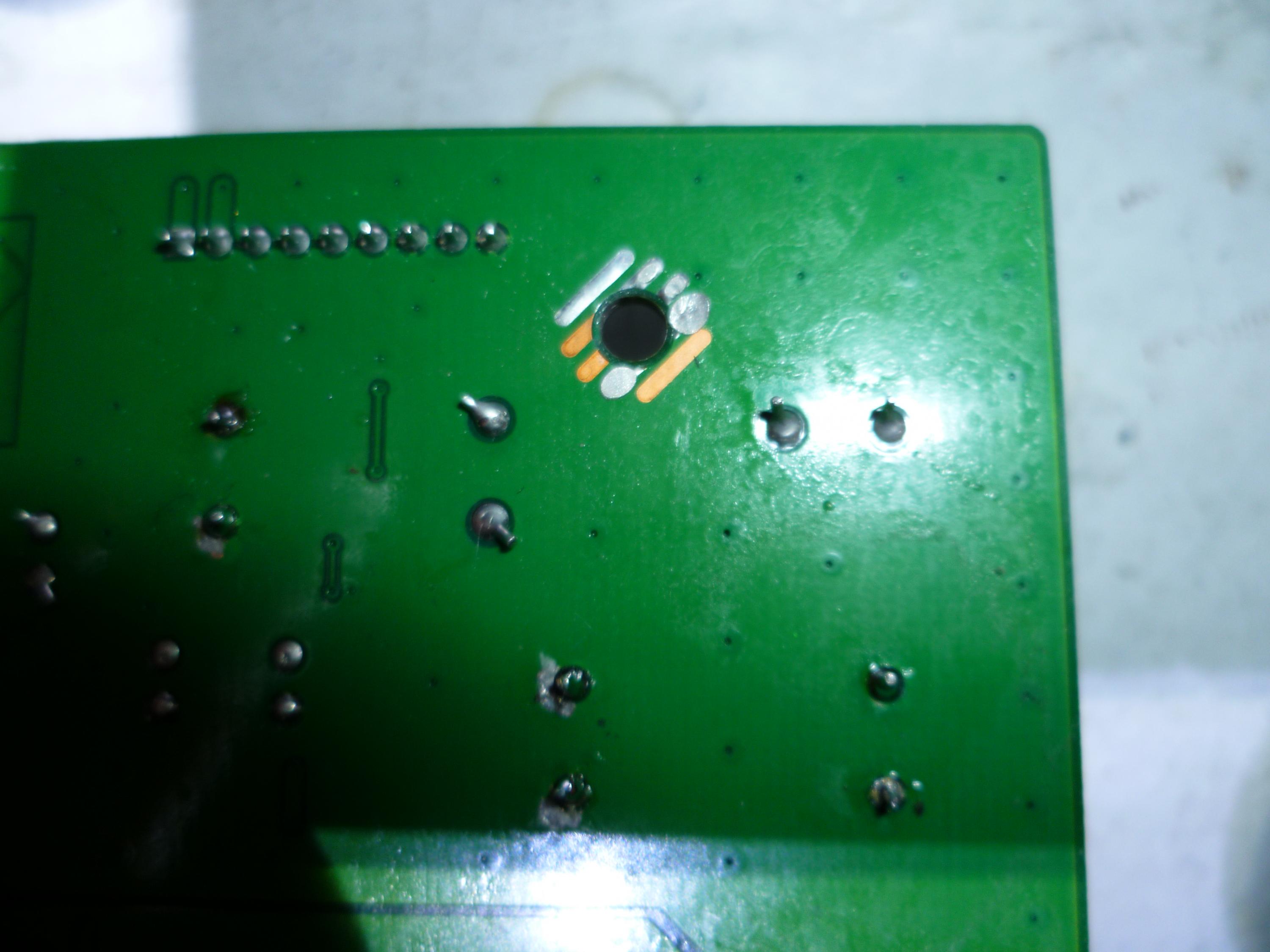

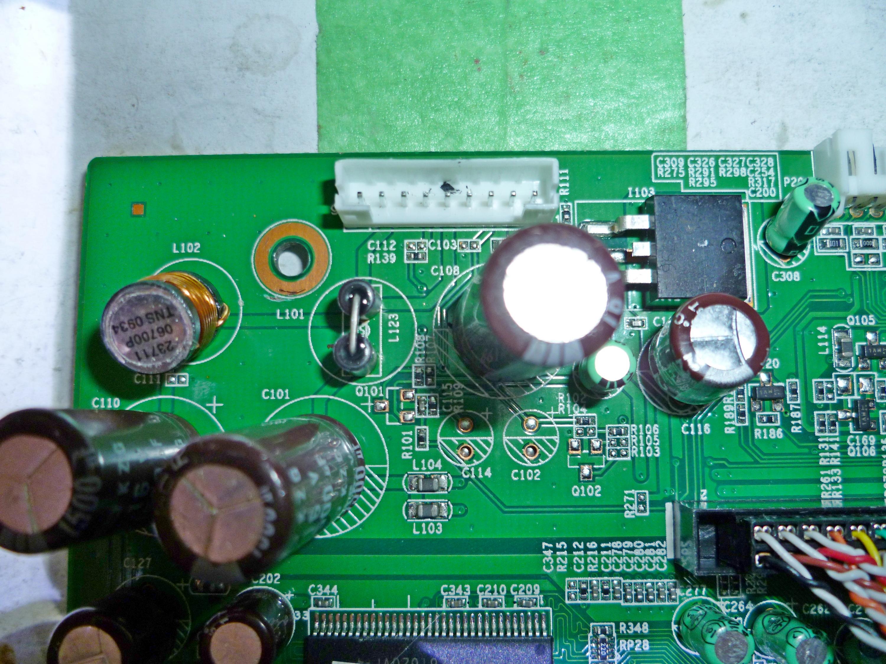

                  Hey Vinceroger, thanks for chipping in! Ok, ready to do the test in post #22, but what is amazing, I can't find L101!! I can see L123 alright, and I see L101 printed on the board, but where is it?
                  Attached are pics of top and bottom of the board. Can you point it out if you see it?

                    #29
                    Re: Viewsonic VT2430 fluctuating 5V rail
                    my guess its the coil/black top device to the left of the l123

                      #30
                      But isn't that L102? L101 seems to be the screw hole, but that is ground, so I am a little confused! Unless L101 is in the schematics but not implemented on the board?
                      Not sure what to do next, should I try with L123 removed and see what happens?

                          Sorry was on phone earlier now on laptop and can zoom in better yes l101 does seem too be the screw hole so not sure what too suggest maybe r_j will advise
                            #33
                            Do you see that L123 (FERRTE BEADS) that foot print is made to fit two type of inductor: one is for Ferrite beads as installed on your board or they can install ROUND inductor L101 instead, that is why the silkscreen has round shape and rectangular shape sitting inside the round shape.

                              #34
                              Ah thank the Lord Budm for that explanation, I would have never understood without your input!
                              Ok, so that means to do the test that R_J suggested i.e. remove the rail for the 5Vamp, I just need to remove L123 and that's it?
                              Tks again Budm!
