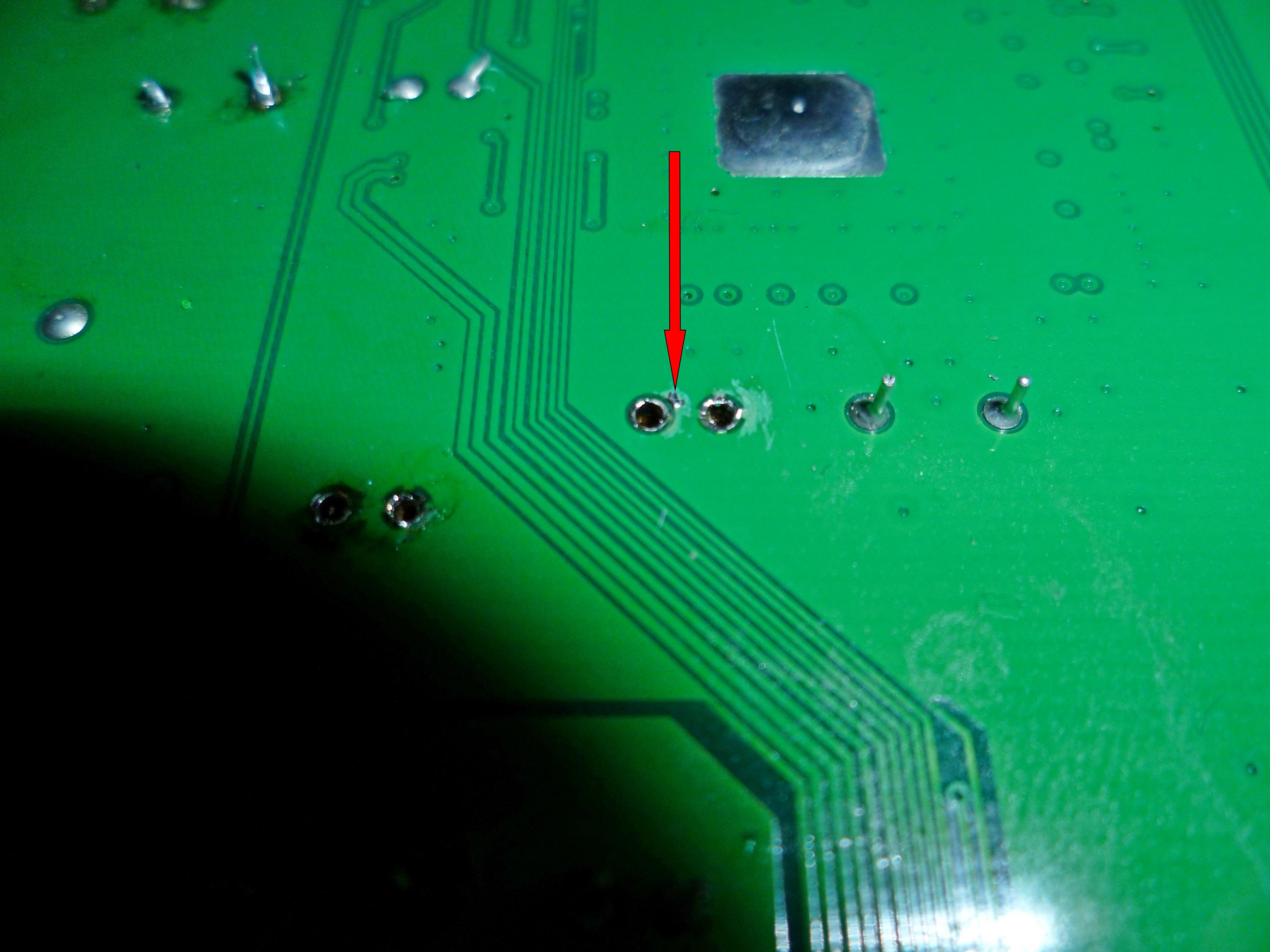

                          RJ: Yes and no, please see below what I've found.
                          Budm: I went on to remove C218 and lo and behold, the shorts had gone! Measured C218 by itself and it was not shorted? So I inspected the underboard pad, copy attached. This is the positive pad of C218, and the arrow points to ground which is a few millimeters from the positive side of C218.
                          Now C218, I had removed and checked it's ESR (one of the Lelon cheap 10uf) and had reinstalled it and I guess I created the short without knowing it.
                          So I need yours or RJ's advice...should I carefully remove that blob of solder and recoat with conformal coating, maybe 2 coats before reinstalling a new C218 (panasonic), and then reassemble everything else checking my progress towards the the finish line.
                          Even though the short will be gone on I204, I still might have my problem of the strobing Led, but what the heck, I am so thankful of you for being able to find this sucker, because for sure the TV portion would not have worked (although the monitor was powering up fine with that short). Continuing my quest with the help of my friends!!

                            Well gentlemen, I think we can call this Eureka! Put everything back together with good panasonic caps (well soldered) and the tv/monitor powers up fine and THERE IS NO MORE 5V rail fluctuation!!
                            Incdredible work and thanks to all of you for helping me out in this, it was an invaluable learning experience as well. Special thanks to Budm who has an amazing profound knowledge and most incredible, he shares it like a great coach and we just get better and better under his guidance! Budm, I think you should consider coming to coach our Montreal Canadiens, they surely would need someone with management skills like you.

                                      Hi R_J, you know what, I was thinking about that and it was probably one of the caps on the main board that I changed (I changed a few at a time and tested), but when I changed C218 I inadvertently created a short on the DTV-VDD33 rail which I think masked my repair.
                                      As soon as I uncovered the short on the C218 pads, it came back perfect. I had changed approx half the caps on the main board and will continue to change them as they are Lelon and Hermei caps which I think are not a good brand. I also ordered a set of caps for the power board which are Elite and Hermei brand and will change those also. TV should be good to last a while after that.
