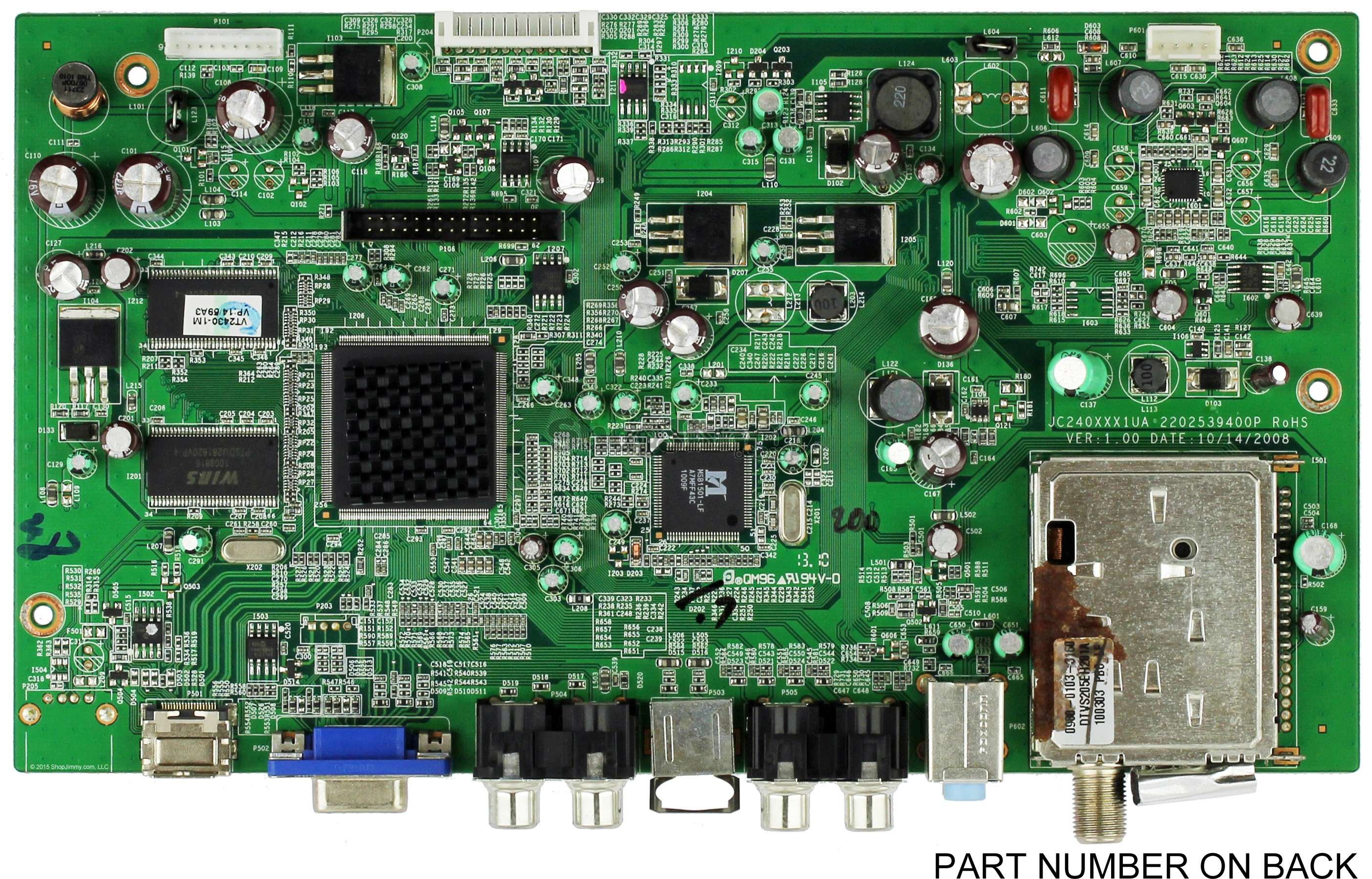

                Can I see the pictures of the whole main board?

                  Hi Budm,
                  Yes the 12V feeds the main board (I actually get 13.1V steady when connected) and powered on. The resistance on the 12V rail is in megaohms, so I suspect it is ok.
                  Which voltage regulator should I measure I103 or I104?
                  I tried it with the Tcon disconnected, same result i.e. pulsing of the 5V rail.
                  Here is a photo of the board, not mine actually but identical. On my board, I have installed a small video card fan in the center of it so it is hiding most of the components - it hasn't been connected however to do these tests as I didn't want to add any load to what is already there. If you need me to, I can remove it (it is only held by some hot glue on the silkscreen) and take an actual photo of my board. Note that I have changed caps on the top left of the board from C110 to C131 down to C291 with panasonic or nichicon low esr caps, but it hasn't changed anything. The brand of the caps the bigger ones are Hermei and the smaller ones 10uf are Lelon.
                  The brands of caps on the power supply are Elite and I'm thinking although I did check the output caps for the 5V rail and they were fine, but maybe I should recap the whole power supply board, as I'm not sure I can trust Elite caps? Also, when I measure voltage on the big cap, I get fluctuation. Anyhow, I'll listen to your advice (or R_J'S). Thanks again to both of you for walking me through this, it's an incredible feeling to have experts looking over your shoulder!
                  What a wonderful forum, the best on the net!

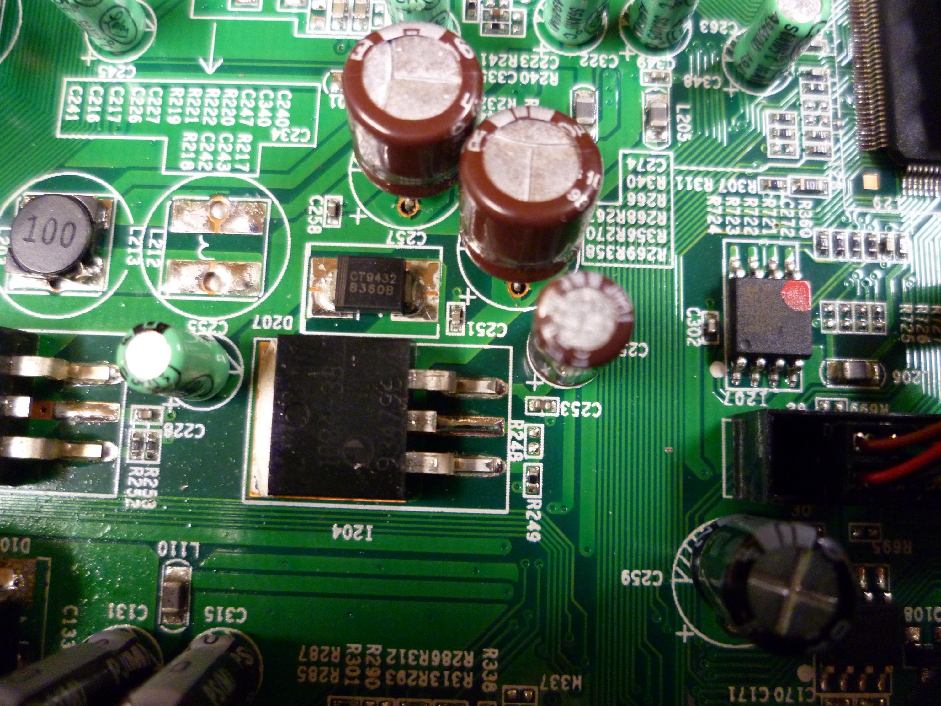

                          OK, lets see good close up of that I204 to able to see what components are connected to the output pin, I hope it is just bad MLCC.
                          I see LYTICS cap C250, MLCC C251.
                          I also see D207 and L210 are connected to the output pin.
                          BTW, you did verify the pinout of the IC to make sure we are looking at the correct Output pin, correct?
                          BTW, what is the P/N as printed on I204?

                            #53
                            Re: Viewsonic VT2430 fluctuating 5V rail
                            Here is the photo. Part no is 1084-33. I103 is also a 1084-33 while the other 2 are just written 1084.
                            As for your question about the output pin, I got the datasheet to make sure I was measuring the right thing. Tks Budm.
                              #54
                              OK, that is a fixed 3.3V output regulator IC.
                              So something on the 3.3V line is shorted out, I would try lifting the Caps connected to the output pin first to see if the low resistance will go away.

                                #55
                                Ok, took out C250, still there. Took off C251 still there. What should I do next?
                                Should I try and lift the ground leg of the regulator?
                                  #56
                                  See if inductor L210 is connected to the output, it is then lift it also.
                                  "Should I try and lift the ground leg of the regulator?" Yes you can.

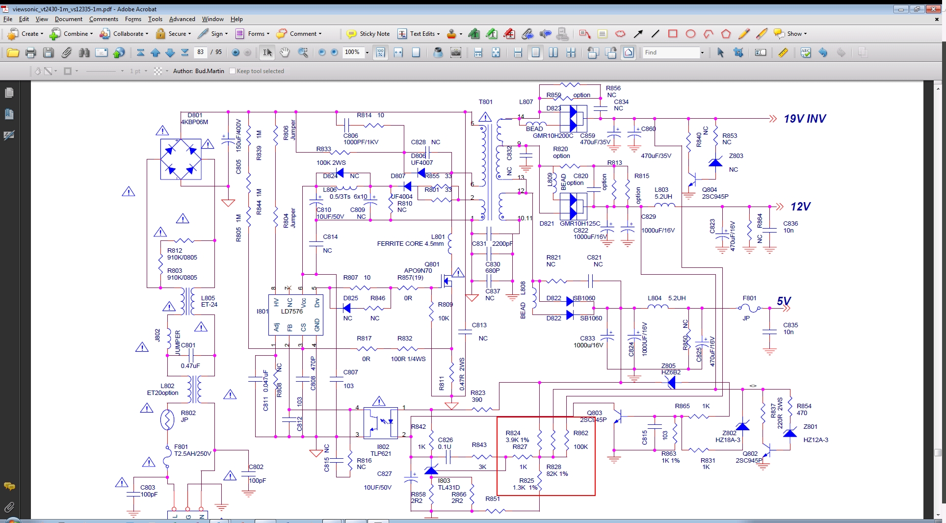

                                    #57
                                    I found L210, but it doesn't seem to be connected to it. Looking at the schematic, I see it elsewhere connected to the tuner section? I'll wait for your reply before lifting anything. Tks Budm.

                                      #58
                                      Oops, I guess I took my readings wrong, it is connected to the output. Still don't see it in the schematics, but then I'm probably cross-eyed!
                                      So Budm, should I lift L210 first and see and then the regulator leg, or both at the same time? L210 is the easier part

                                          #60
                                          It may be easier to lift L210 first to see what happen. Right now it is a matter of finding which component that is connected to the output is shorted out. At least we are getting close to solve the problem.
