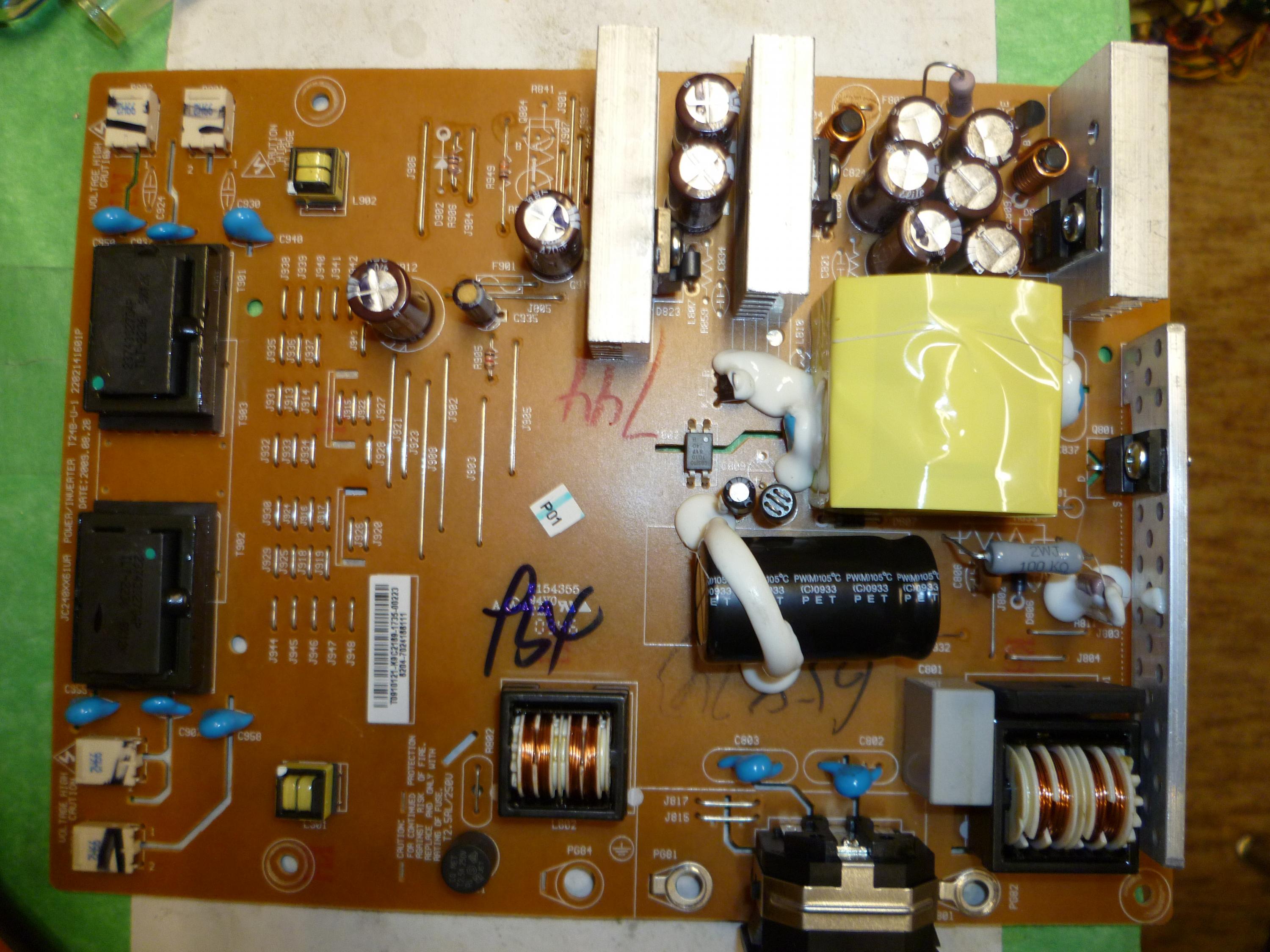

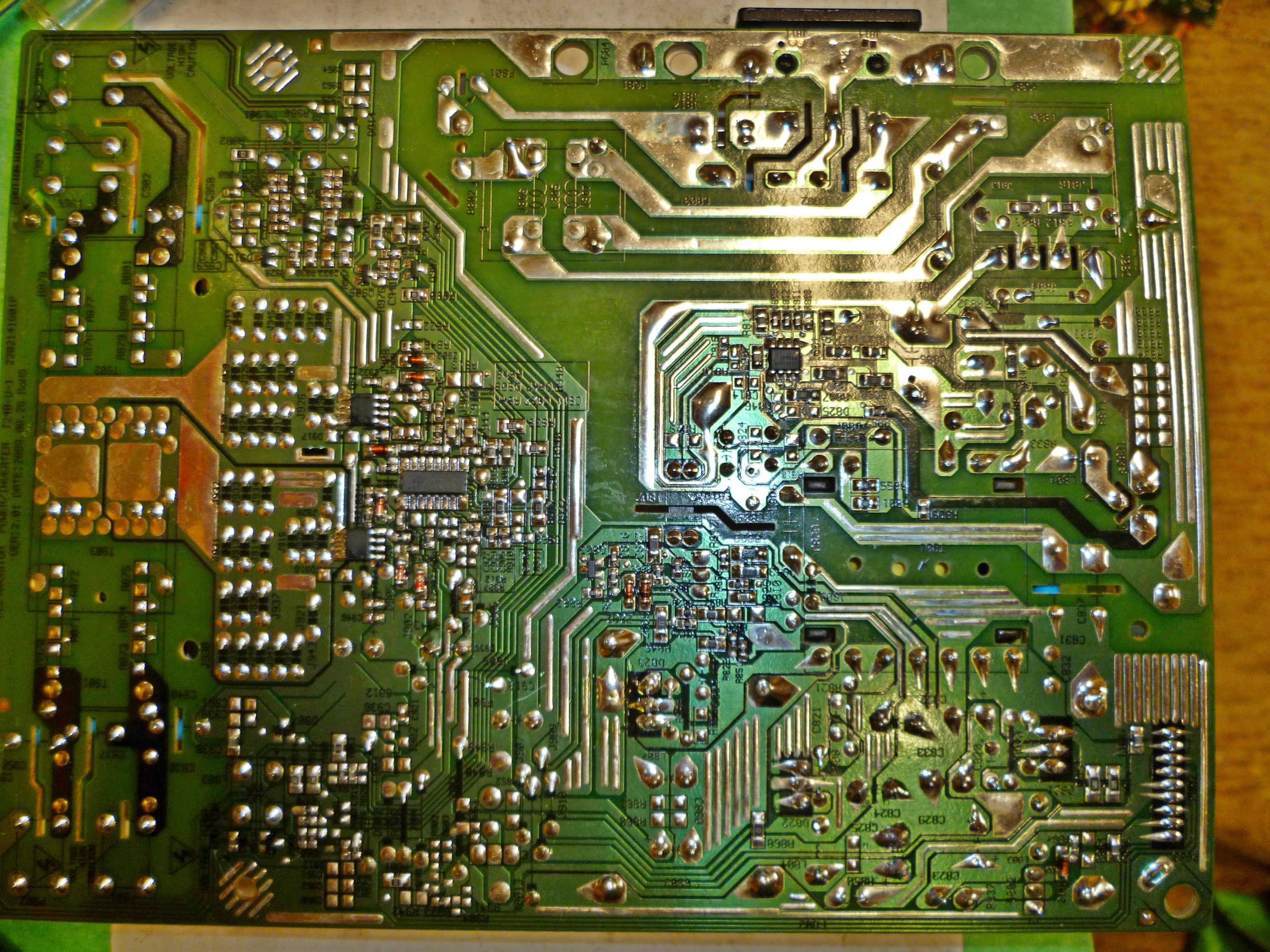

    Hello to everyone,
    I need some help with this tv/monitor. All is working well, except that I noticed the power indicator light (blue) was fluctuating while using it.
    I opened her up and I have all my voltages +5V, 12V etc, rock solid when the monitor is in standby mode. When I power it up, it comes on fine but the 5V rail is fluctuating from 4.8V to 5.1V constantly which is causing the indicator light to fluctuate (throb).
    I checked all the caps on the power supply board and they are all good (including ESR and value), even the big guy! I checked resistors, diodes and a bunch of components, but everything seems fine.
    So when there is no load on the power supply all is fine. As soon as there is some drain, the 5V rail fluctuates from 4.8V to 5.1V constantly like a heartbeat, which I think is out of range...but the monitor/tv works fine. Any ideas what it could be?
    I am attaching photos with the service manual and the schematics - I just can't figure it out and need help from the masters!
    Thank you!
    Ray

    Are the 12V, 19V steady? 5V, 12V, and 19V are generated by the same transformer.
    The feedback for the output Voltage monitor all 3 power supplies outputs so I expect the other two outputs to fluctuate also.

      The first cap. I would replace would be C810 10µf/50v

        Budm: the 12V fluctuates for 11.75V to 12.5V (when load is on) but not in standby. I can't find a 19V??
        R_J: C810 on board is a 22uf 50V which I took out and measured with my ESR meter and it looks fine. But you are right, the schematics calls for a 10uf, so I don't know if that could be the cause or not?
        I did measure the voltage on the big cap, and I do get a fluctuation there: 160V steady on standby, when power up, fluctuates from 148V to 152V ???.is that normal?

          If C810 is a 22µf then I would leave it, schematic could be different. any small change of voltage on the large cap won't have any effect on the output,
          The led is supplied by the VCC5V-ST, there is a 1500µf/16v (C110) on the main board that should take care of any voltage fluctuation, unless it's bad?

                            Did you check C827? I see from your picture it is a smd cap.
                            This could be hard to troubleshoot since it is working just not supplying enough current.
                            I see you checked the caps like c833,c824 but have you tried replacing them to see if that stabalizes the +5
