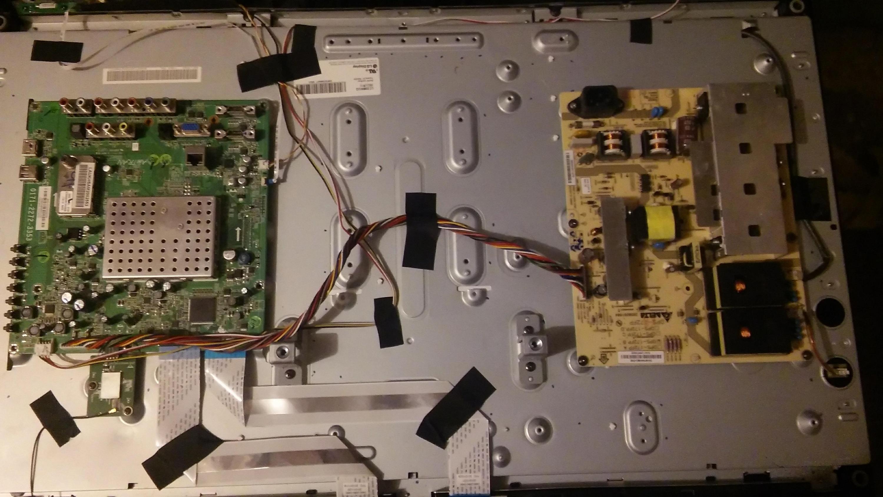

    Re: Vizio e322vl wont turn on
    http://www.shopjimmy.com/catalogsear...q=Vizio+e322vl
    It may be EEPROM problem but we should at least see the DC Voltage readings on the connector of the power supply board that goes to the main board first to see waht condition they are in.
    You need to the report the readings in this format: Pin name follows by Voltage reading when TV is OFF, and when Power switch is activated
    Example:
    Pin name (I.E. 5V), TV OFF = xxV, TV ON = xx V
    BTW: Upload good clear pictures of the whole backside of the TV showing all the boards will help too.

        • lucas0113
          • Feb 2018
          • 12

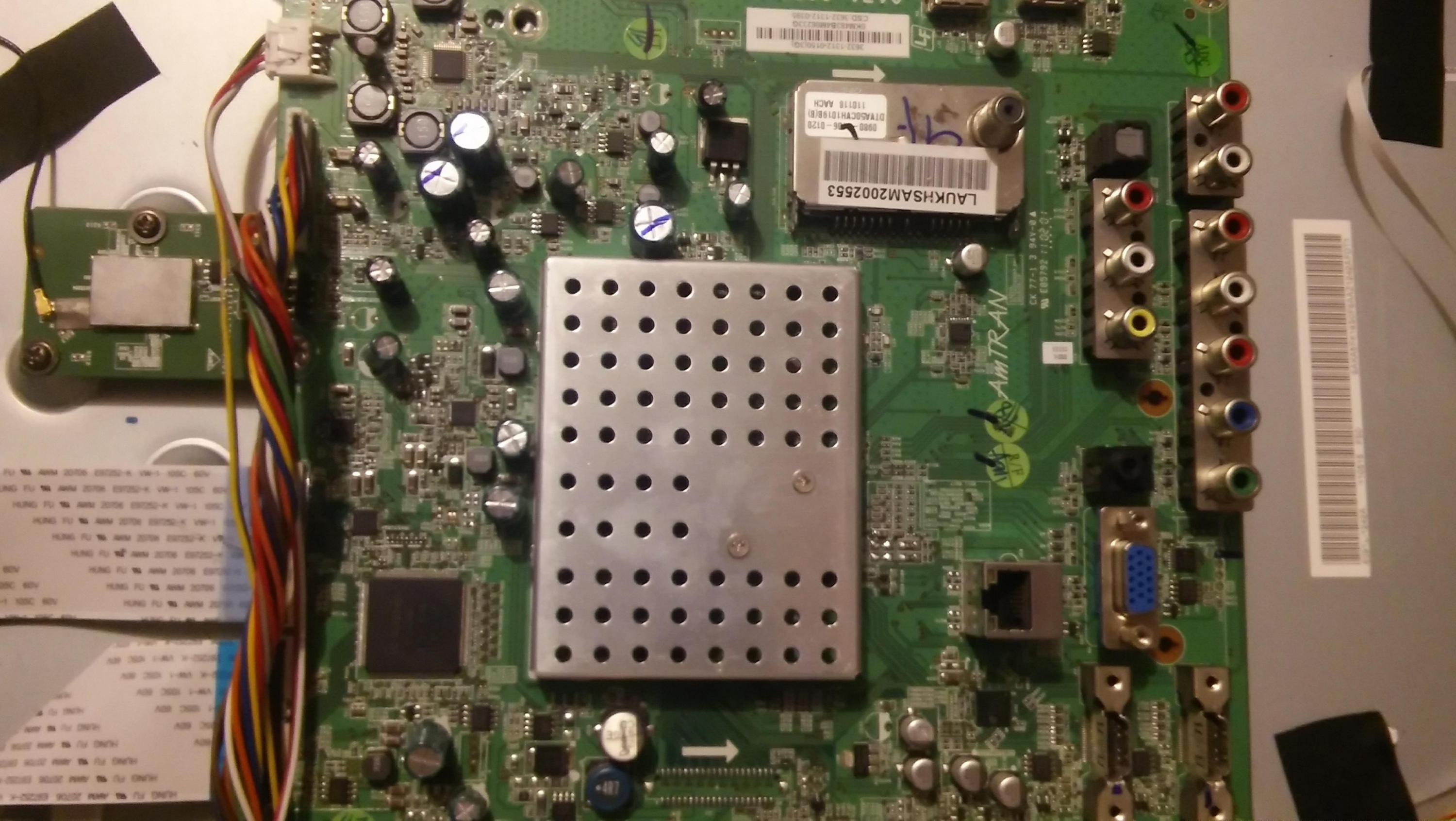

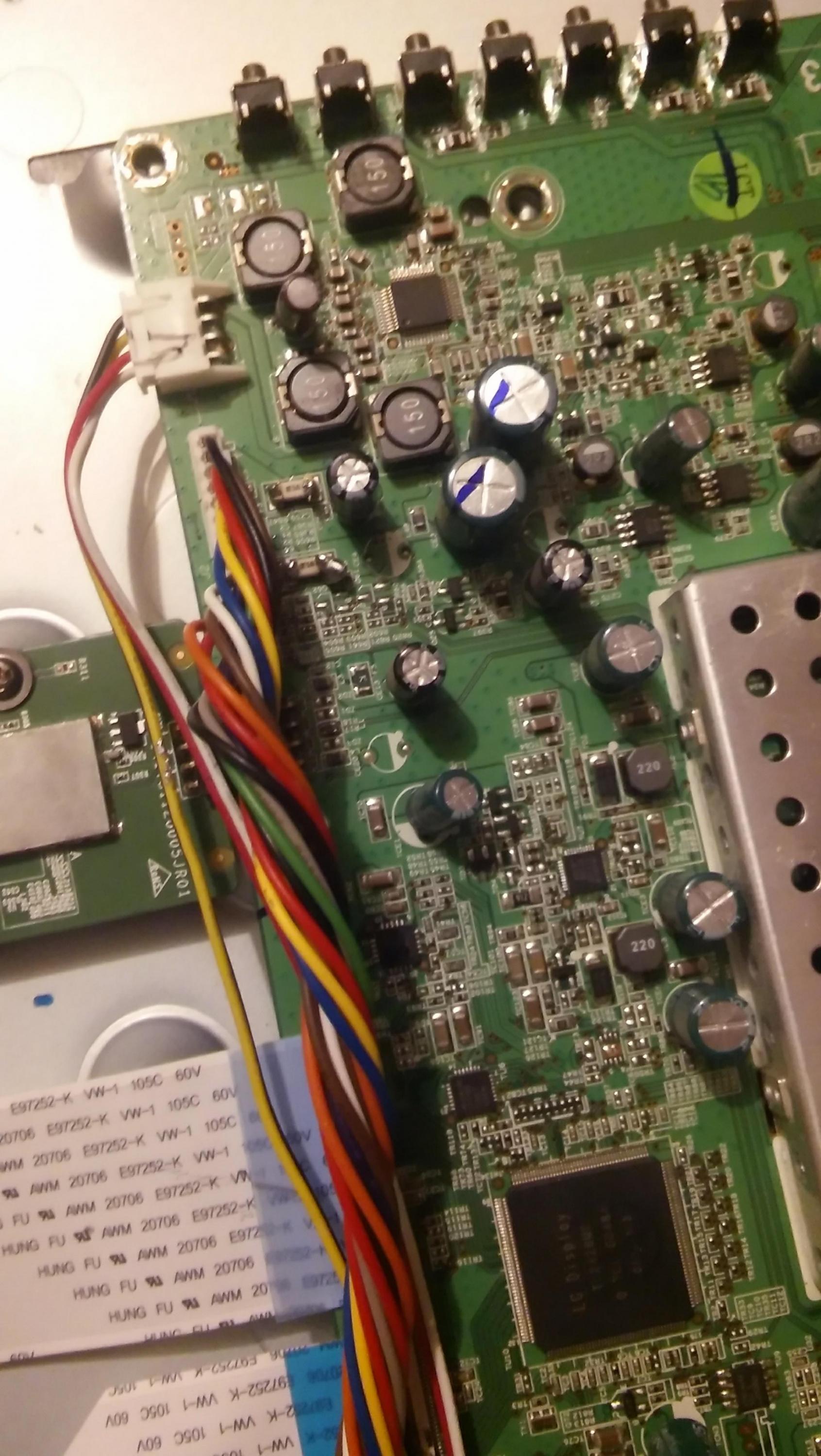

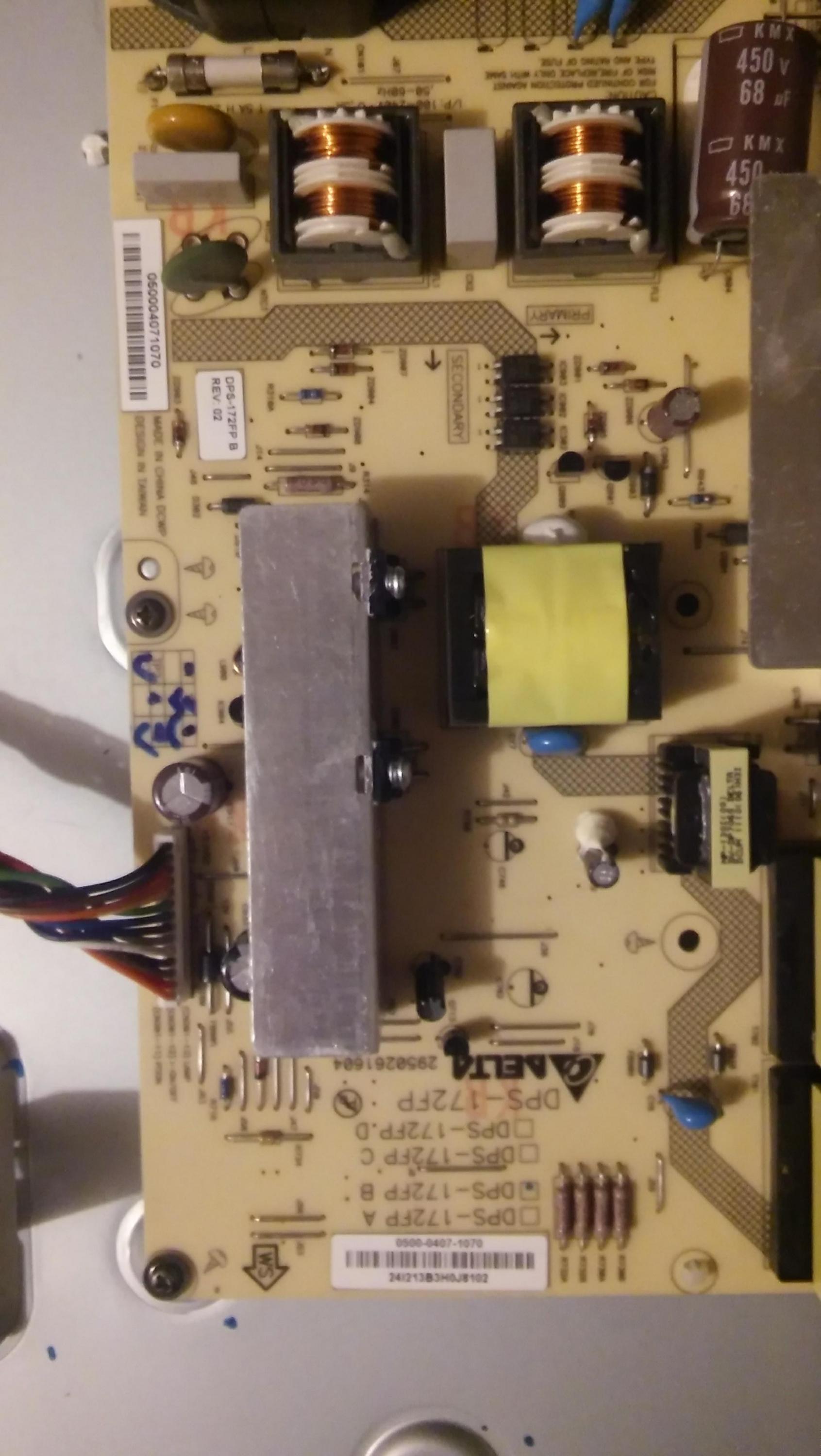

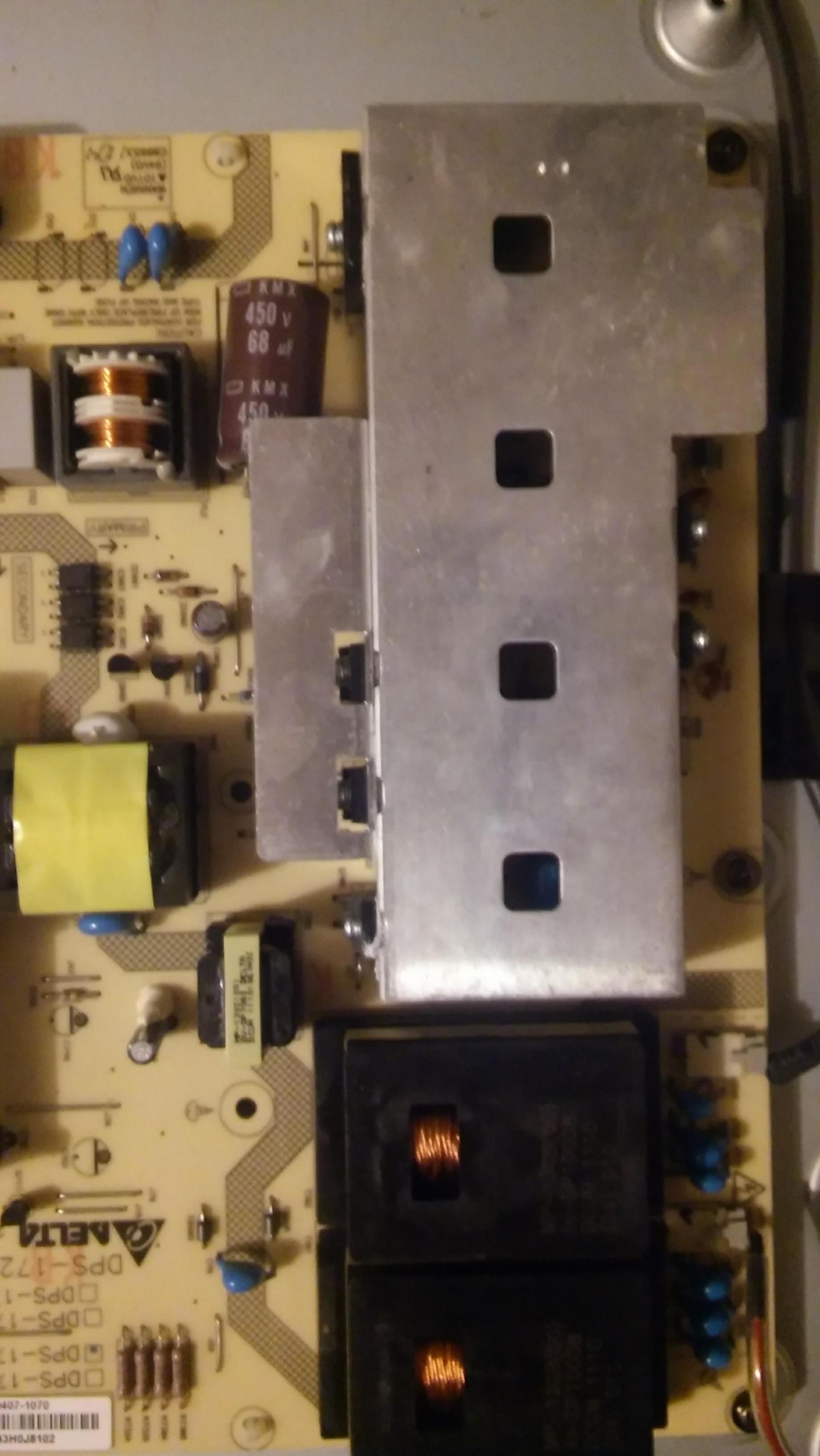

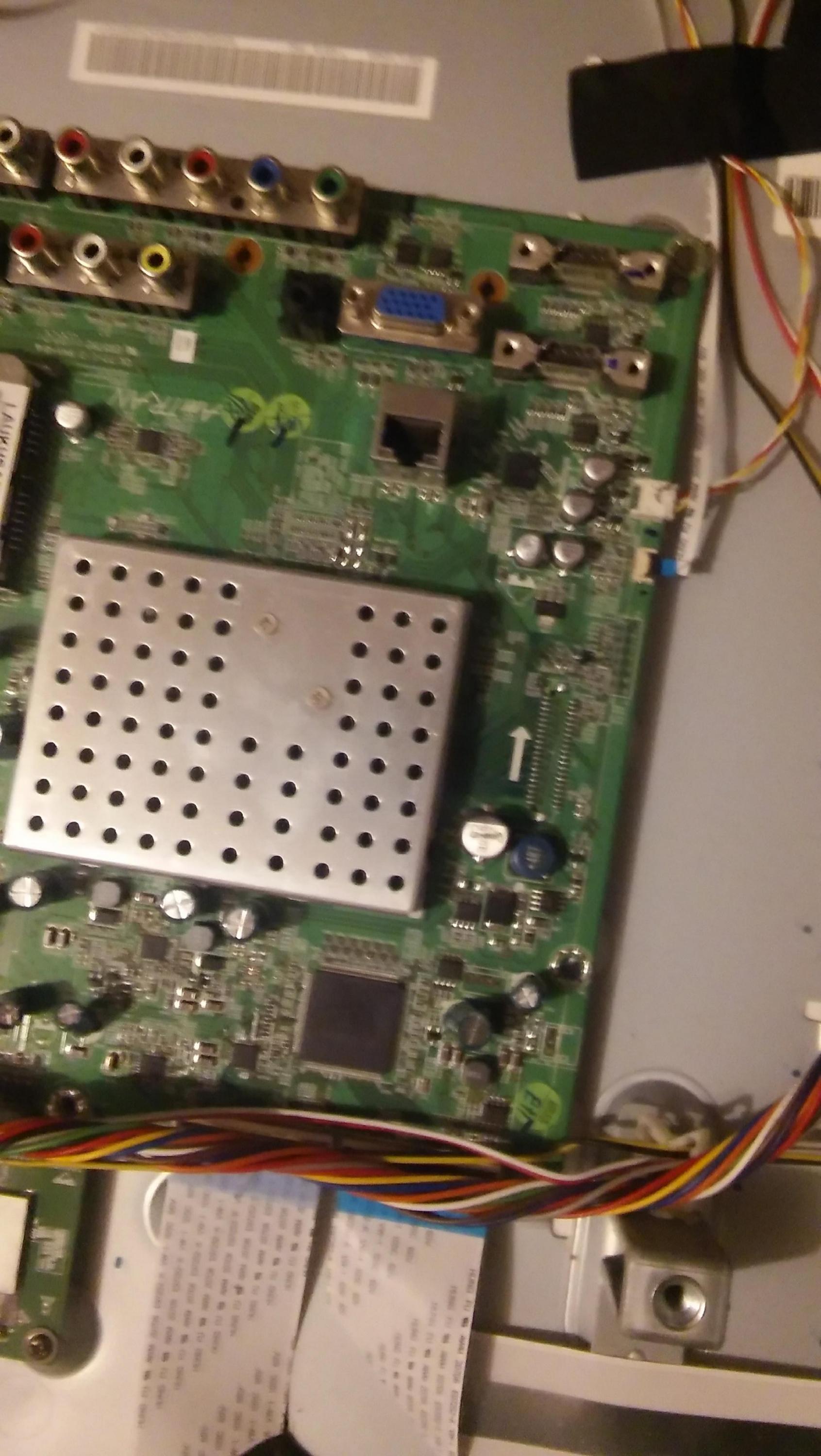

          Again, sorry for late reply. Here are the images:
          (sorry for the quality)

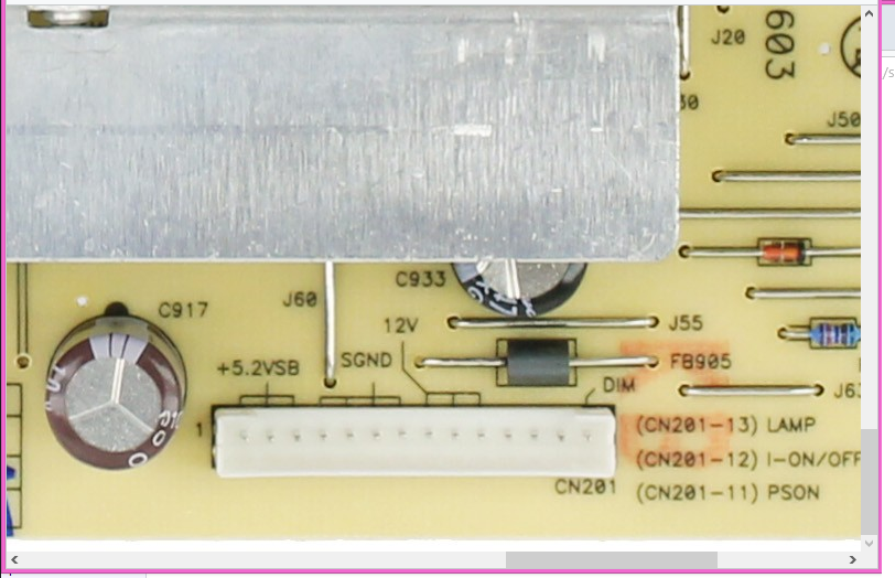

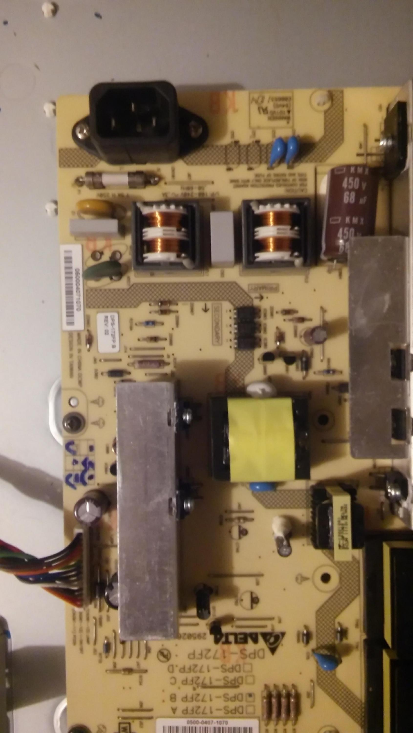

              0500-0407-1070 Looks to be your board.
              http://www.shopjimmy.com/vizio-jvc-0...upply-unit.htm
              Connector CN201 has label for each pin.
              Black probe of the meter on the chassis.
                      Pin name? I put what they were labeled from the board.
                      It even says cn201-11 is pson, and so on
                              That is a the info budm seeking. The pins should be marked or have a legend nearby or sometimes under the board.
                              • lucas0113
                                • Feb 2018
                                • 12
                                Well here, this image should do.
                                  Wouldn't I need a heat gun to remove something like that?
                                    I think he meant to add the pin name to list. Here you go:
                                    1. 5.2vsb : 5.4v
                                    2. 5.2vsb : 5.4v
                                    3. 5.2vsb : 5.4V
                                    4. gnd : 0V
                                    5. gnd : 0v
                                    6. gnd : 0v
                                    7. gnd : 0v
                                    8. 12v : 0v
                                    9. 12v : 0v
                                    10. 12v : 0v
                                    11. pson : 0v
                                    12. i-on/off: 0v
                                    13. lamp : 0v
                                    14. dim : 0v
                                    Edit:
                                    Turn unit off (unplug), put probe on lamp(#13), power on, press on button. Did lamp ever change?
                                    Do same for pson.
                                      I ask to put down the pin name on your reading so I do not have to look back and forth between the pictures and your report.
                                        Can be done OK with soldering iron but best to watch some videos first - basically add a bit of solder to legs first then melt solder and gently prise up legs one side then work on the other side - must avoid damage to board tracks/attachment points.
