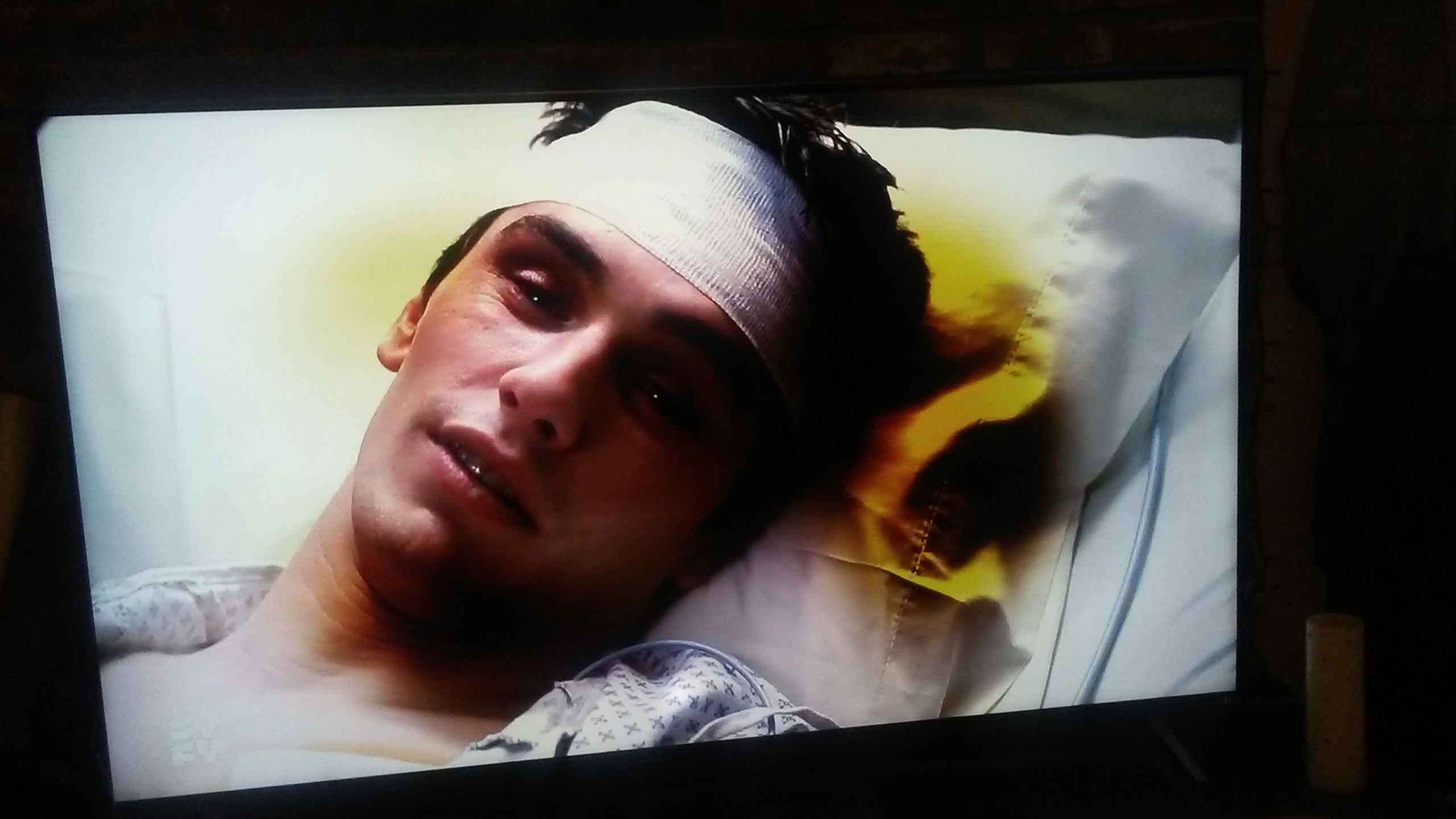

                Re: 70in Vizio m70-c3 replaced led's now picture screwed up.
                I only used two. Had another person help me carefully remove it. Its what was instructed to use by shopjimmy.com. the picture is beautiful except for the shadows. I've worked on other smaller Tv's replacing boards and such. Never had a problem till this one. And yes I know the problems I'm facing were self inflicted. Have never denied that. I did check the backlighting before replacing the panel, all looked well. Brightly lit. What's odd is when watching cartoons, the shadow is barely visible. No shadow, just slightly darker colors as the surrounding.
                          Originally posted by ecking767
                          parts for this e701i-a3 and e601i-a3 model Vizio are plentiful on eBay. to me this mean a lot of failed LCD panels or crack screens. I will lean more toward the failed panel than crack screens. I avoid buying these model Vizio TVs unless it power on and I see a clear picture
                          The picture was clear with no flaws just dim backlighting in spots. I replaced the backlight a now have a bright crisp picture except for the shadows. They weren't there before. Its driving me crazy.
                            What's weird is the shadows don't stay black. They change with the changing colors if the scene. Its just the dark scenes are really dark in those spots. If you press on the panel in those spots, they lighten to match the rest of the picture.
                              there is probably some form of distortion (physical) on the plane of one of the layers. I asked earlier about the use of the suction cups... did you use them to lift the entire panel / tv set or just to remove the layers?
                              since your set is somewhat "disfunctional" in its present state, you might consider "re-do" the disassembly of the layers and subsequent re-assembly... maybe some thing happen during reassembly (air pocket / vacuum pocket) that is causing the "pressure pattern".
                                I only lifted the screen/panel out once everything was disconnected. Barely weighed anything at all.
                                      Here's the picture now.
