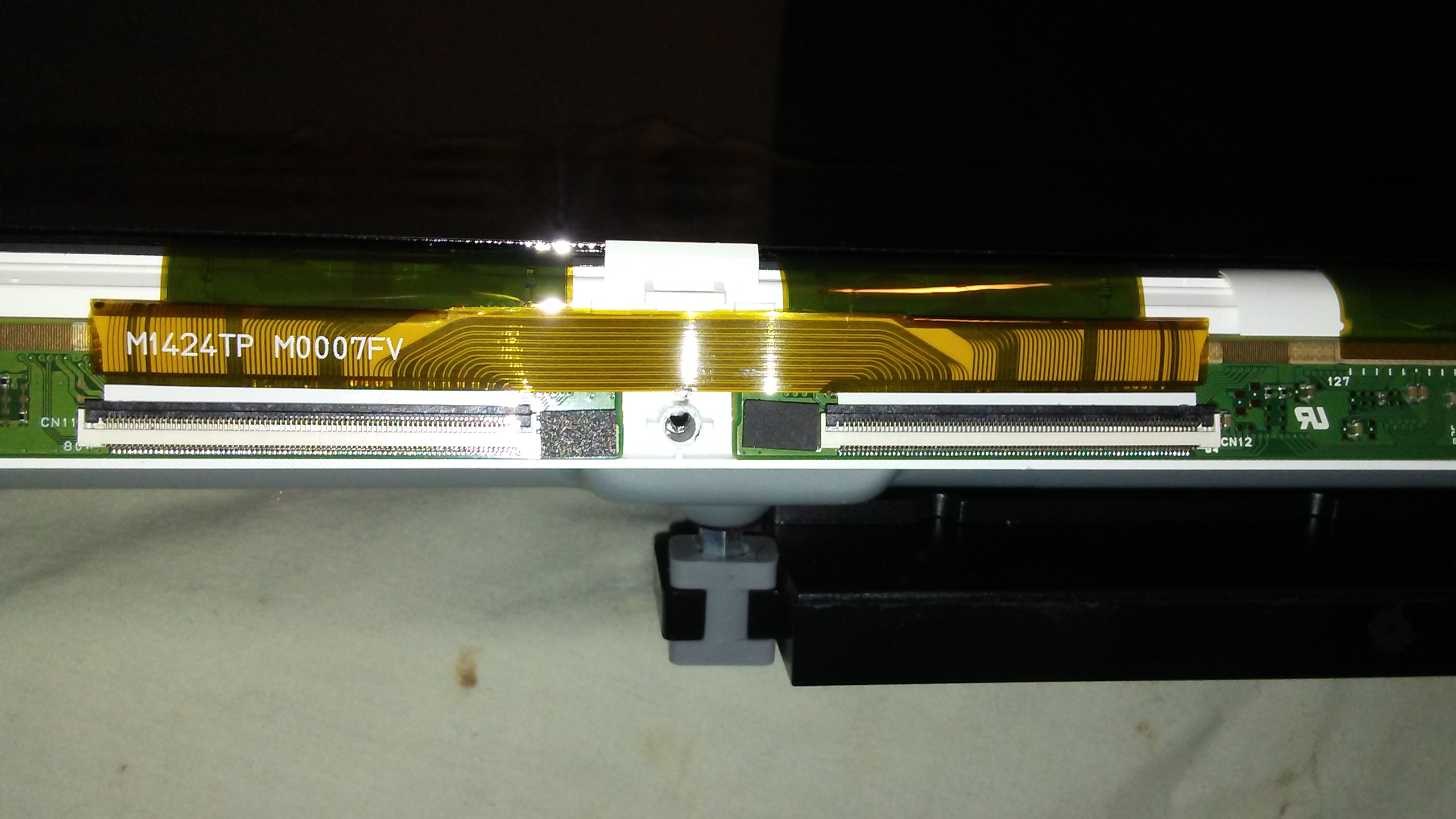

    This is the ribbon connecting the 2 boards on the right side of the panel.
    • freakaftr8
      • Oct 2012
      • 3743
      Re: 70in Vizio m70-c3 replaced led's now picture screwed up.
      You will be removing the side drivers. Not the ones on the bottom! Don't remove those. Wrong area. The right side is the area. Not right bottom.

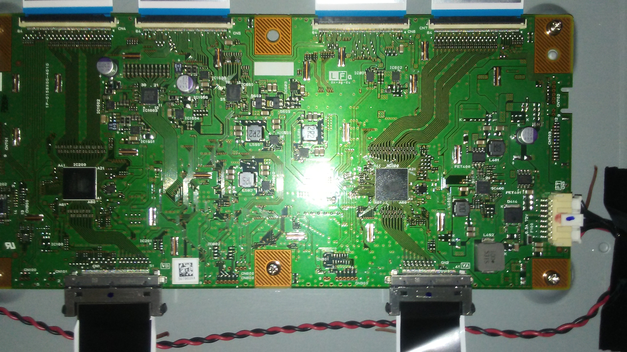

            OK so this particular panel does not have driver boards attached to those ribbons. Shouldn't be a big deal. You can try removing them since this is the side that's causing the issue.
            This is the right side (side) of the panel correct?
            Not necessary to use rubbing alcohol.
            Before you do this can you post a picture of the tcon board?

                Well that is definitely a Sharp tcon board. It is a little bit different panel however it should hinder the same results as the models with the driver boards on the sides.
                Note that this is an irreversible process and I bear no responsibility if it doesn't work right. But considering the Present condition of the panel it's either make it or break it at this point anyhow.

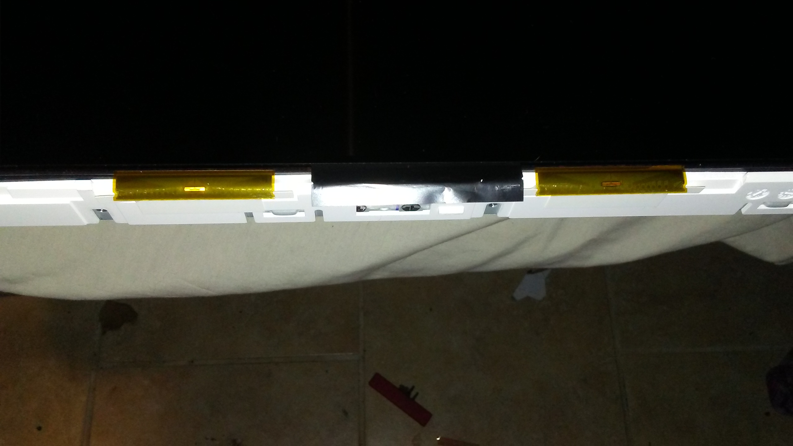

                              #34
                              I just noticed that one of the eight driver tabs on the right side is missing. Evidently it came off in my initial dismantling. It's on the bottom right side.
                                well that's your problem. That means you have no choice but to remove the other ones on that side and cross your fingers.
                                  It didn't just come off, it tore and part is still on the panel.didn't think it did anything so I didn't mention it.

                                    now you different... :-( too bad as you likely had a "perfect set". IF you are lucky and the removal of the rest of the side tabs is good / clean, your tv should be OK.
                                    good luck.
                                      Ok.. Agreed that's your problem. You cannot have any damage to any ribbon driver on the panel of it will cause problems. At least you didn't damage any of the source drivers.

                                        So I should go ahead and pull the other seven off completely?
                                        • freakaftr8
                                          • Oct 2012
                                          • 3743
                                          #40
                                          Yes
