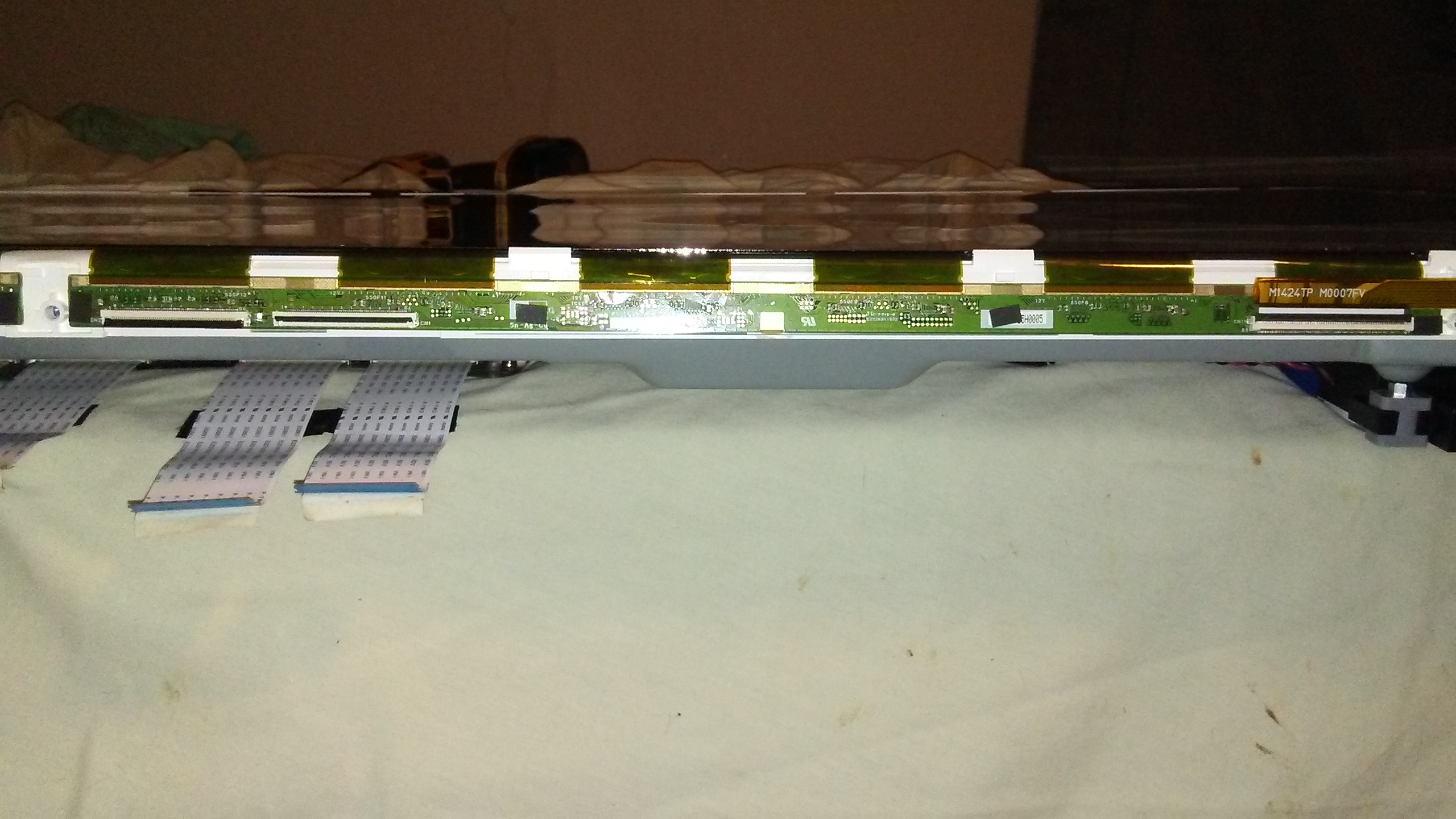

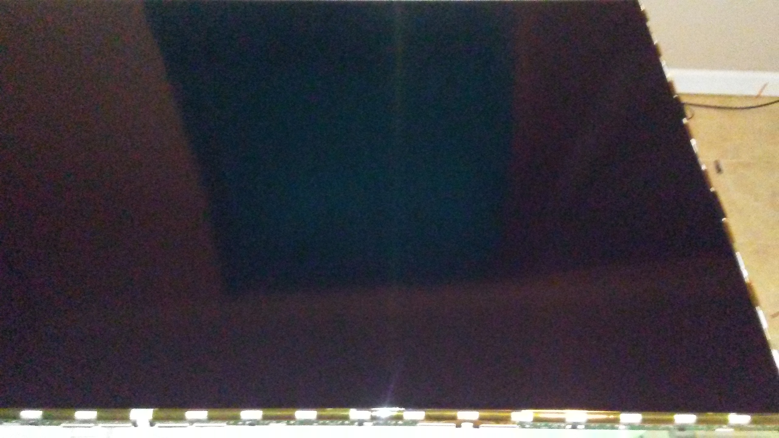

    Maybe someone here can help me. I bought an Vizio m70-c3 on craigslist for $175 that needed backlights. It had a beautiful picture just really dim in some spots. Tested the leds and alot were out. Ordered some from shopjimmy and put everything back together and now the pic is screwed up. Any advice would be greatly appreciated.

    That's mura, not fixable, but may be caused by the failed gate driver on the right side of the panel. Panel and tcon manufactured by sharp.

      Take a better picture of the screen if you can. Looks as if the right side gate driver with that white band goes all the way across the screen is the area that is badd
                I've been reading your posts about peeling off the tabs from the panel. Do you think this could help?
                        Yes it appears that this is your only saving grace now.

                            Could have pinched the tabs when setting the screen back on...take off the plastic piece that holds the panel on that side and see if it clears up

                                Ive taken off the piece that fits over the panel and checked all cables, no improvement. Ive got the back off now and its on its stands. I can get to everything if needed. Just not sure where to start or on which side.

                                  Take off the right side while in front of the screen.

                                    No heat needed just gently pull each tab away from the panel like you're peeling tape off of something. Start from the top and work your way to the bottom both side boards (upper and lower) all cables on that side. When you're done you will have to boards connected by a ribbon with all the ribbons hanging off the boards Like you saw in my pictures on my post they were sitting on the tile

                                      Thanks so much for the guidance. I'll take pictures here in a minute and post just to make sure I'm correct.

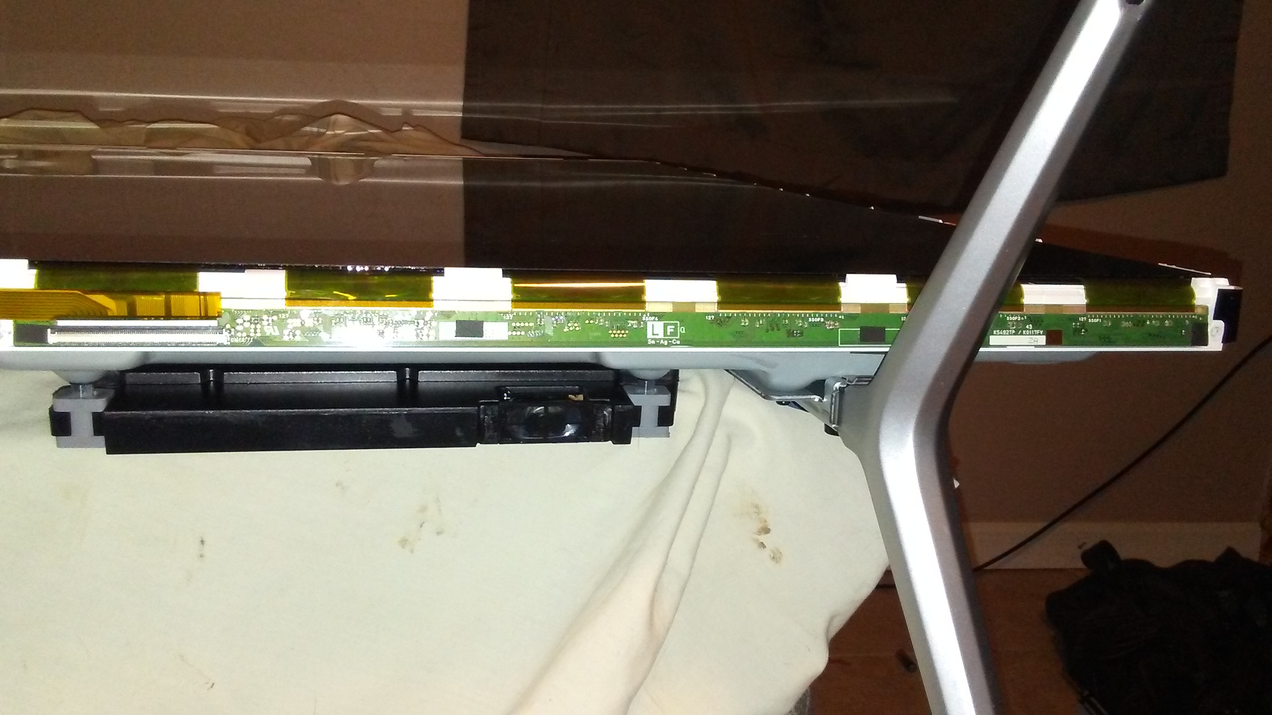

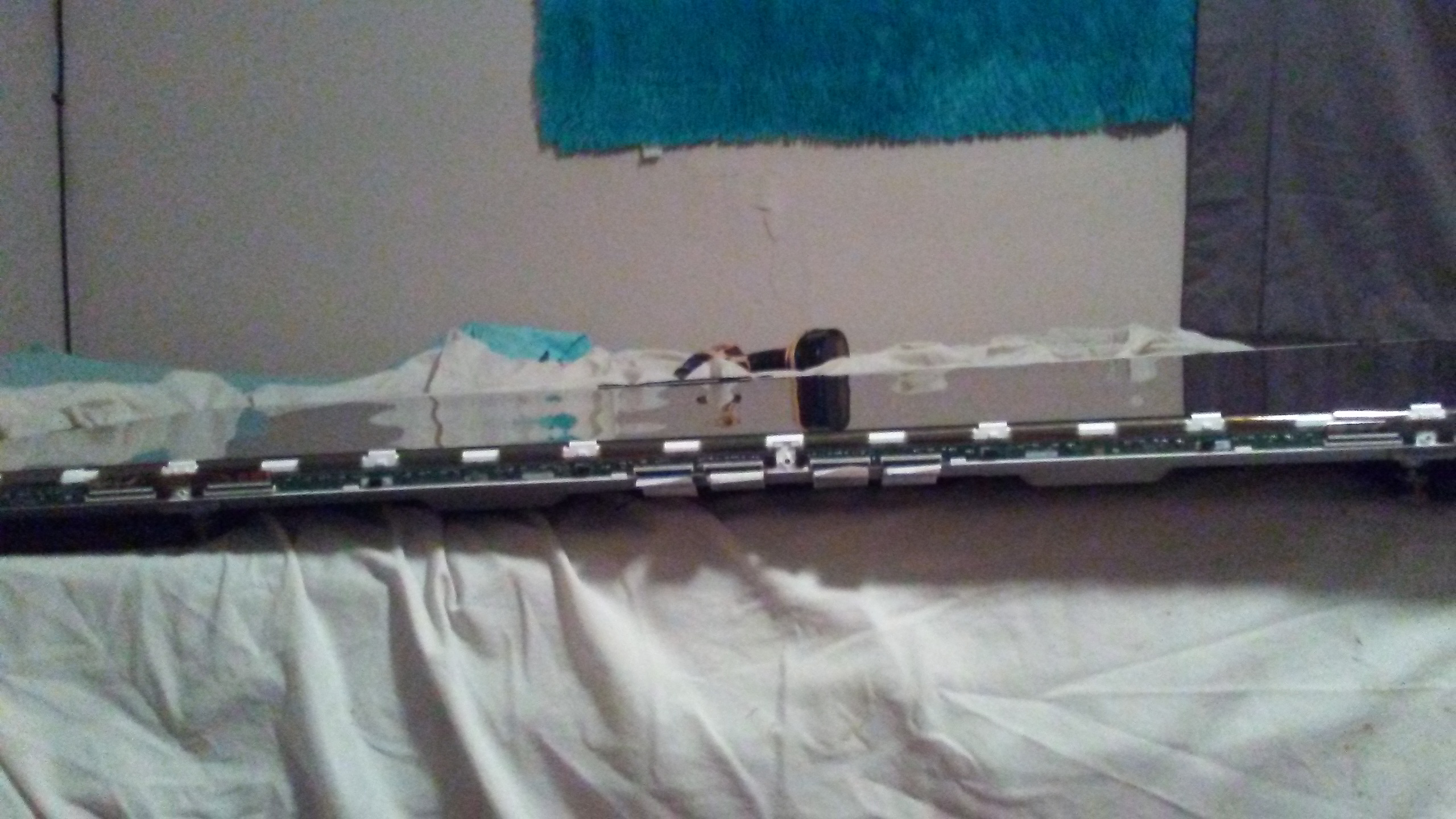

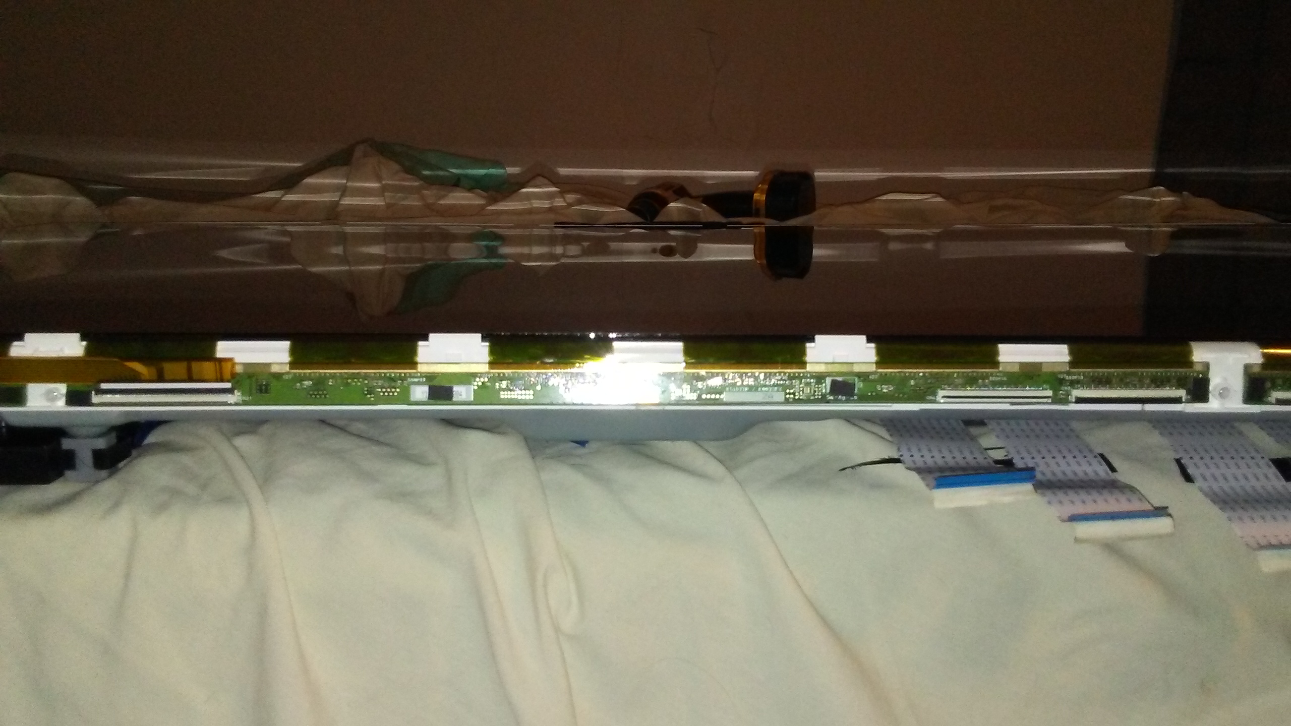

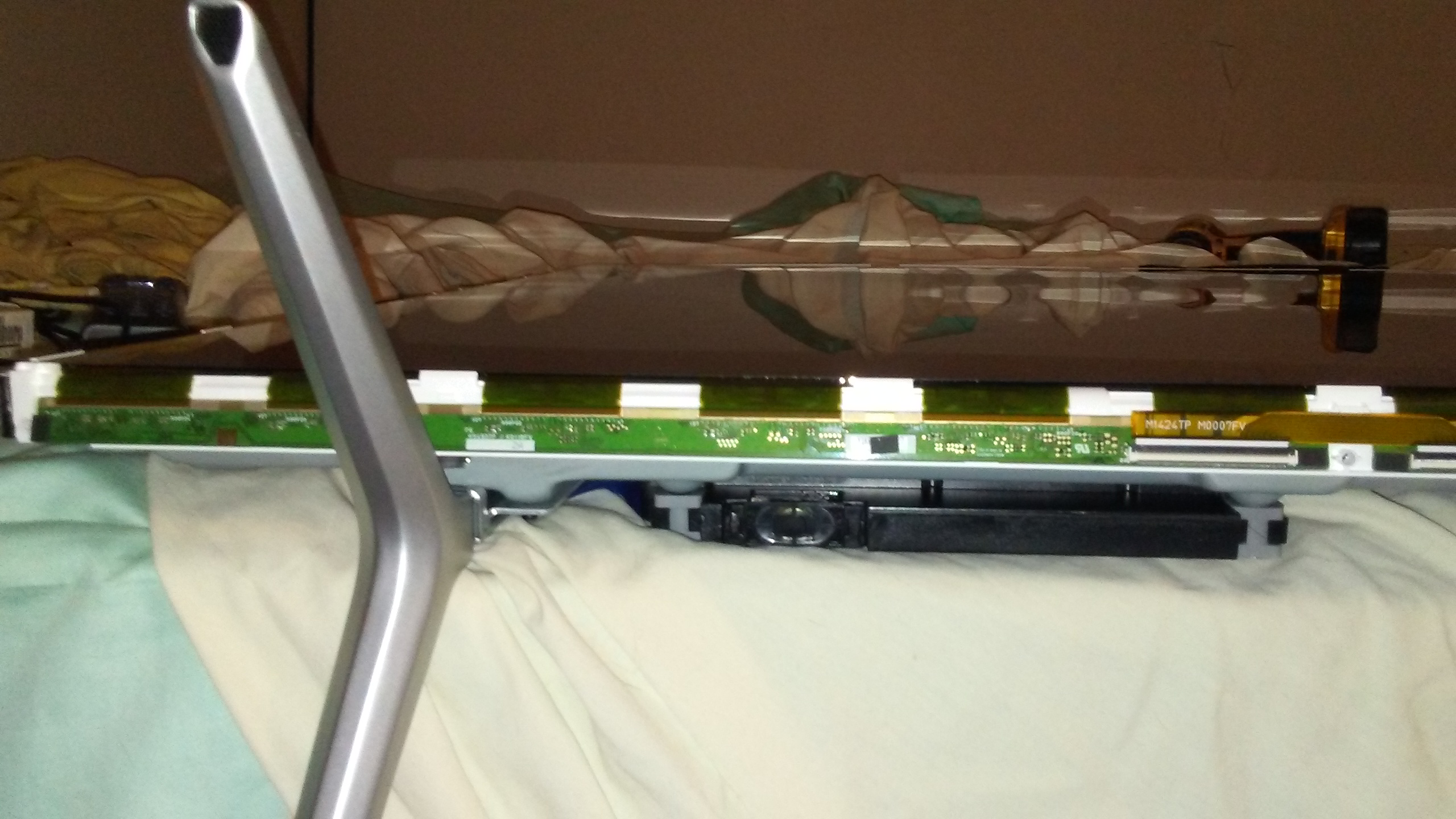

                                        Pictures taken. Now, I have 4 small boards (2 sets of 2connecte by an mid ribbon) attached to the bottom of the panel. These are connected by 4 ribbons coming of the boards on back of TV. Do I peel off the ribbons on the far right of the papan, 5th pic?
