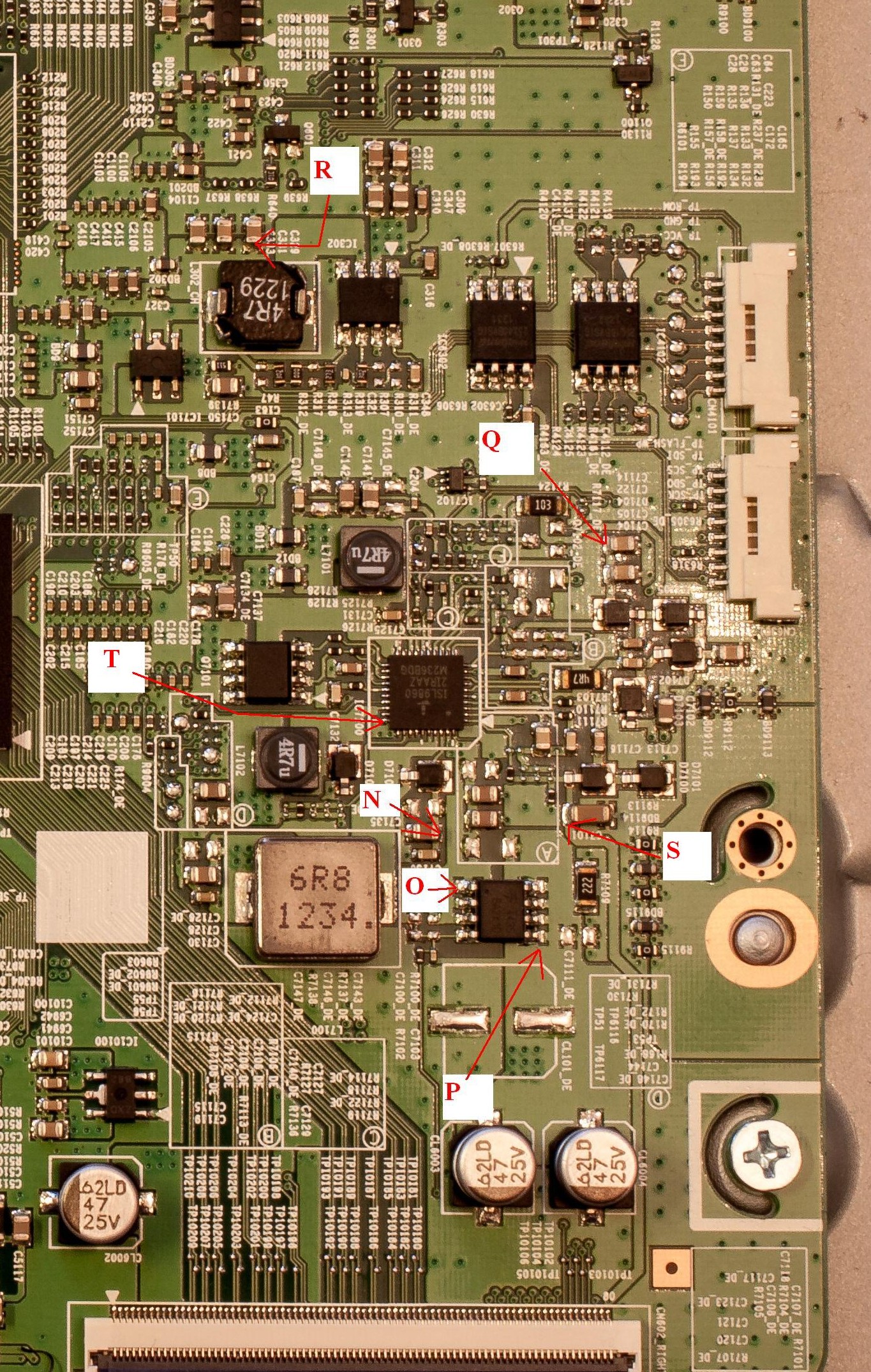

    Sorry, many points that i have pointed at are wrong, this tcon need some tests more and without to measure continuity between points or view datasheets is too much difficult.. i think.. where you measure 12v is much probably not an output but input.
      #42
      Re: Samsung UN60EH6000 Tries to come on, but stops
      Davi,
      Are you saying the board is just bad and I need to replace the entire board?
      Did I measure at the wrong locations?
      Kirk
        #43

                  I saw now the norcal video, but he tested near 0 volts on that big coil where i've put indications M N, you have the tension he had measured after repair.
                    #49
                      Can't you measure theese points?

                          #52
                          Originally posted by Davi.p View Post
                          Can't you measure these points?
                          Davi,
                          Sorry, I just now saw your post. I will try to get those measurements tonight.
                            #53
                            Davi,
                            Here are the points you asked for.
                            N : 12.7 V
                            O : 11mV
                            P : 1mV
                            Q : 17mV
                            R : 1v
                            S : 1mV
                            T : 12.7V
                            Kirk
